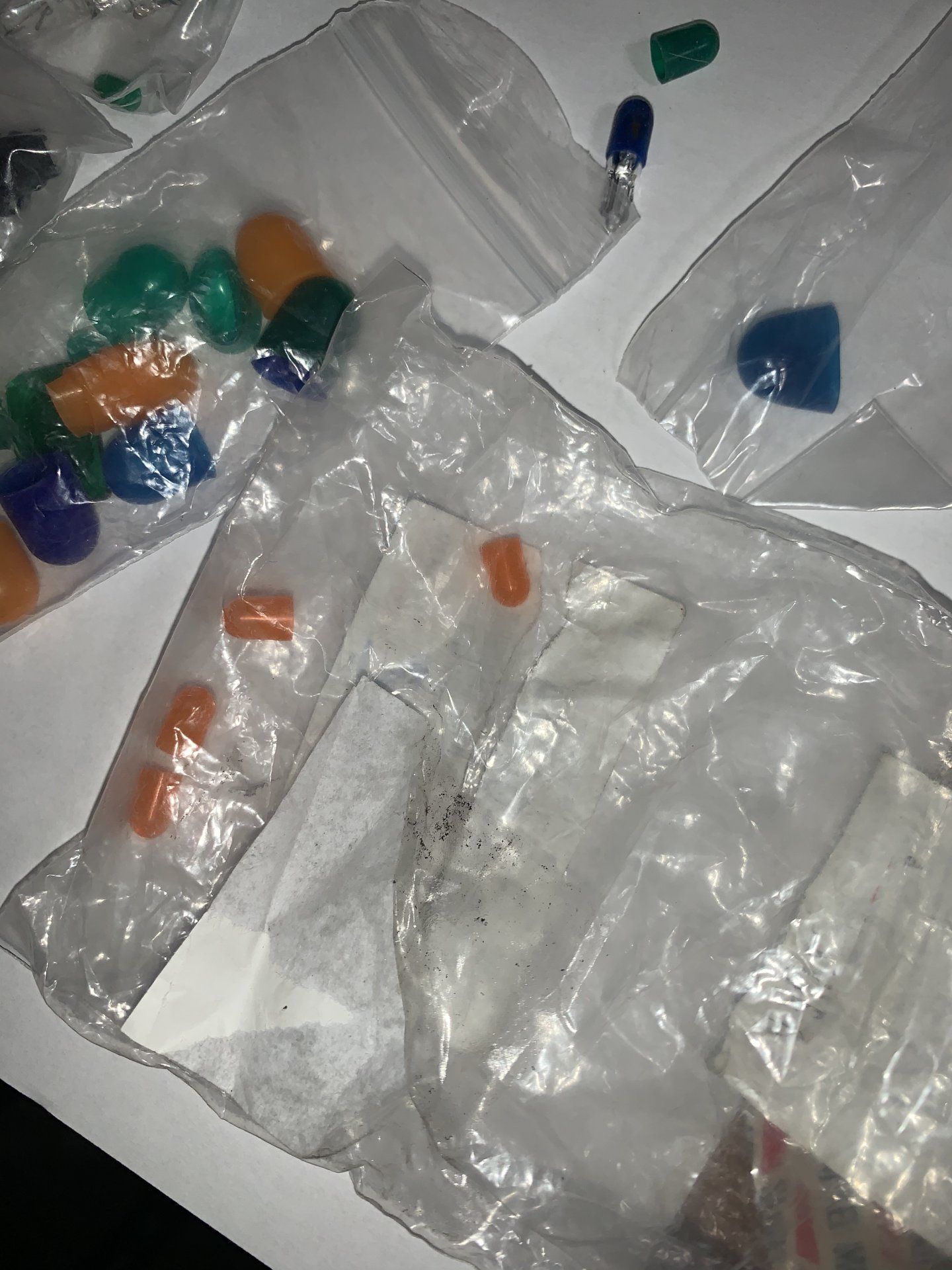

i would like to offer up a unique collection of sorts to the cause ........
my life time supply of OEM colored rubber bulb caps
most are green , but i have oem blue , oem fire oarnge , oem yellow too
please let me know and i can them mailed out to Ya ........

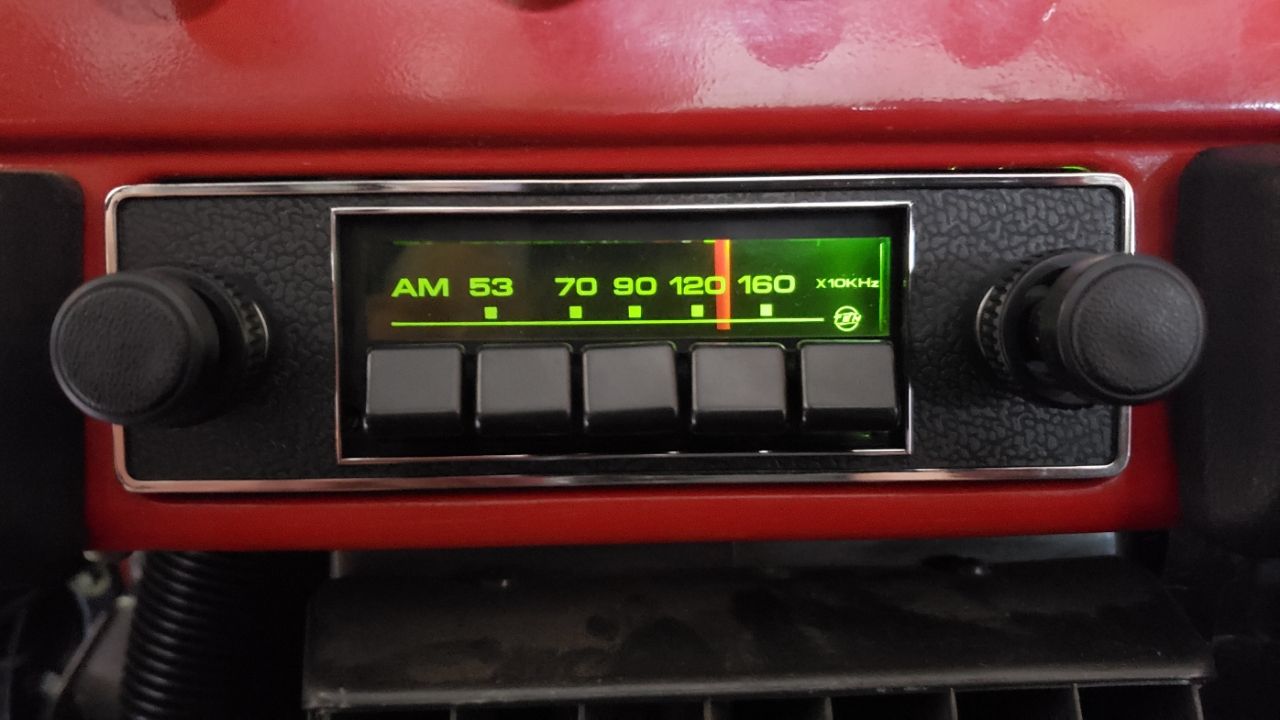

Working on the CB40M today. Some of the segments on the channel LEDs were not working. The segments in the channel display are controlled by contacts in the channel selector switch, wiping the switch a few times got it to working pretty well. After a bit of run time, found the middle horizontal segment on the second digit was intermittent on all channels that used it (2,3,4,6,8, etc) indicating a bad connection somewhere. Digging further in, found a bad solder connection on the back of the led. All segments working fine now.

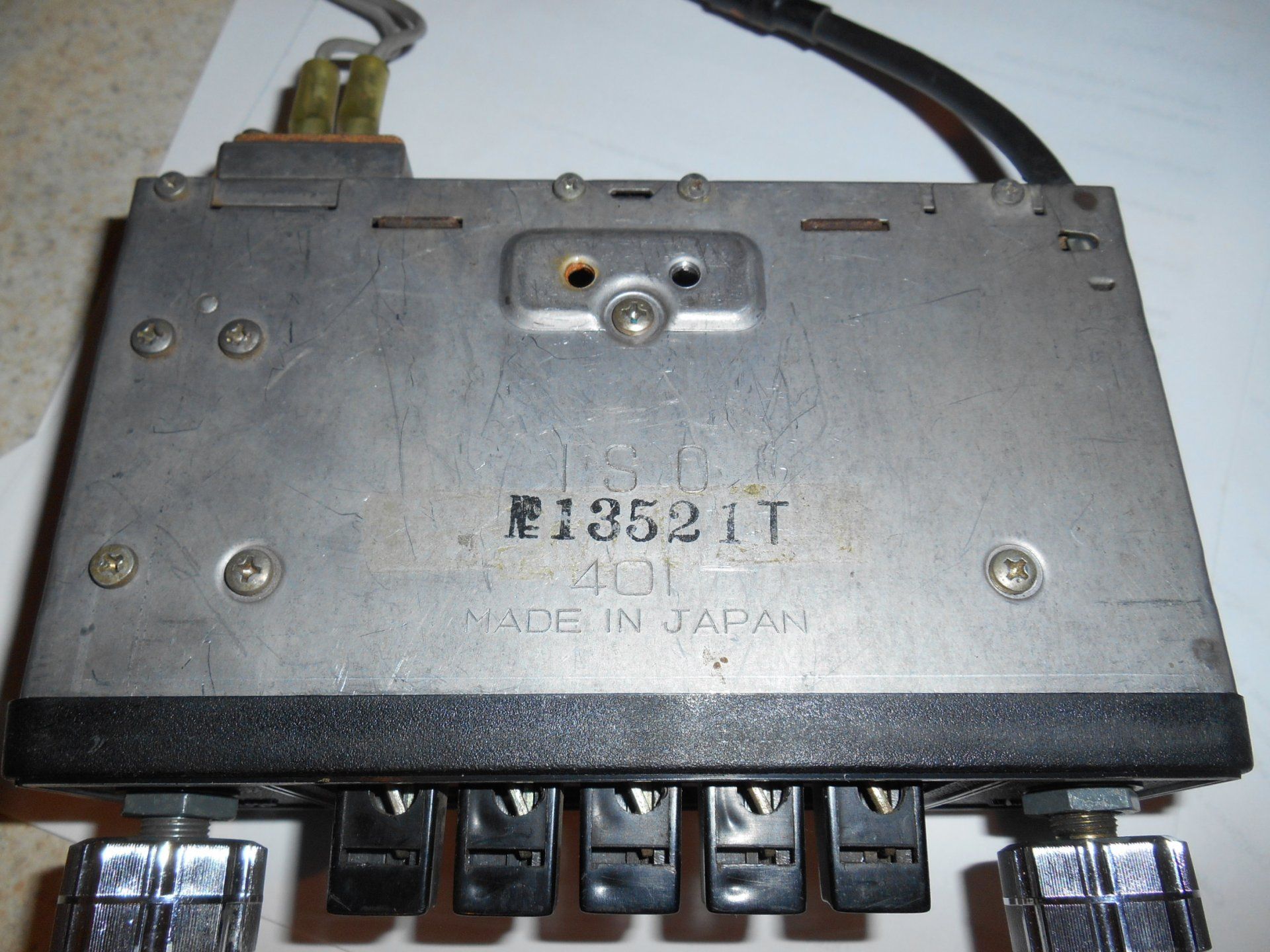

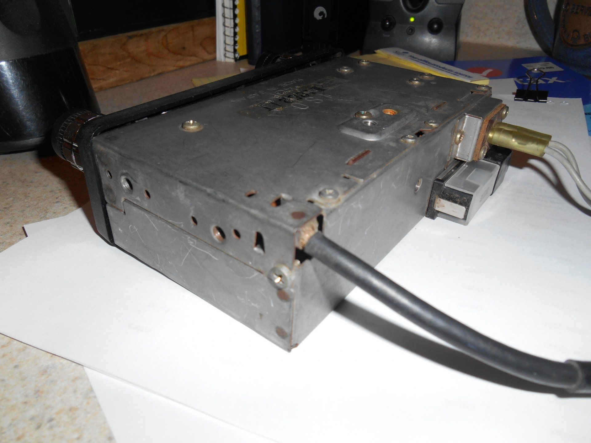

The radio all works as it should, but I see no evidence of a light bulb inside (it's presumably burnt out) nor can I see how to replace it. There is not an obvious set of screws to remove a cover to gain access to the light bulb. Is one of the covers easier to remove than it appears? I restore antique tube radios and it bugs me that I can't determine the magic screws on this transistorized car radio! Can you indicate which screws in the photos are the ones to remove and get to the bulb?
Thanks - Steve
For the 08600-00014, the case will come apart like this, you can see the screw holes in the picture.

@Engineer8000 - thanks - I figured that the power/speaker junction block was directly soldered on (and made cover removal difficult), and not that it had handy wires to allow the cover to come off. Very easy, now that you have shown me how. I have some Toshiba 158 bulbs, so I will stick with the lower wattage bulb here. Thanks to you all for the advice!
