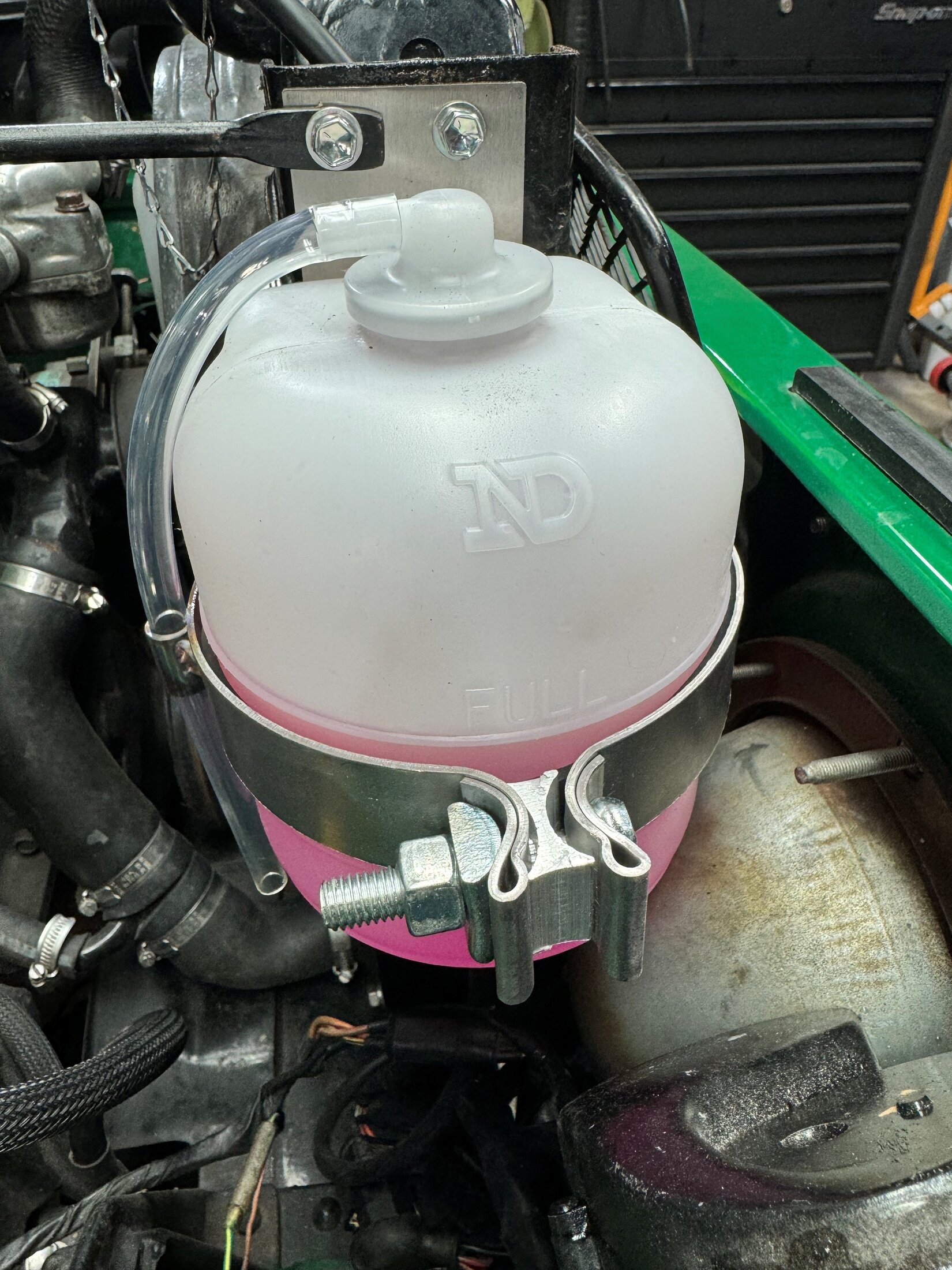

Edit: Actually I think mine would mount like how @Green Bean has that one.
So this is what I need to keep my garage floor dry! Well, this and maybe a front seal.
Do you have any additional pics of them mounted other than what is on the site? I’m not sure mine would mount the same way as the pics in the listing.
Yup! Just like @Green Bean posted. :)

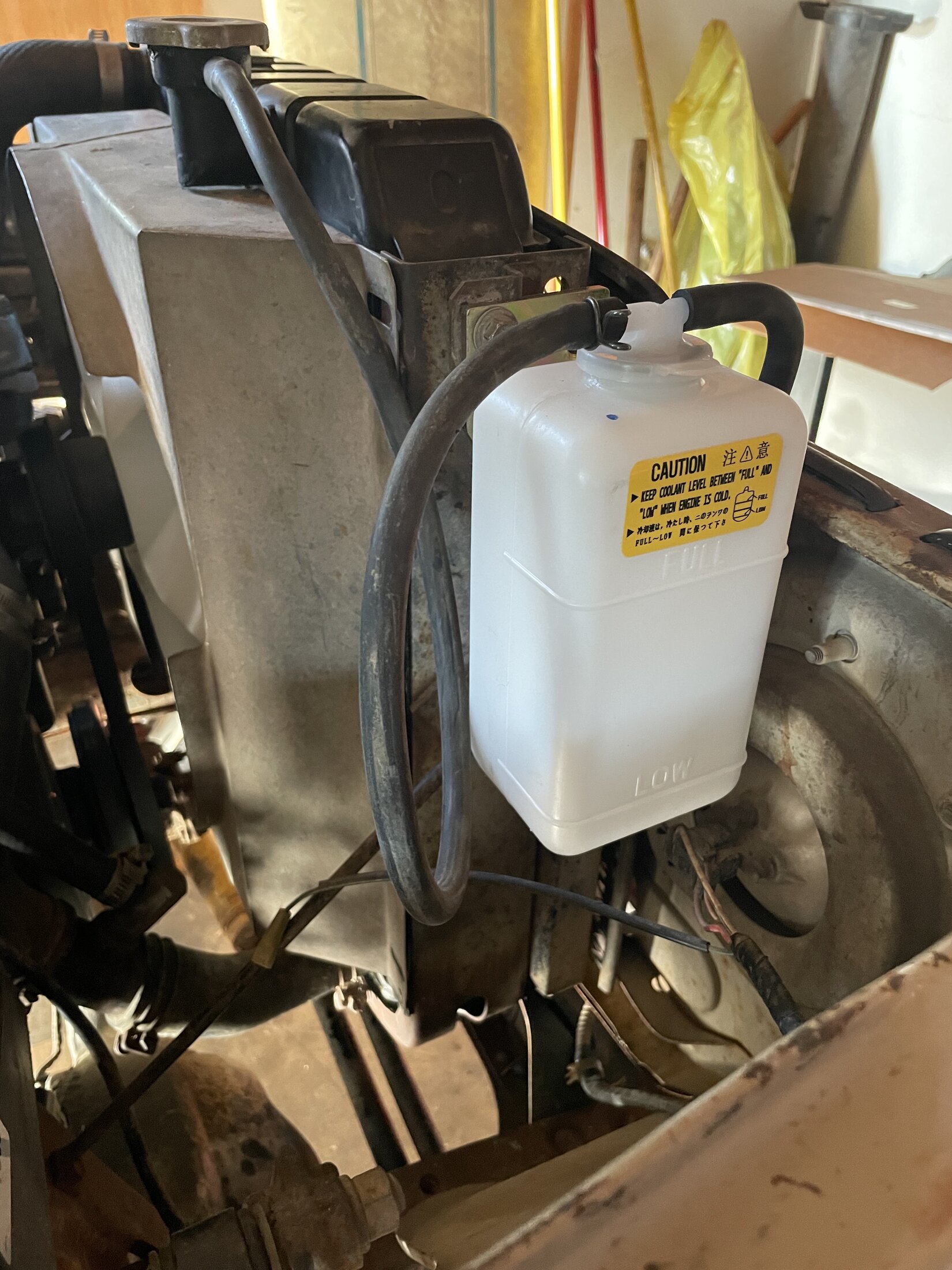

I was partial to the factory round bottle for many years , and managed to collect over 30 of them before the reproduction ones came out. Then @ToyotaMatt came out with a clean compact rectangular one that I liked enough to offer for resale. I think @majdomo just posted a picture of his install a week ago.

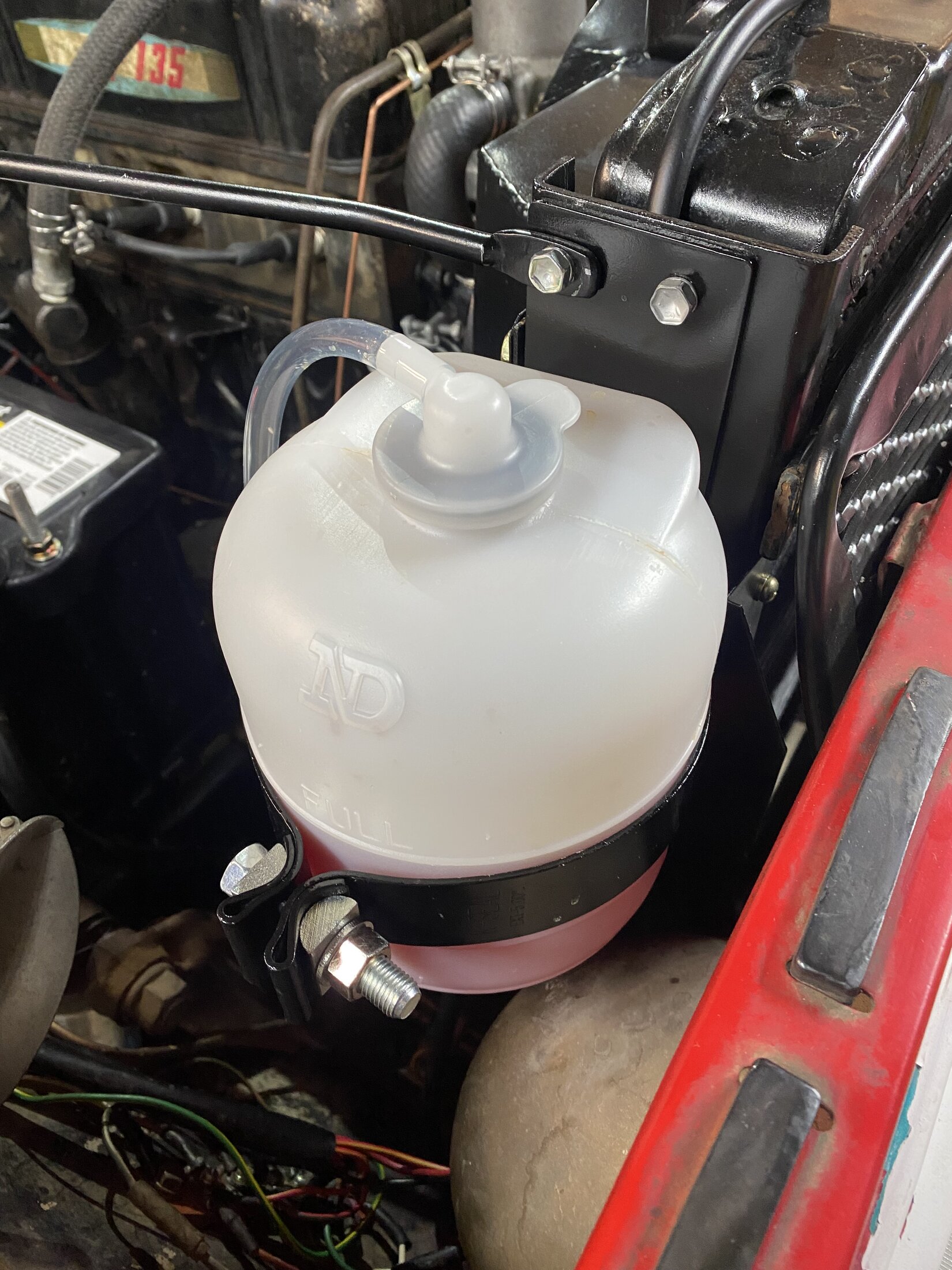

Tank installed on my '72 @65swb45 @ToyotaMatt! Comes with a bracket to attach to the rad support.

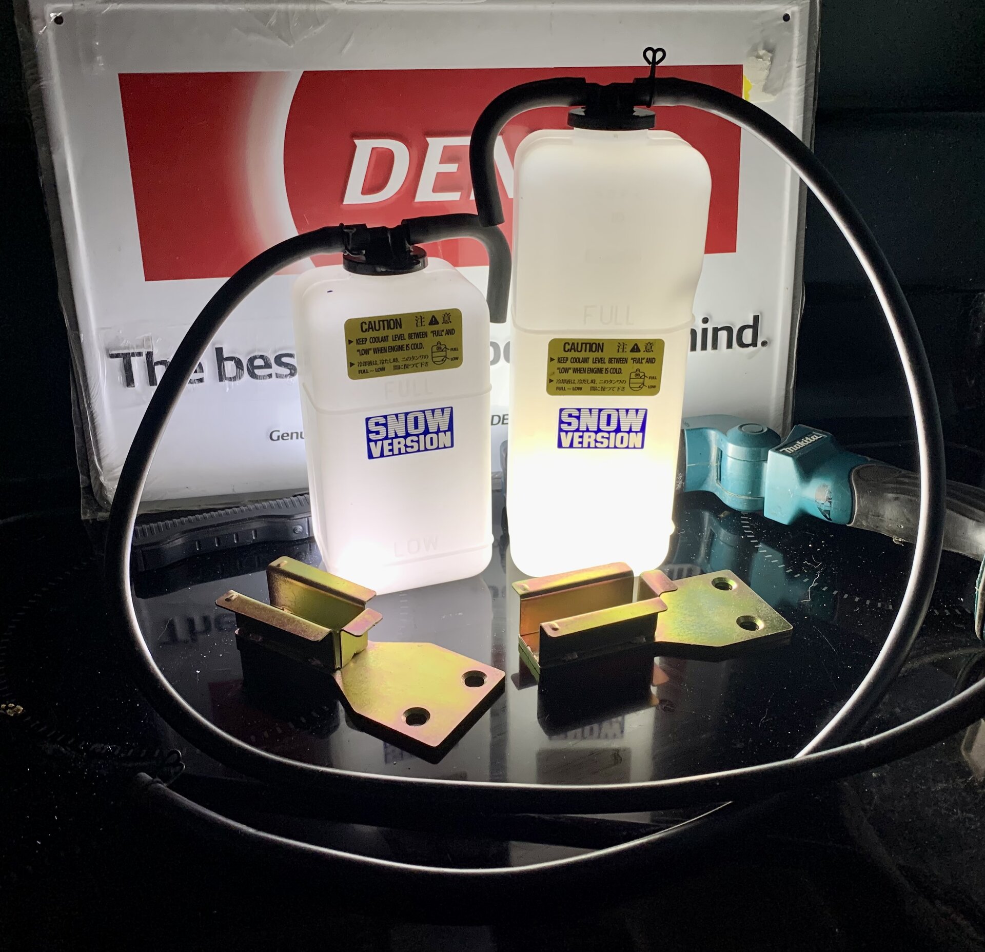

my OEM genuine NipponDenso little buddy now has a a taller brother
our same exclusive period Correct Gold Zinc plated “ drop down bracket “
this rascal has more Fluid CC to the HIGH Mark then round bottle above by a notable bit … :wrench: :wrench: :wrench: :wrench: :wrench:
And
Made in JAPAN as Always …

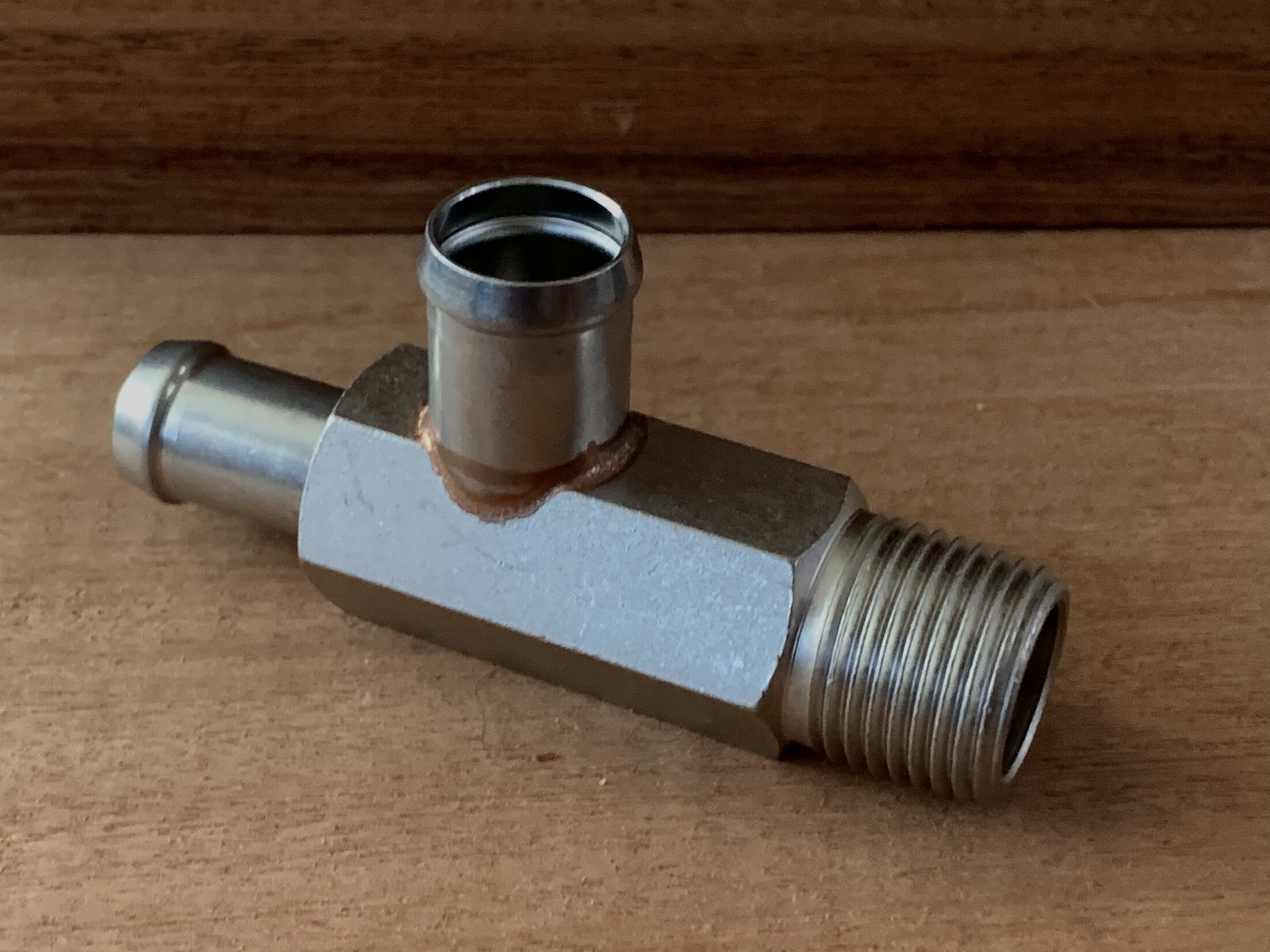

as we speak every bodies solid mud buddy mr green bean and also uncle mark A have this little new rascal below , en-route to evaluate and install , and report back here on how the shoe i de-designed fits ..... :wrench: :wrench: :wrench: :wrench: :wrench:
NOTE : ONLY the shut off valve ...
m

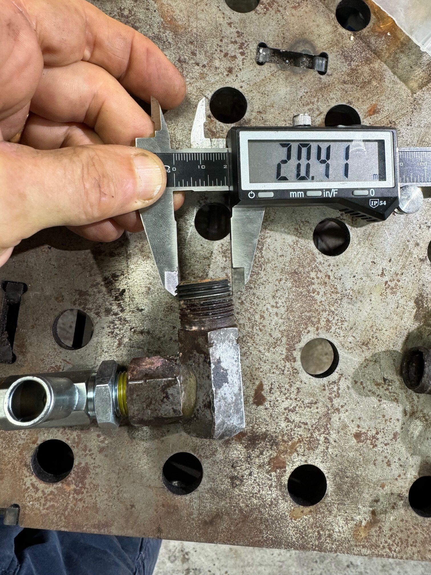

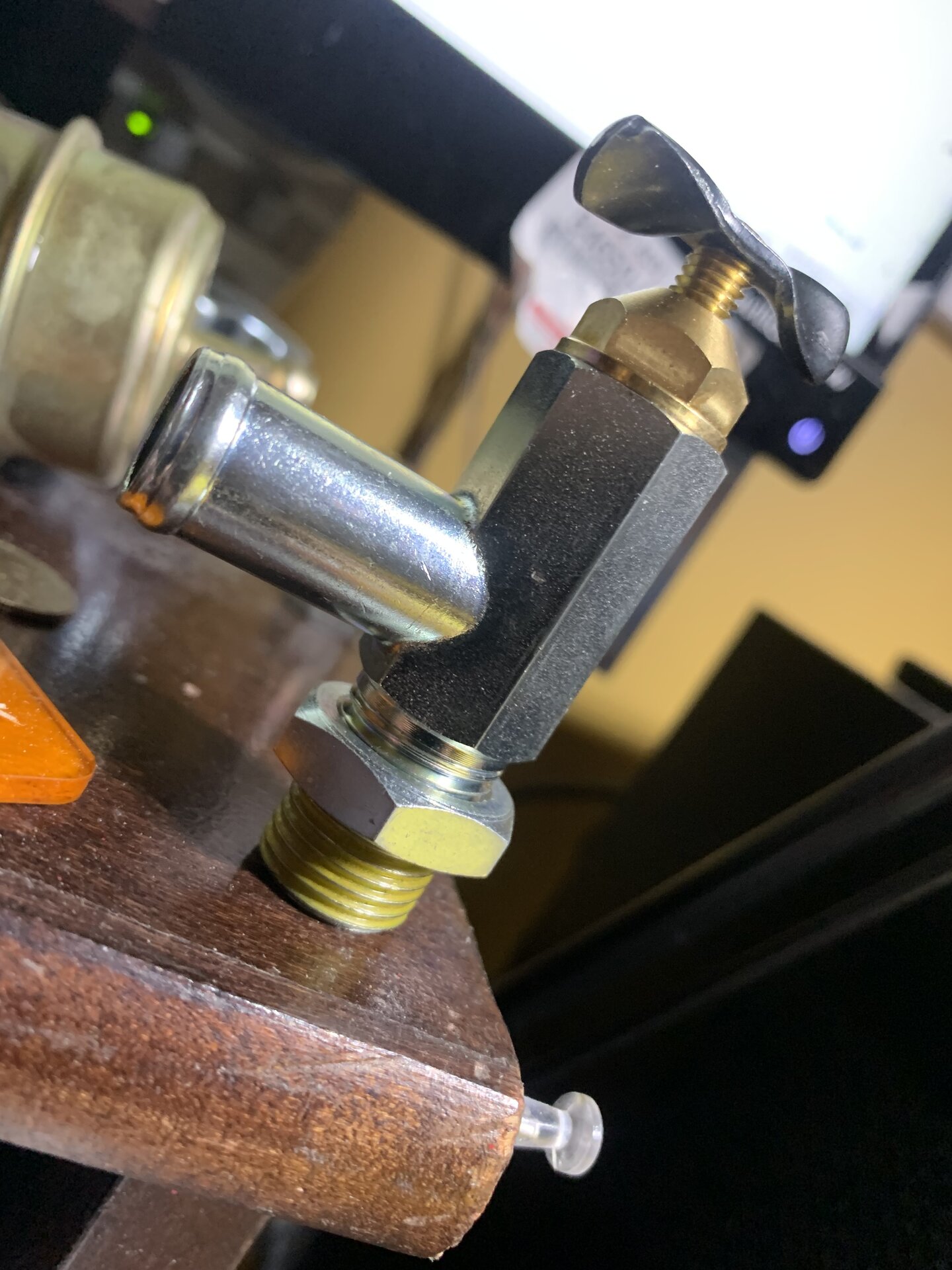

@ToyotaMatt I have an early heater shutoff valve tech question: What size and pitch are the threads for the heater shutoff valve and accompanying 90 degree fitting that screws into the head adjacent to the temperature sending unit? The threads for the OE shutoff valve that screw into the 90 degree fitting are different (smaller) than the thread size that screw into the port on the head.
OE Heater shutoff Valve. Approximately 16mm.
OE 90 degree fitting for heater shutoff valve. Approximately 20.5 mm.

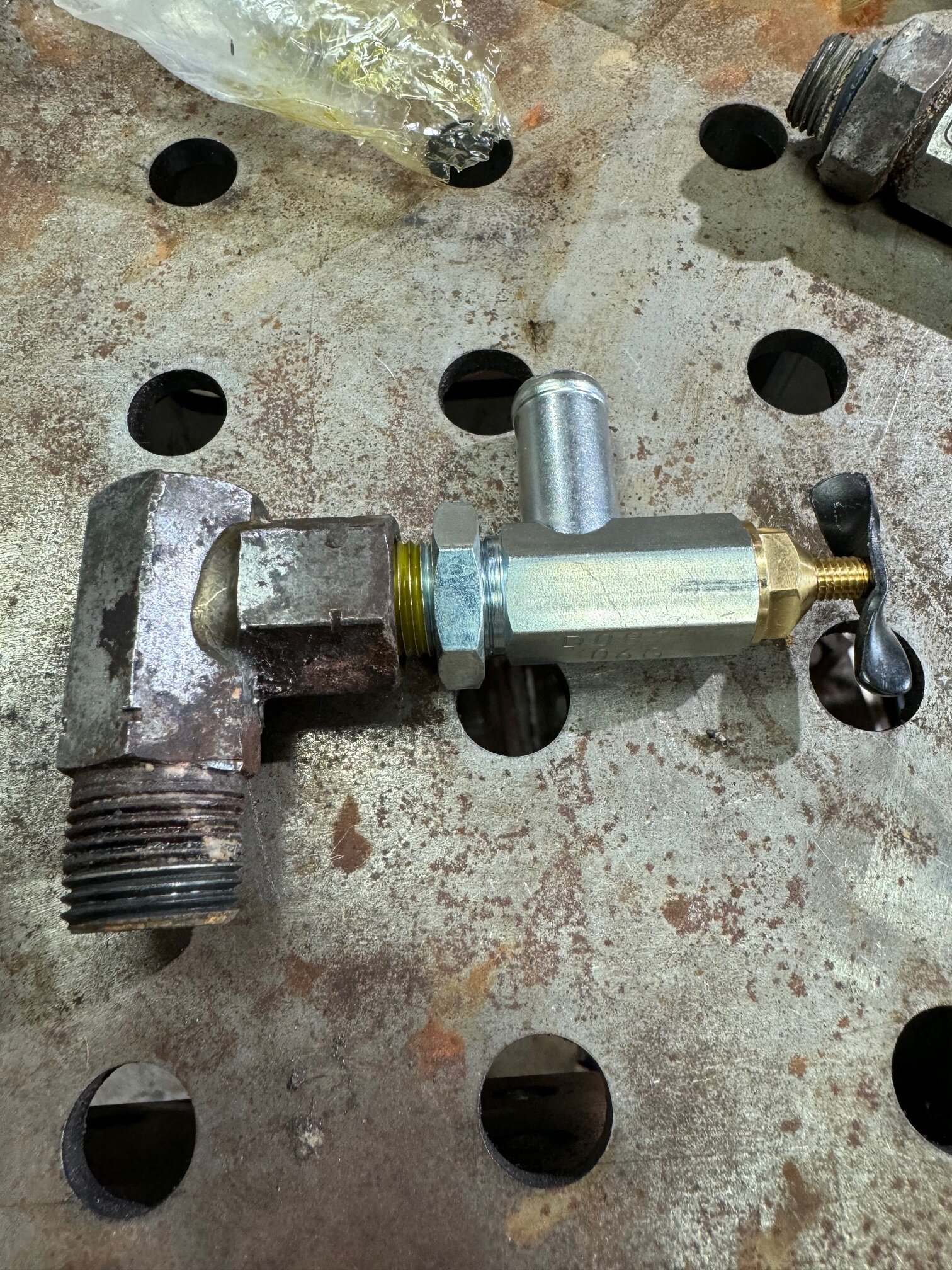

Photo of complete OE heater shutoff valve assembly.
Photo of Vintage TEQ Heater Shutoff Valve with OE 90 Degree Fitting.

oh me .......... oh my .........😮
i totally forgot Mark , you got the initially proto-type by mistake for this latest one
i will say mark ..........
that one is " different " then the one in the mail to you now ,
PLEASE tie a red-tag on it and set it to the side ,,,,
it will NOT be a Land Cruiser application use part ,,,,,,fyi
but please do NOT toss it i need it back for my reference specimen and study use ,
this is how good things come into the world of new things in my world ..... , .there are a few steps along the way , to make them happen .....this is / was a needed step ......:D :wrench: :wrench: :wrench: :wrench:
