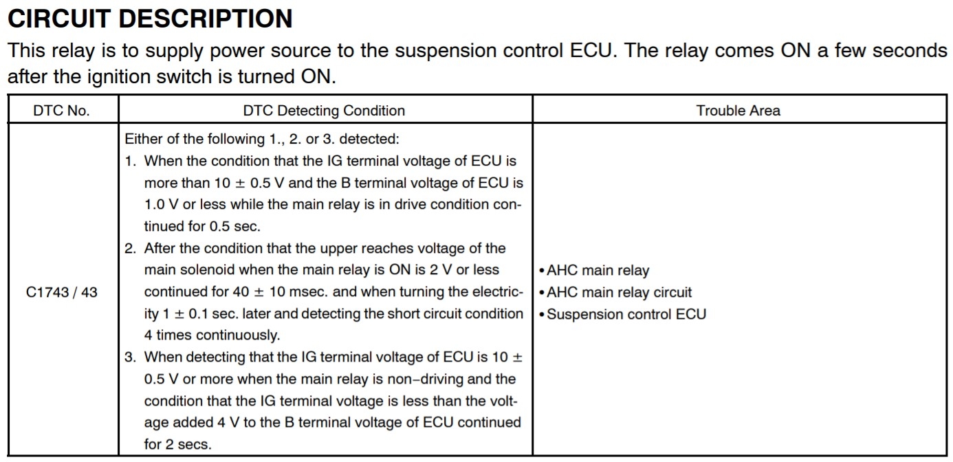

The FSM-defined “DTC Detecting Conditions” are complicated and it is not yet clear (at least to me) whether or when a DTC would be recorded, given the voltages described by @ParaJake. Maybe this is getting a bit academic! The problem is pretty clear.
Actual IG Power Source Voltage around 12.7 volts while driving (12.3 volts in test at Post #13)
Actual +B Power Source Voltage around 1.5 volts while driving ( 3.0 volts in test at Post #13)

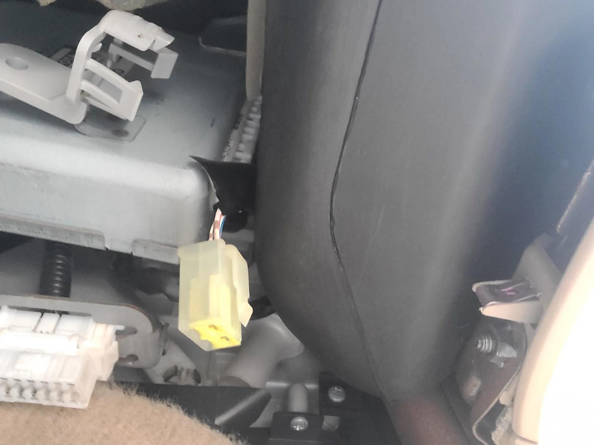

Did a quick check and sure enough, the main relay is missing. I found the plug tucked up a little higher in the dash. I'm assuming this 4 prong yellow plug is where the relay should go?
@ParaJake yep, that looks like the correct connector.
That might explain why none of it is working. I did perform the manual active test with the paperclip in the DIAGNOSTIC plug under the hood. I was not getting any movement or noise from the motor/pump. Does this mean there are problems other than the missing relay?
Nothing will work without the relay. The power to the ahc pump motor goes through that relay. Directly from the 50 A ahc fuse, through the relay to the motor.
I suspect we're staring at a previous owner's improper attempt to disable AHC. :facepalm:
