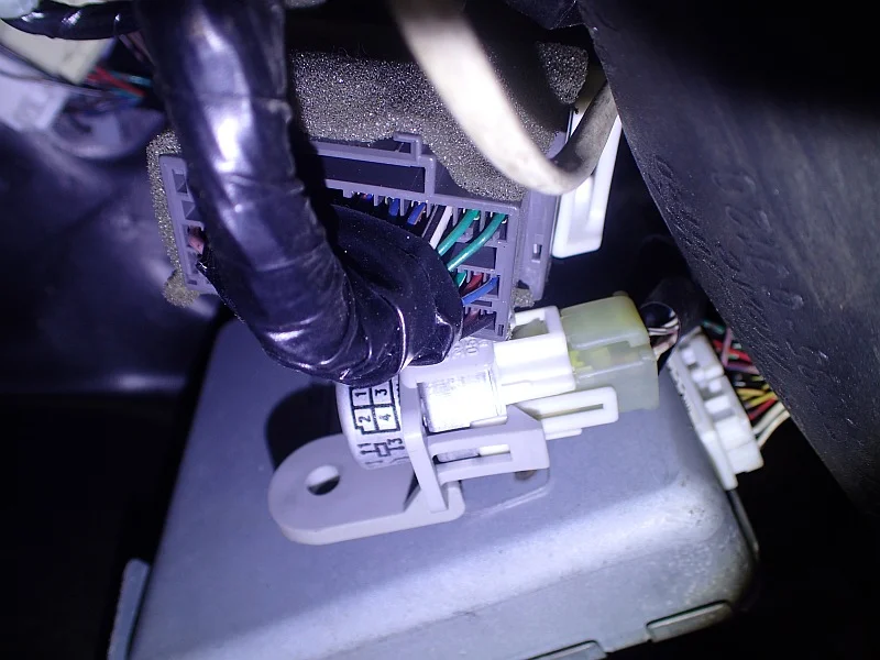

I'm having a hard time finding the AHC Main relay under the dash. Looking under there in an extremely awkward angle, there are no relays that are jumping out at me. A LOT of wires and plugs, but no relays. Is the grey box on the far right of this pic the suspension control ECU?
Looking for AHC Main Relay -- pic by @ParaJake
I’ve never had to locate the AHC main relay myself, but I agree with @IndroCruise that the gray box is the ECU and that the empty bracket looks suspicious.

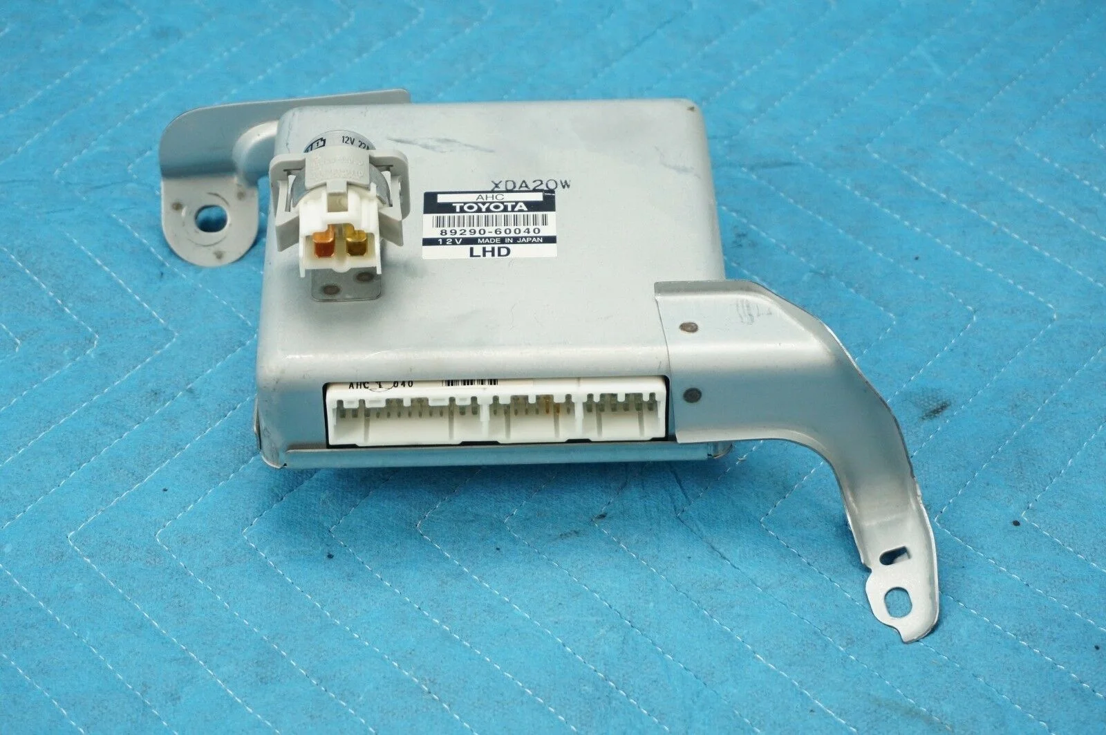

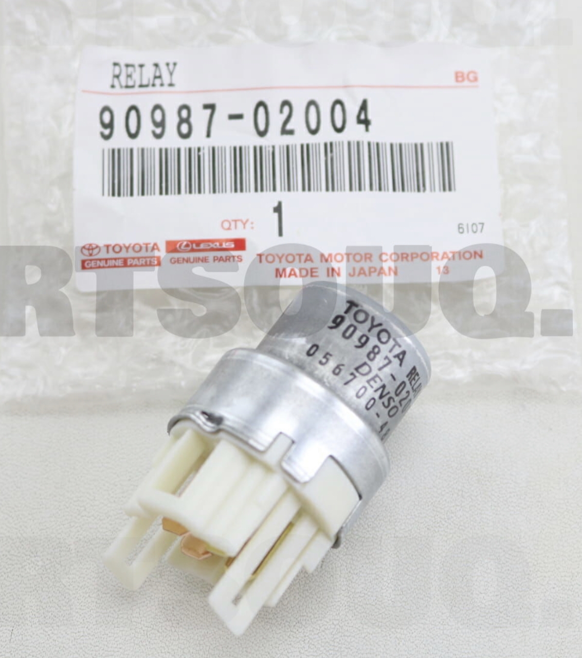

I found an ebay pic of the ECU and a Partsouq pic of the AHC main relay and it looks to me like the relay is the part that’s missing from the bracket. Are there any empty connectors nearby?

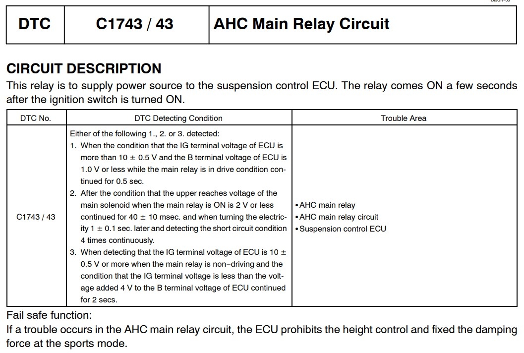

After looking at the attached troubleshooting guide, it is clear that the AHC system is not going to work without a healthy working AHC Main Relay! There probably is not much point in proceeding with the other tests mentioned in my previous posts until a satisfactorily working AHC Main Relay is in place.
It seems likely that the vehicle is in the 'fail safe' mode described in the image below. The vehicle may have other problems as well -- and a combination of faults is a possible cause of no DTC's being displayed -- although I must say that I am surprised about this.
Obviously, there are some unknowns in the previous Owners' history with this vehicle. This relay did not just fall out of the bracket. It seems possible that there has been previous work on the relay or the ECU and the relay has been dislodged or removed.

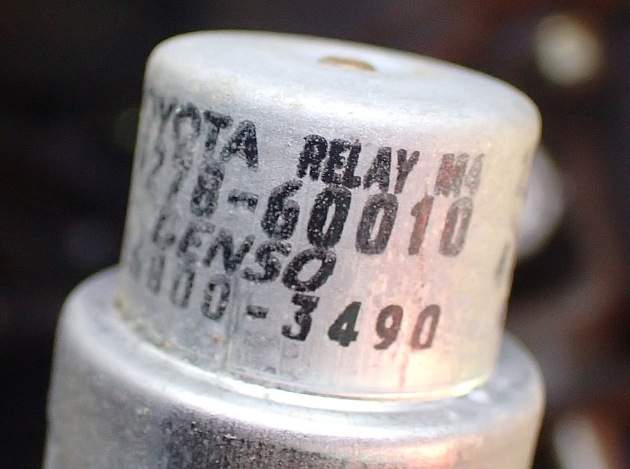

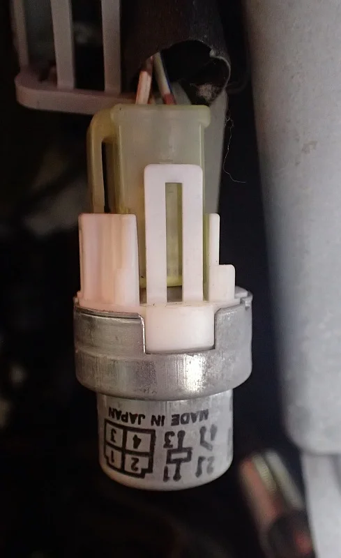

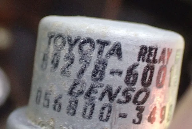

Mystery indeed. Had to have a look under the dash - snapped a few pics of the relay. The part number appears to be 89278-60010 on my 2004-july prod hdj100.
I also found a russian site where someone took apart the relay, which might become valuable if Amayama is right in that the relay is not made anymore.
Google translated russian TLC site
Great pic. Very useful. Thanks @uHu. I haven't taken a look yet. I wonder, if it is disconnected, if that would throw a trouble code. And if it is disconnected, I wonder what benefits somebody would have by removing the relay. These pics at least give me a plug type to look for tucked under the dash.
EDIT: I did find the part on Amazon using the part number. It says temporarily out of stock. I wonder how "temporary" it will be out of stock.
The part was in stock for my ‘03 on Partsouq, but you should double check the PN using your VIN before ordering anything.
I will definitely do that. But I'm going to try to find the plug first. Maybe the relay is intact and on the vehicle but tucked up under the dash in a less than obvious place.
