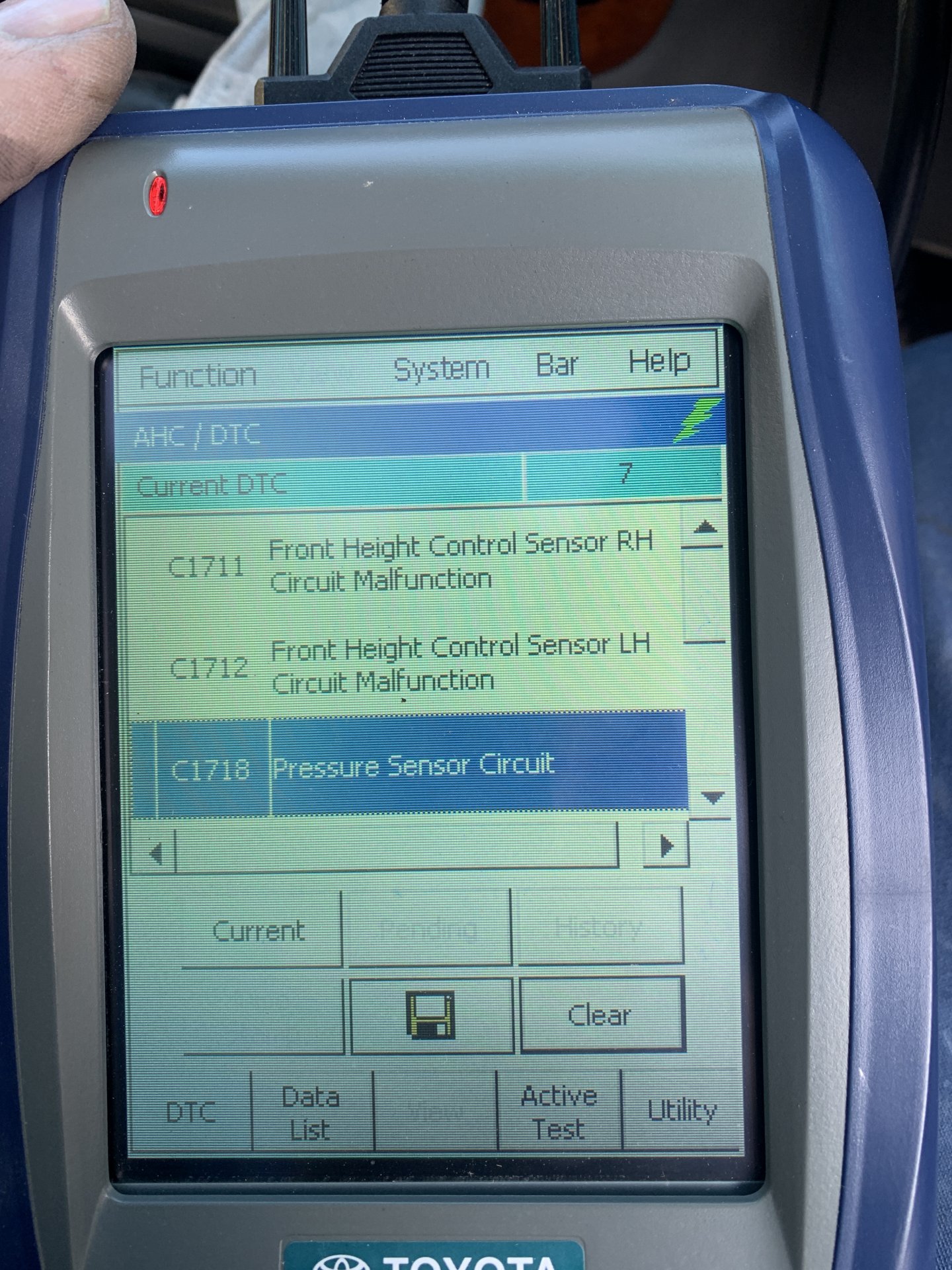

If the relay is not getting any power, and fuse is intact, I would connect the Techstream and see if the AHC controller is even active/alive?
I get
C1711
C1712
C1718
From Toyota intel tester 11
Providing I am using correctly

Looks like it can't read the pressure sensor or the front height censors. Unless you have recently disconnected a bunch of plugs on AHC, I would worry if the AHC controller got toasted due to reverse polarity on jump starter.

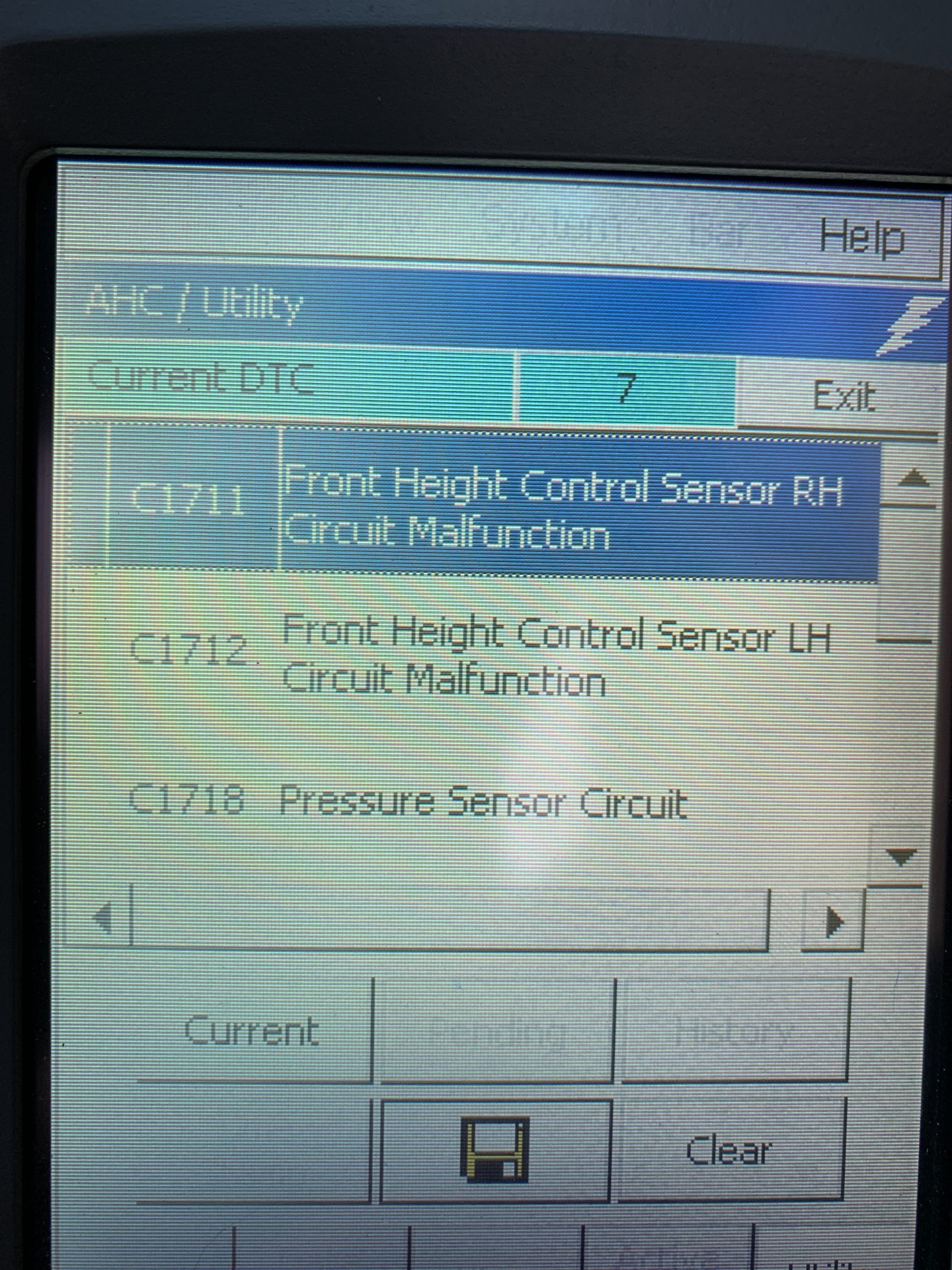

You've got *7* DTC, not just 3. The screen shows 3 at a time, but you appear to have 7. I suspect some sort of electrical fault. Try clearing them and then checking. If 7 still exist, post all of them up. Maybe something will pop out at us.
Yes I can see that there is 7 now
I pretty sure I tried to clear but wouldn’t let me
Will plug in again see what else is there are should they be on that screen shot i sent
I’m just new to using the diagnostic

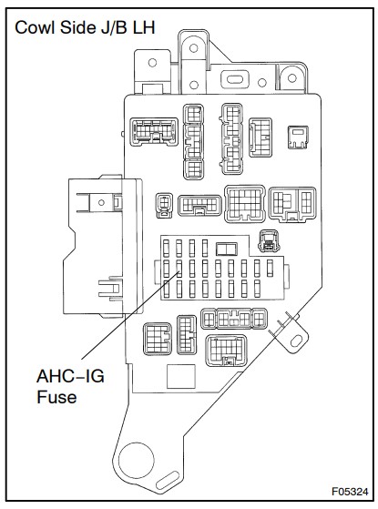

Late Edit: Pic of location of AHC IG fuse added.

It is also possible that an electrical disruption such as ‘jump starting’ may cause the AHC Main Relay to stop and show this DTC:
C1743 – AHC Main Relay Function
Some hints on overcoming this problem are found at Post #1 by @PADDO at this link:
AHC DTC C1743 - main relay - https://forum.ih8mud.com/threads/ahc-dtc-c1743-main-relay.914138/
(Refers to AHC IG fuse which is found here -- behind cover in Left Hand footwell):

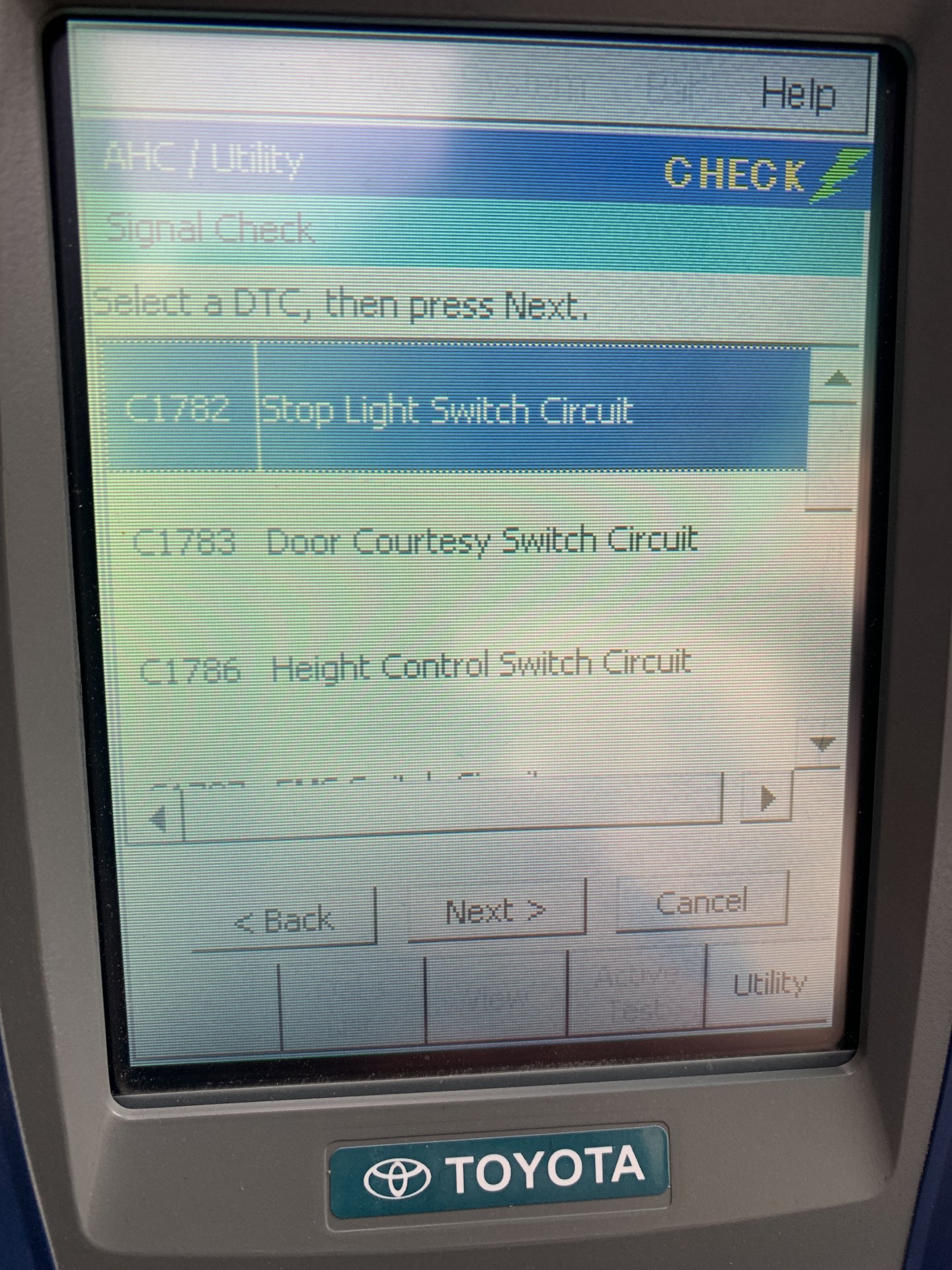

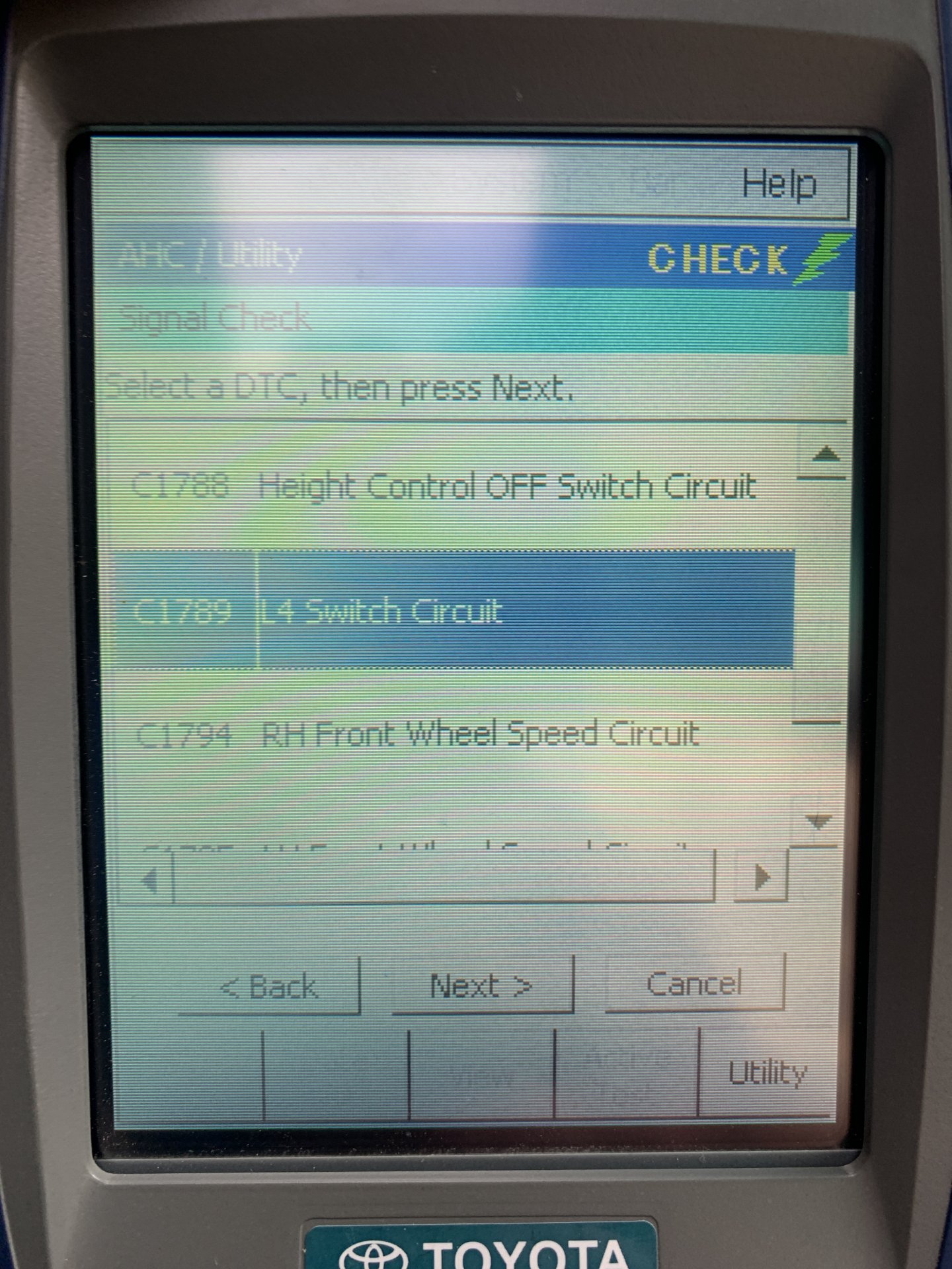

Hi connected diagnostics and got same faults but as you said showing 7
But can’t find them but got some photos of what I found also every time I try active test diagnostics freezes and have to start again

Hi any thought on diagnostics phot I sent

@Trb – to move forward, some response is essential to the feedback previously provided to you.
Can you please confirm that you are operating the handheld tester with all vehicle doors and rear hatch closed?
Diagnostic Trouble Code (DTC) C1783 Door Courtesy Switch is shown in your first picture in your Post #13 above. This suggests that a door is open. If a door or rear hatch is open, the AHC system will not work.

Thank you will try go through each section you mention thanks terry
hi there just found some missing docs also must of had door open when attempting active test as fault not there the faults that are there won’t clear all fusses now checked all good will continue to go through other checks thanks terry
