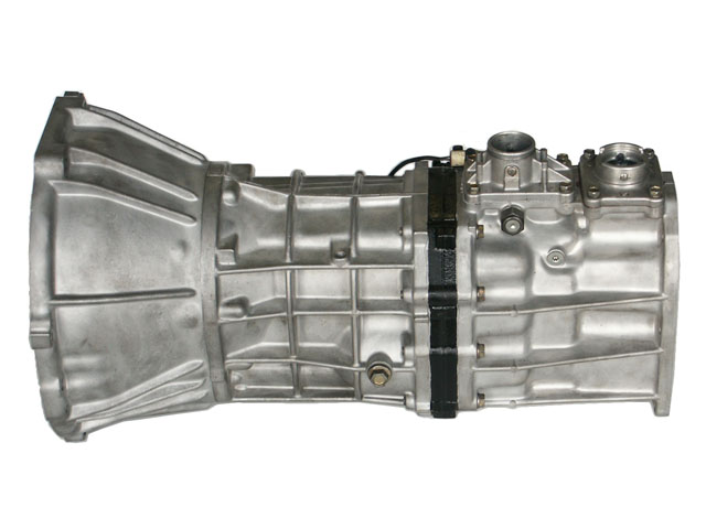

The R151F transmission I am most familiar with is the Turbo trans that came in the 1986 and 1987 Turbo Pickups. This trans has a bellhousing that mounts to the 22R(E)(T) series engines and a tailhousing that mounts to the RF1A gear-driven transfer cases commonly found in the 1979 - 1995 Pickups. And it has the more desirable 4.313:1 1st gear ratio for rockcrawling.

Do any of these other trucks use the RF1A gear-driven transfer case? Or is the R151F/RF1A combo only found on the 1986 and 1987 Turbo Pickups?

But I am asking if there is an additional source for the 22R/R151F/RF1A transmission combo besides the '86 and '87 Turbo Pickups? Specifically, an R151F with a RF1A tailhousing.
For example, did the Land Cruiser Prados ever come with a 22R engine, R151F transmission, and RF1A t-case combo?
The reason I am asking - the R151F Turbo transmissions are difficult to source, but the R151F Prado transmissions seem more common. I want an R151F with the lower first gear. And I want to run RF1A t-case(s) without an adapter.

The r151 tailhousings are floating around. I think the 86-87 22ret USA and Canada models were the only market to receive them with an RF1A adapter. I haven't looked recently but $100 was the going price a couple years ago. You can swap the tail housing on most of the pre-1996 R151 transmissions listed above.
I think you can still buy the lower 1st and 2nd gears so might not be all that difficult to swap those on an R150. Might be cheaper than an import transmission
I actually sold my lower gear clusters in my R151F because they sucked behind my swapped 3.4 on the street. Just didn't match the power band. I put the 3.0 V6 R150 gear set in. I don't regret it one bit. Sold the bell housing as well. Made enough to buy a rebuild kit and some Marlin Crawler upgrades.

I "think" the lower first and second gear were to compensate for turbo lag on a 4 cylinder engine. I originally swapped it in behind my built 22RE. It was an advantage on the trail and "ok" on the street. At the time my truck was my daily driver. It was just too low and too far apart for commuter driving every day. It was like using granny gear all the time to take off, yet 2nd was too high. I had 5.29's and 35's.
Just food for thought. So you might be better off with the late R150 that mates to the 3.4 and just get the adapter to run the RF1A case?

The lower 1st gear (4.313:1) gear set is available only through a used 1986 or 1987 Turbo Pickup transmission. There are no aftermarket or alternative sources.
The gears are still available from toyota. But the countershaft is NLA. I don't think the R150 countershaft will work but I might be wrong. Is that R151f specific?
Hoping someone can answer me trying to resurrect this thread. Mostly interested in the non-US market (HZJ, Prado, etc.) R151f and how easy it would be to mate to a 3.4. I know I'll need a 3.0 R150 bell housing and fork/throwout bearing but I don't know if there's anything else (input shaft mostly) that would need to be modified. Mostly interested in the non-US R151f because they came with part-time land cruiser split cases from the factory.

Offset, passenger side drop. Using locked fzj80 axles which is the main draw of the split HZJ case/R151f combo. Just wanting to know if it's as easy to bolt up to a 3.4 as the 22RTE R151f's from the US (3.0 R150 bell housing and clutch bits etc.).
@aztoyman said it best: "I actually sold my lower gear clusters in my R151F because they sucked behind my swapped 3.4 on the street." This is why I got the extra one owner complete R151f I HAD for $150. Yes, I got the 22rte bellhousing, R151f transmission, shift levers, and transfer case for $150. I can say from experience, the R151f behind a solid 22RTE engine sucks too! Sorry, not for sale. If you really want one, they turn up.
Depending on the age of the transmission you’ll either need a 3.0 or 3.4 bellhousing. The early models used in the LJ7x, KZJ7x and PZJ7x LandCruisers used the shorter input shaft (same as the 3VZ) and a shorter transfer adapter, while the later 1999+ HZJ7x versions used a longer input (same as the 5VZ) and a longer transfer adapter. Also, the 1990-1993 LJ7x used the R150f, whereas all the other models were equipped with the R151f. Almost all internal parts are different between the 1999+ HZJ transmissions and the others, coinciding with the 3VZ/5VZ changeover in the US spec R150f.

Ok that is actually really good to know. The R151f I'm looking at is from a 2007 hzj77 so I guess I should find a 3.4 bell housing instead of a 3.0?
