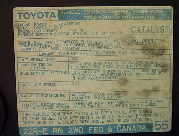

Hi folks,

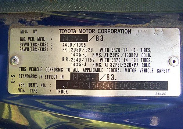

I have a 1984 2wd SR5 truck that has the optional 22RE (fuel injected) engine - I have noticed when I'm at some websites or even some parts stores, a lot of the EFI parts listed start at '85 and go on up and list mine only as a carburetor model. I have received several wrong parts over time due to this and was wondering if it would be easier if I just say it's an '85 truck. Are they the same 22RE engine?
The sticker under my hood says:
Engine family: ETY2.4T5FBB4
EVAP Family: EV-E
Engine Displacement: 144.4 CID
E.E.C.S. : EFI/EGR/O2S/TWO
22R-EC 2366cc
