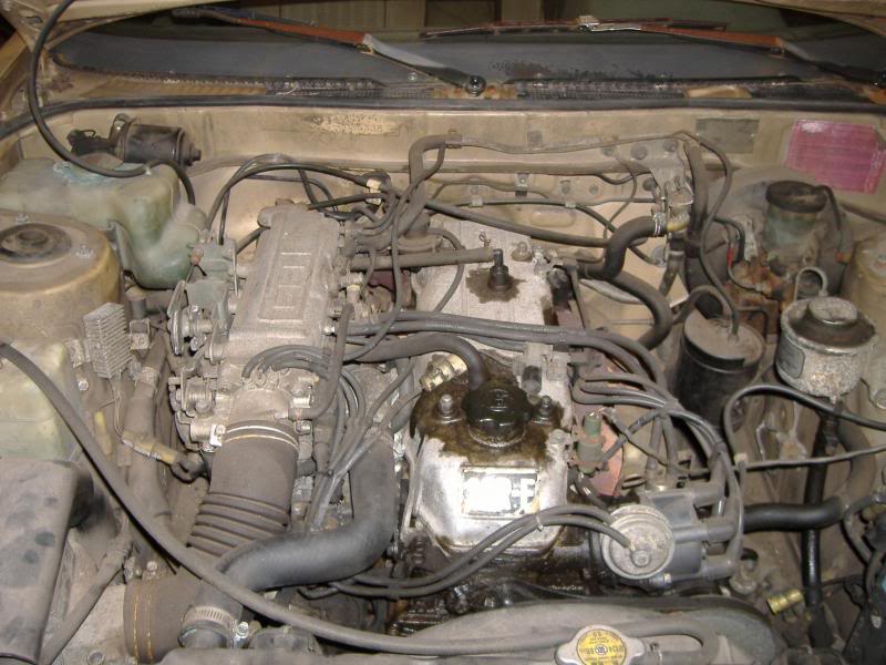

that looks identicle to the engine in my brothers 83 celica
Sure does! I was looking around on google image search and found this picture from an 84 Celica:
Looks like the same engine with the air intake and charcoal canister in different locations and a few other things
