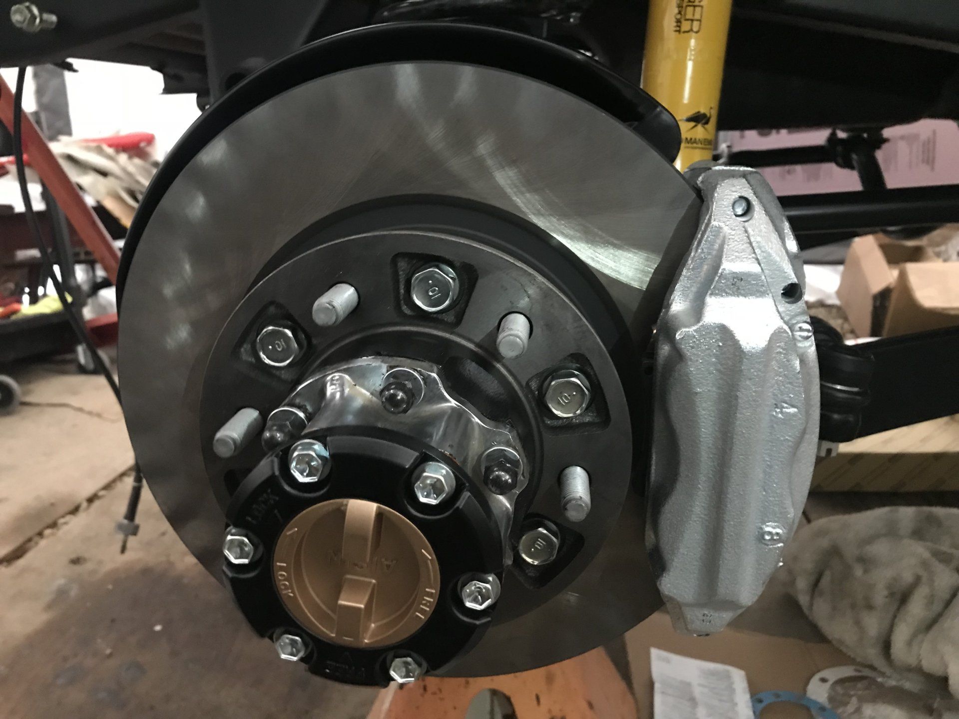

Man... what is it about freshly rebuild front hubs? New rotor, clean caliper, fresh hardware... ugh! Looks sexy man.

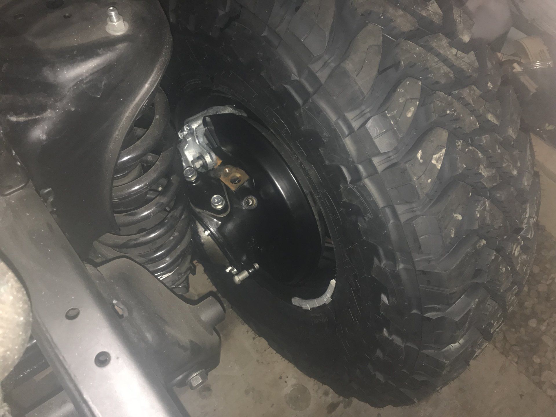

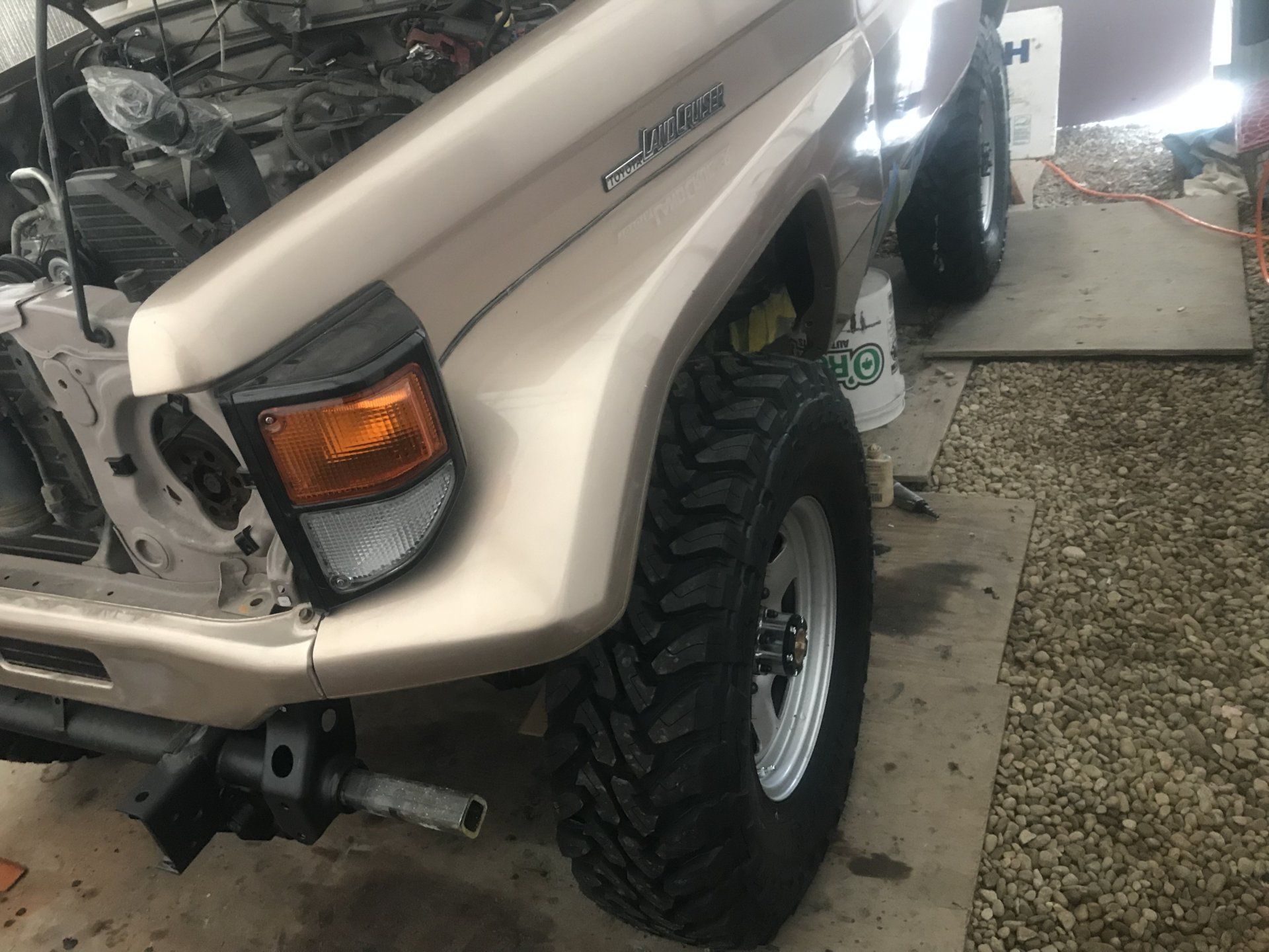

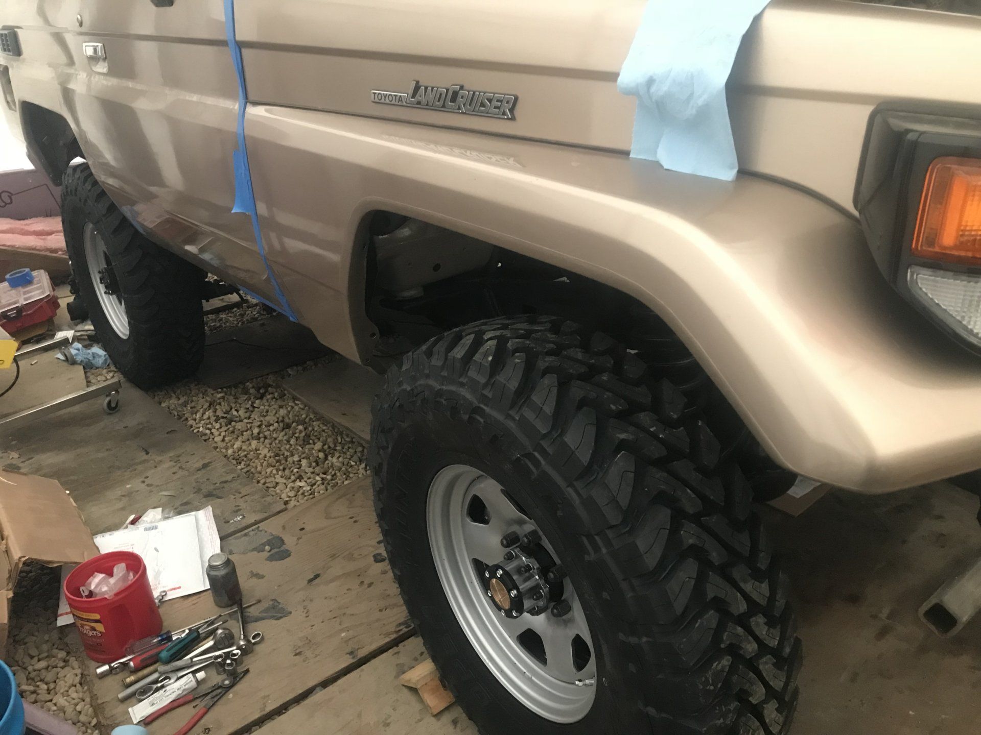

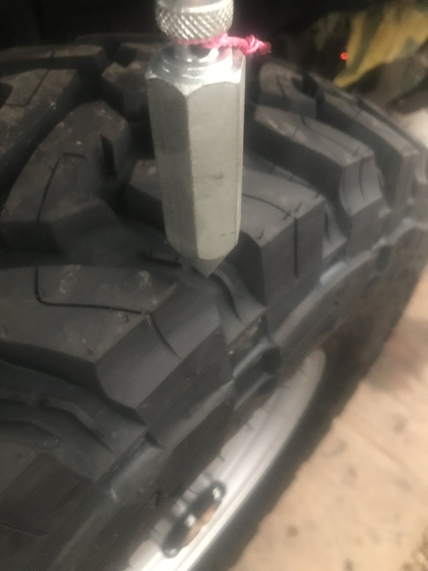

Track width in front has widened substantially with the conversion. It is literally almost identical to what it is on 2007+ 71/76/78/79 series. That is roughly 2” per side.
I knew it would be wider but how much I wasn’t sure since I have used a mix of parts and this is custom built rather than just buying say a 1999-2007 front axle housing.
I have done my research and honestly I don’t see it being an issue. If anything the truck is going to handle very nice due to the increased track. After hours reading up on Aussie forms the main complaint about the wider front track width comes almost entirely from guys running on sand. I simply do not see this truck running on sand very much in the future.
I have also spent a lot of seat time in a 2007+ HZJ76 and I didn’t notice anything about the difference in track width.
Regardless, the easy fix is wheel spacers if it needs anything. The front tires with the skinnies are dead on the front fender lip so it isn’t like the tires are outside the fenders. It is definitely noticeable though looking at the truck.

Pictures have a way of either making things look less or more than they really are. I don’t think it looks bad at all but again, it is noticeable.
So, really this conversion has made this truck a PZJ71! Added benifit, turning radius should be amazing!

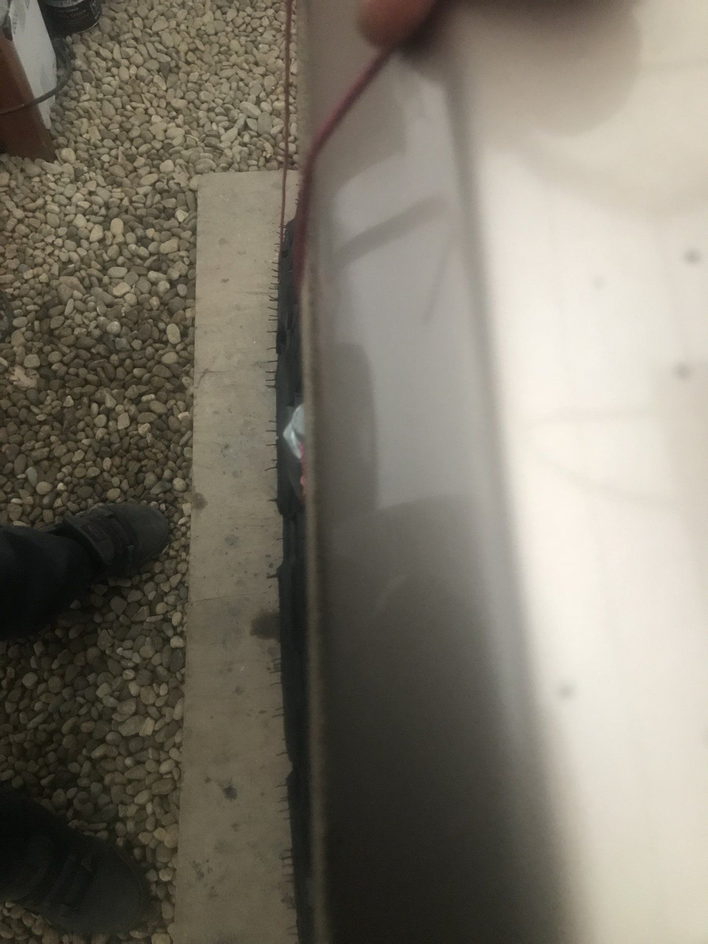

Couple more pics so you can see where the tires are in relation to the fender lip. Like I say, it’s right there, to me on the money.
1907437
1907436
1907438
Axle isn’t perfectly centered yet but it is within a 1/2”.

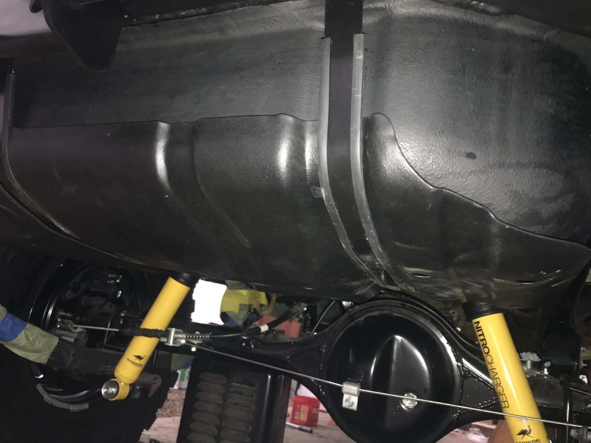

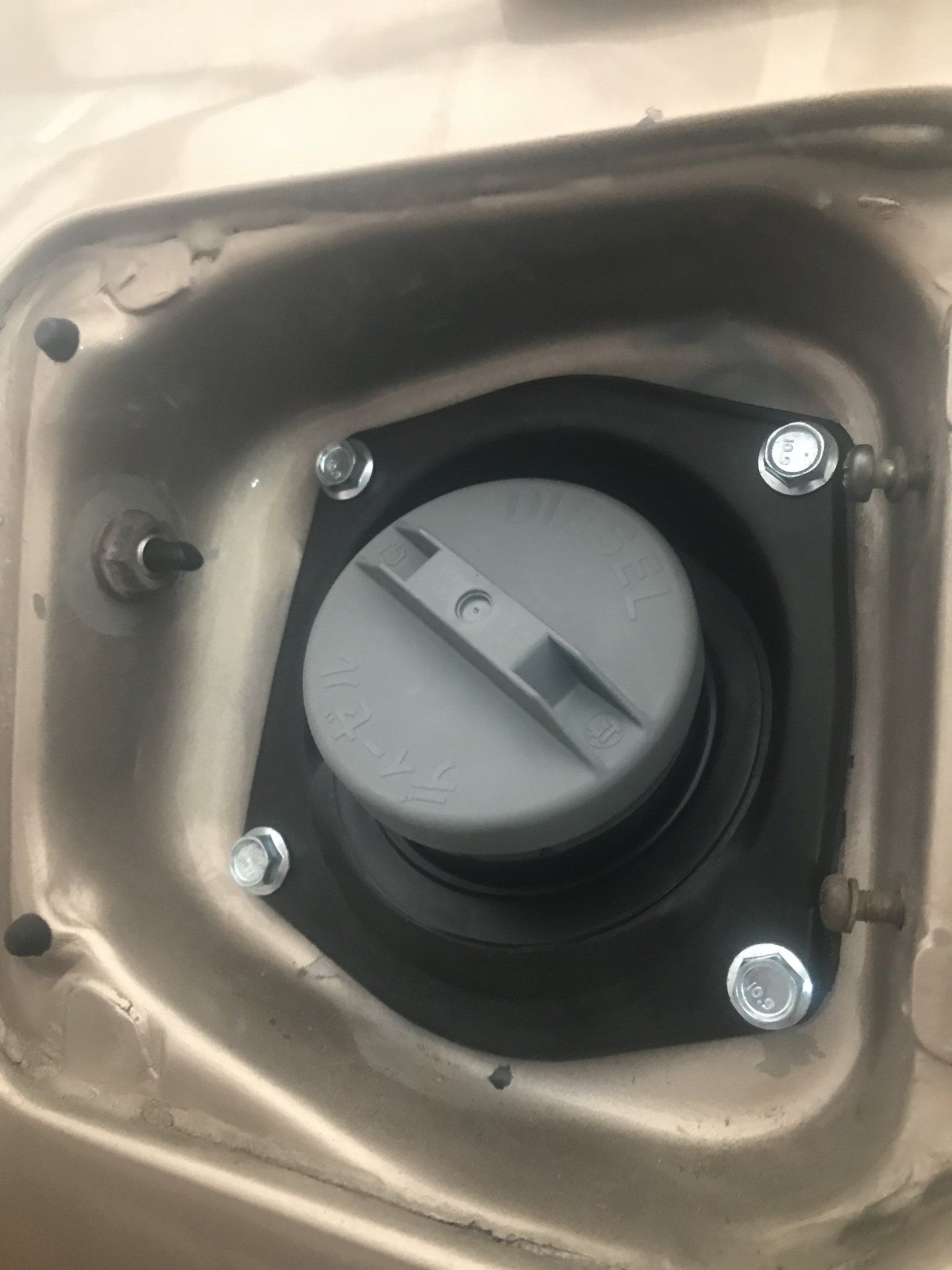

New fuel tank, straps, skid, sending unit, pickup, filler neck, cap and all hardware installed.
1909282
1909283
1909284

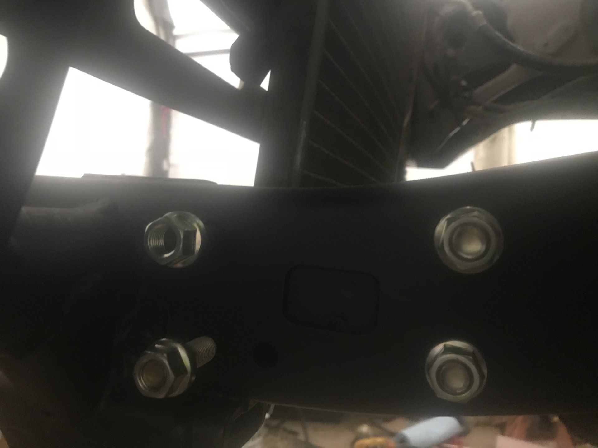

New body mounts installed. They were pretty toast but hey 29yrs isn’t bad!
1909281

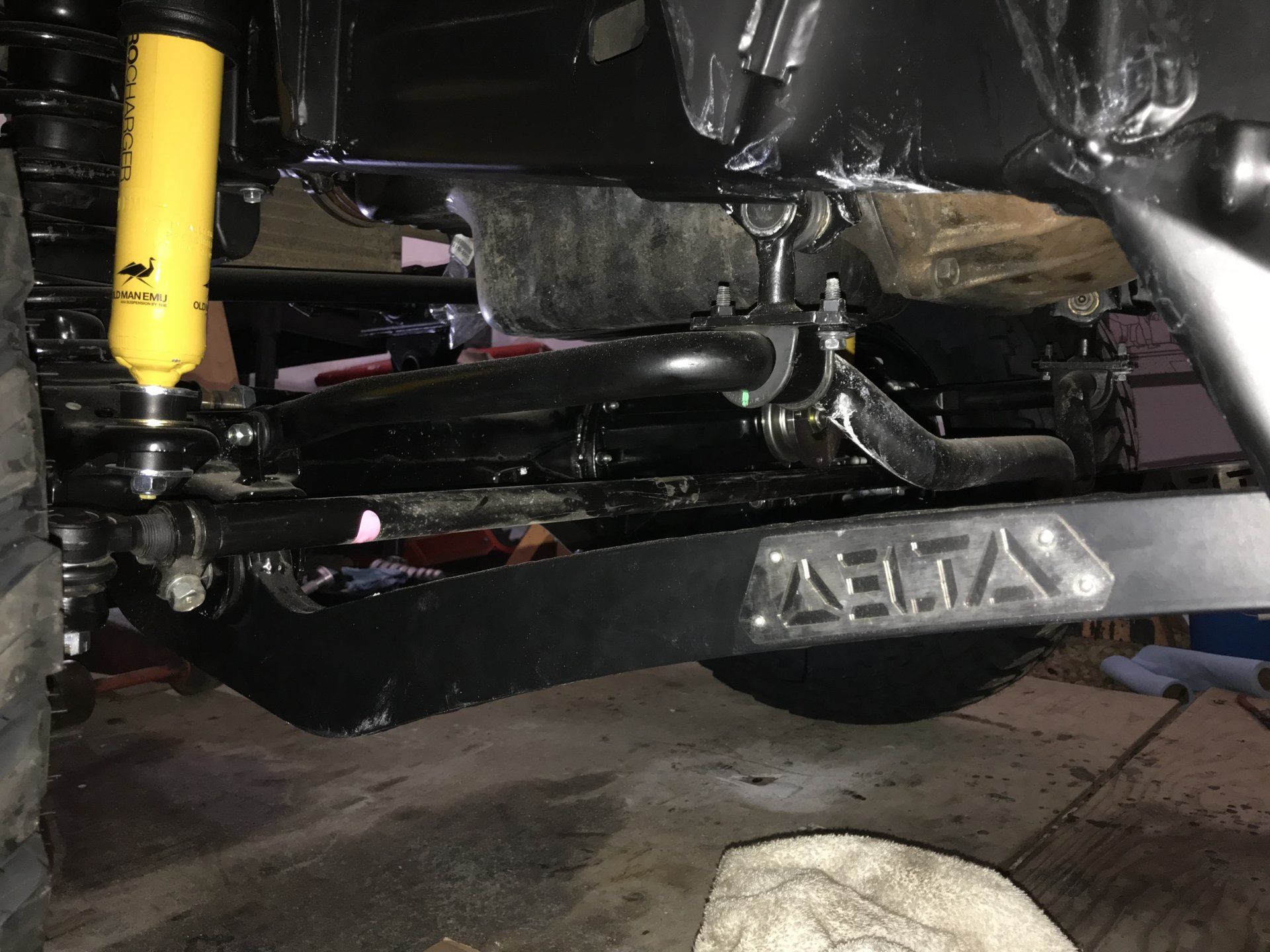

My friend Dave from over at @Delta VS stopped by today to scan the front of the Cruiser.
Very very cool software and he uses it for the CAD to build bumpers and the like.

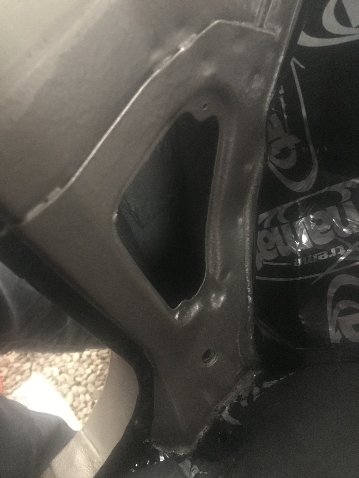

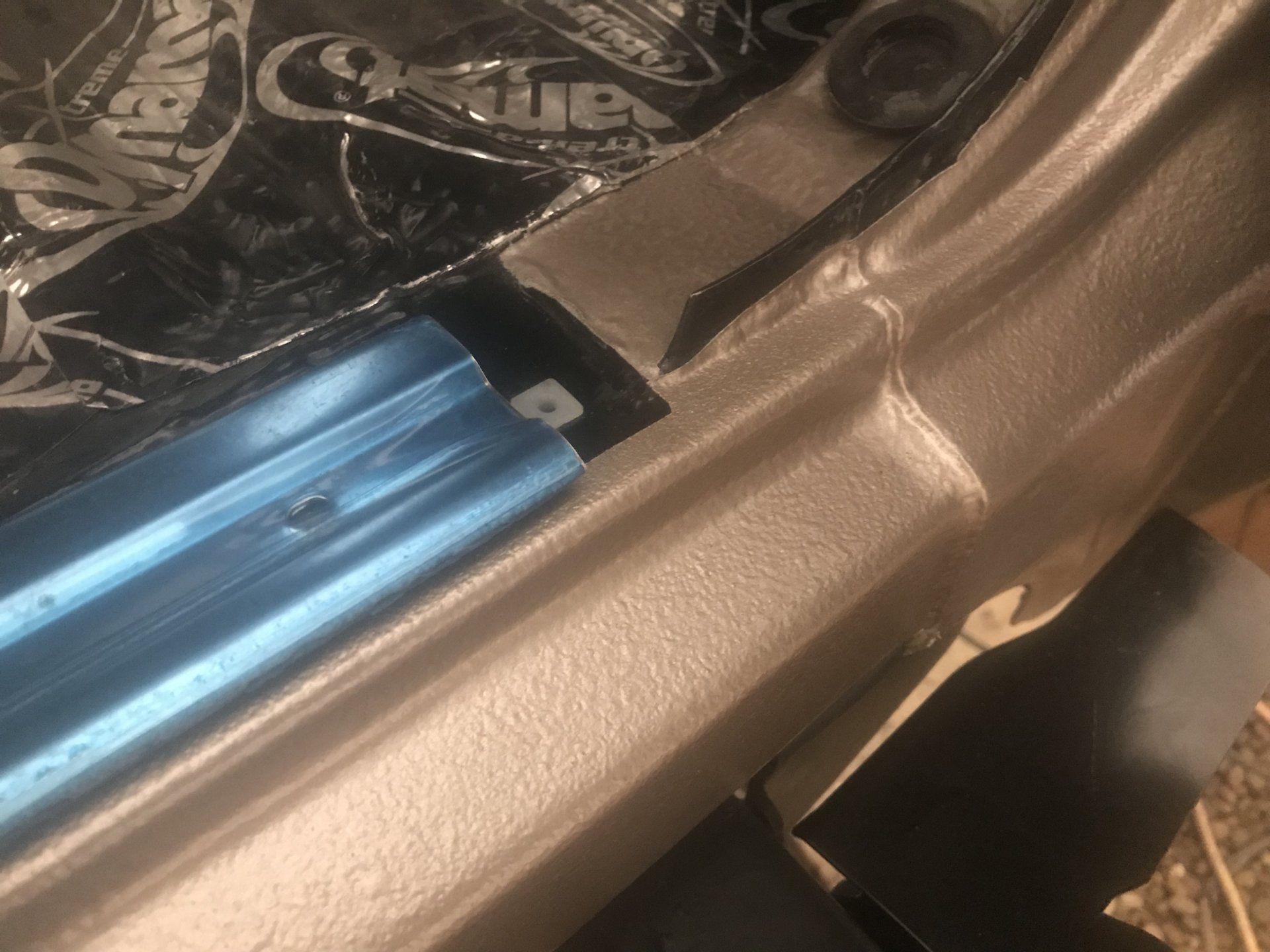

Applying chip guard to four small locations on the interior. These are high wear areas in my opinion.
1913671
Once applied I will top coat with gold.

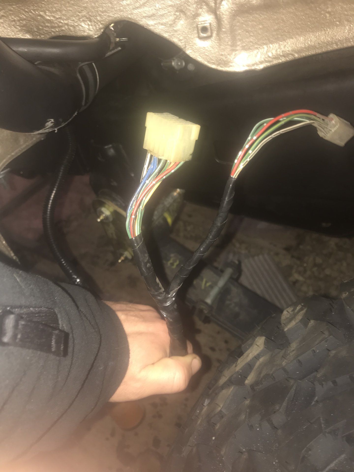

Rear wiring harness was refurbished, I unwrapped it, made a couple repairs, cleaned it and rewrapped it. Needed to spray the wax before I finished the install of the harness.

Here is the chip guard in one of the four interior locations. The cover I also coated. As mentioned before the owner will be stuffing all kinds of gear in the truck, he likes books and crannies for this. So I did this to keep the scratches and chips to a minimum.
1916016

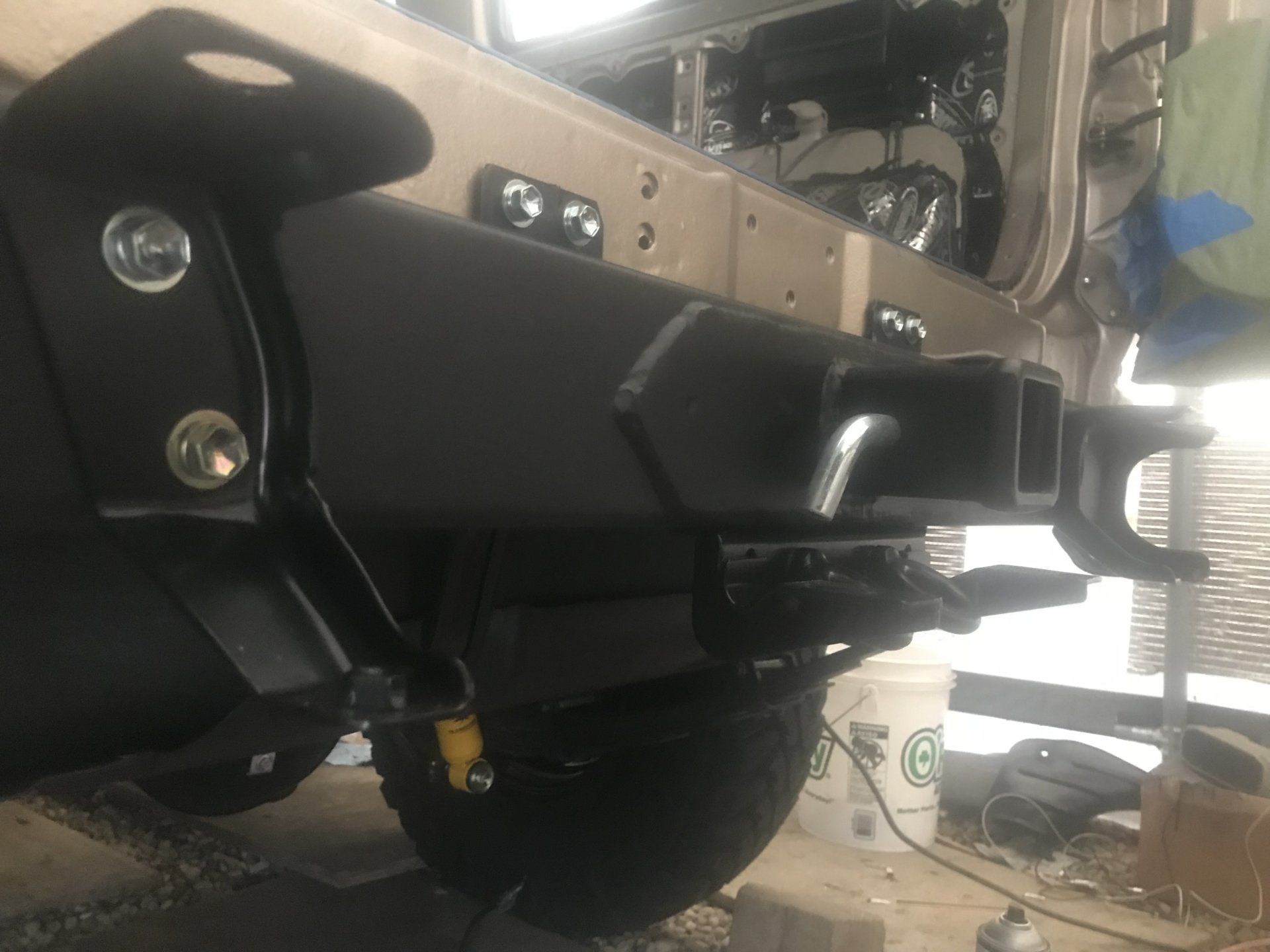

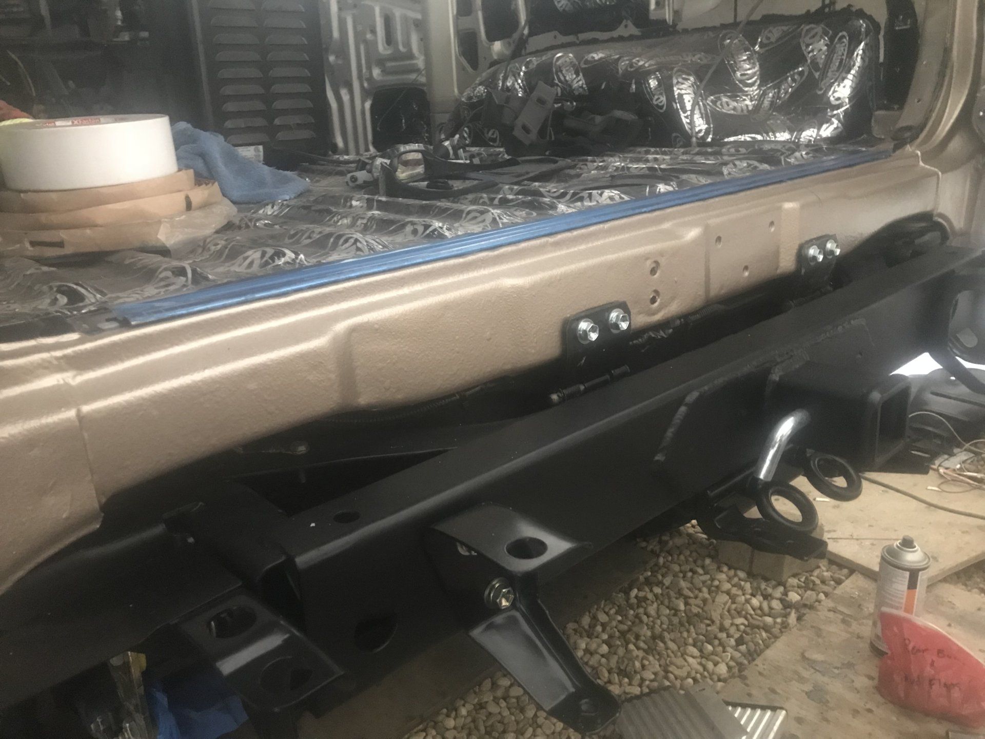

I had all the mounting brackets for the rear bumper powder coated and got new mounting hardware.
1916027
1916028
Here is the chip guard in the back with a new scuff plate. I also have a new trim piece that goes here and new door welting to finish it off.
1916026

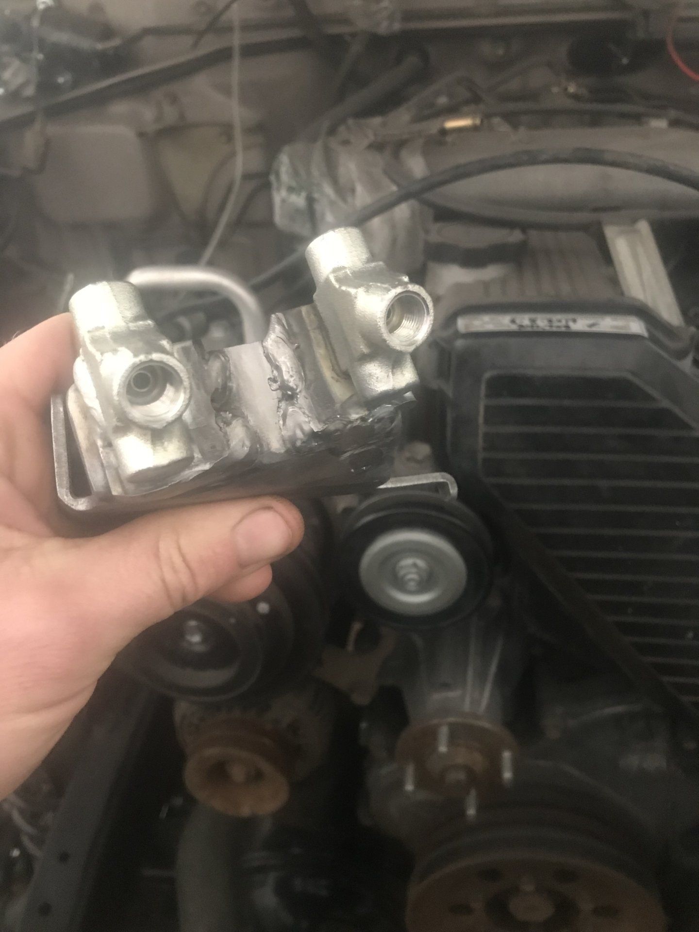

This truck the LSPV has been gone for who knows how long. It was simply bypassed in the rear and makes for some funky plumbing. I am not installing a LSPV so I needed to make this new forward brake fitting, the stock one with LSPV both fittings are 3-way. I am also removing the return line for the rear and installing a Wilwood proportioning valve on the rear line to dial it in.
1916029
