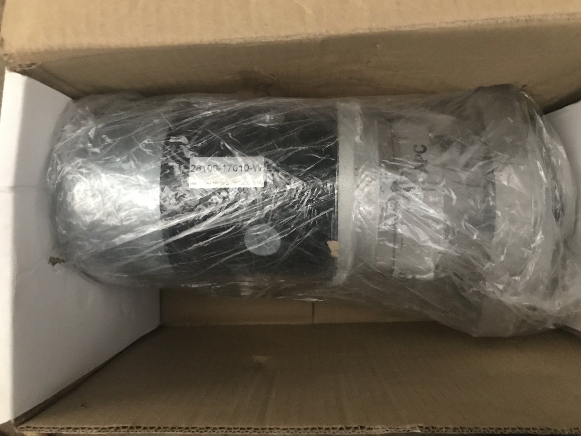

Picked this up for the 1pz, was only about $125 iirc.

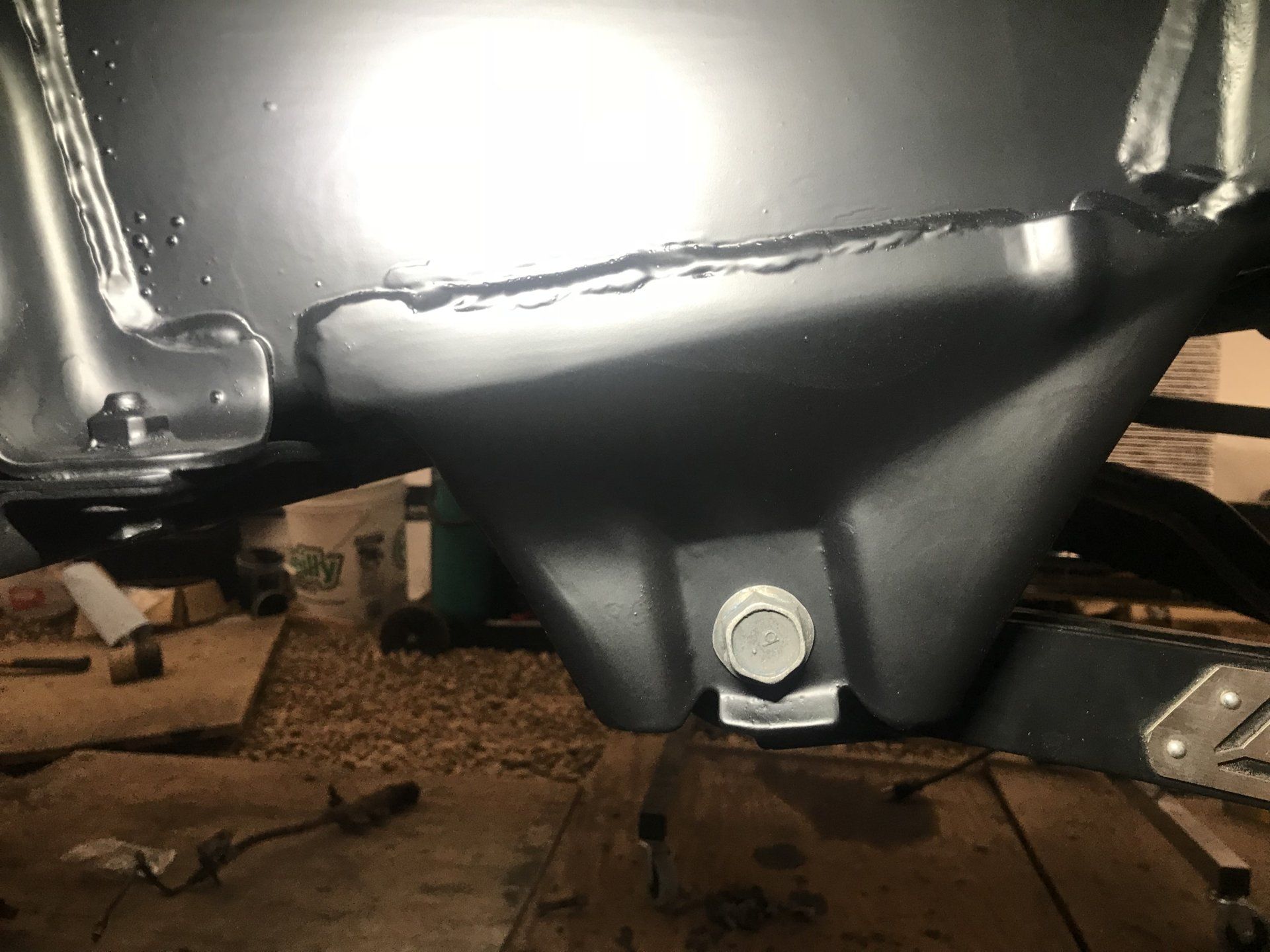

@SNLC can you please post a few close up pics of how you tackled the crossmember/control arm bracket interference dilemma.
Sure....
Remember I had @Delta VS build me radius arms to my specs, 1.5” shorter than stock. That was due to the crossmember. I also cut out the back of the factory frame side radius arm mount and boxed it back in to suit this build.
Cheers
ok so you didnt have to actually modify the cross member

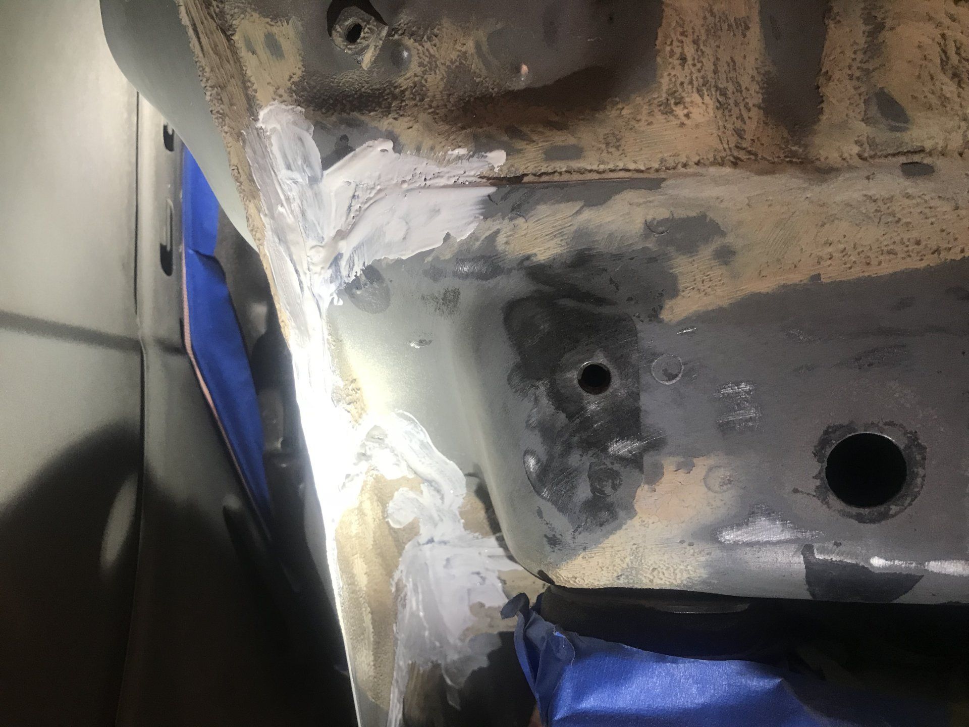

Nearly ready to paint and seal up.
POR15 sealer applied after digging out old factory sealer that was falling apart. Surface rust found was wire brushed out before applying.
Everything is getting POR15 + more.

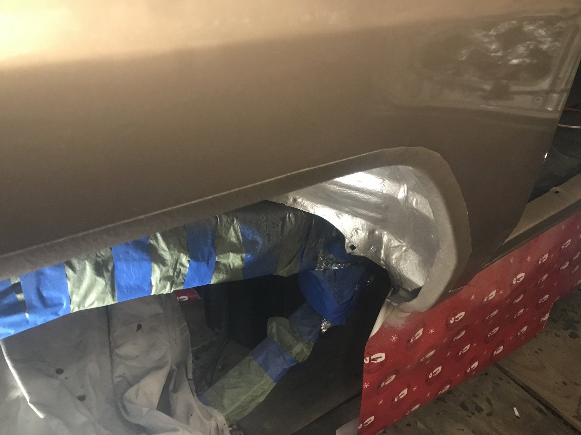

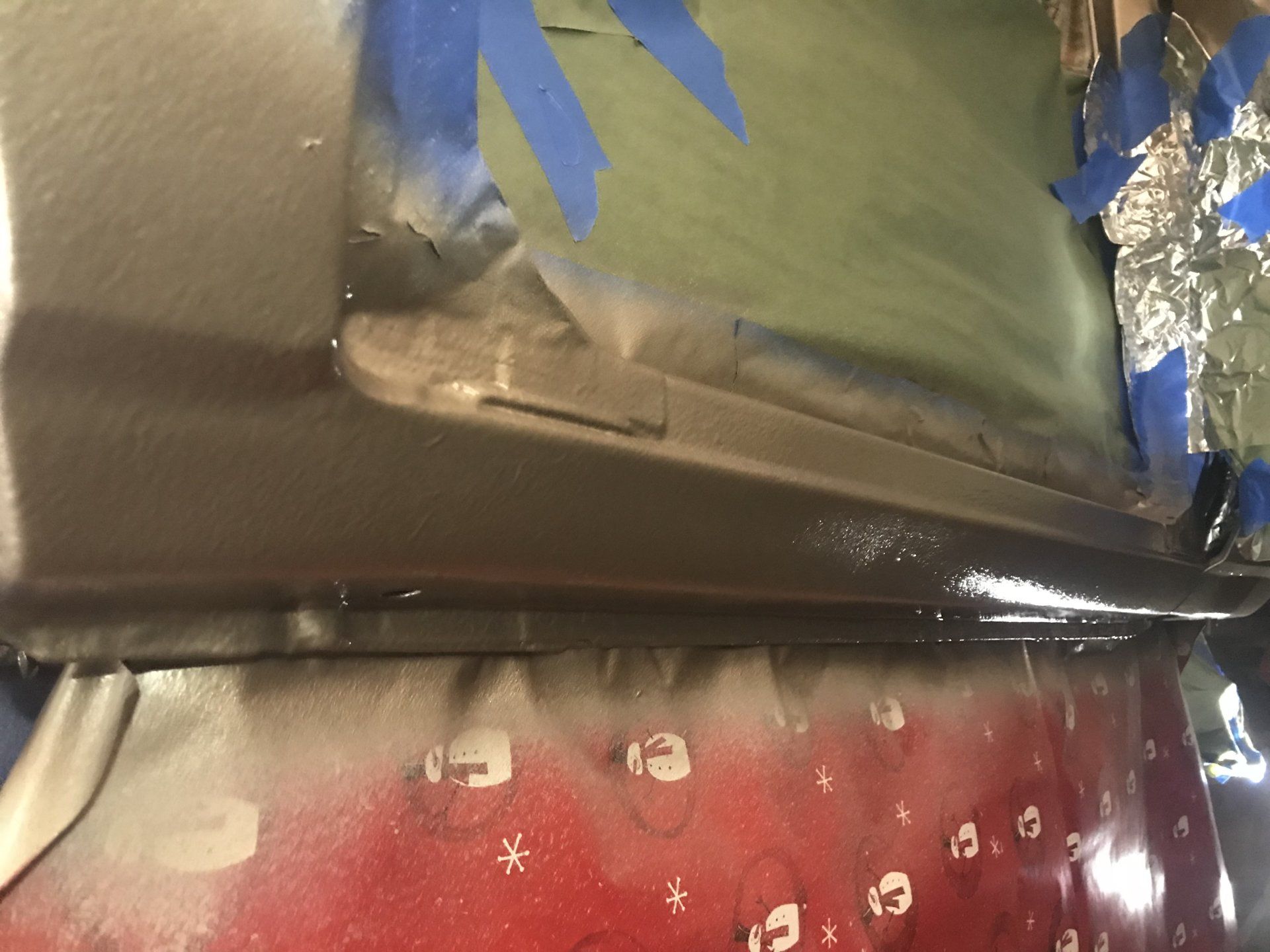

Two coats of the chip guard is down....
I could top coat tonight as it cures out in 90 minutes max.
So far so good but I can tell I will have to cut the taped edges with a razor blade. The 3M chip guard cures out way to fast to pull the tape wet.
Cheers
By the way here is that spot in the back I performed a rust repair. Not perfect but for a refurbish (vs resto) certainly good enough and well sealed up now.
Cheers

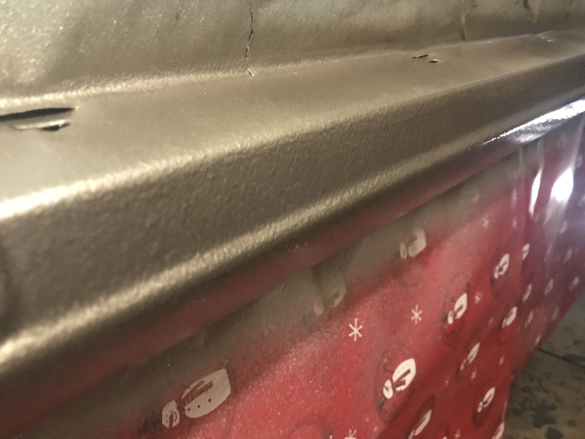

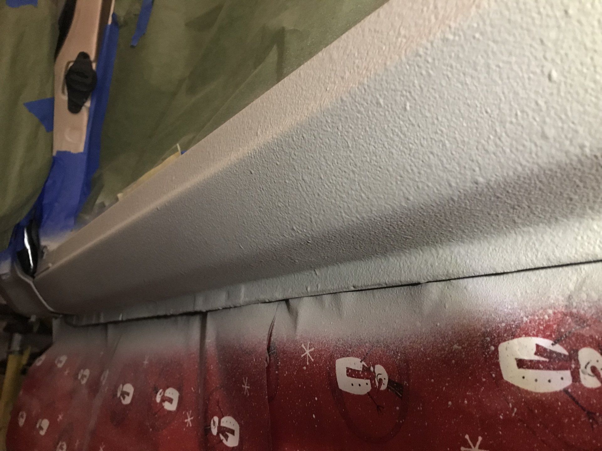

These two pics show texture.
I am very happy with the results. Like I say, this is to replace doing bedliner in areas like this on a truck.
Going to be some hours to cut all the tape off and I may do one final step to blend it (the edge that will be there once tape is cut), I will decide once the tape is off.
Cheers
I was totally wrong about the tape, this is pulling beautifully so burn the midnight oil and do it before it cures!
