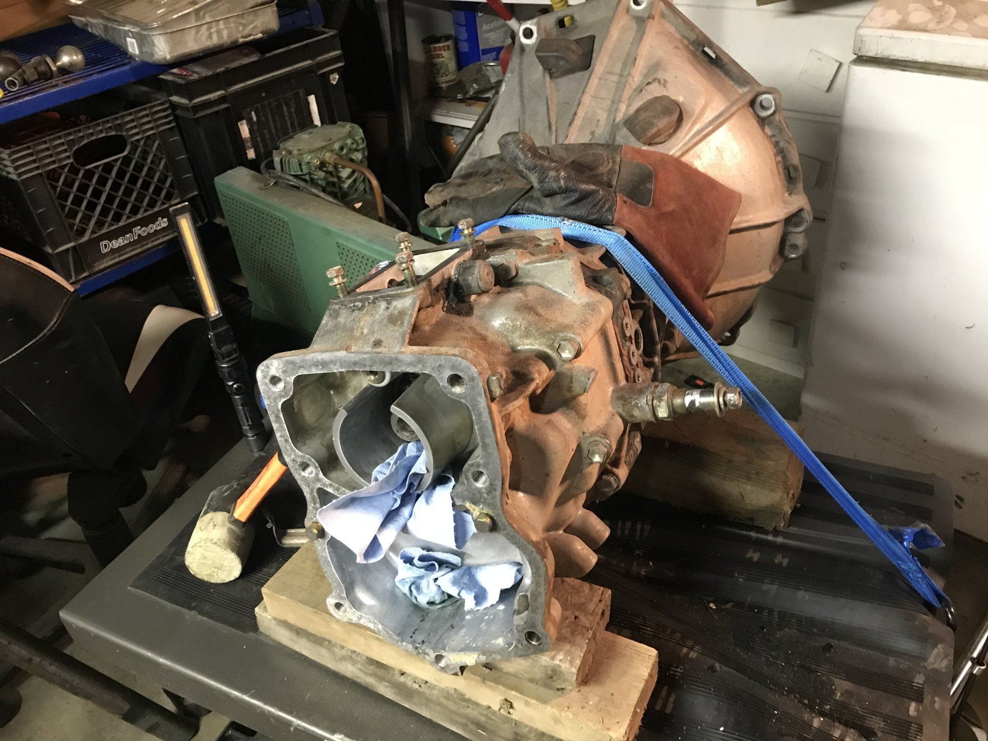

A nice change in the build. T-case rebuilds are fun to me.
Cheers

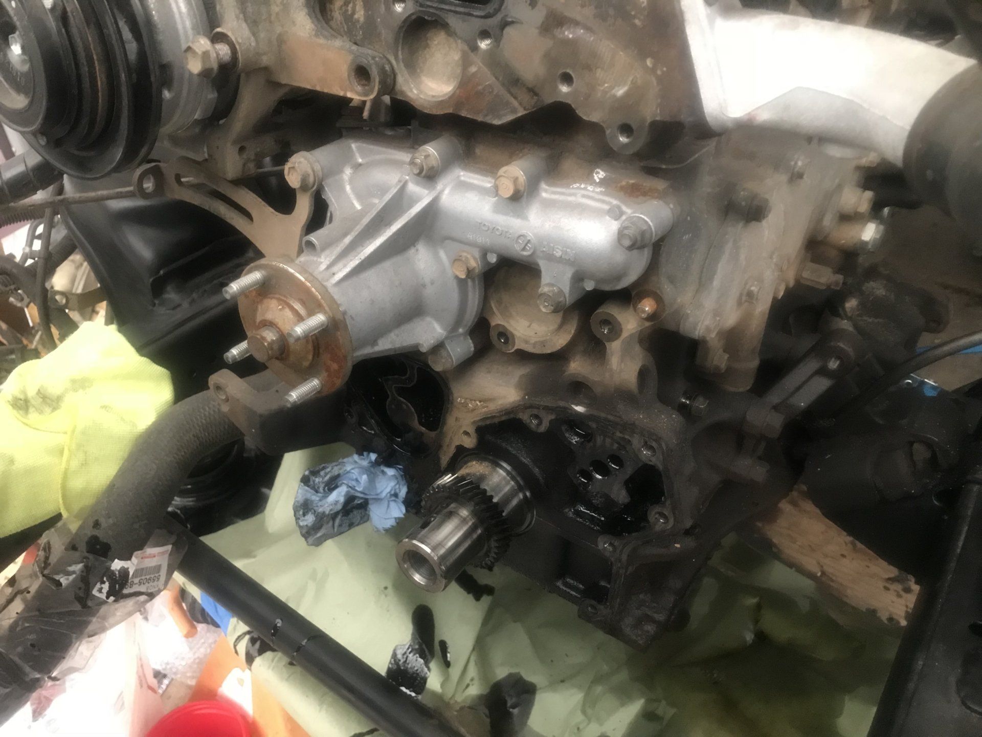

Bit of wear on the front output shaft synchronizer. Probably hard to see in the picture.
1922290

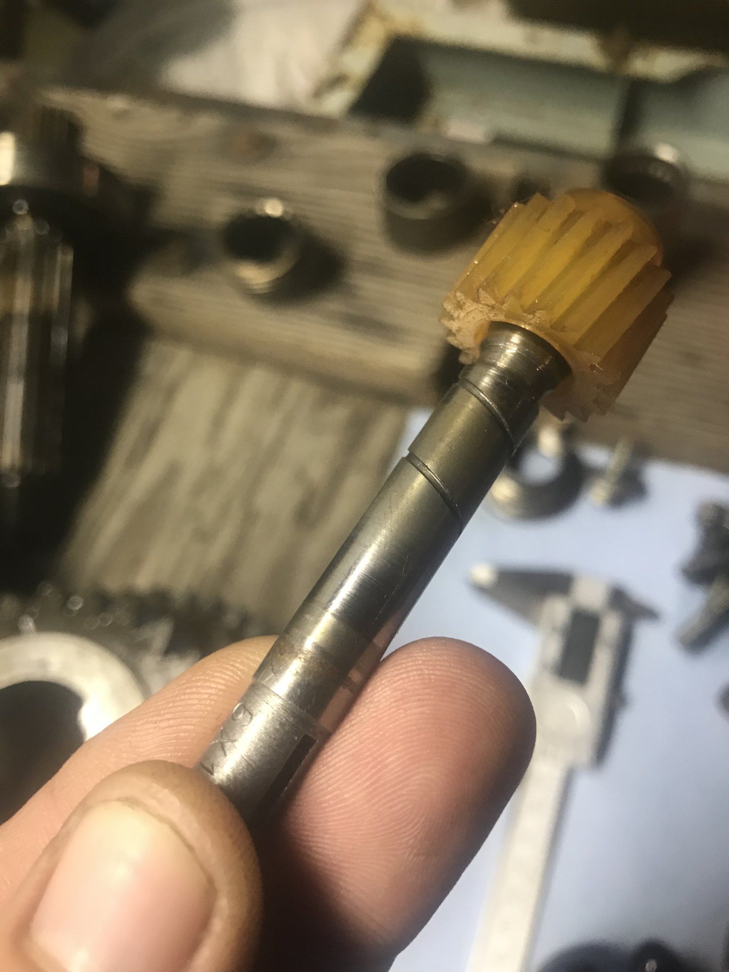

Tiny bit of corrosion where the seal rides on the speedo pinion. Plastic gear looks great though.
1922296

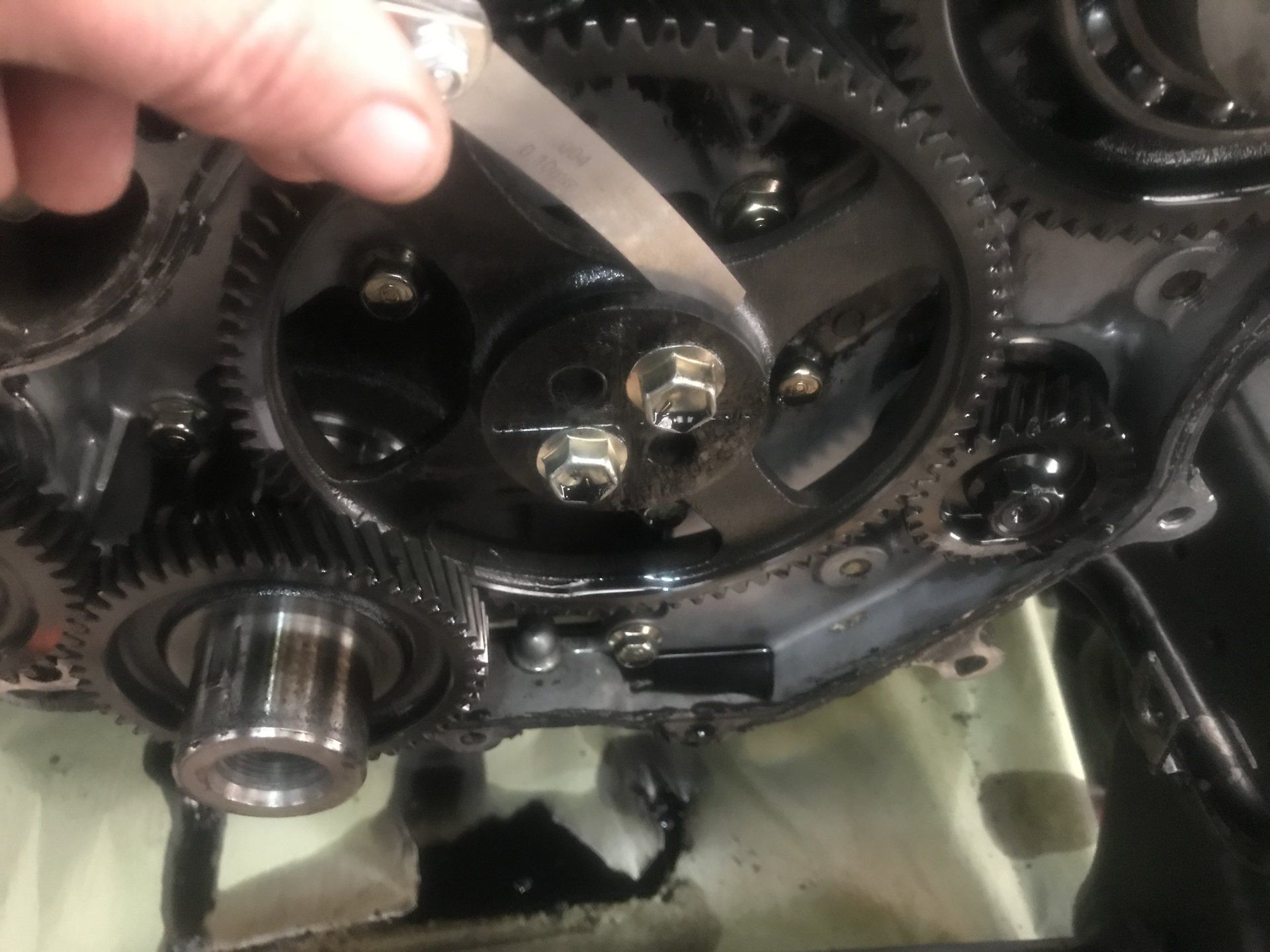

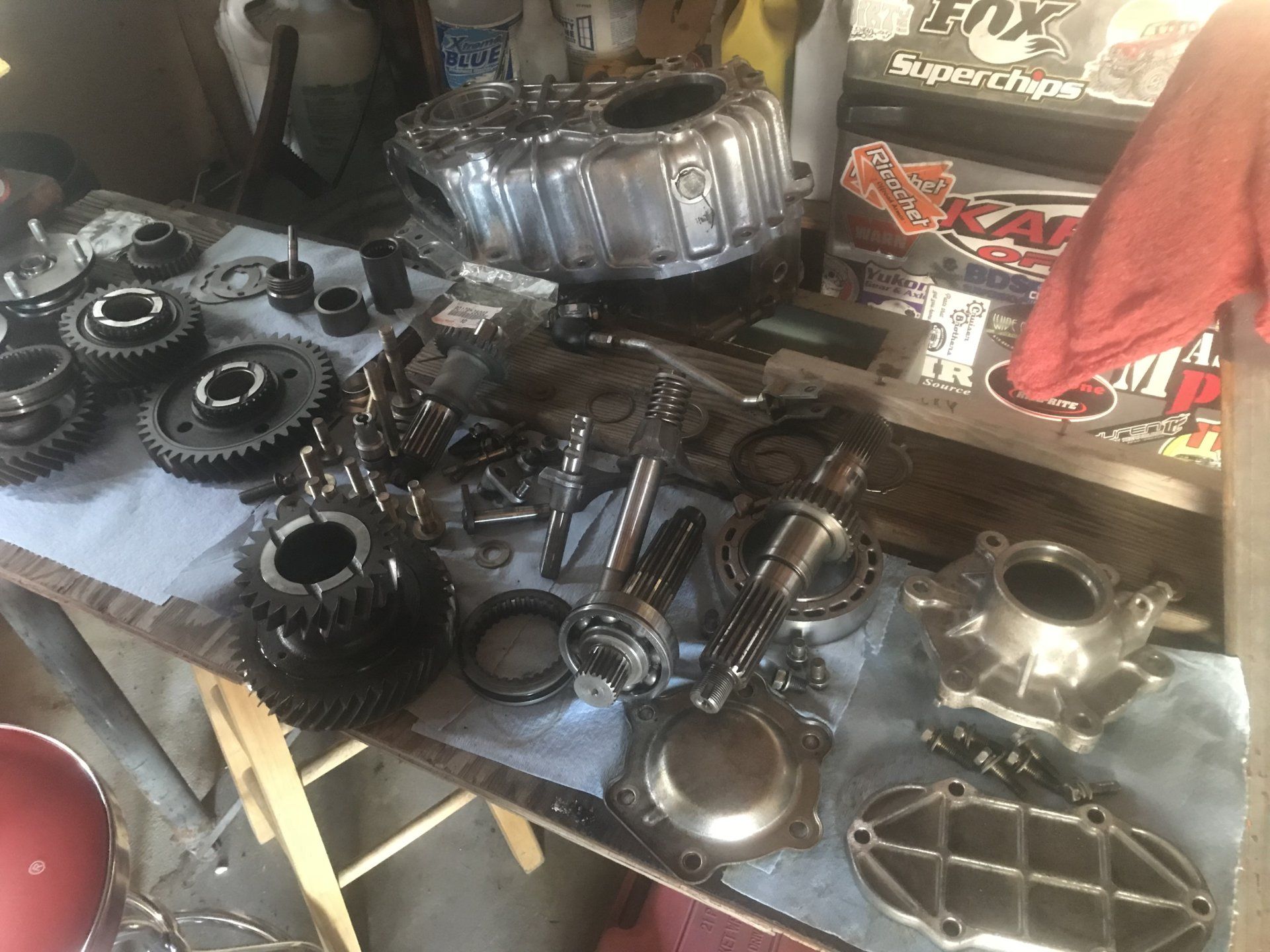

Still got to tear down the gear clusters and check them but everything so far is within specs. Not shown on the cardboard is shift fork to synchro hub specs which are very close to being out of tolerance.
1922297
I still got to finish cleaning the cases.
1922295
Half the parts have been cleaned.
1922293
Overall it is in great condition for age and miles. I think I will order a few items though and replace them.

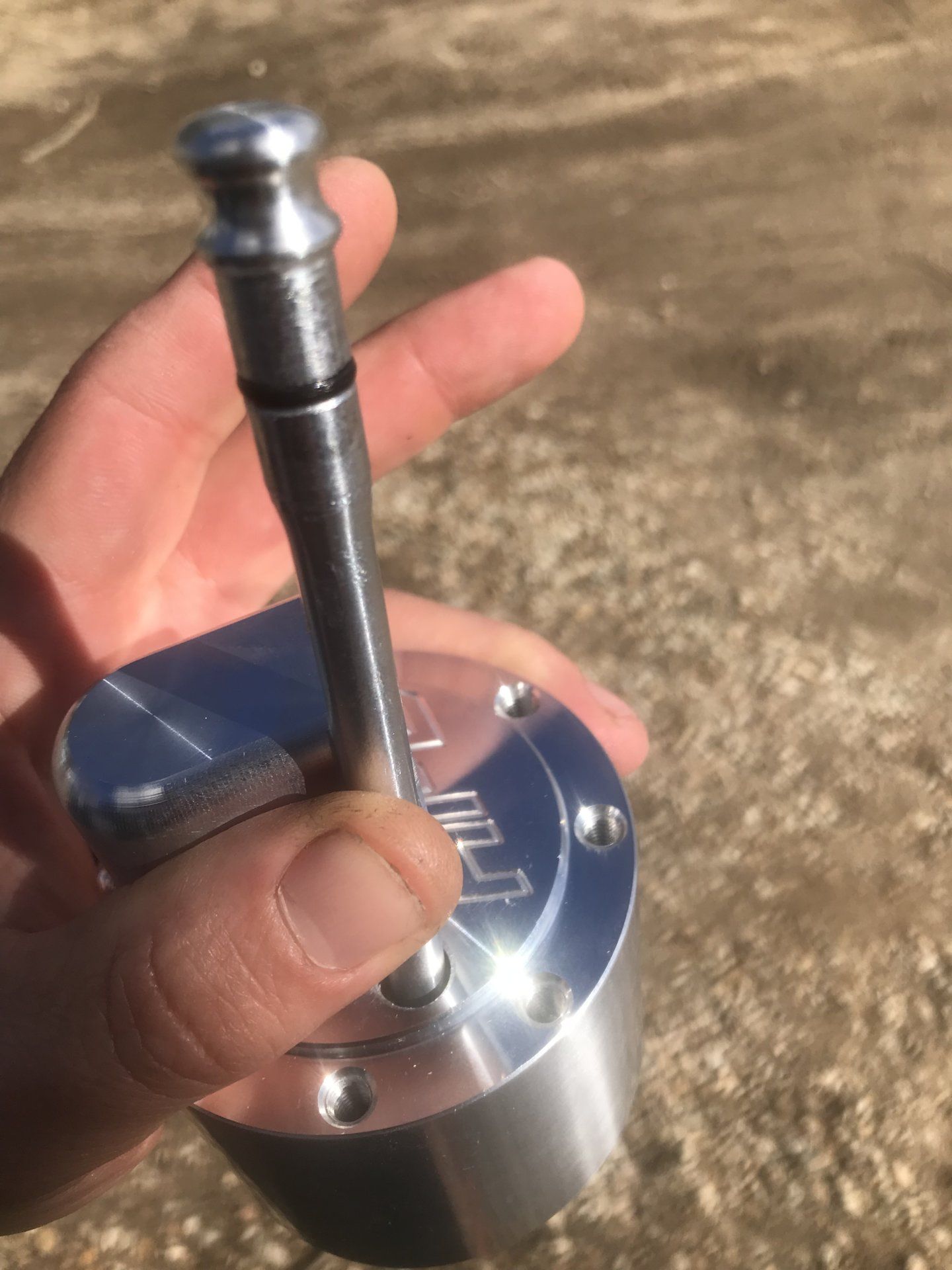

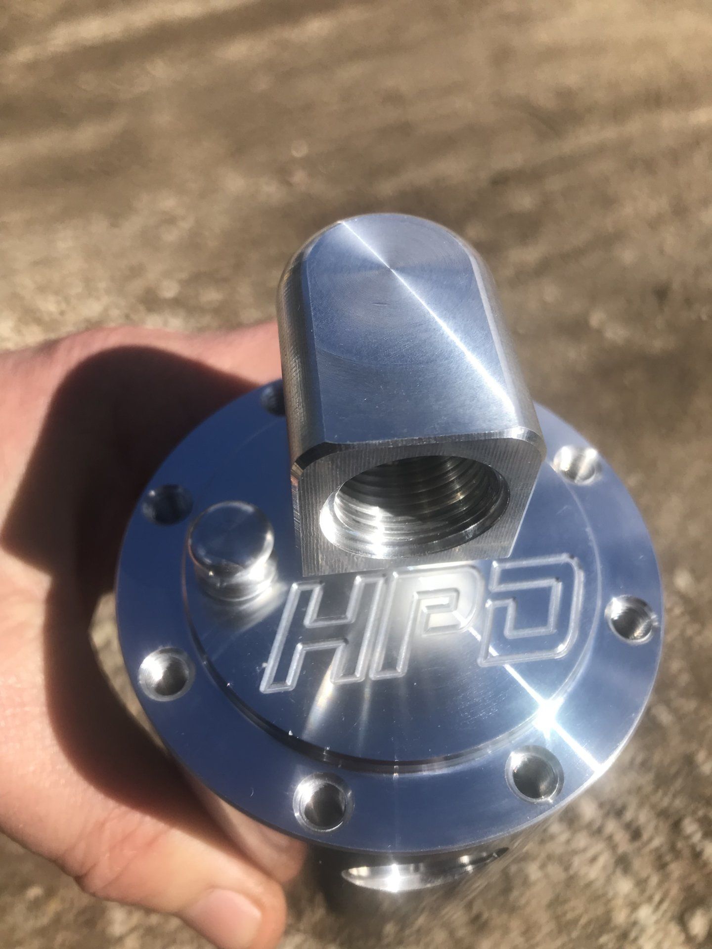

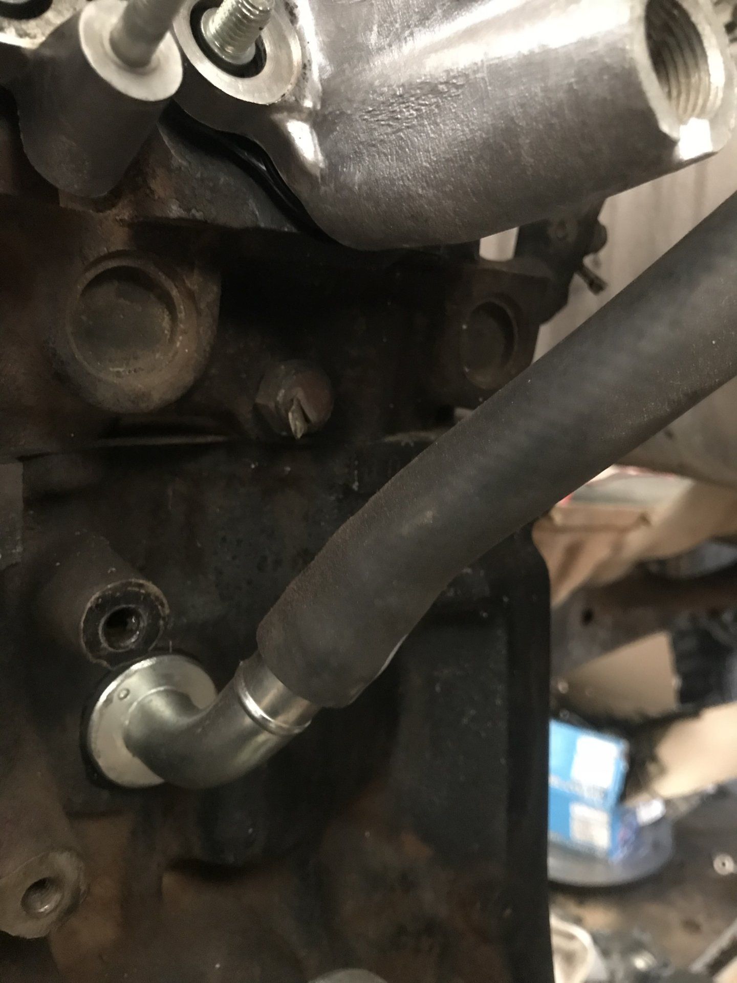

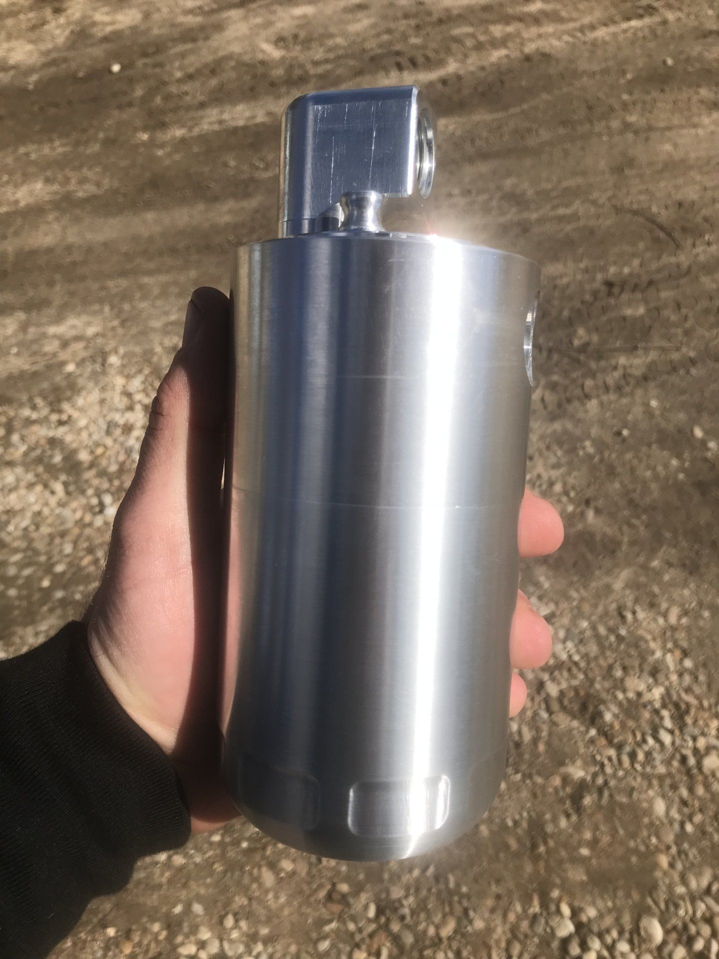

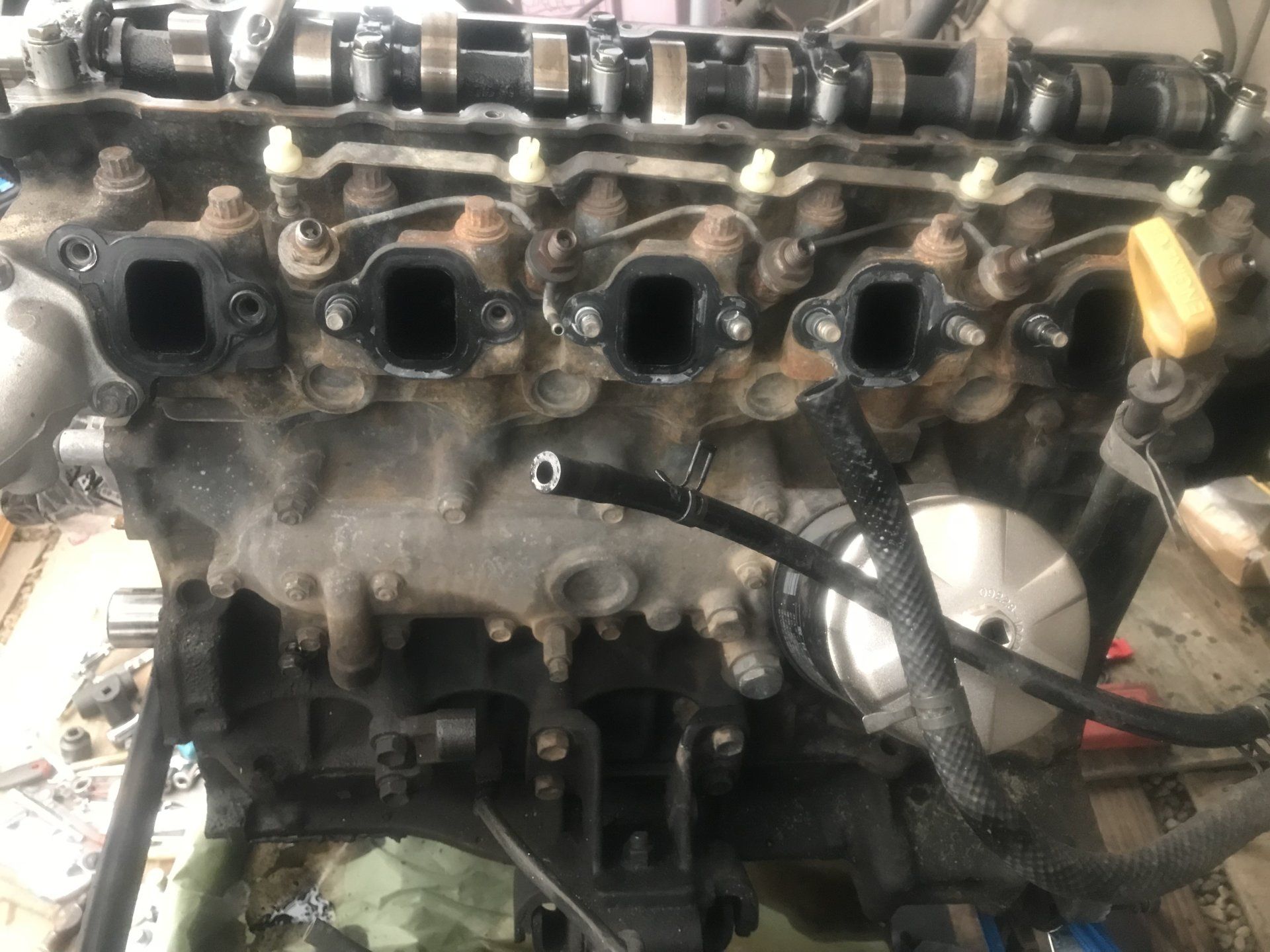

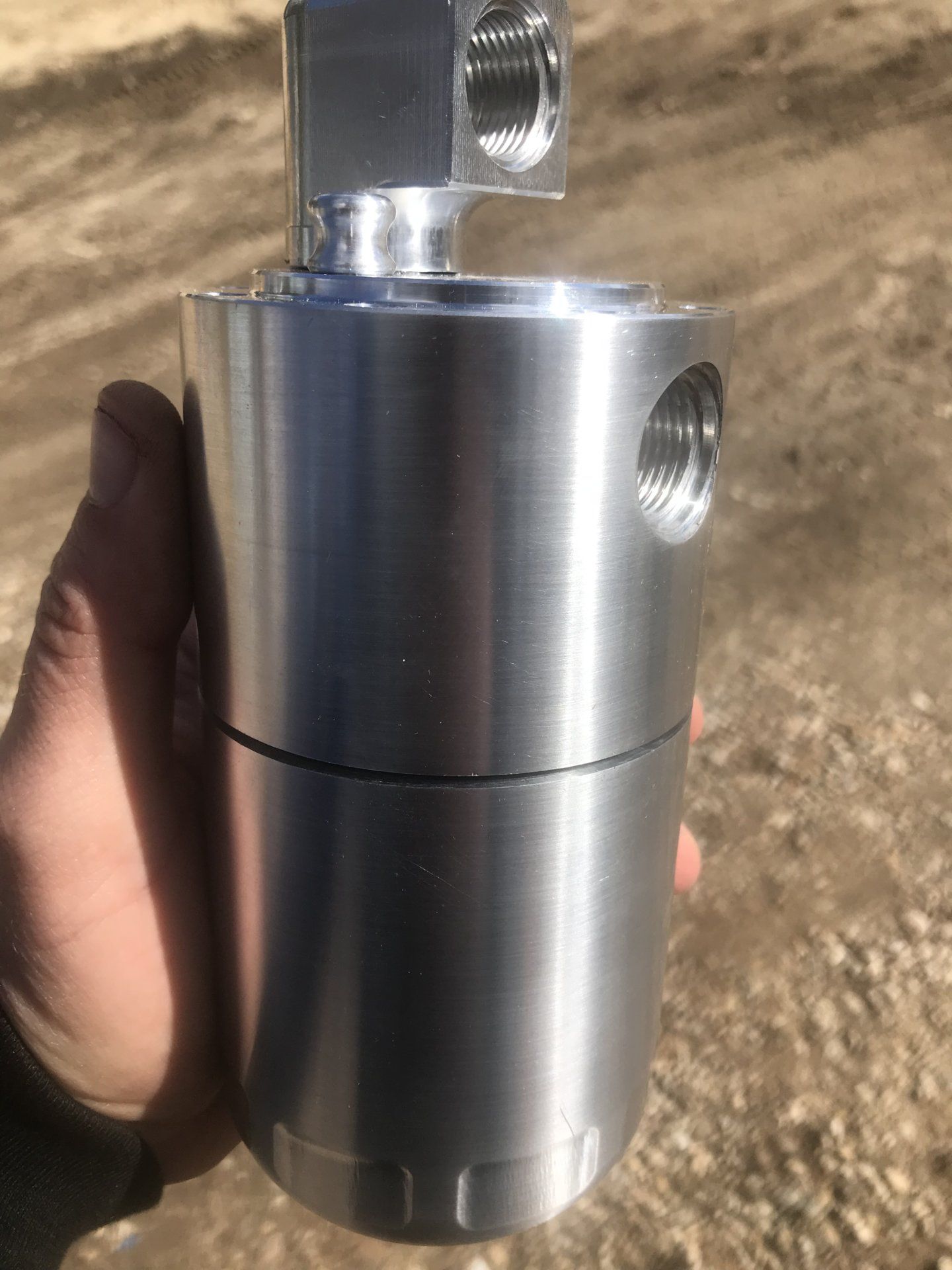

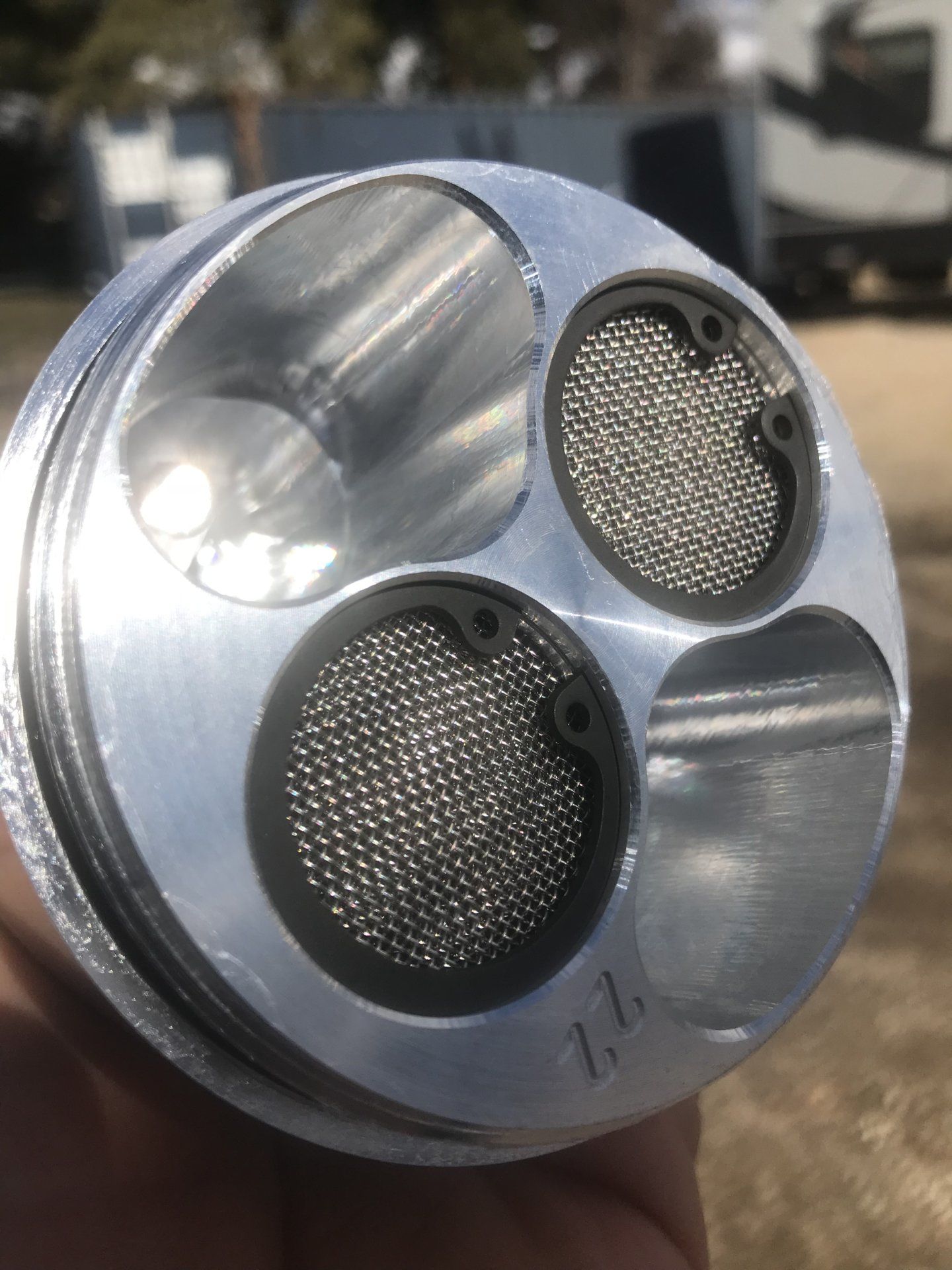

I needed to get a catch can for an HDJ81 I am working on so I decided to get a second for the 1PZ too. Reason being is I don’t really want to run one with a filter.
1923914
1923915
1923916
1923919
1923920
Wow! I am impressed with this, one fine piece of machined billet!
Cheers
Cheers
Billet catch can... Very nice...
I also have a 1PZ and have considered installing a catch can....
Dare I ask what that HPD unit set you back ?
I did a lot of looking into catch cans. I decided anything with a filter is a no go and could create problems.
The HPD ones are not cheap at $385 Aussie bucks (great exchange rate right now though) but I think they are top of the line and you get what you pay for. I couldn’t find a single Aussie review for these either that was negative.
Cheers
Thank you for the information...
I will check out their website....

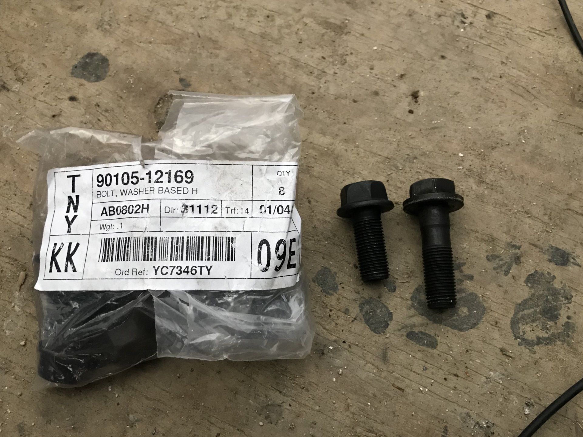

1HZ vs 1PZ flywheel bolts.
1924980
Pin removed from the crank. The flywheel I have is from a HZJ80.
1924984
1924982

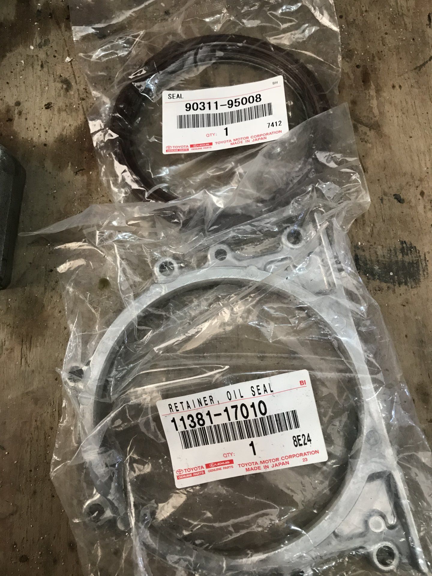

R151 vs H151, only difference is ID.
1924983

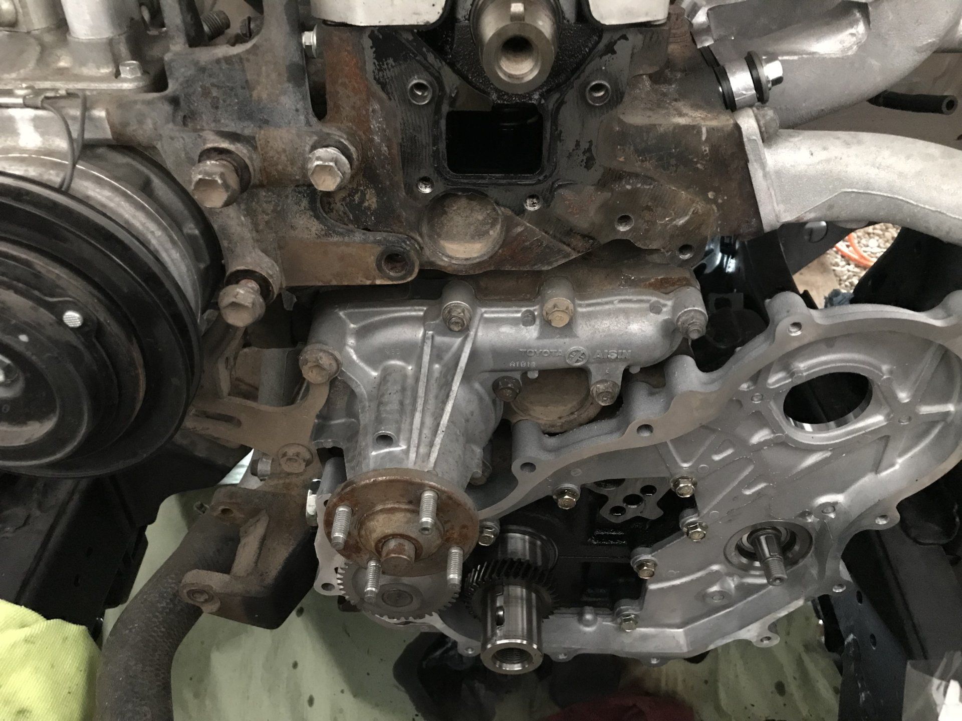

Getting ready to replace the rear main seal before installing the flywheel.
1924981
Cheers

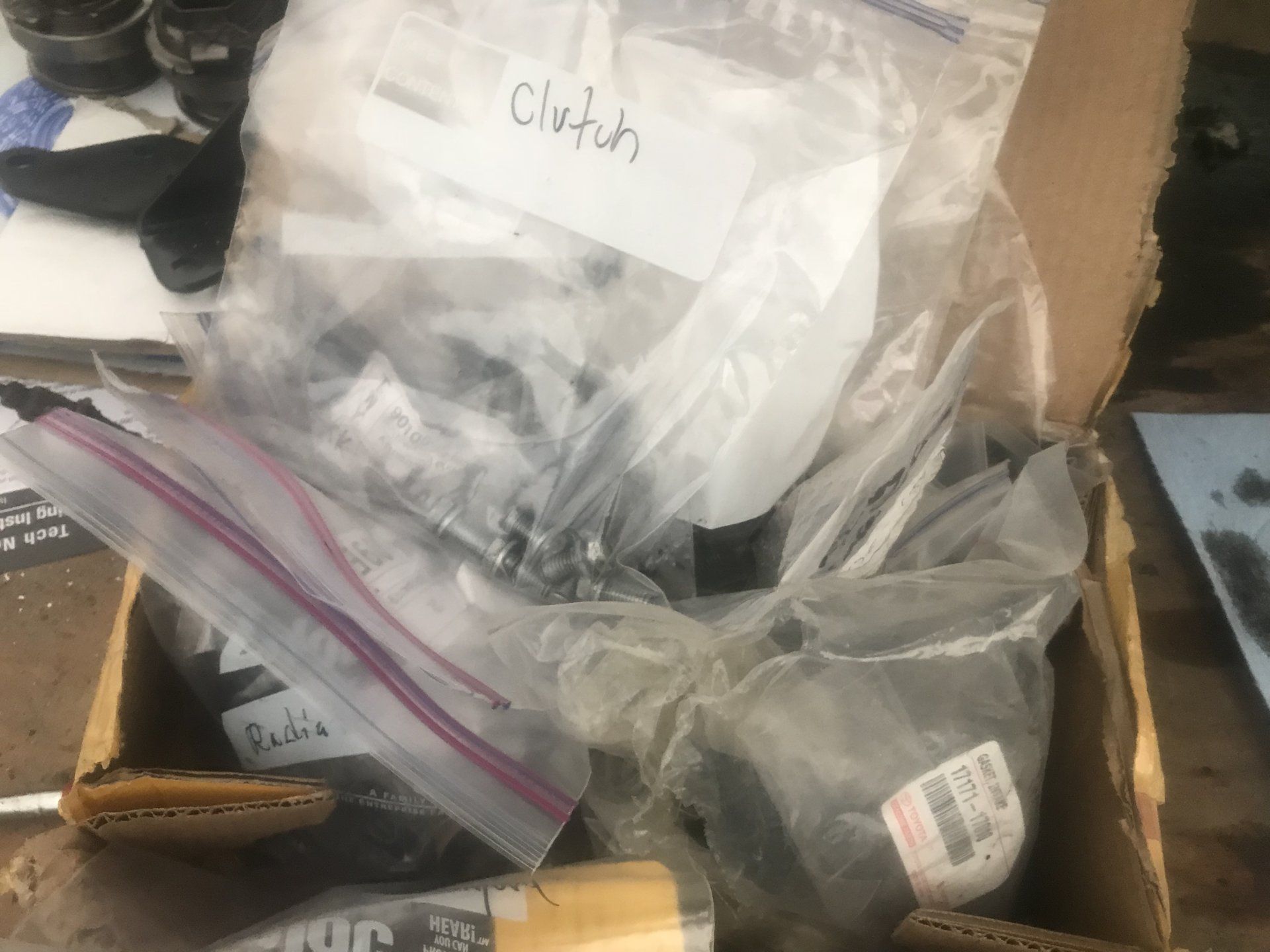

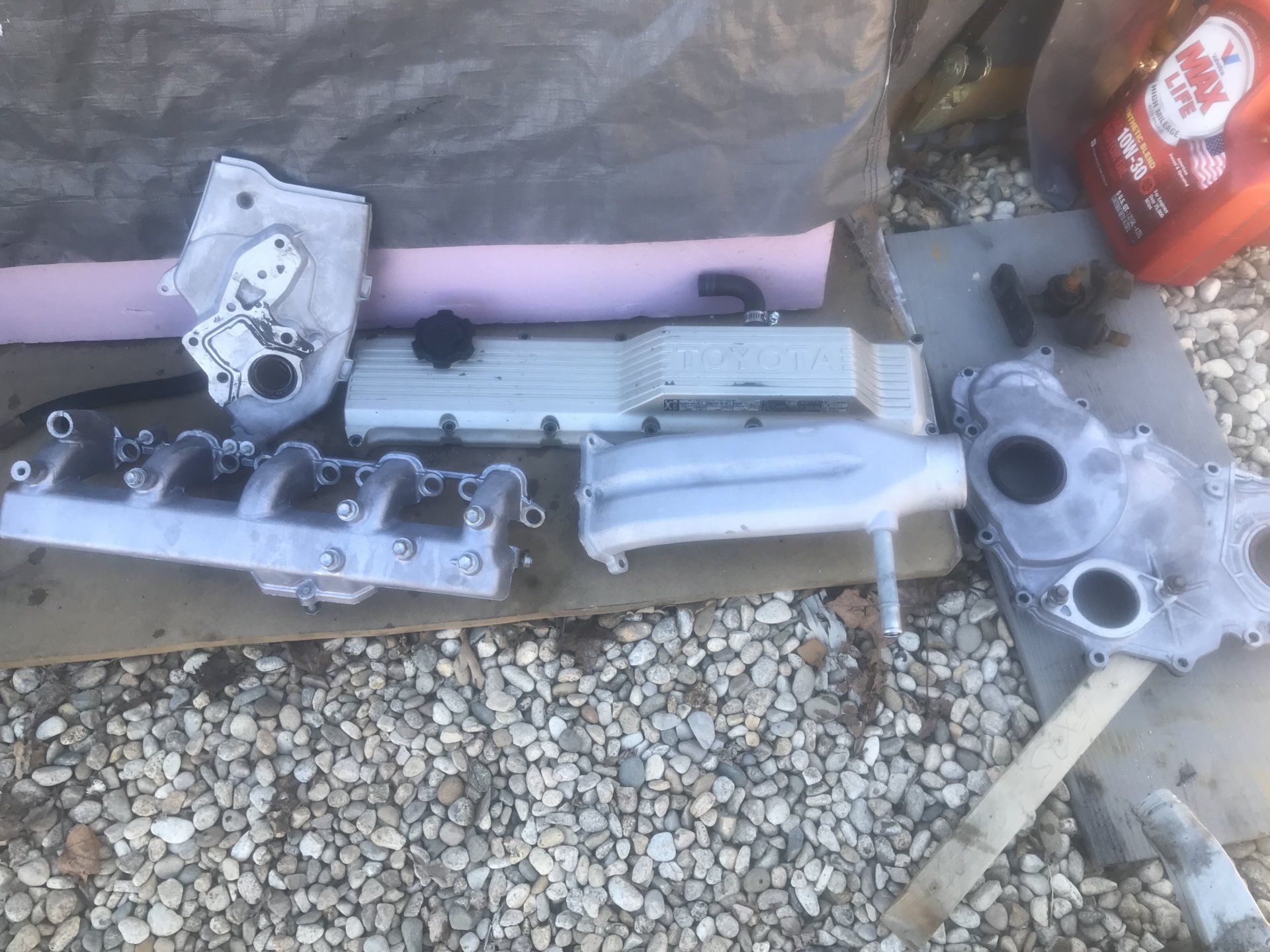

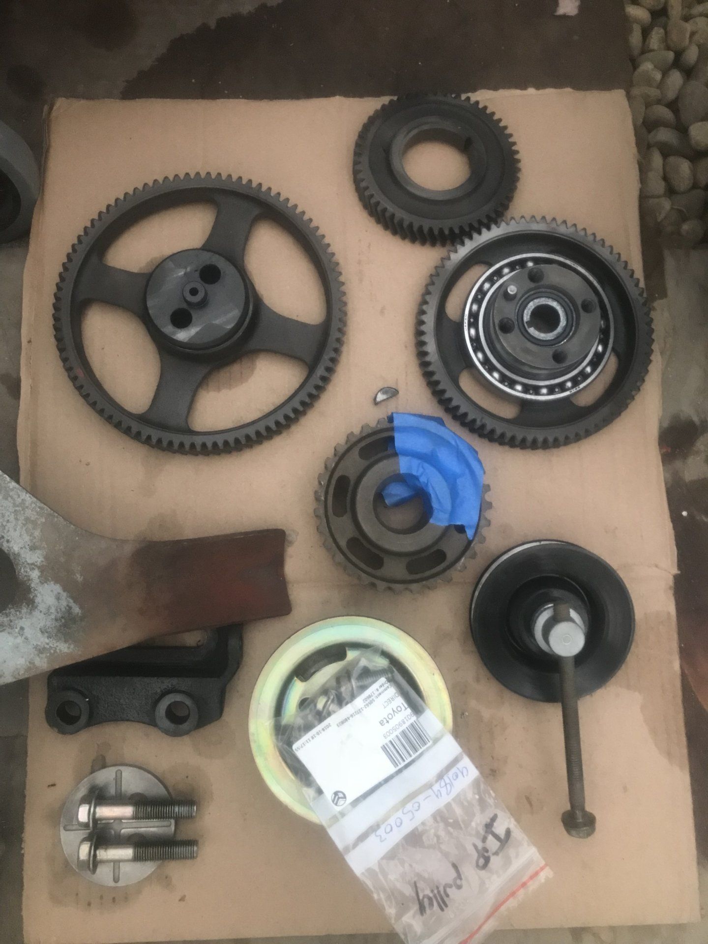

Yesterday I spent a lot of time cleaning all the parts removed so far. I also went through all the parts I have on hand to make sure I am not missing anything for this work.
I even cleaned all the hardware, I dislike greasy-oily hardware when I am reassembling stuff.
Three boxes like this of parts waiting to be installed.

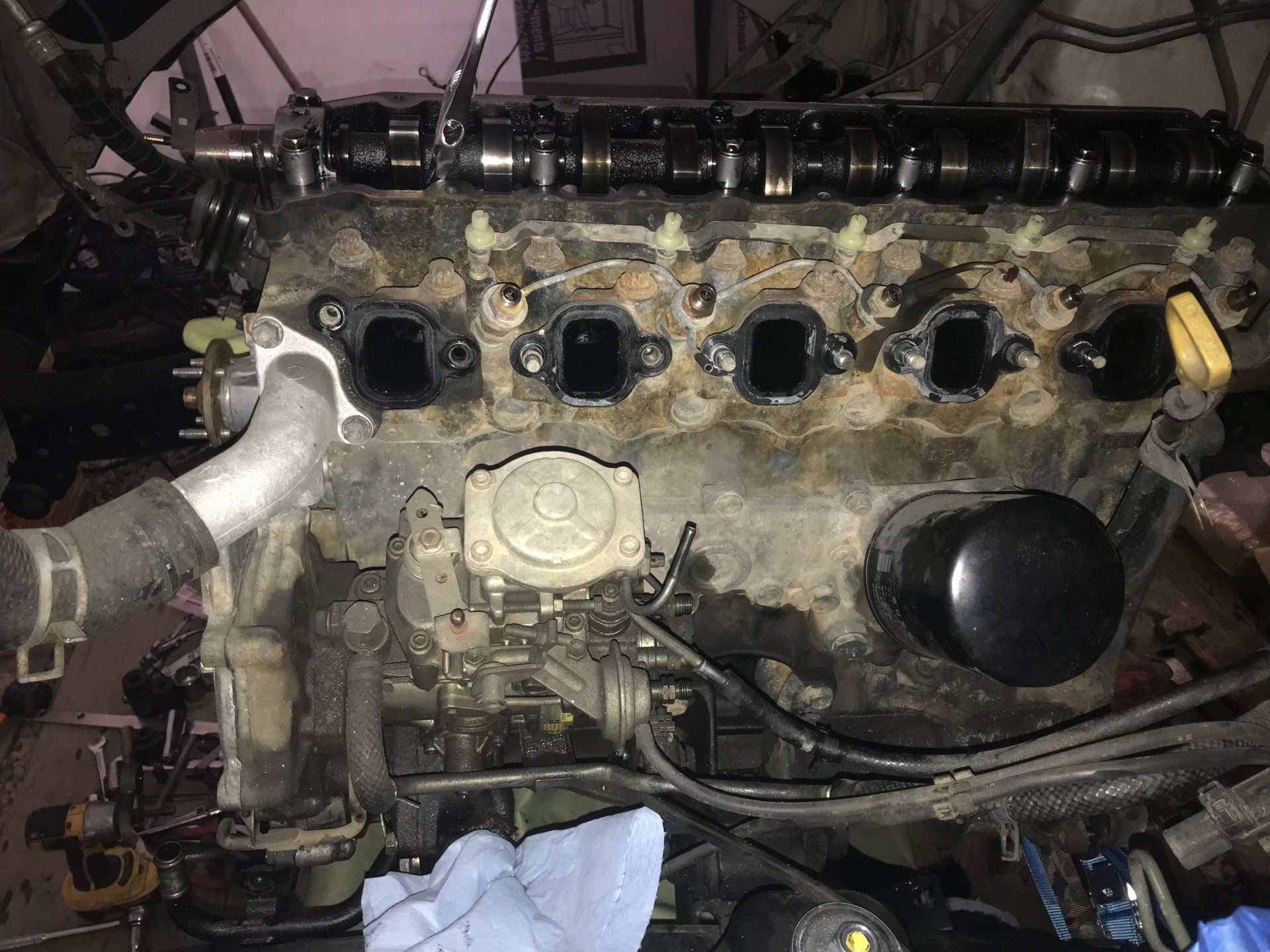

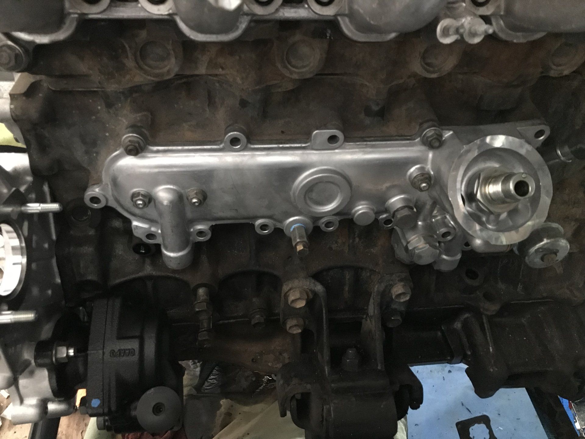

One more item to pull and one more cleaning session before starting on assembly. I am pulling the oil cooler as well as cleaning the block.
Cheers

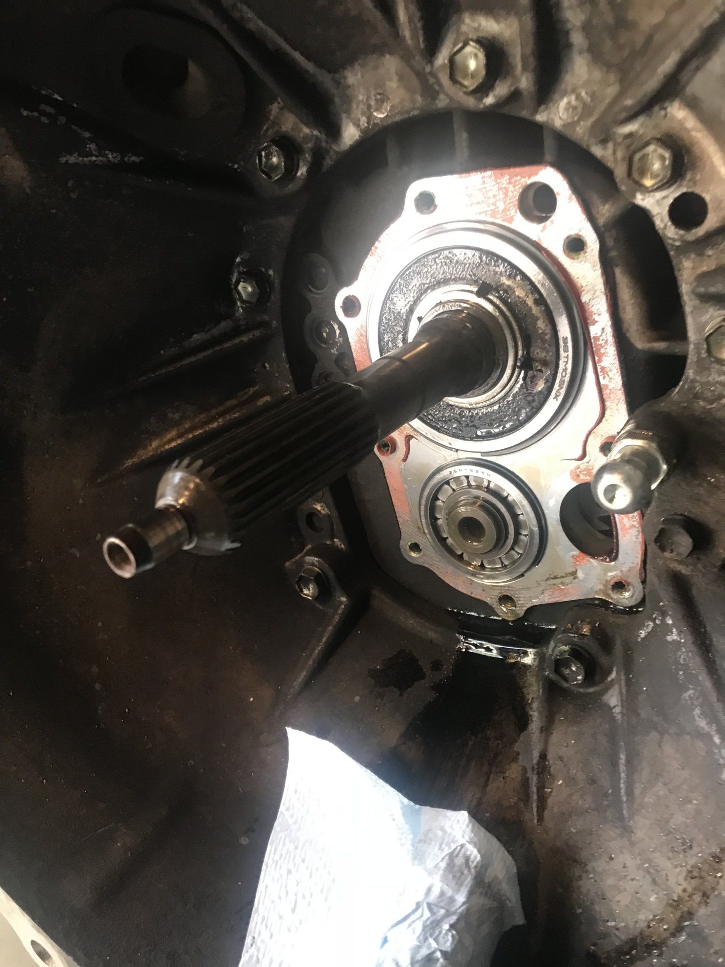

Transfer case is rebuilt, just need new switches to arrive.
While I am at it I am changing the seal in trans bearing retainer.
Cheers
Just waiting on the crush washers for all the plugs in the cooler cover and I can seal it back down.

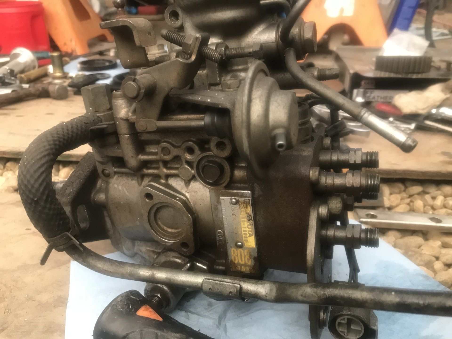

Can’t do much more here without the IP back from the rebuild shop.

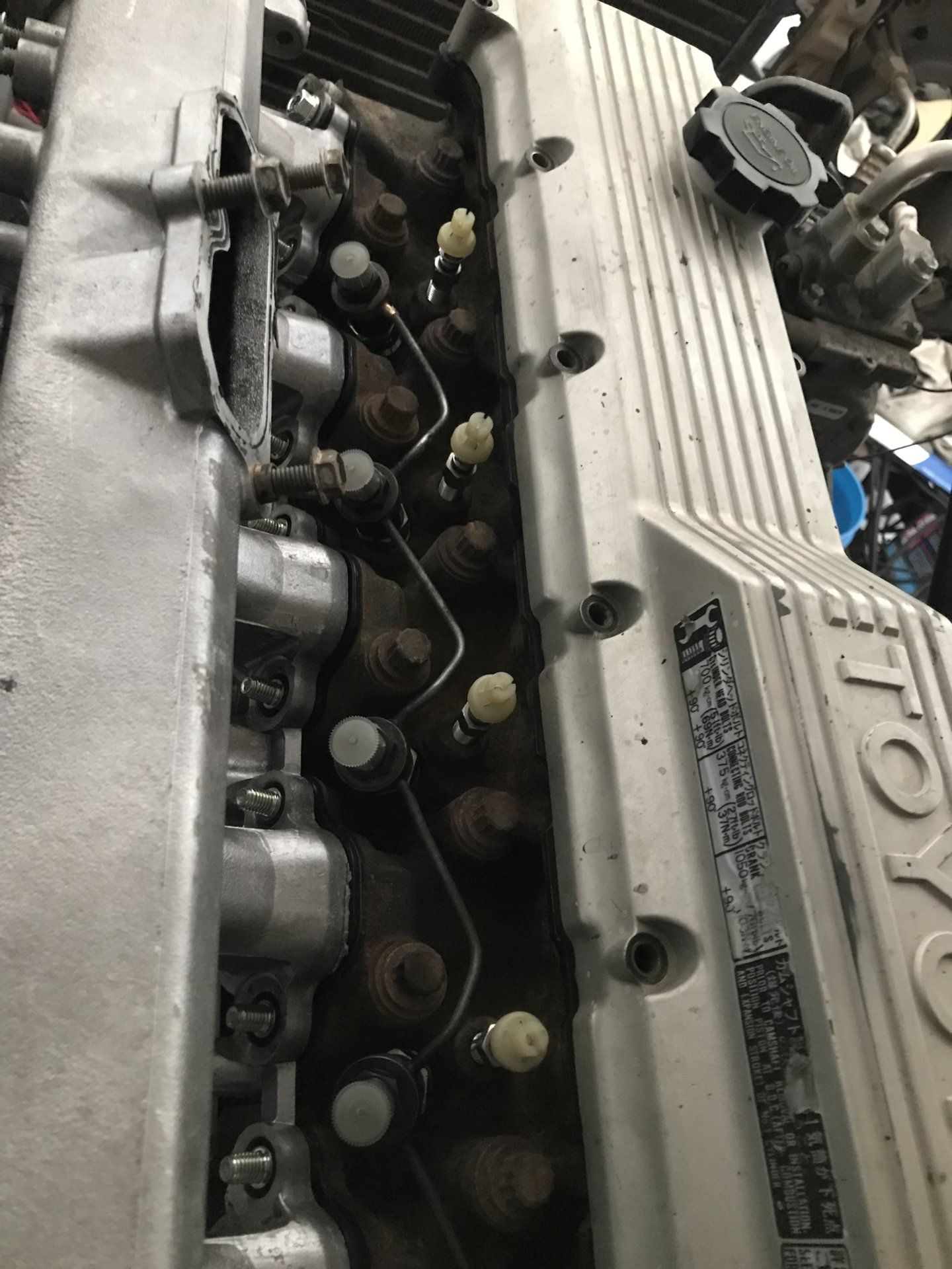

I did stuff new injectors and glow plugs in it.
Installing the pan next and then the flywheel + new clutch.

@SNLC I just got mine rebuilt by them, glad I saw this, now that I think about it I don't recall seeing the seal either, better check when I get home
