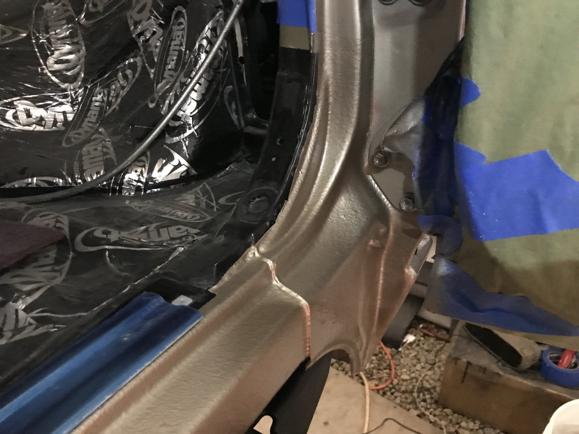

So while the tape pulled beautifully I was not happy with the sharp edge left. It is less than bedliner, obviously this is all about thickness of the coating.
1897584
So I knocked the edge down all the way around the truck with 400g.
1897585
I then touched up the paint.
1897586
1897587
I will probably do a cut & polish on the truck and a wax before it goes home to the new owner but besides that this is a done deal.

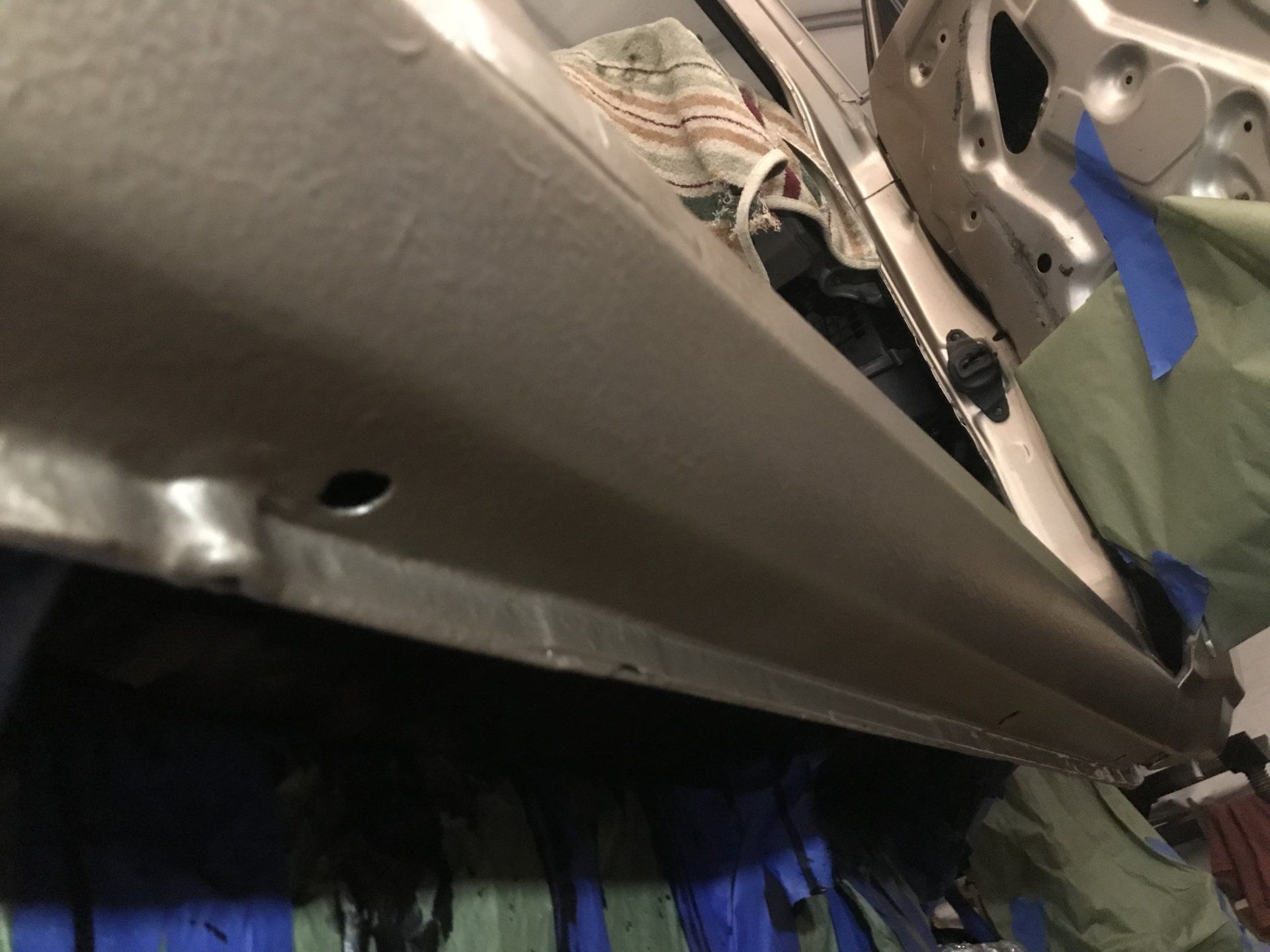

Chip guard on my 80.
1897998
1897999
I am not sure if this was factory installed or dealer installed. Perhaps somebody who knows could chime in on that?
Cheers
I'm pretty sure thats factory. I've had 6 80 series and every single one had that on the rockers.
It was on my 2004 taco too. I am sure it is on 4Runners as well.
Not a common thing to see a tape line from the factory on any vehicle. Which is why I question. It was taped on the fender too just feathered up towards the tape line. And obviously applied before paint.
Cheers

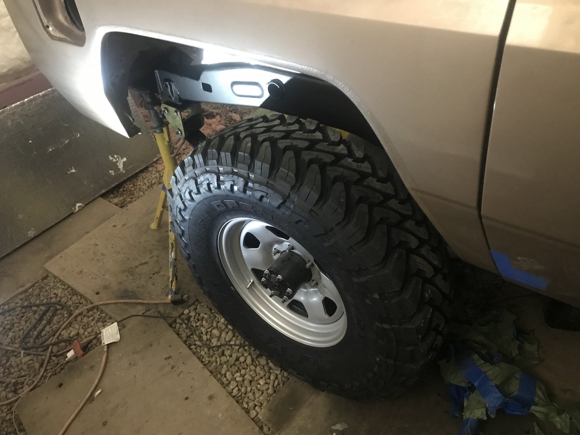

Having the Toyo M/T’s mounted up to the OEM wheels right now. Also having the Toyo’s sipped.
This is definitely a sweet combo! I didn’t want to spend the cash on this set up a year ago but man it is nice no doubt. I am excited to see them on the Cruiser.

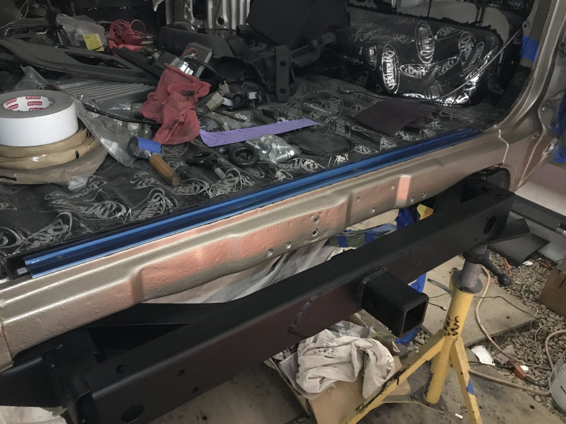

Had an old friend in town so didn’t work on the truck much the last 3-4 days. Rear axle is all ready to go down on it’s own weight.
1902369

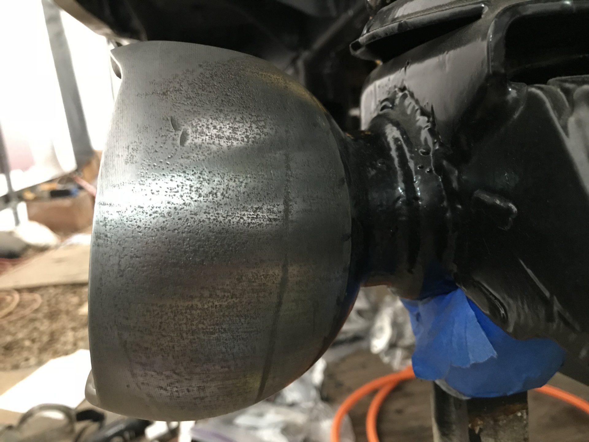

Knuckle ball before clean up.
1902367

I like those Toyos. I’m trying to choose between Toyo and the coopers stt maxx. Coopers would Probabaly be better for the weather here, but I like the looks of the toyo better
Depends how how you use the rig. I've run both tires. In the dirt, rock, mud, slickrock, the Toyo MTs are killer, on-road they can hum a bit but in a 70 you probably won't notice much. The ST Maxx are very decent in the above terrain and quiet on the road. They are, however, rather stiff due to the Armor-Tek3 carcass. But they are a stout carcass.
Main reason I went with these was size. 255/85R16 there really isn't much to pick from in this size. I honestly would have went with Duratracs, they fit the owners uses better but those are not available in a 255. So I had the M/T's sipped.
Cheers
Yeah, I'm wondering if the ST Maxx would be better for snow packed situations. I throw ice out as we only get that a few times max during the year.
Cheers
Yeah I'm torn between cooper and these in 255/85R16 It could be whoever has the best price, although I'm sure the Cooper would last longer on road. decisions...
They were pretty good in snow on my 200 series in 285/75. A fair compromise, in my opinion, for an A/T vs full snow tires. A bit better than K02s in my experience. However, in ice or when the snow packs very hard/near ice, they were average at best. They do have built in provisions for studs if you want to go crazy.
