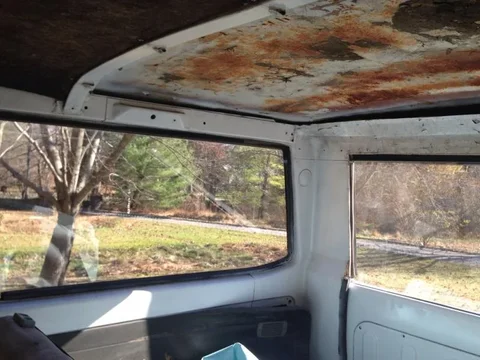

Given that a picture is worth a thousand words, here are a few of the interior. Headliner is shot, door seals are all shot, door panels are beat up, interior, pillars and roof all need to be sanded, treated, and painted.
