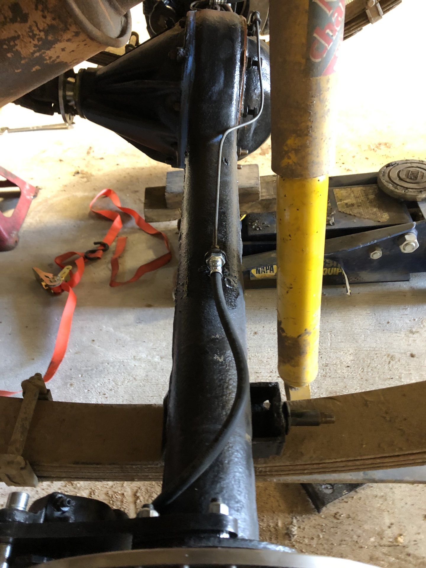

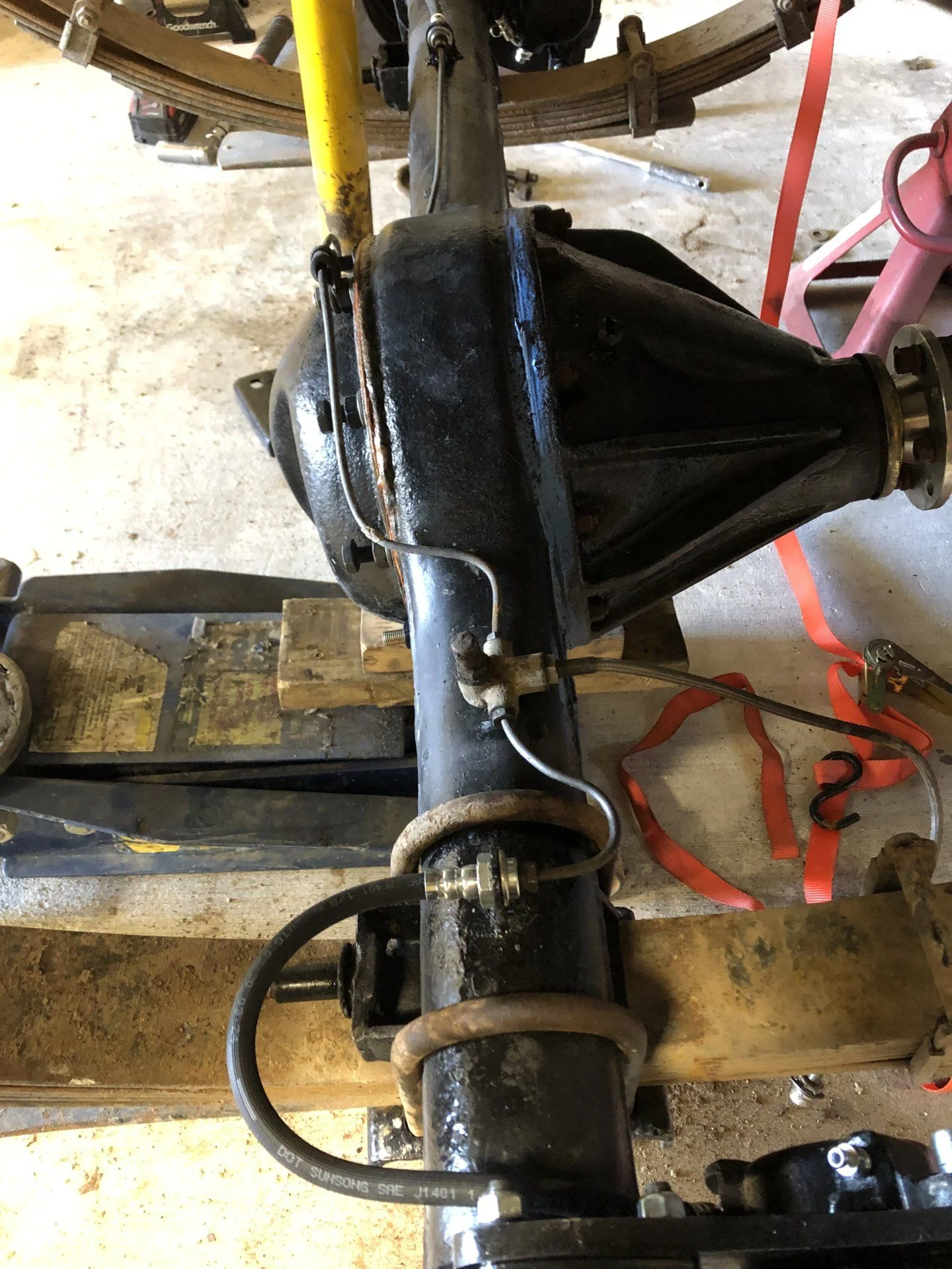

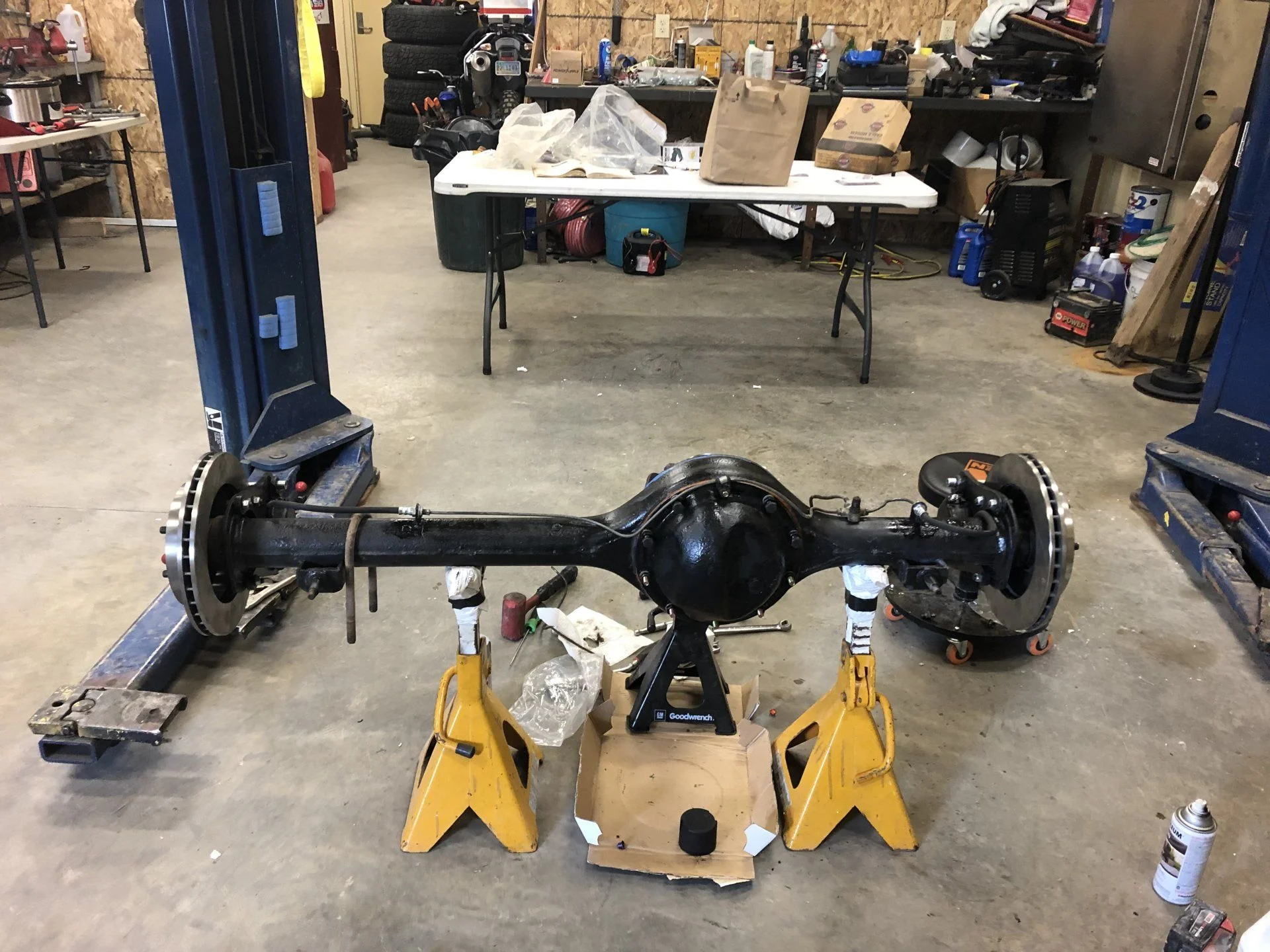

Here’s the axle all dressed up and ready to party

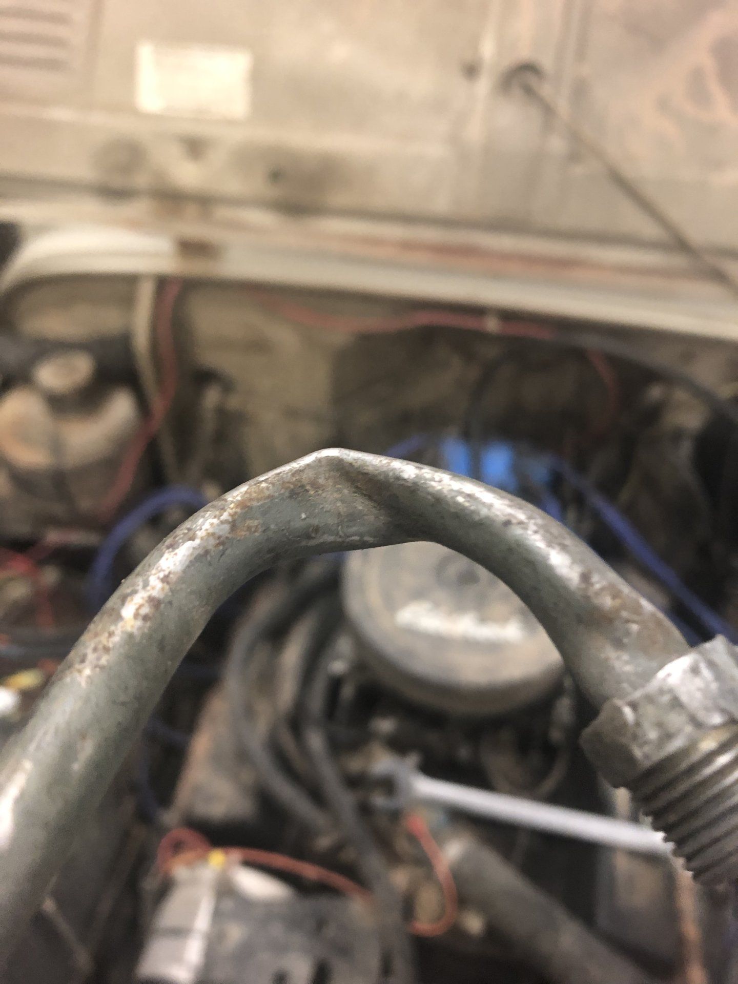

I probably stared at the new brake lines too long, before I came up with this set up. I still have room to slip the strap between the brake line and housing when putting it on the trailer.
It’s somewhat tight packaging on the passenger side. The bender I was using wouldn’t make the second part of the curve. Thankfully you can bend the brake lines by hand if needed. Shocks aren’t in yet, I need to find a solution to this. The threads are shot on both the upper and lower mounts.
The smallest part of this stage was the relocation of the axle. I drilled the perches and ubolt plate to push the axle 1.5” backward. This gives it a better look and should keep the tire out of the front of the fender. Now I’ll need to open up the back to allow for more flex. To this end I picked up some TJ flares for $20 (I just realized they are in the rack in this pic). I’m not sold on the look yet, so not sure where I’ll go with it.

I know running brake lines are a pita. I see some issues that might arise in the future. Your tombstone and brakeline connection will interfere with the bump stop and possibly get crushed, also the way the lines are configured it will make removing the ubolts more difficult. Make sure the shock doesn't rub on you lines. I ran my lines while the axle was installed and trial fit shocks and such, to make sure I had good clearances. If you look at how the stock lines were run, these issues were taken into consideration. When I ran my lines, I made sure I would hope to never have to mess with the lines. I found trying to find a happy location where caliper soft lines meet the hard lines can be difficult and creative. If I need to remove my axle all I have to do is disconnect the soft brake line where it meets the frame, and easily remove the ubolts and shocks . I hope this helps. Good luck.
I know running brake lines are a pita. I see some issues that might arise in the future. Your tombstone and brakeline connection will interfere with the bump stop and possibly get crushed, also the way the lines are configured it will make removing the ubolts more difficult. I hope this helps. Good luck.
s***e!!! I didn’t think about the bump stops. Back to the drawing board. Maybe it’s a good thing I don’t have the bumpstops in yet. I did consider the ubolts and they are quite easy. Regardless , the tombstones will have to move. Oddly enough I went out for some mild wheeling today in the sand dunes. No drama, but I’ll be moving them anyway.

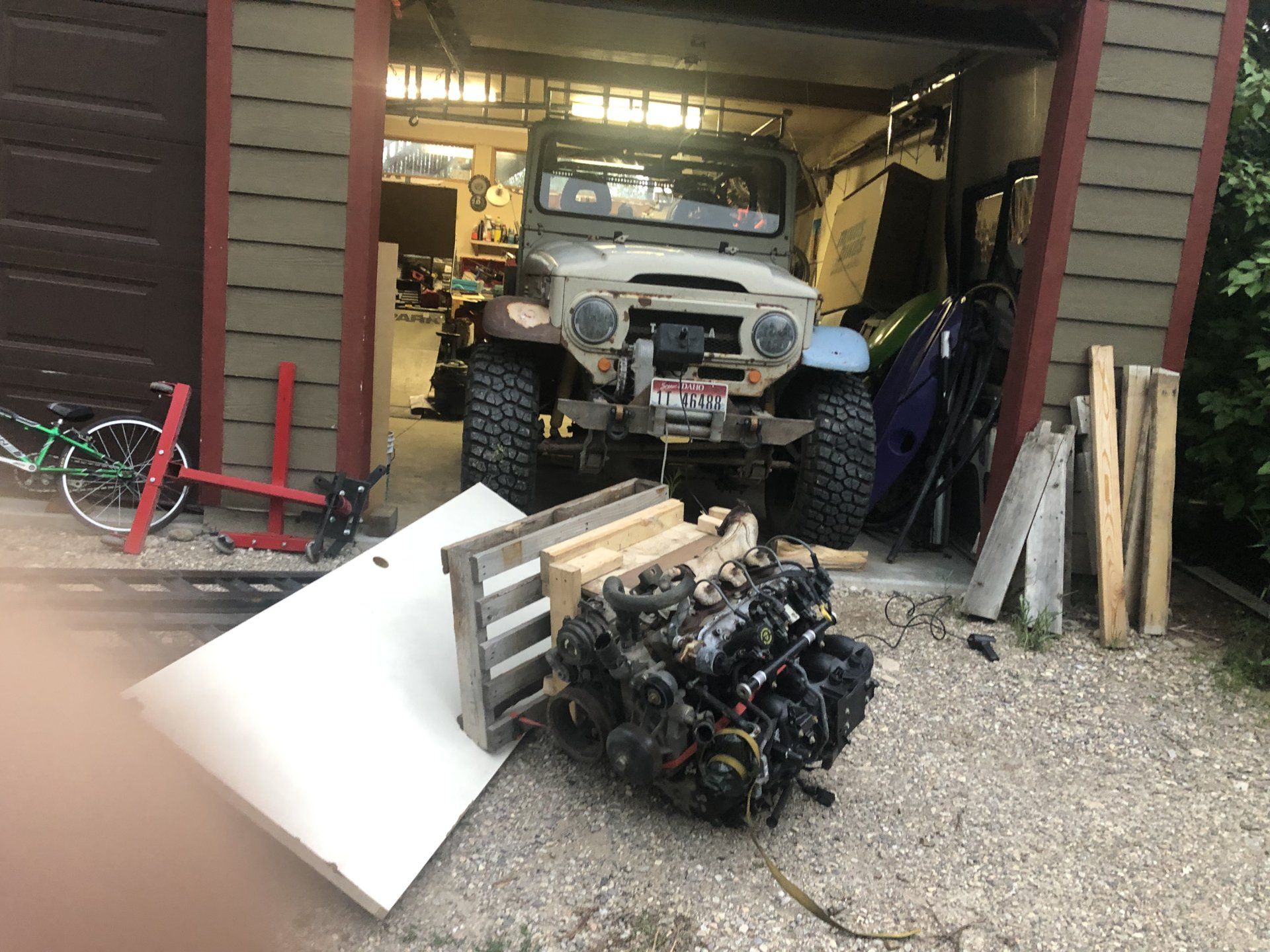

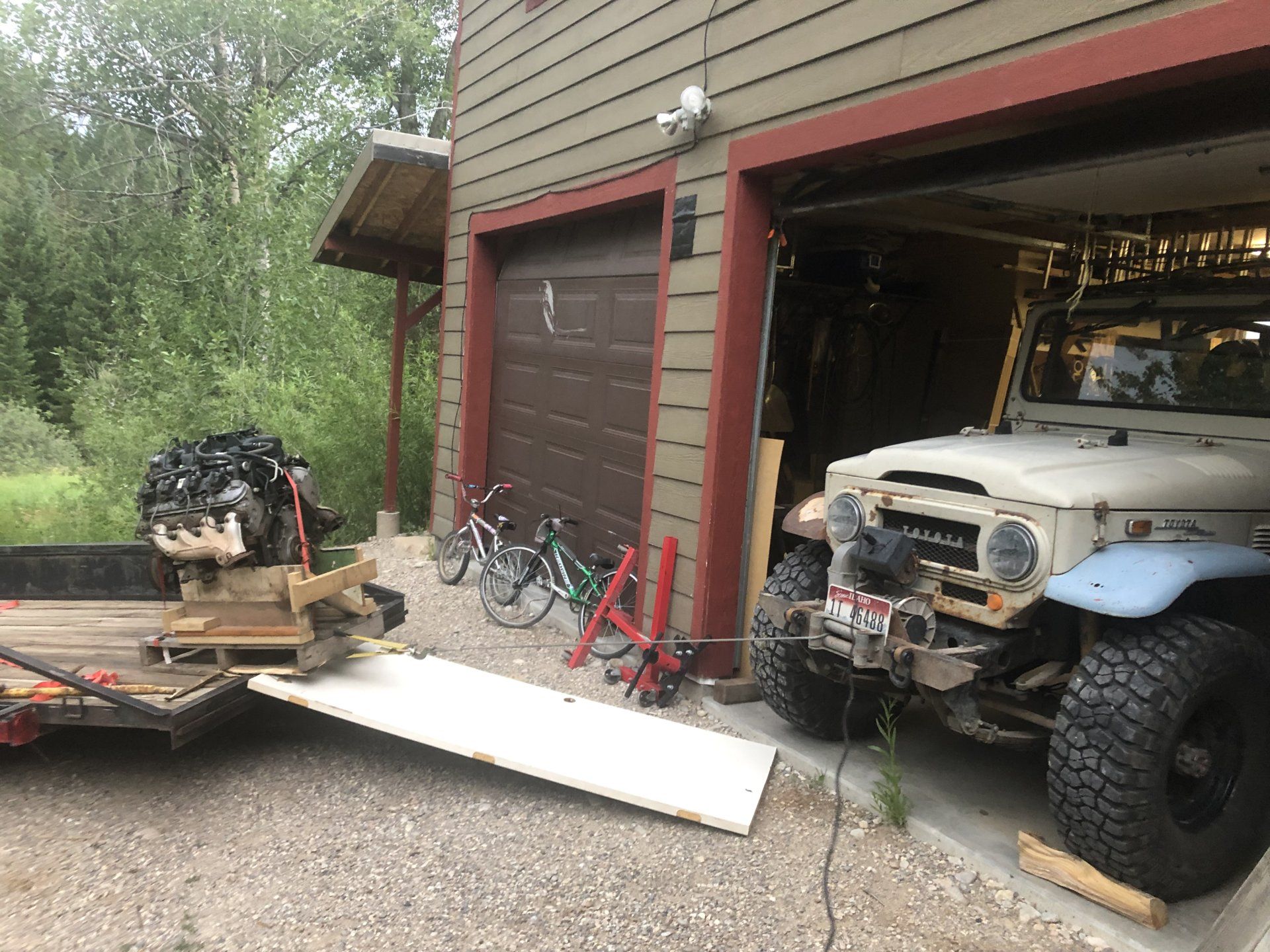

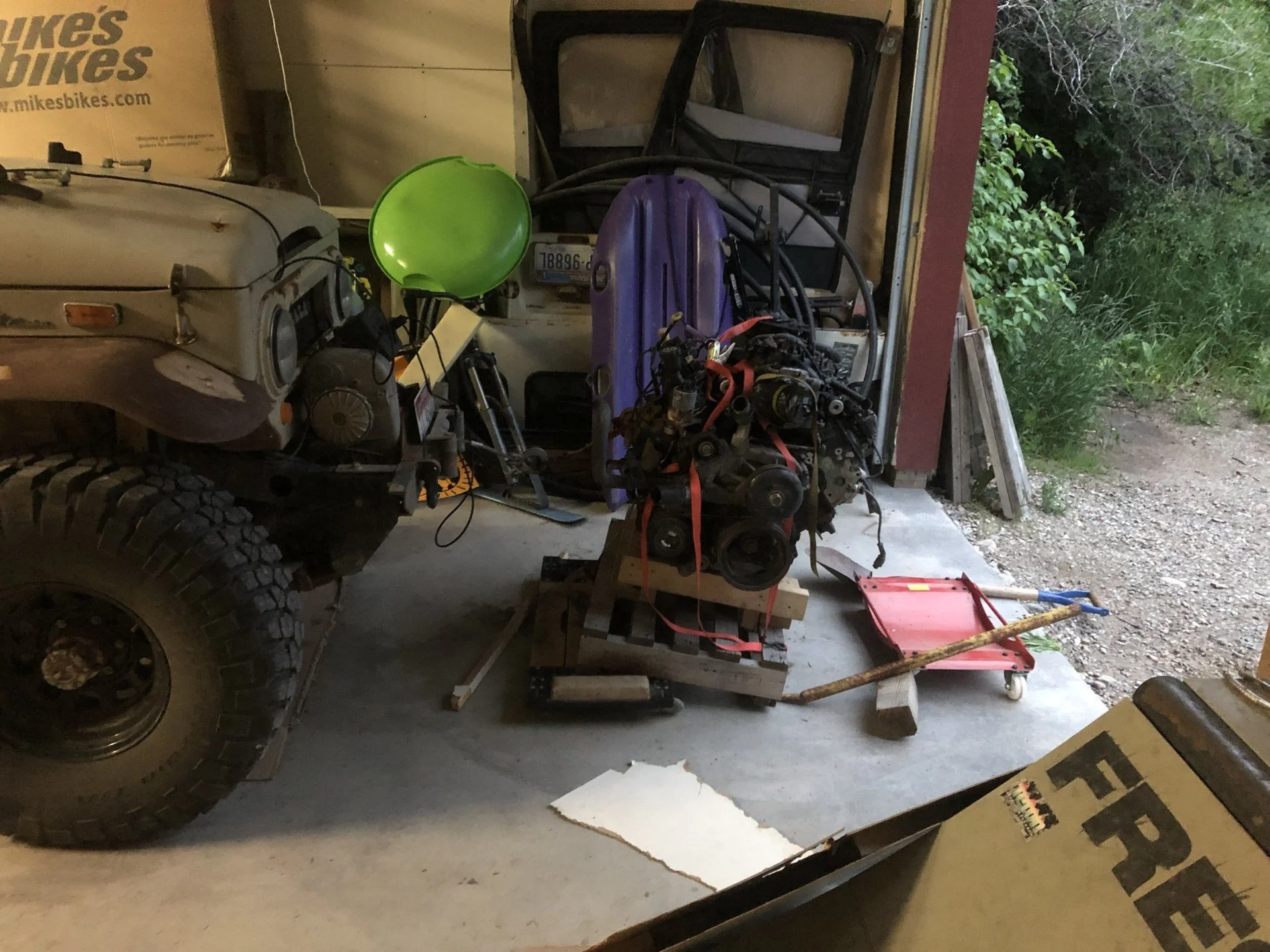

We went camping in Island Park last weekend and the day before we left I was cruising the classifieds and found the answer to the timing issue.
So this happened:
Unfortunately, this also happened:
But ultimately this happened:
It’s in the garage, out of the rain. The cruiser is stuck until I figure out how I’m getting on the stand.
It’s a 5.3 I found for $500. It was the best price I’ve found. (Of course, a 6.0 with similar miles for $800 popped up two days later.) My 350 is ok, but I had an itch for something else. I’d considered an EFI Kit, but t wanted more than just TBI fuel management, I wanted the promise of newer technologies. An extra 100hp didn’t hurt, either. I’m still wincing at the thought of spending another $1000-1500 in bits and pieces. It won’t go in until winter at best, God knows I have enough half finished projects to work on for now. Maybe an NV4500 will fall in my lap as well... then I’ll need split case too. It never ends.

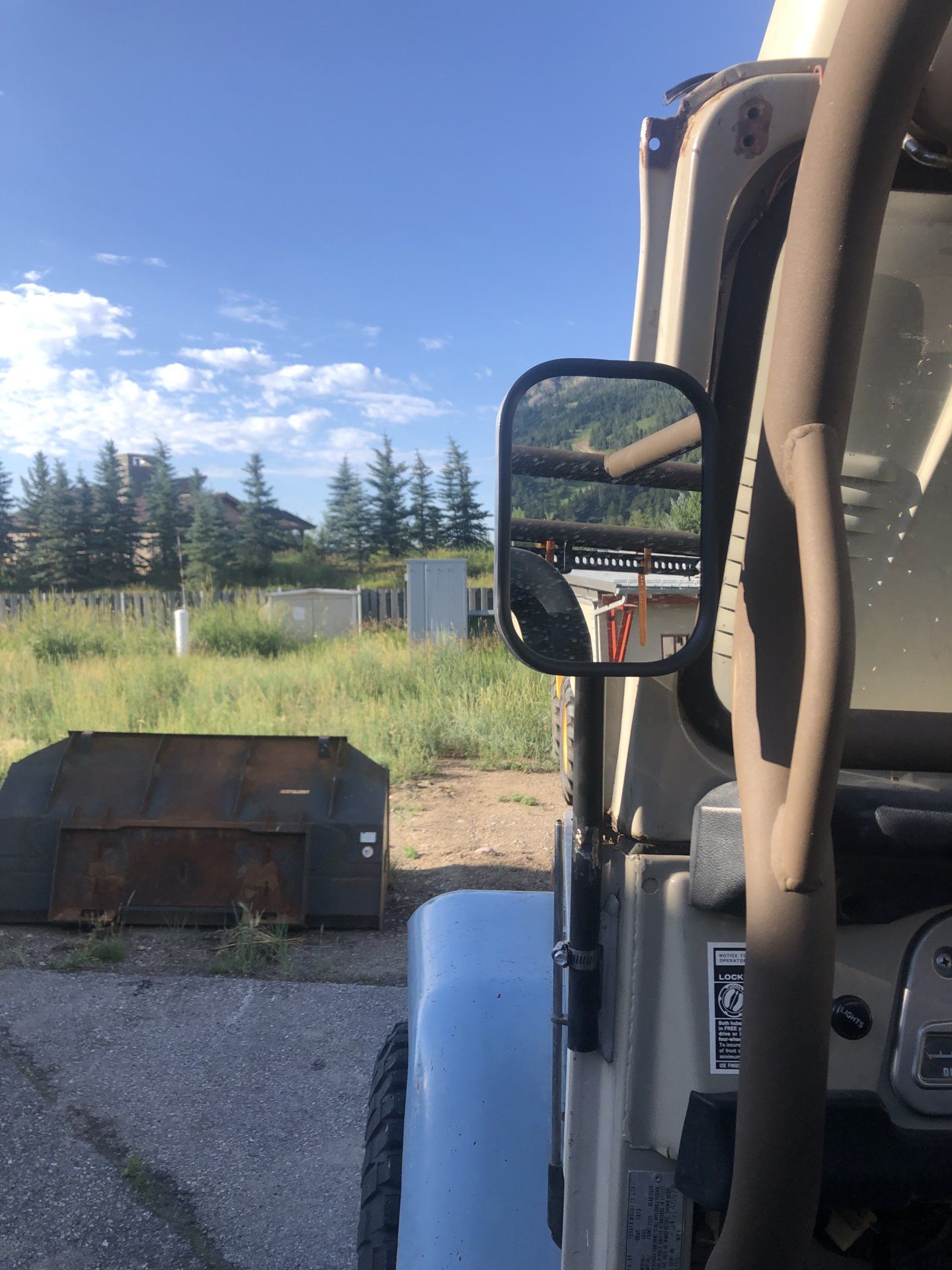

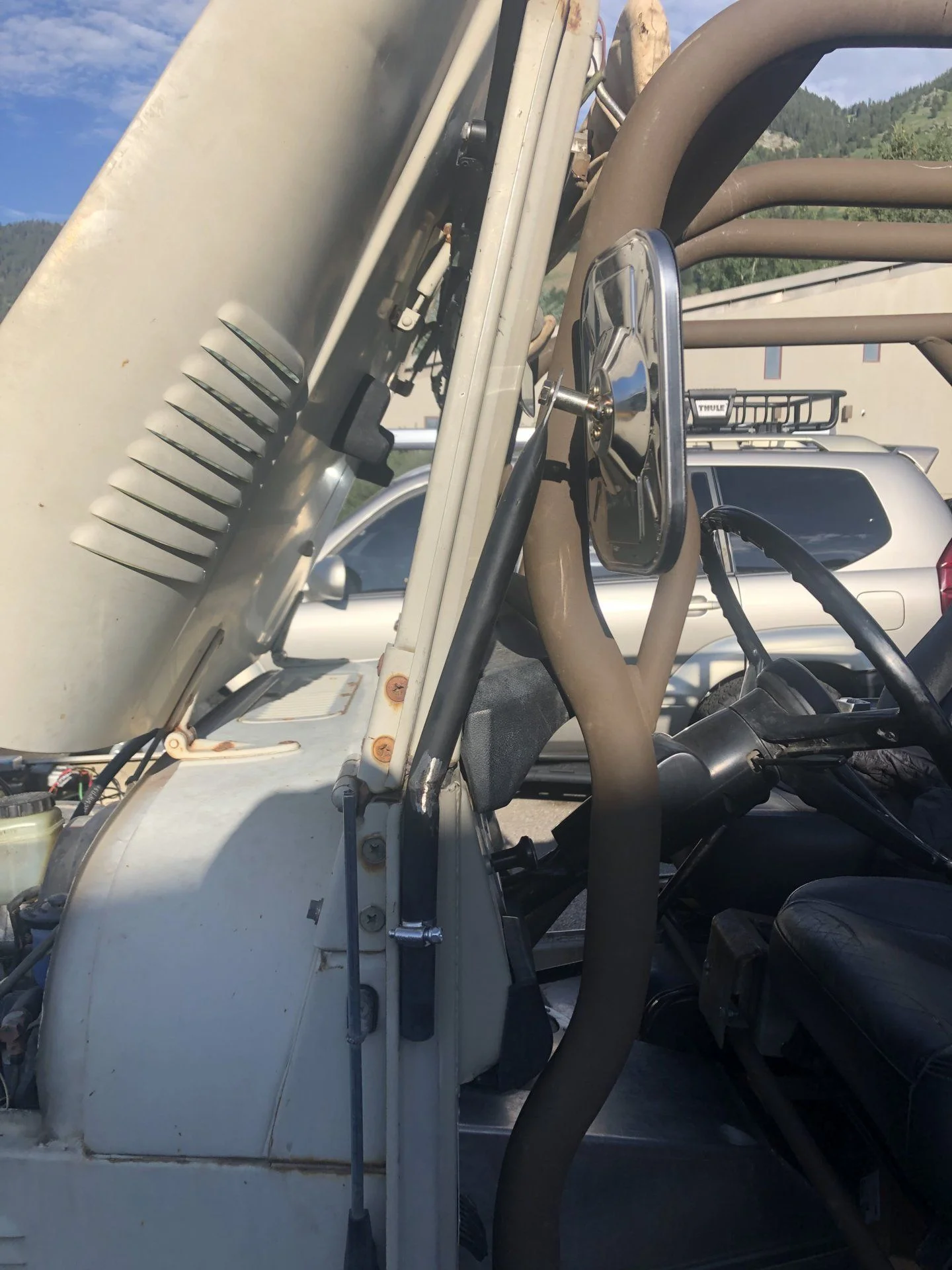

So a very nice gentleman informed me that I had 30 days to get a side mirror to compliment the rear view mirror. Oddly enough the wife had asked when I was going to get some last week. So that’s two against one.
So here’s the needs and desires for the mirrors:
  1. Need to be low profile
  2. Easily replaceable
  3. Sturdy enough to take a few branches
  4. Not cost as much as the oem units
  5. Satisfy the law

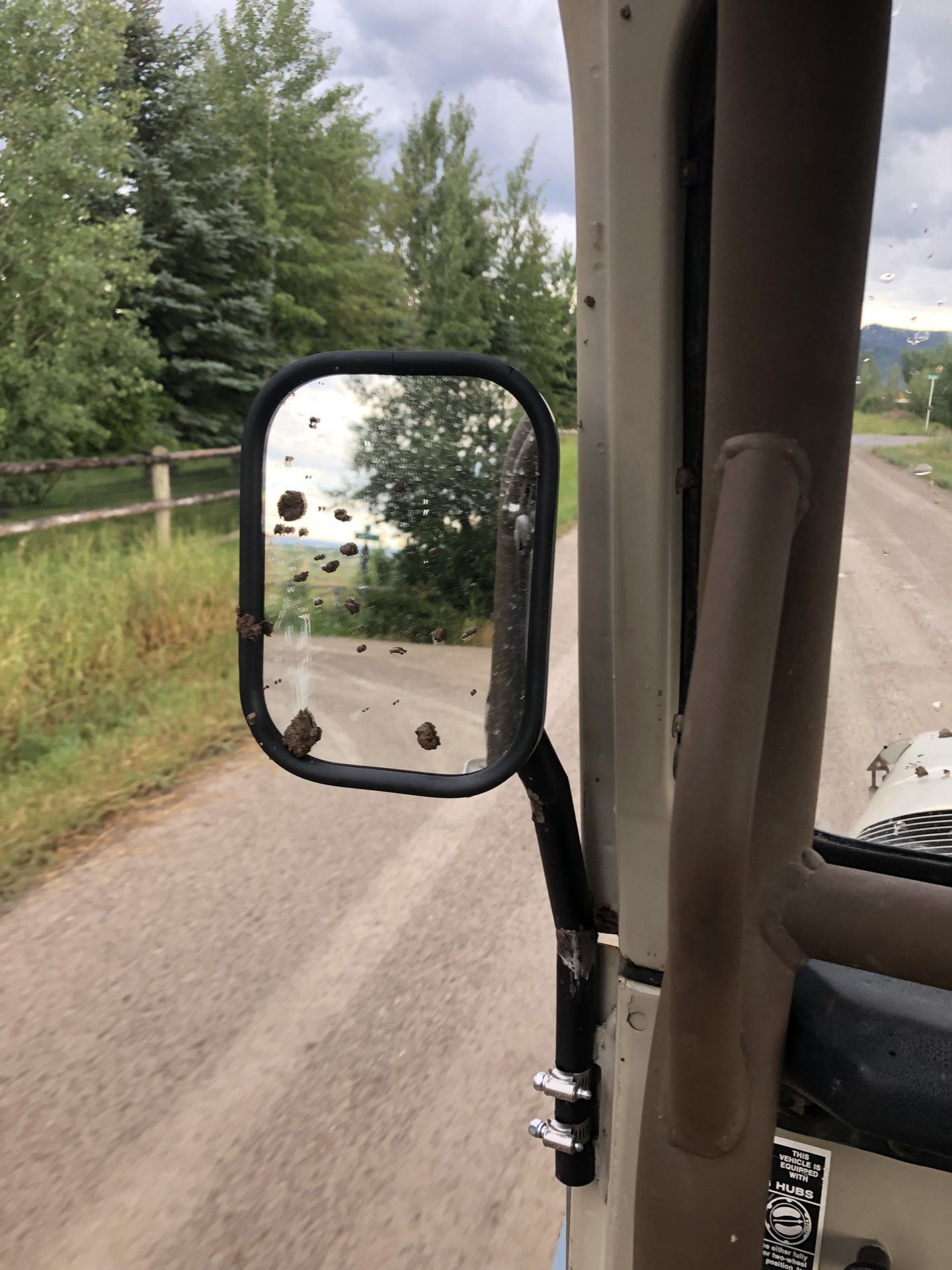

Version 1.0
Not bad, I can’t take the credit though, i found a video of someone reviewing an Outlaw Offroad product. It was a simple enough product and it met my criteria. Off to the scrap pile...
It needed to be a thin wall to clear the hinge and the rib. Found some old cheap lawn furniture-perfect size and wall thickness. A quick cut to create the bend at the windshield and another to get away from the body. A slot to clear the door hinge and some hose clamps to snug it up.
Looks better with some dirt on it. Version 2.0
Couple issues-
  1. Hose clamps are ugly
  2. Needs paint, I’m thinking pewter
  3. It vibrates
Yeah there’s some vibration, but 35” MTs will have that effect. Even sitting still idling it has some vibration. It’s quite bearable and simply touching it will steady the image.
I’m all ears on getting rid of the hose clamps.
So that was a long post for a mirror...
