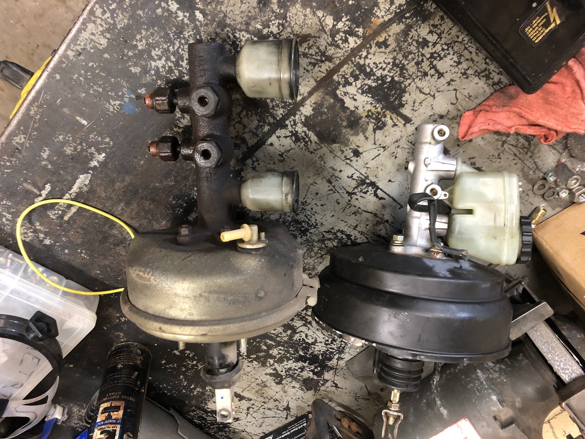

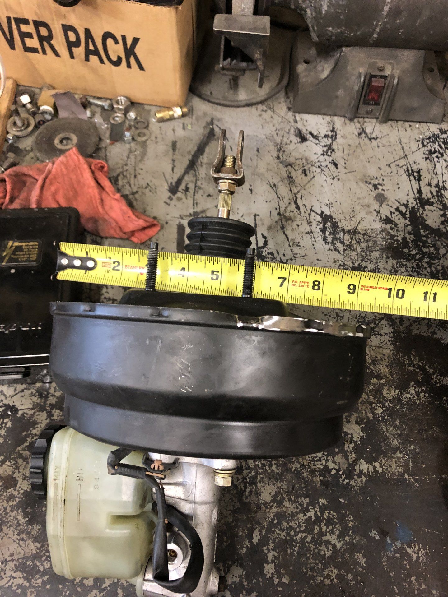

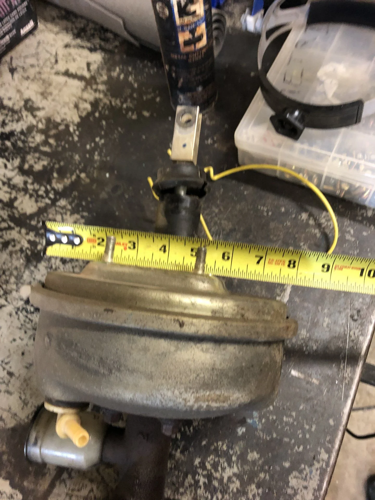

This weekend I worked on swapping the parts from an old early ninetys mini truck: booster and both master cylinders. The booster is an inch or so bigger than oem unit, but otherwise it boots right up.
Th
The other reason for this swap was the old brake master caps. Whenever I climbed a steep hill or up a ledge, the old one would spill fluid. The old caps were a loose fit at best. The new one has a locking cap that hopefully will mitigate this problem.

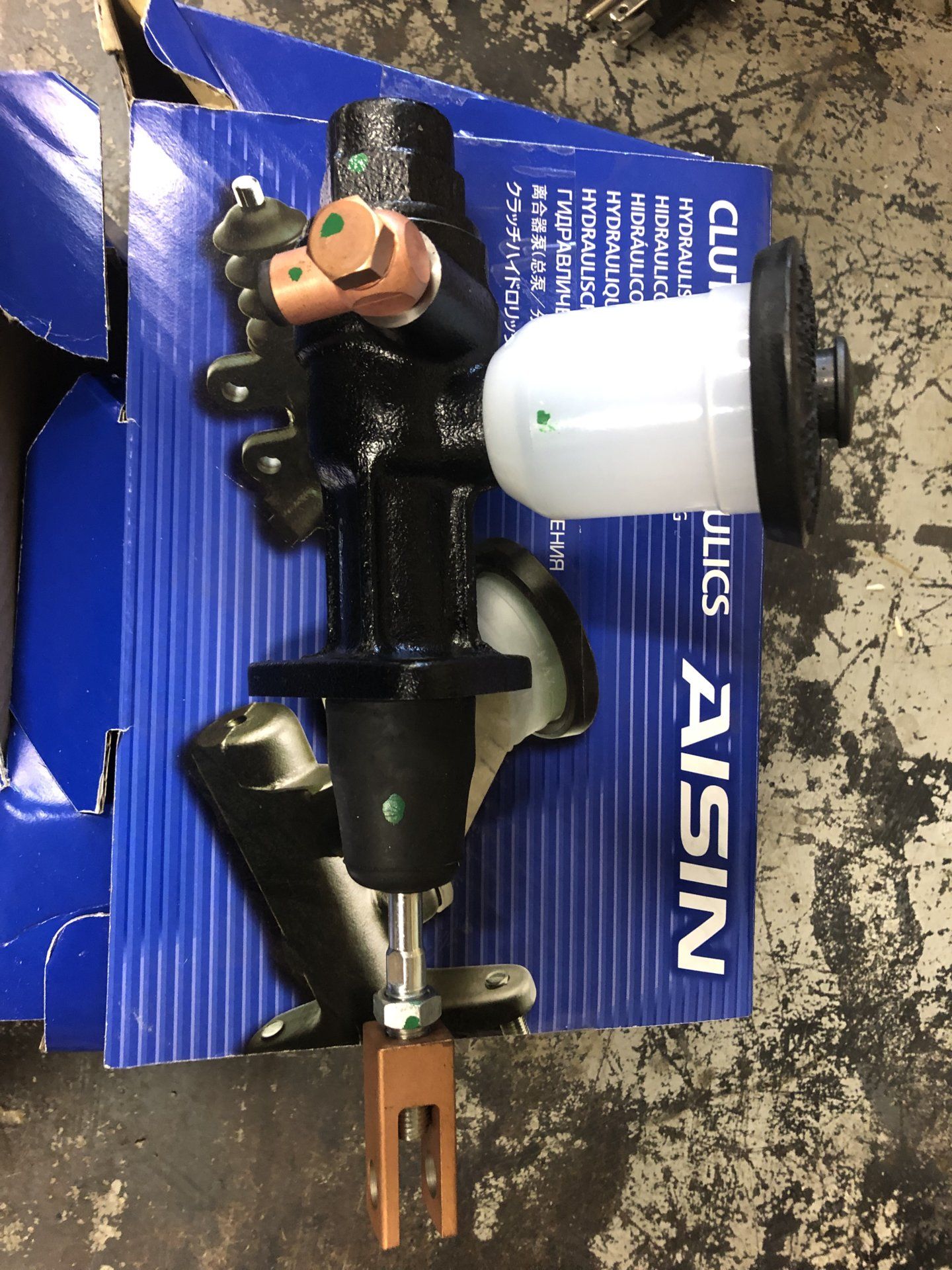

The clutch master swap wasn’t as straight forward. I had done some internet prowling on this master and it’s it gets mixed reviews . I figured it was cheap enough to try it out- I’d just be wasting my time.
First step was to make an adapter plate from some scrap. The oem on a 73 has a triangular mounting pattern, the new one has a diagonal two bolt design. This was pretty easy, but took to long as usual. Next I realized the pushrod was the wrong length, I swapped them. A new hardline was bent into a workable shape and we were ready to bleed the system.
So I think I got the air out and I’m not getting enough motion on the clutch. I’m running a 350/sm465, so it takes a pretty long throw as I understand it. Bummer, I wasted a bunch of time on this, but I knew it was possibly going to end this way. So I bit the bullet and got a new Aisin master/slave shipped to me. I’ll put it in and stop trying to reinvent the wheel.

So this fixed the clutch issue. Rock auto had a pretty descent price if anyone is looking for one. Should of gotten one in the first place, but it’s fun to try things out.

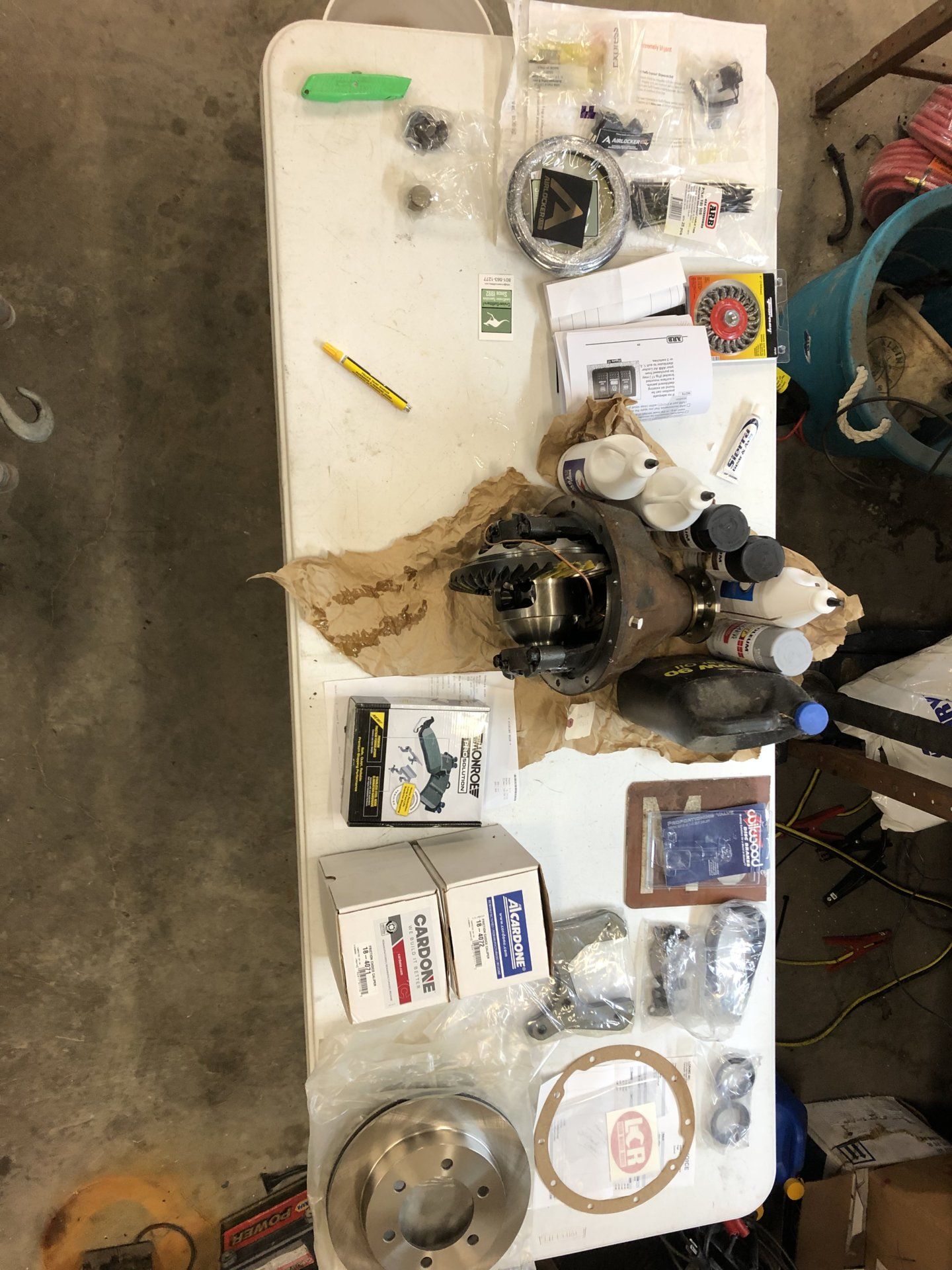

Table full of goodies:

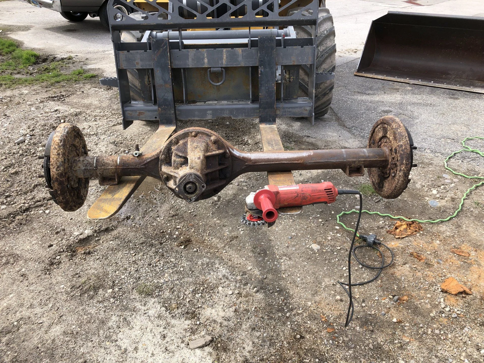

I got the axle out with out to much drama, the u bolts put up the most resistance. The Milwaukee 1/2” impact may have given up the ghost trying to get them off.
After a trip to the Hotsy, I hit it with the angle grinder to get the scale off. From there I started pulling it apart. Brakes were pretty straight forward. Diff and cover studs came out all the way, which is fine I need hit them with the tap and die anyway. Damn that diff is heavy or I’m old. Once the housing was fully bare, I hit it with Naval Jelly and a coat of primer. I re-drilled the perches to move my axle back 1 1/2” as well. Tomorrow I hope to paint it and reassemble it- maybe get it in the truck...

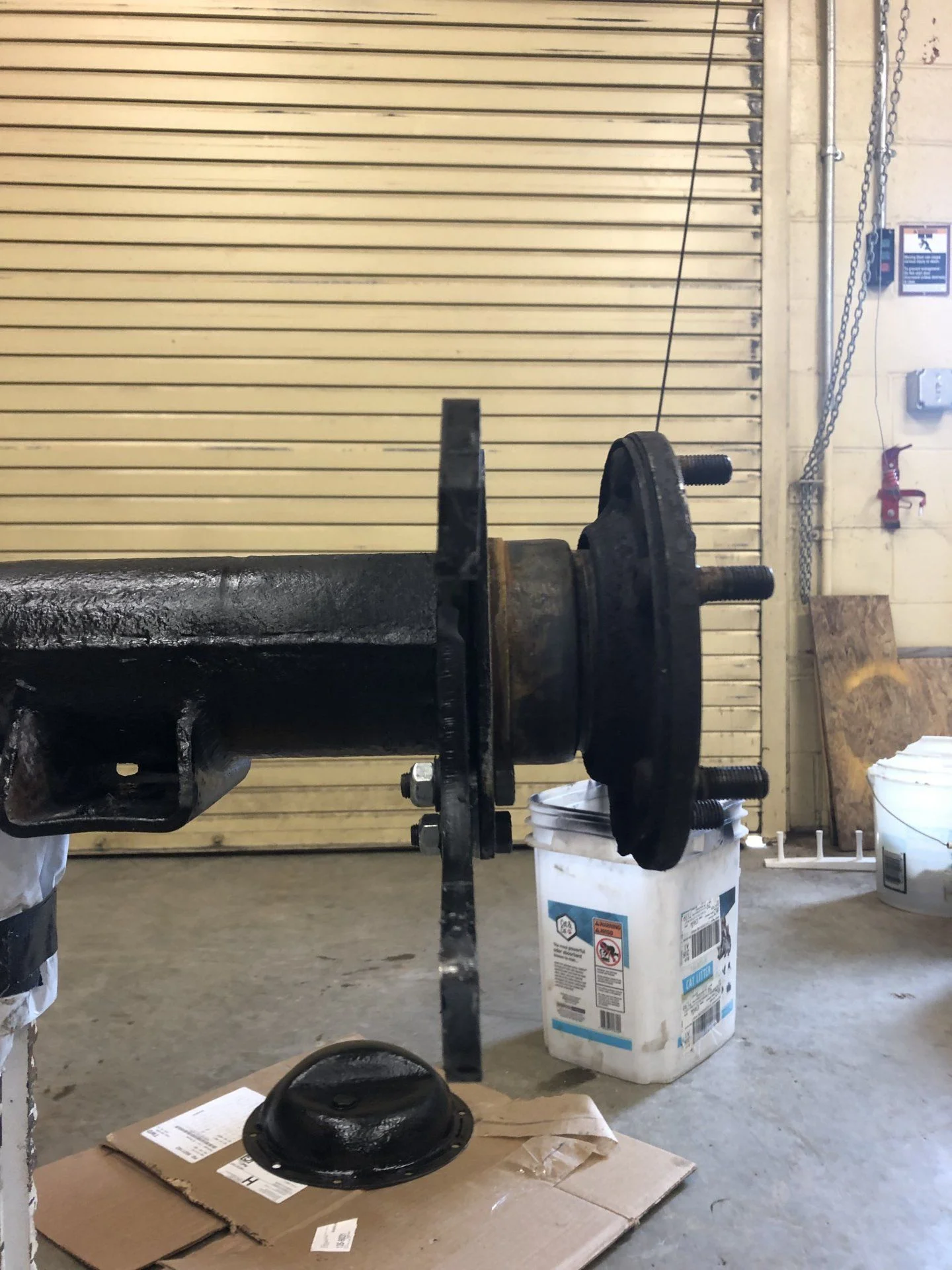

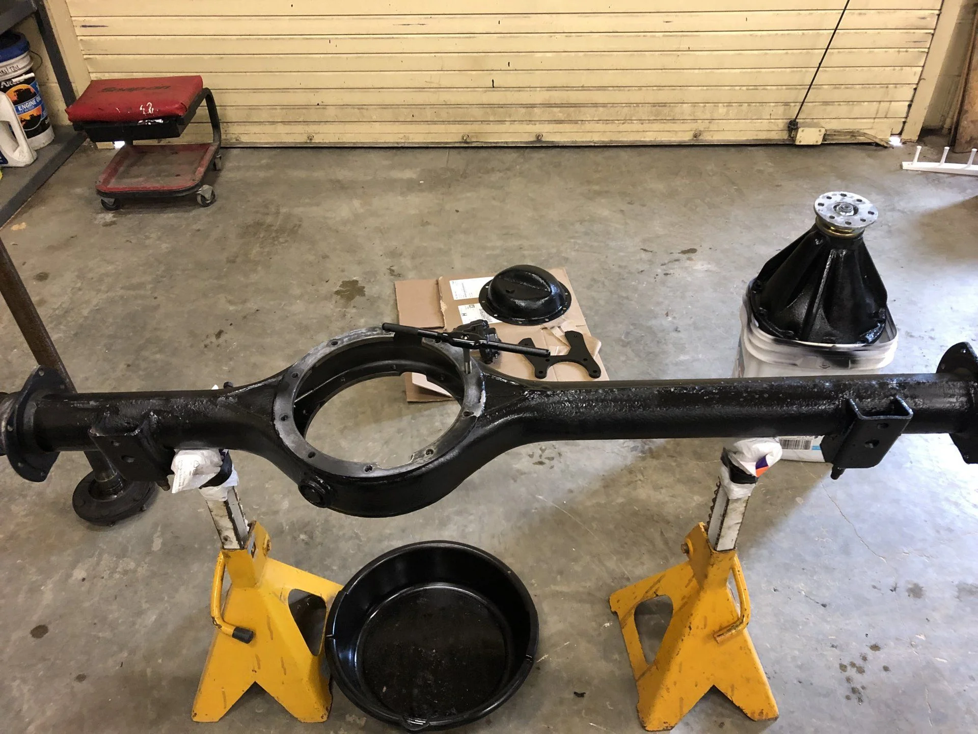

So it begins. Everything got a hasty derusting and paint. This will be used off-road, so I didn’t see a need to a meticulous paint job. Threaded holes and differential studs were chased, but the cover studs were to rusted to save. I soaked them in atf over night to no avail. These will need replacements. 80 series 3rd member w/ARB went in slowly- as this was a fist for me, so I was double checking each step. I ended up using the thickest C-clips on the axles. During clean up I found a piece of the locker that I forgot to install, I think it’s a center cross pin. It looks kinda like a cross pin with a stack of washers in the middle. (After some thought, I think it must be the spacer between the axles). Unfortunately, I forgot to take a picture and I can’t find it in the online parts diagrams. As good as the ARB instruction sheet is, I could of used a couple more pictures/diagrams.

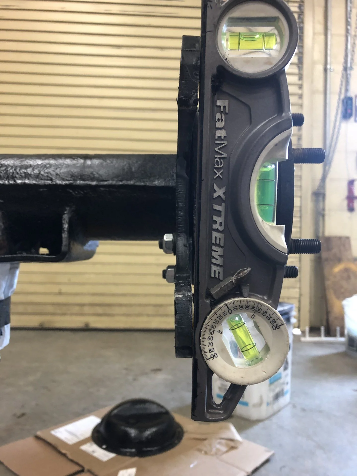

@Poser brackets were next. I printed out the thread of his install, so I could follow step by step. There was a slight warp in one of the brackets that caused some misalignment of the caliper pins. ****Edit: after talking to @Poser, he informed me I had the spacers in the wrong place, once in the right place they were honky dory.**** I did get it work, but it took a little doing to get them lined up. Overall, I’m happy with the kit so far. Rotors were perfectly fit on the axle and the brackets were high quality in feel and looks. It seems the kit is complete and I like that he breaks the parts down into individual bits, so you can choose what you want. For anyone looking, rockautos shipping ended up costing $30 more in shipping than Amazon Prime.
So I was hoping to have it under the cruiser by the end of Sunday day, but it didn’t happen. A couple missed steps and some unforeseen tasks cut into the time frame. Good news is after getting new differential cover studs and and couple other small things the axle will be back under the cruiser.

Thats strange that the bracket is warped. Can you put it in a press and push it back flat?
I’m going to try the press when I get back to it. By the time I figured it out I was out time and had to get to the movies. My only concern about using the press is if the bracket was warped when the holes were drilled/tapped. But they seem slightly misaligned as well.
This isn’t a slam on poser at all, his kit and service seem good. Things happen. The other side went well.
What about just having him send you a non-warped one?
