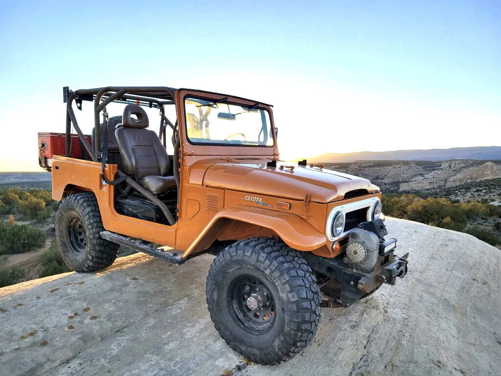

I didn’t take any pics, but one of the guys sent some more from Vernal so I’ll leave you with some vanity pics.

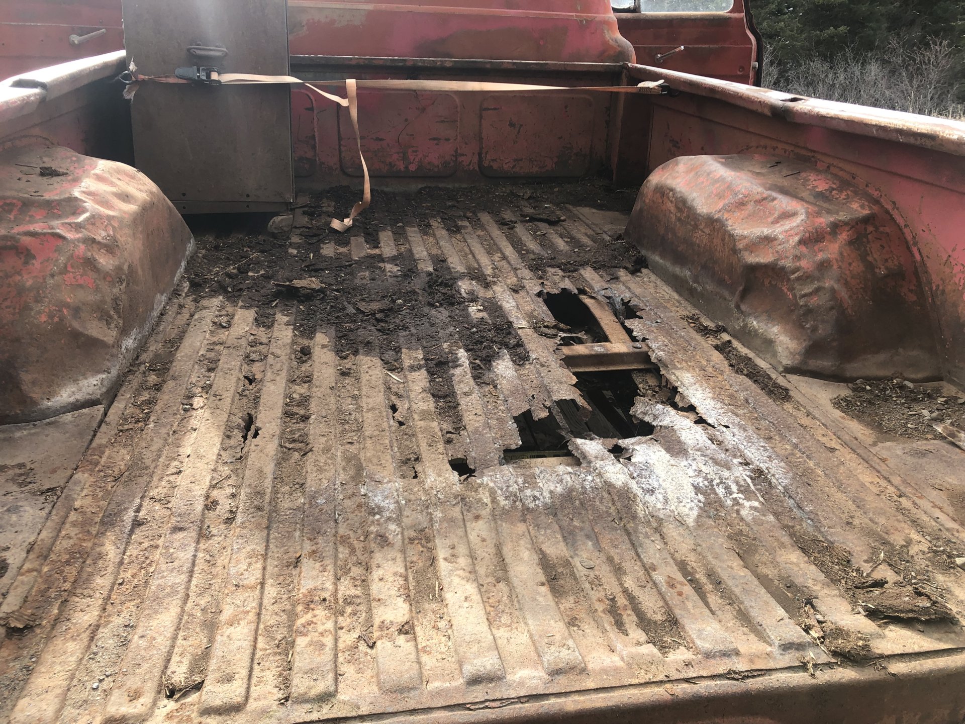

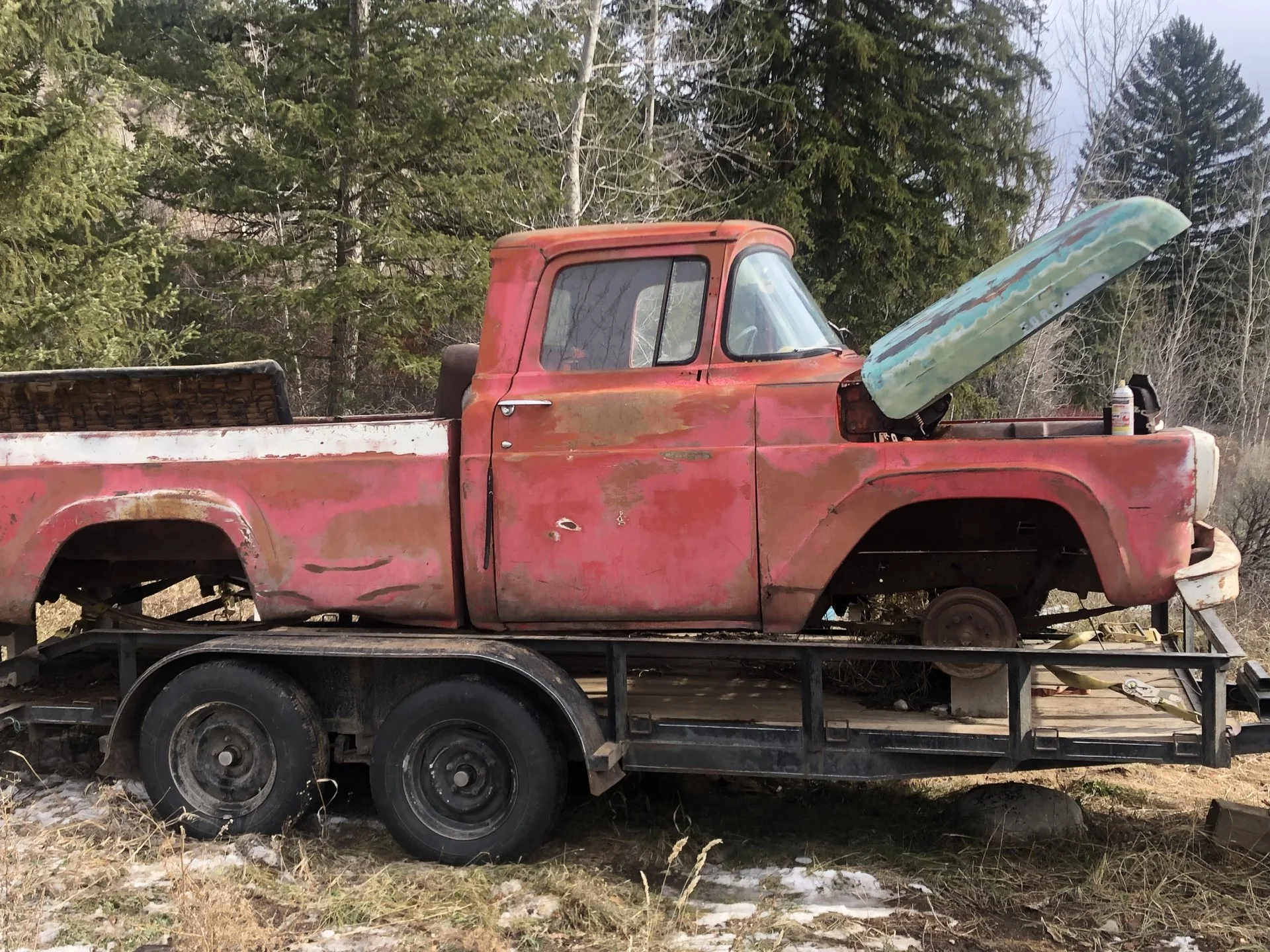

So maybe I’m delusional, but I picked up a distraction. 1959 F100 2wd long bed, no engine, transmission or rear axle.
It’s gonna be a patina build for the time being. I’m really digging the look, we’ll see if I do by the time it’s running.

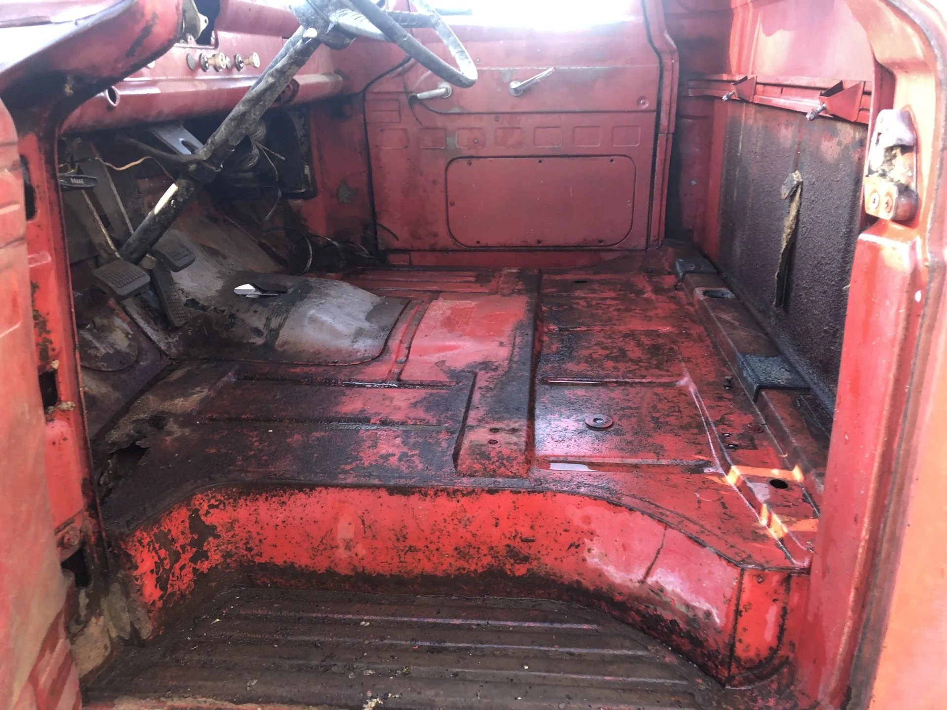

Believe it or not, the rust isn’t that bad. I mean the bed floor is complete toast. This was pulled out of a field. The bed has had 2-3” of dirt sitting in it since it was taken off the road in 71. All that dirt was a hell of a sponge, this was in the high dessert of Idaho.
I’m thinking of bracing the sides and ripping the floor out and welding in a different floor. Or maybe a wood bed or…
This(& the price) is why I bought it. The cab corners are good. The floor only needs the area above the cab mounts replaced.By that I mean, there’s are other areas that need work, but the cab is really pretty good all this considered.
So that brings me to the reason for the purchase. I was looking for a means of getting the kid in the garage with me. He wants a long bed truck to haul bikes up the pass and I love old iron trucks. So we found one we could agree on. Wife wants it to not be another bottomless pit(cruiser) & she has her wants for the house.
Not sure where this one will go yet. Definitely, a patina build. I already have a built offroad rig. I’m not really a speed freak. Lowered trucks are cute, but…I’m thinking of an awd canyon cruiser, maybe a 5.4, exploder drivetrain with fully independent suspension. Just a thought. One thing is for sure- there is t enough left to go back to stock.
So we’ll be mothballing this for the winter while we come up with a plan. After all, the original money pit isn’t finished yet and I might come to my senses.

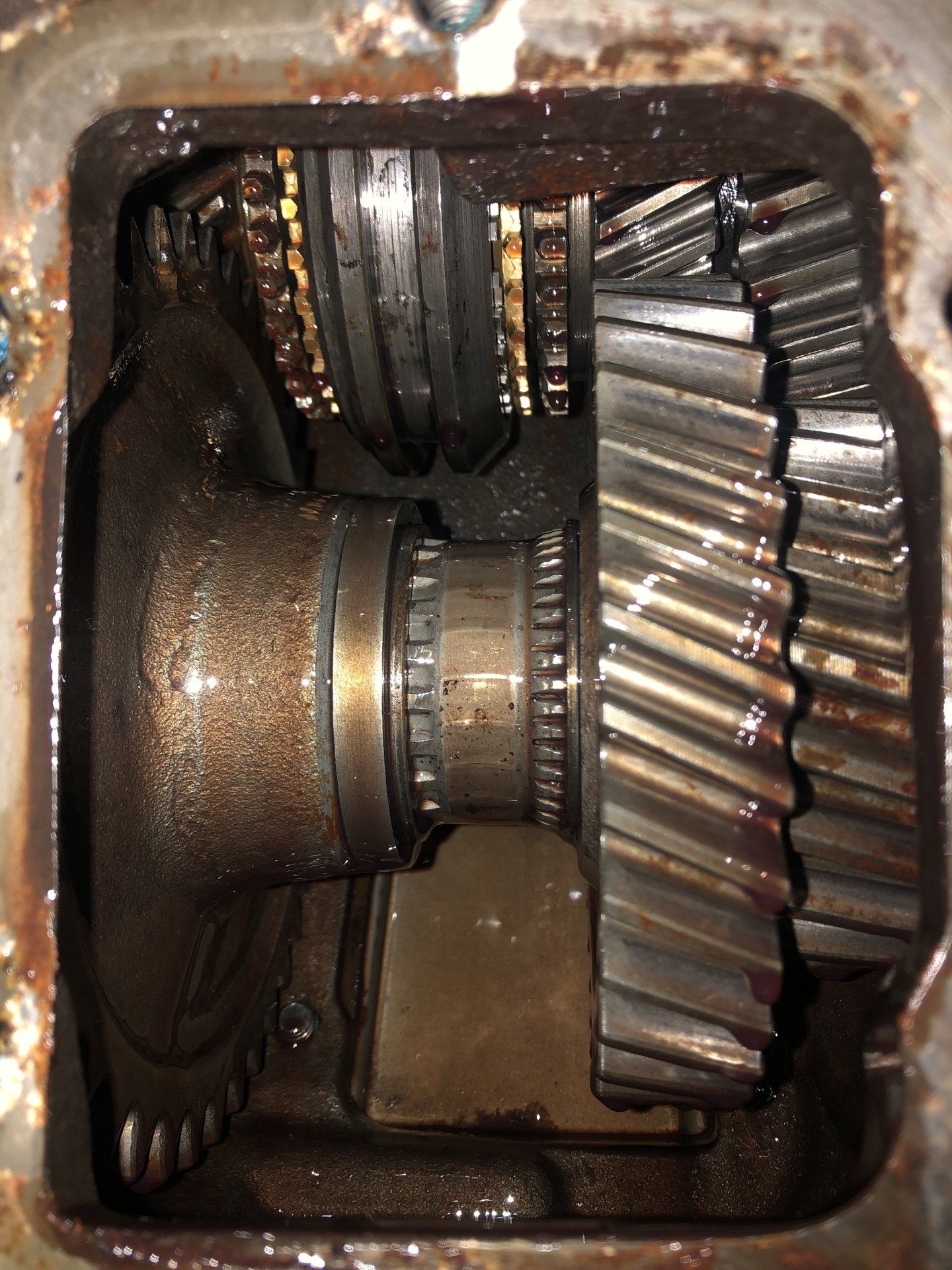

Well we’re back on track, if slightly distracted by the Ford. The area of concern is transfer case not staying in gear- there’s a lovely discussion in the O R I O N sticky. Couple of the potential candidates for the problem are the hi-lo range check ball/spring, shift rail and fork- the AA replacement parts may be slightly out of spec. In addition, my 47yo shift linkage is pretty sloppy and I’m not positive its not contributing to the issue. So after I access the other potential bad players, I’m going to fab up a twinstick shifter that isn’t loaded with slop.
A tangential project is I’m getting rid of the AA propeller xmember. @Mopdog has inspired me to follow his lead on his style SM465 crossmember. I have some ideas that’ll put my own spin on his prototype. Drained the transmission and pulled the pto plates off today, I’ll use them as templates this weekend at work. Here’s what the gears look like:

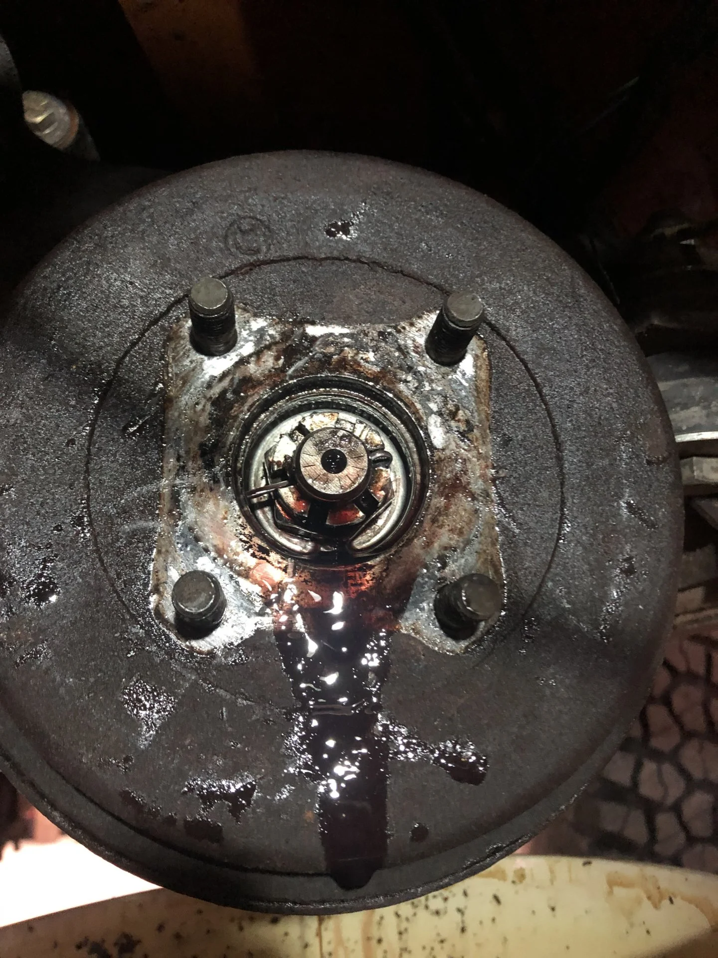

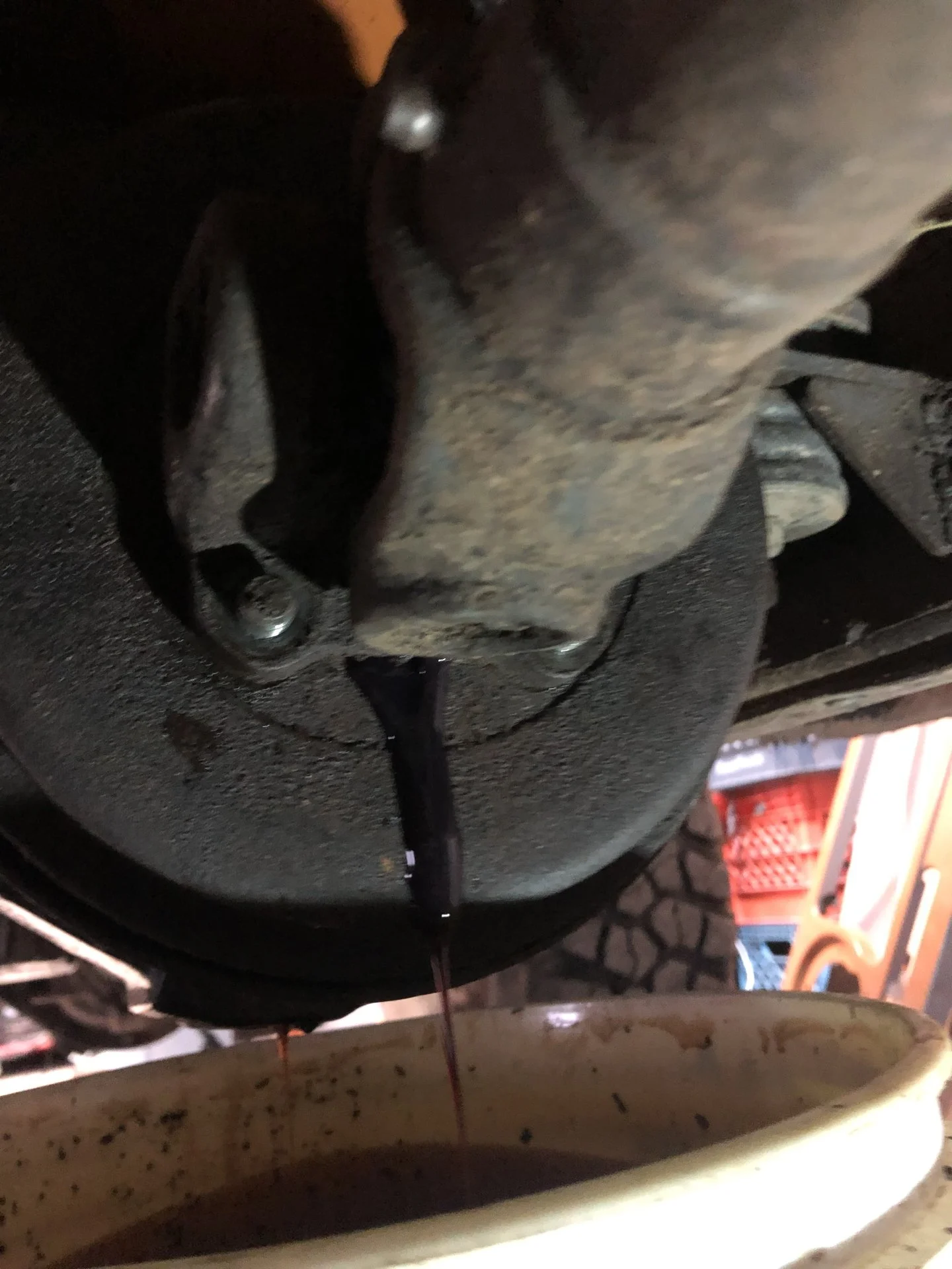

So without further delay, I dug into the transfercase. I was breaking the driveshaft loose when I got my first surprise. This will be a familiar sight to some:
I guess Ill be doing either a dual seal mod or a speedy sleeve- I’m open to suggestions.
Thats not leaking because of the seal. That's leaking because of no fipg on the splines before installing the drum.
Is that the reason for drip at the bottom drum as well? That’s been happening for a while…

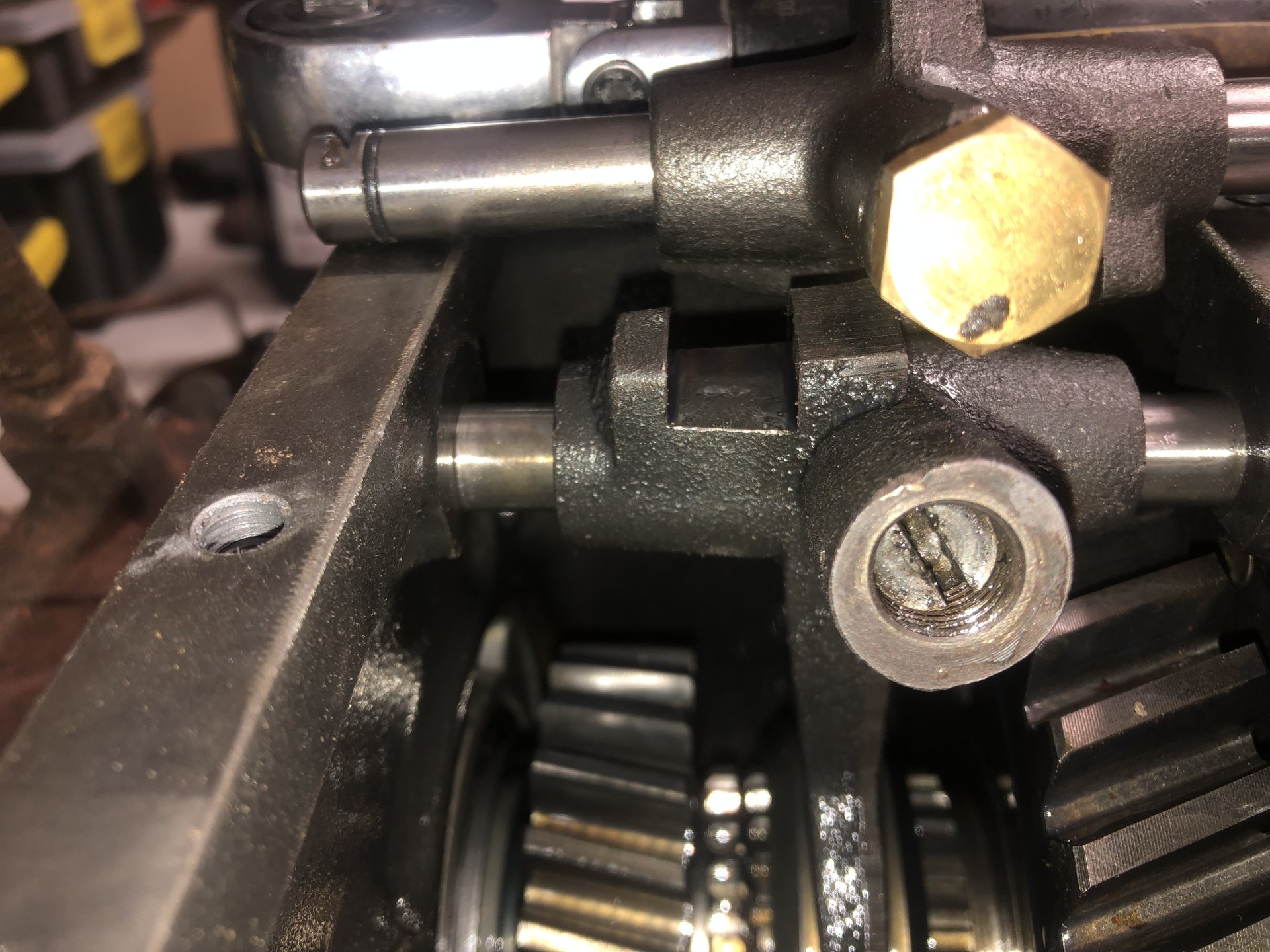

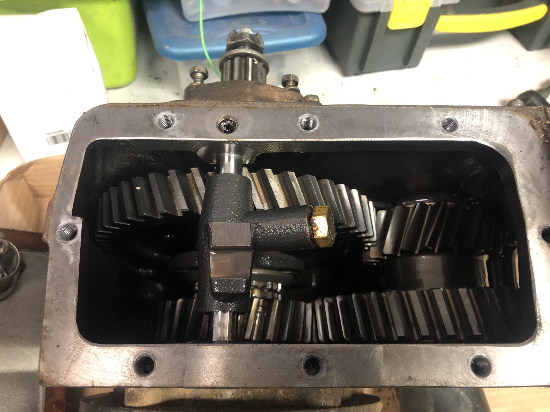

So winter is upon us and the magchloride is on the roads, so time to do long over due repairs. I got the Orion out today and onto the bench. The offending bits:
As a refresher, I have the same problem as others of not holding lo range when coasting. In addition, mine is popping out of high range at highway speed when I take my foot off the gas, but leave it in gear. This can be very exciting at times. My case and gears are a year or two old and I (for better or worse) built it up using AA’s instructions. From this thread, I’ve learned the common theme in fixing the issue is related to the shift fork or rail.
To my untrained eye the AA&OEM shift forks and rails look similar with minor differences, but nothing I would consider detrimental. The AA fork is clearances for the 4:1 gear and the oem isn’t, so I stuck with the AA unit. The AA shift rail has a detent for the set screw (case), but otherwise looked like the OEM piece. The indents looked exactly the same in size and orientation. I had thought maybe the indents were maybe slightly out of orientation, but I couldn’t find a difference. Since others had pointed to the oem shift rail as superior, I put it back in. In my case I think either would have worked.
The real difference I could find was in the spring, ball and set bolt for the spring. (I’m pretty sure I didn’t mix the parts up, but I can’t be sure). The springs- the AA(silver) one seemed a mm or two longer the the OEM(black). Balls- one was slightly bigger(AA) ~1/2mm. The set bolt- here it’s easy to see the difference: AA uses a brass bolt and OEM uses a set screw. So the brass screw only goes in so far and might not go deep enough to hold the gear. While the set screw can apply more like pressure.
To my eye, this seems like the solution the problem: the taller spring, bigger ball and the Toyota set screw pushing further into shift fork. Cycling the shifter shaft on the bench seemed to produce nice firm shifts. I’m not positive it’ll fix the issue, but seemed reassuring.
Does this sound like a winning solution? The Tcase is still on the bench and likely will through the holidays, so I can still easily change out the parts.
This is how far the set screw is in the shaft:
Is ~1/4” to much insertion? It’s below the cotter pin, but the CP still acts as a fail safe. I was doing the insertion by what felt firm. If this is ok, I’ll need to loctite the set screw.
This picture just illustrates the difference in set screws/bolts.
Bigger is not always better, a bigger ball will be passing the notch easier than a smaller one.
Ergo, the smaller ball will be better in keeping the shaft in position.
I’m hoping I’ll have some time to play with it this weekend. I’ll check the figment against what you said. Thanks for the tip

Can you show a pic of the shift rails from the side, curious as to the height of the peaks between detents, the bottom rail looks to have a bit more material there and also if see thru the detent so we can see if they have the same "U" shape. FWIW the pic with the slotted screw for spring tension should have a cotter pin to retain it. Try running it down just til it won't shift, then up a bit. You get a good idea in what the travel and effect of that adjustment is. With the stock ball and spring IIRC when set just off lock up the screw slot is below the cotter pin holes so you can't get the pin thru the slot but above the screw so it doesnt back out.
I apologize I forgot to take a picture ofvthe rails side by side, but they mic’d out as identical .36” indent with a .36 width at the top of the machining. Since we’re measuring things here’s some other stats
Spring height .91” & .89”
Ball diam.39” & .37”
( I don’t use a caliper for living, so take these measurements at your own risk)
Now eye balling the ball in the rail and looking for the light to pass through the gap- the large ball in the AA unit had the least amount of light passing through. I know it’s not the best way to measure, but that’s how I did it.
Next up I tried different rail and ball combinations in the transfer case. To get an idea of the force needed to switch gears, I used a digital torque wrench on the shifter lever.
With set screw threaded in .2” the needed torque is as follows:
AA rail w/ lg ball- 11ft/#
AA rail w/ sm ball- 8ft/#
Toy rail w/ lg ball- 5.5ft/#
Toy rail w/ sm ball- 5ft/#
So it seems I’ll get the most holding power from the AA/lg ball combo. Full insertion of the set screw is around .30 and the shifter doesn’t want to move at that point. Currently, I have the depth at .28 and the shifter needs 12.5ft/# to move between modes.
So is there another area of the Tcase I need to look into? My gear sets look good and the shift forks didn’t look any different that I could determine.
looks very good, you can compare the setup you had in there and test the force needed, or was that what you did before?
Yeah, that would of been great if I had tested the force needed when I initially pulled the Tcase. Unfortunately, I didn’t think of that method at the time. I think it’s needing more force to shift now. I guess I’ll put it back in and see how it goes. Real bummer there: the truck won’t be on the road til spring due to the road salt, so we won’t know the results for a bit.
