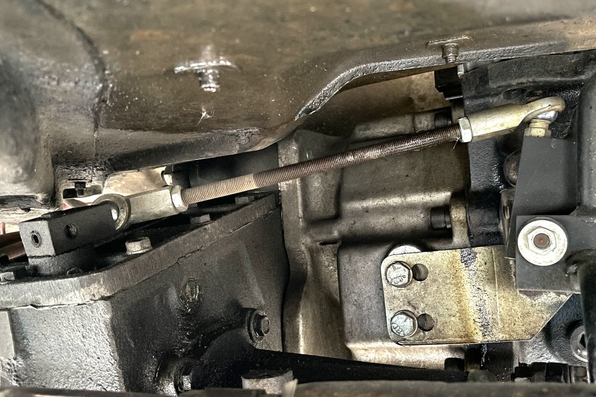

For the Orion professionals: would/could the angle of this shifting rod cause or aid in the t-case popping out of gear? Would it be better if it was less of an angle? I’m not an engineer, just made me curious after reading some things with steering angles and wondering if this may be part of my issue I’m having. Does someone NOT having issues have a photo of their linkage to share?

I don’t have a photo, but mine looks very similar to yours. My popping out issue turned out to be chamfered shift detents (kit came from AA with it) that George at Valley Hybrids didn’t notice when he assembled. He swapped it for older style square shouldered detents which solved the problem. I suspect AA thought the chamfered shoulders would make shifting easier but it is just enough for shift ball to ride out of the detent on it’s own under load. With our shifter setups, it’s pretty easy shifting with the square shoulder so chamfered is a negative.

As I said two weeks ago, the shifters only function is supposed to be to MOVE the range selecter, NOT RETAIN it. In other words, As long as the lever is pressure neutral, it should not be part of the the equation.

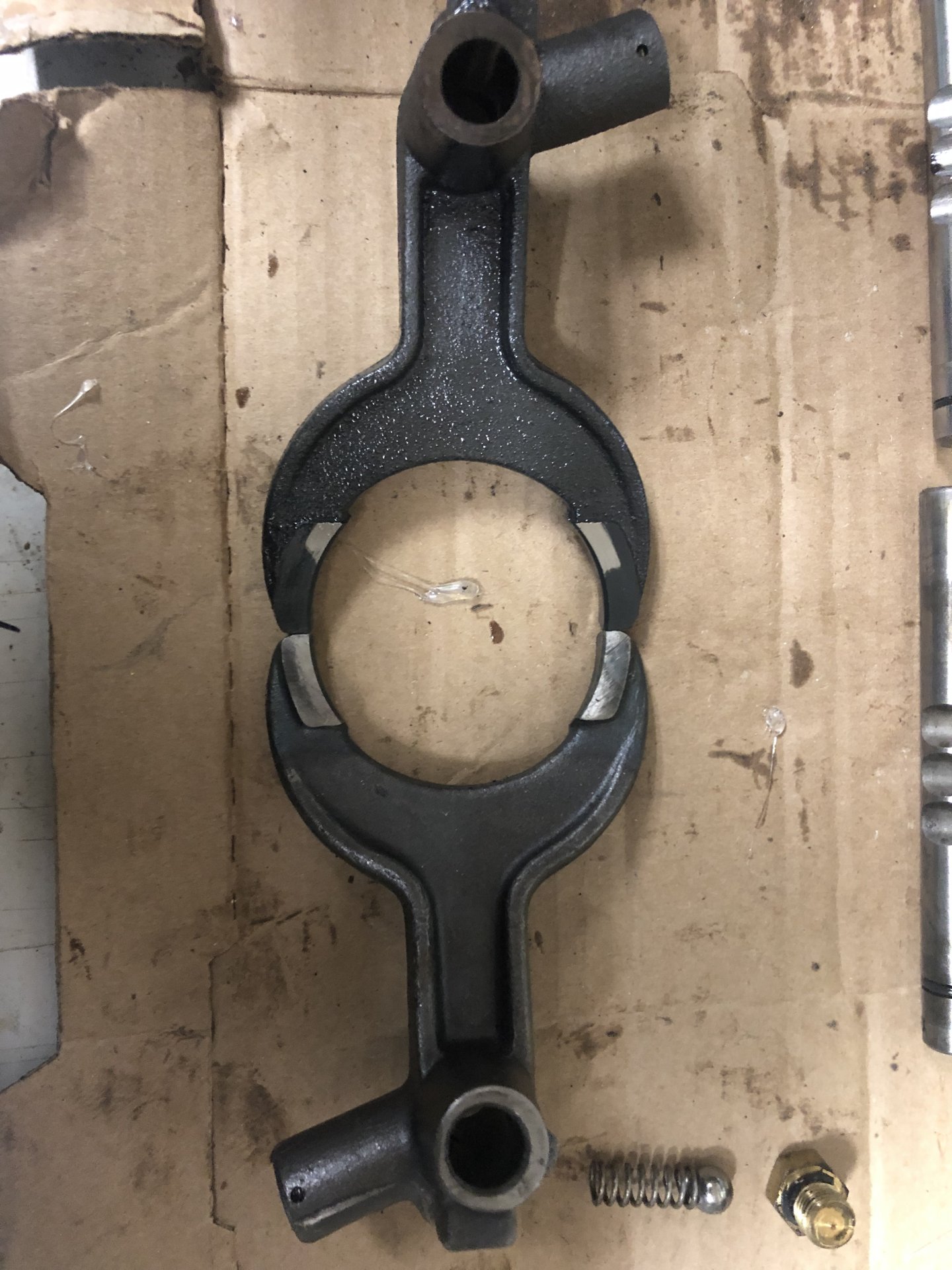

So winter is upon us and the magchloride is on the roads, so time to do long over due repairs. I got the Orion out today and onto the bench. The offending bits:
As a refresher, I have the same problem as others of not holding lo range when coasting. In addition, mine is popping out of high range at highway speed when I take my foot off the gas, but leave it in gear. This can be very exciting at times. My case and gears are a year or two old and I (for better or worse) built it up using AA’s instructions. From this thread, I’ve learned the common theme in fixing the issue is related to the shift fork or rail.
To my untrained eye the AA&OEM shift forks and rails look similar with minor differences, but nothing I would consider detrimental. The AA fork is clearances for the 4:1 gear and the oem isn’t, so I stuck with the AA unit. The AA shift rail has a detent for the set screw (case), but otherwise looked like the OEM piece. The indents looked exactly the same in size and orientation. I had thought maybe the indents were maybe slightly out of orientation, but I couldn’t find a difference. Since others had pointed to the oem shift rail as superior, I put it back in. In my case I think either would have worked.
The real difference I could find was in the spring, ball and set bolt for the spring. (I’m pretty sure I didn’t mix the parts up, but I can’t be sure). The springs- the AA(silver) one seemed a mm or two longer the the OEM(black). Balls- one was slightly bigger(AA) ~1/2mm. The set bolt- here it’s easy to see the difference: AA uses a brass bolt and OEM uses a set screw. So the brass screw only goes in so far and might not go deep enough to hold the gear. While the set screw can apply more like pressure.
To my eye, this seems like the solution the problem: the taller spring, bigger ball and the Toyota set screw pushing further into shift fork. Cycling the shifter shaft on the bench seemed to produce nice firm shifts. I’m not positive it’ll fix the issue, but seemed reassuring.

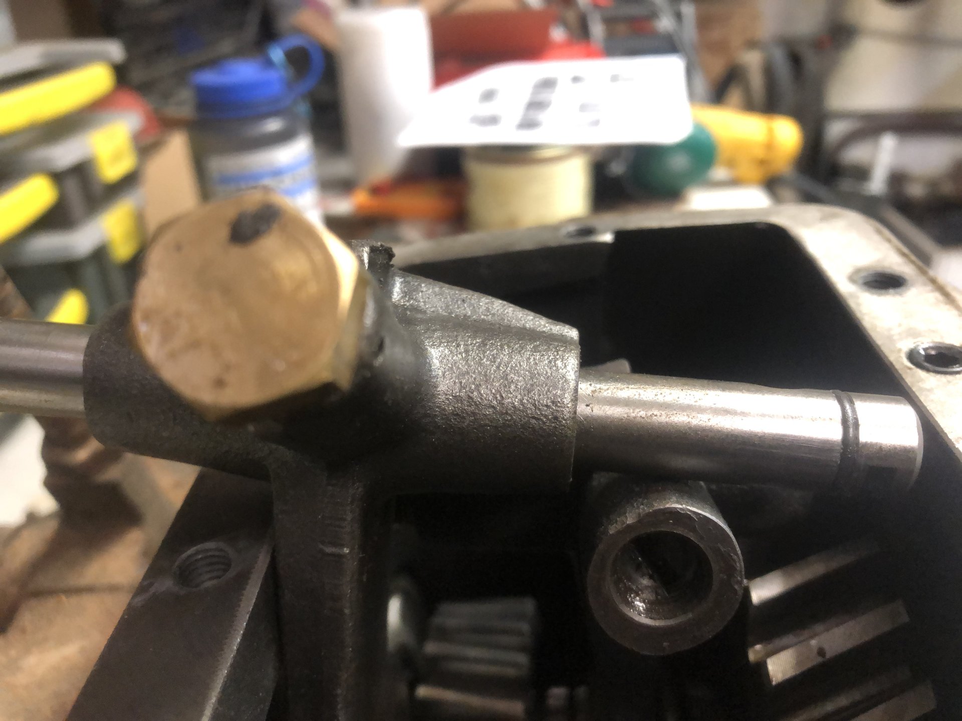

This is how far the set screw is in the shaft:
Is ~1/4” to much insertion? It’s below the cotter pin, but the CP still acts as a fail safe. I was doing the insertion by what felt firm. If this is ok, I’ll need to loctite the set screw.

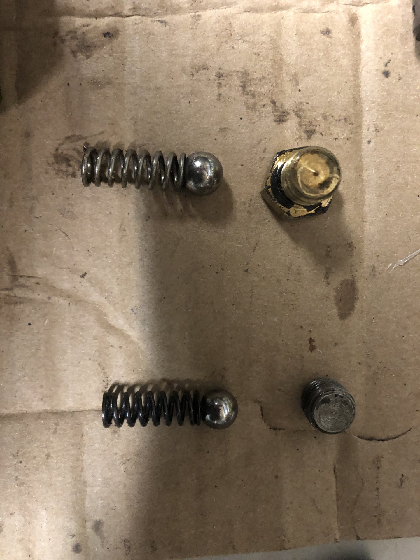

This picture just illustrates the difference in set screws/bolts.
The AA ‘bolt’ is more accurately referred to as a cap screw. I am reasonably confident that the cap screw is not an off-the-shelf item, but a custom made part, with thread depth of a predetermined depth by AA based on, among other things, spring rate of the spring they provide.
What did the arc of your old fork look like?

Here’s some pics to help explain:
AA on top
Im not sure why the wear pattern is only on the top of the AA “fingers”

Silver spring set is AA

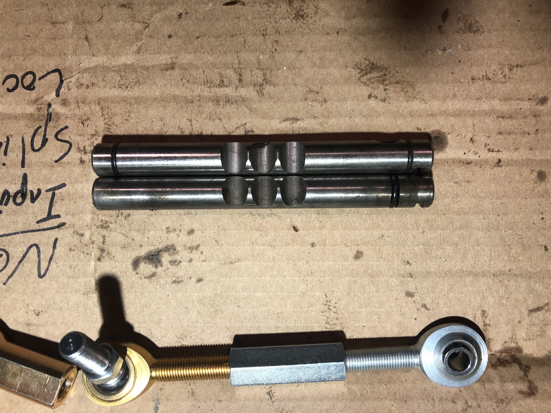

I’m by no means an expert, but it looks like your detents on the AA rail are slightly chamfered. This was definitely the problem with mine. My symptoms were just as you described and steadily getting worse. As I mentioned, George at Valley Hybrids replaced it with OEM and solved my issue 100%. Give him a call or PM?
Can you show a pic of the shift rails from the side, curious as to the height of the peaks between detents, the bottom rail looks to have a bit more material there and also if see thru the detent so we can see if they have the same "U" shape. FWIW the pic with the slotted screw for spring tension should have a cotter pin to retain it. Try running it down just til it won't shift, then up a bit. You get a good idea in what the travel and effect of that adjustment is. With the stock ball and spring IIRC when set just off lock up the screw slot is below the cotter pin holes so you can't get the pin thru the slot but above the screw so it doesnt back out.
I apologize I forgot to take a picture ofvthe rails side by side, but they mic’d out as identical .36” indent with a .36 width at the top of the machining. Since we’re measuring things here’s some other stats

Next up I tried different rail and ball combinations in the transfer case. To get an idea of the force needed to switch gears, I used a digital torque wrench on the shifter lever.
With set screw threaded in .2” the needed torque is as follows:
AA rail w/ lg ball- 11ft/#
AA rail w/ sm ball- 8ft/#
Toy rail w/ lg ball- 5.5ft/#
Toy rail w/ sm ball- 5ft/#
So it seems I’ll get the most holding power from the AA/lg ball combo. Full insertion of the set screw is around .30 and the shifter doesn’t want to move at that point. Currently, I have the depth at .28 and the shifter needs 12.5ft/# to move between modes.
