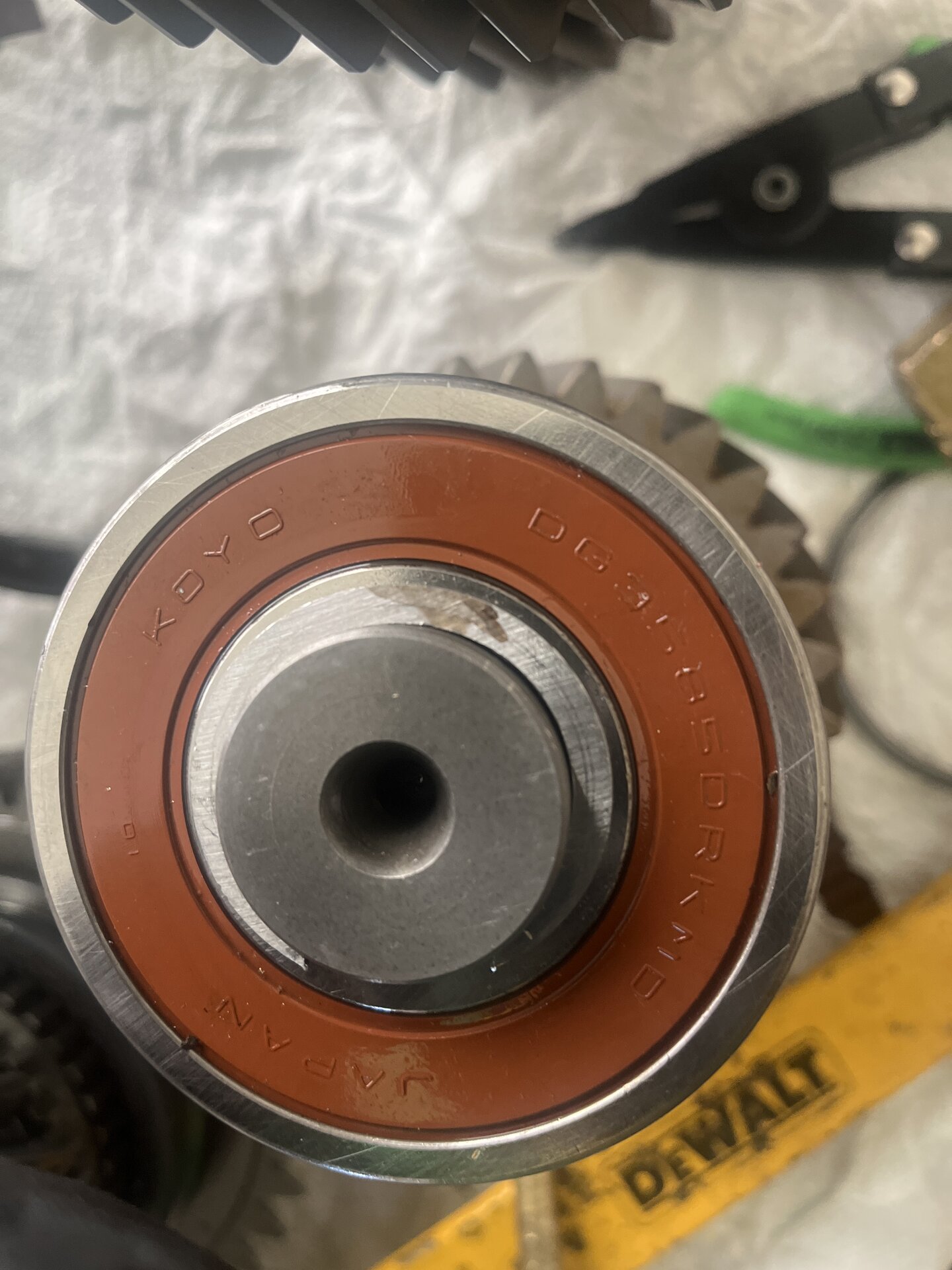

Another thing for those still watching this. When I was reassembling the big stack earlier today the straight pin part really unnerved me. It was perfectly lined up and the sleeve pressed on how it was supposed to from what I can tell, buts what are the mechanics of how that works? Does the downward pressure from the sleeve fire that straight pin back into place or shave part of it off or what? Everything pressed together flush so I didn’t really worry too much but it did get me wondering.

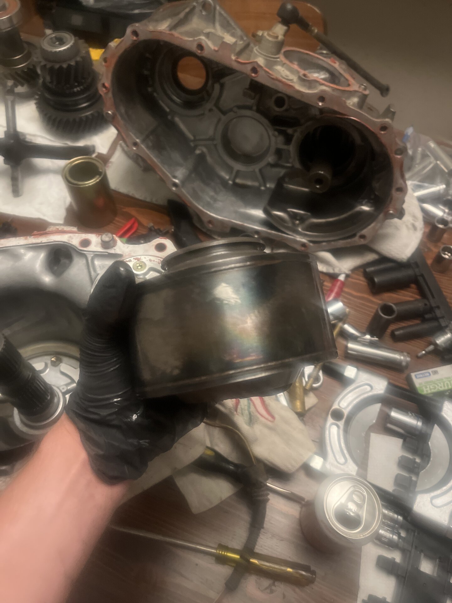

So I can really just… throw this whole thing away?
If that's the VC, Yes. You must've looked at some VC threads to identify it. It looks like the right part. Forgive me, I haven't been inside a transfer case, so I would confirm that with those that have. And if it fails, it would NOT render the truck inoperable, but it would make it a pain to drive on paved roads. Reason being that when it fails, it is like CDL is activated continuously. So in essence, it would need to be fixed. It is a part that has failed on many 80's.
Edit: The VC is NOT an essential part to the transfer case. So "fixing it" for most is removing it.
I'd try and see if something isn't seated fully in the stack. I wouldn't trust it even if it came off and the gears stayed put. That ring would still be floating around in there on a seek and destroy mission.

Got the sleeve pulled out of the front housing. The big snap ring takes more muscle than I wanna give it with the pliers. Is that gap meant to allow you to remove it with a screwgie? Soundguy’s write up mentions hammering the shaft through but I’d guess the ring needs to come out first?

I guess I don't see your point. The VC is a ticking time bomb, there is no way to tell it's condition until it fails. I was under the impression that current logic here (MUD), was to get it out of the equation, with the fact that the youngest U.S. spec 80 is more than 20 yrs old. And it seems like the average mileage is like 200K. Being that the OP is already into the TC provides the perfect opportunity to do just that. You disagree?

No need for a vote. It’s already out, which is where it should be.
I think it's a gross exaggeration. The few threads on ih8mud represent an insignificant minority of failures. You could make an argument about literally everything being a matter of "when not if" but the reality is the TC is pretty bulletproof.
