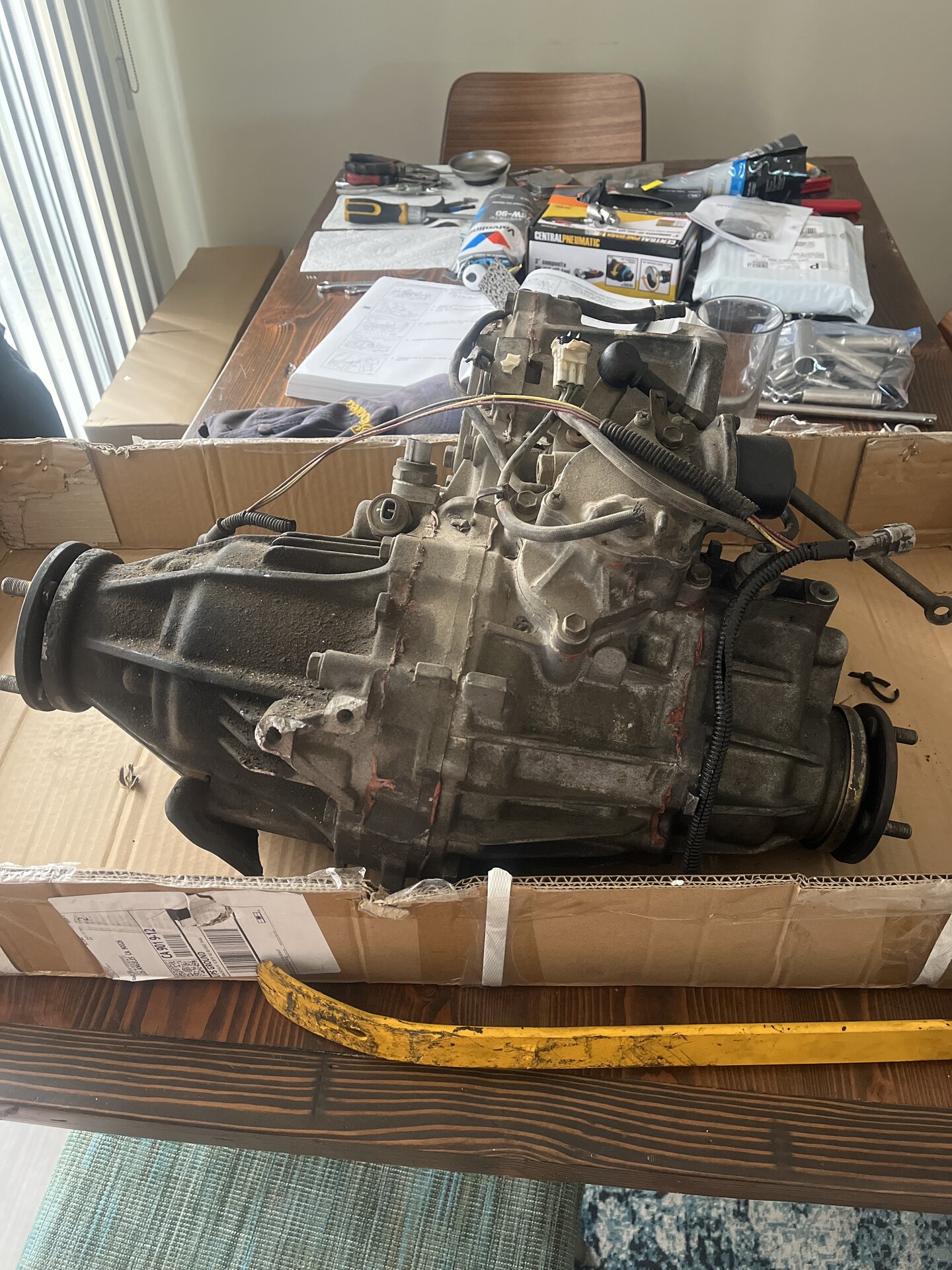

Everything was going fine until I was getting ready to actually separate the damn thing from the transmission and it would not let go. Took an hour of working around the edges with a pry bar just to get it where it’s at in the picture.
Tcase is secured to the jack and about level with the transmission.
All the reading I’ve done on this job basically says “just pull it off” so I’m here wondering what I did wrong. Center diff is locked and transmission is in neutral. What am I missing here?
Yeah, it almost falls off when the bolts are out.
Transmission is still supported, correct? I'd loosen the straps holding the tcase to the jack a little to let it move, bet your all misaligned and bound up on the shaft.
Transmission is not supported, should I have a jack on the pan as well? I’ll try loosening the straps first and see if that does it.
I should have added "in a perfect world".
Got the bugger! Still took some muscle but thanks to 3eyebandit for the tip. Cracked the white plastic over the top connection but other than that seems good. Now comes the fun part.
