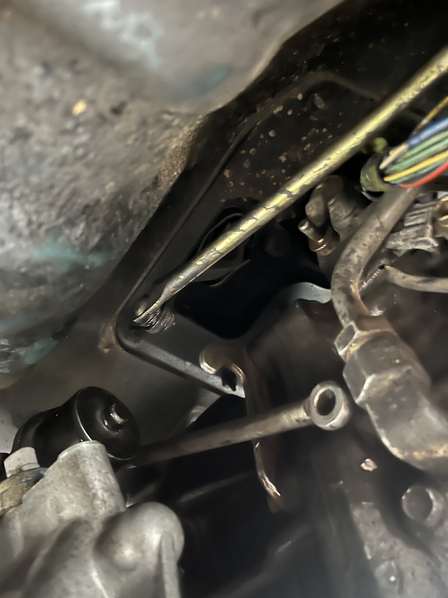

Finally getting it back in. Quick question on the install. Is this shift linkage supposed to sit up under the hook or clear it? I know the crossmember will move things up but the angle still looks wrong to me.

That stupid hook is in a really crappy spot for accessing that top t-case mounting bolt.
If that hook is the lifting hook on the rear of the the extension housing, it goes under. Way under.

i think you are right, god awful place to put that hook though. The bolt that holds the other end of the link on looks like a 10 or 12 per this picture so I’m gonna try to sneak a wrench in there and take it off to avoid lowering the whole case again.
I was able to get the other end undone. Assuming this is the right home for it I’m not sure how I’d get it on there from under the hook?
It's easier to do from the inside.
Way under? The end of it needs to fit over the pin in the tip of the picture.

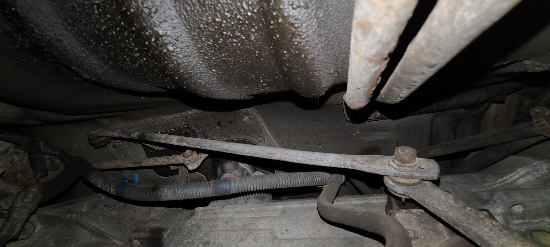

This is what mine looks like
I assumed you were asking about the longer shift rod, which is several inches below the lift hook. The shorter linkage rod is just off the ear, to the outside.
