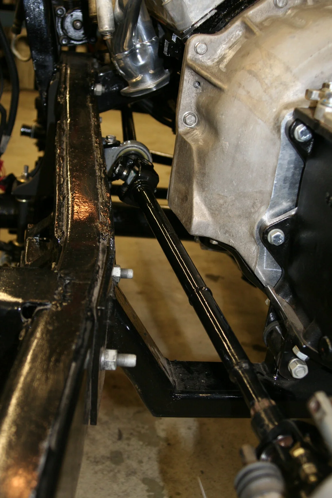

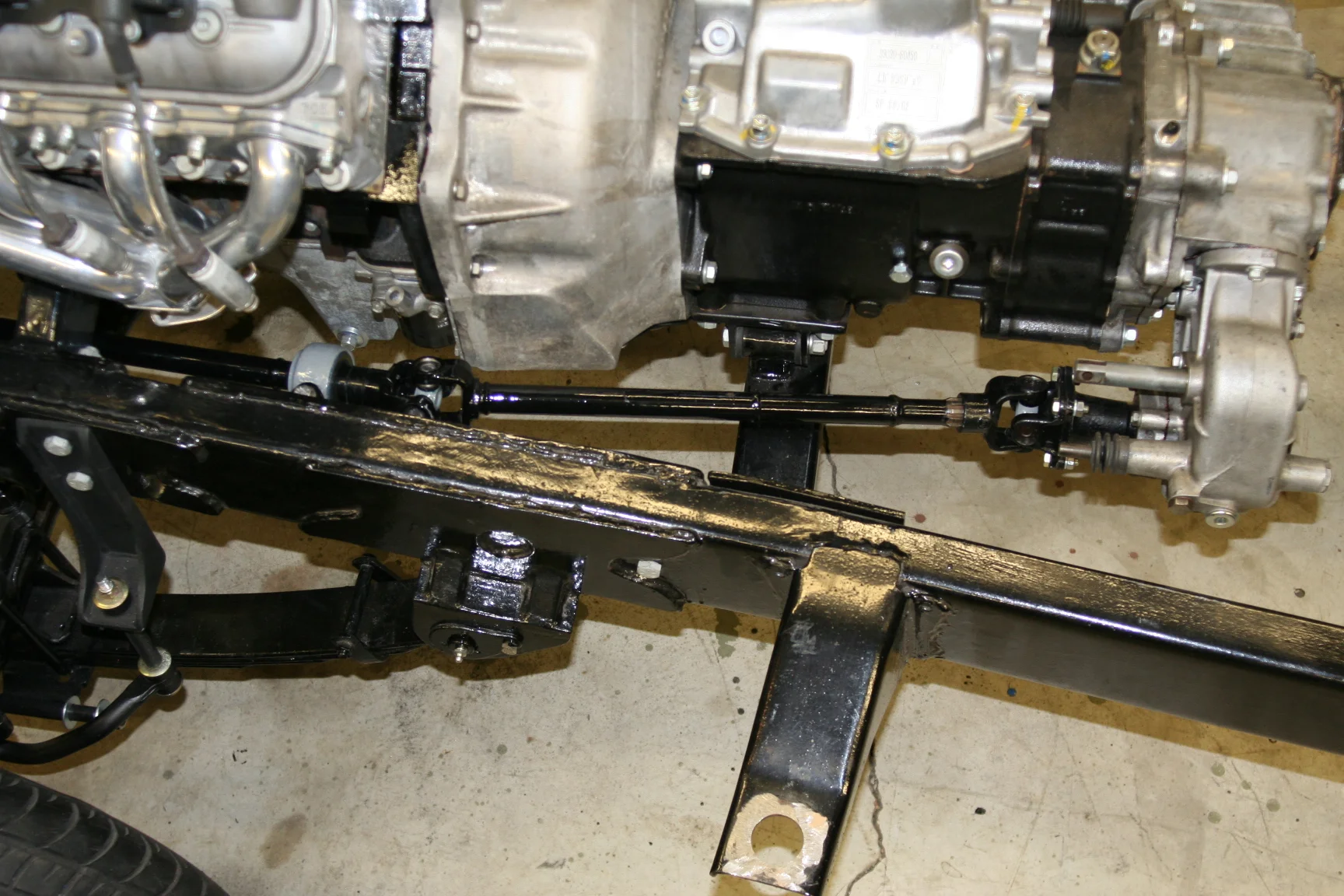

I put an LS3/4L70E/60 series split case in a 1979 FJ55 with a PTO winch. Modified the drive shaft a bit along with the mount for the carrier bearing and the shifter linkage. I would think it is doable in a 60 as well.
☝️This...I also put a 5.3 with an H55 and split case in my 55 with a factory PTO. The 60 has a wider frame up front than a 55, so should be easier. I made my own carrier bearing mount for the PTO driveshaft as well. I used Sanderson headers and in the end it is a very tight fit, but doable.
