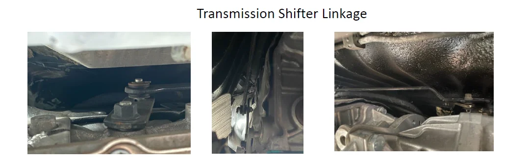

Shifter: On the A/T shifter modification Matt has a great post about taking things apart, I didn’t have easy access to a good grinder either to extend the squared off part of the rod, so I took off the thick lock washer used in that assembly [UPDATE] and replaced it with a thinner one to free up space for the shifter arm. The bolt that was getting in Matt’s way causing the need to bend the short arm of the A/T shifter can be removed. They are for holding the breather tube and that bracket can be relocated.​
[UPDATE] make sure this is bolted together very tight. The shifter problems I was having at the start were the result of some play in two shifter arms coming together. When pushing the shifter forward to park, the shifter arm and the linkage arm would slip against one another and let the cab shifter go up to P, but the actual transmission would stay in R. With this fixed, its much better. There are a bunch of other linkage products out there too. This one was included with the kit, so I figured I would make it work before getting even more spendy.
I bought a Dakota Digital GSS-3000 transmission position indicator. The install there is a cinch. The Toyota EWD here is straightforward in showing you what you'll need to connect to this box (trace back from the combo meter). I believe the box has to have a R input, so I disconnected that light from the larger back up light circuit. I'm installing this box behind the glove box. I haven't tested this yet, but I've read it throws off enough power to light up the incandescent bulbs inside the combo meter.​
I don't know if my bends to the shifter linkage from Tor were off or if I somehow got a mis-cut link piece, but I needed to drill a new hole in the long shifter arm from Tor to get this all to connect.​

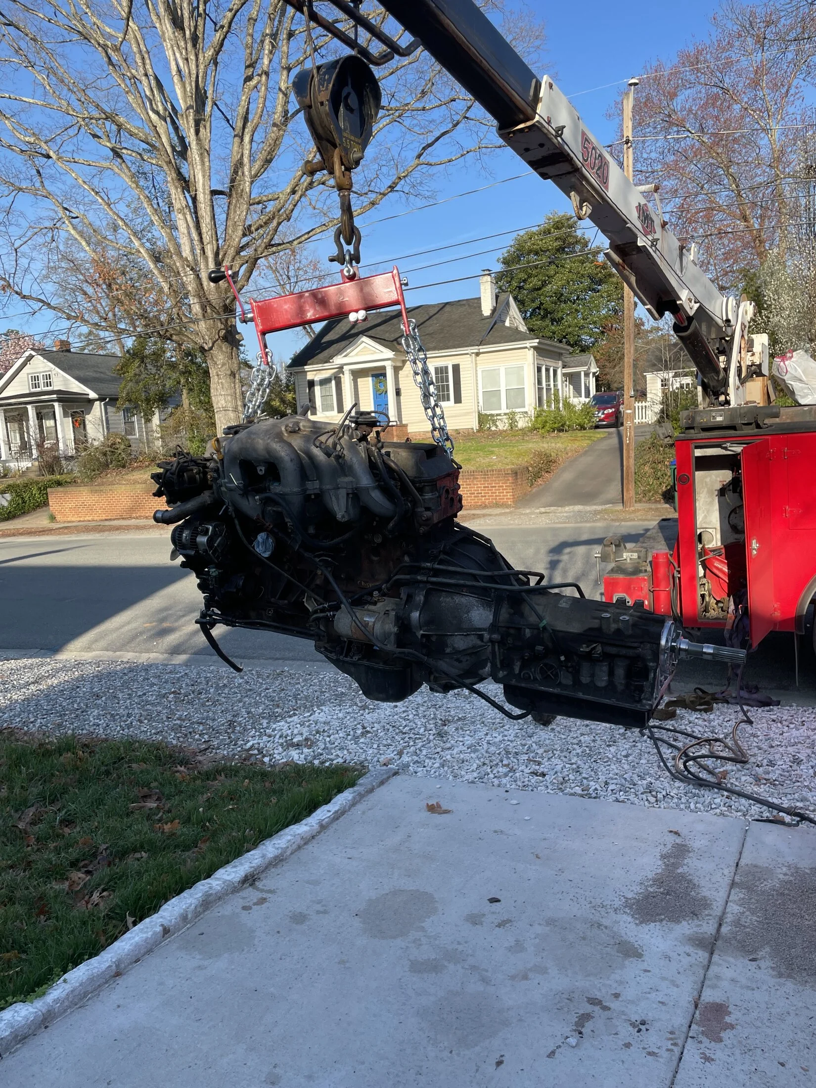

Oil / Water Sensors: I think Matt did this as well, but I kept the factory oil and water senders to feed into the combination meter on the dash. The oil sender is on the same harness as headlights and needs to be extended a fair bit to move from the PS to the DS of the engine block. The water sender is on the engine harness so be sure to save those wires as you take apart the Toyota harness. I did the standard Earl’s blockoff with top port and an adapter like Matt for oil. For water, I got a M28 to 1/2" NPT Coolant Temperature Sensor Adapter Fitting from ICT Billet that fits in the big coolant port on the driver’s side of the engine block and then a 1/2 NPT to M16 thread adapter to put the water temp sender into that hole from a place called Thread Tool Supply (1/2" NPT to M16 Thread Adapter: Nickel Plated Brass - https://www.threadtoolsupply.com/nickel-plated-brass-thread-adapter-12npt-M16.html). This was basically the only combo I could find where I could get thread adapters to link from coolant port to Toyota sensor.​

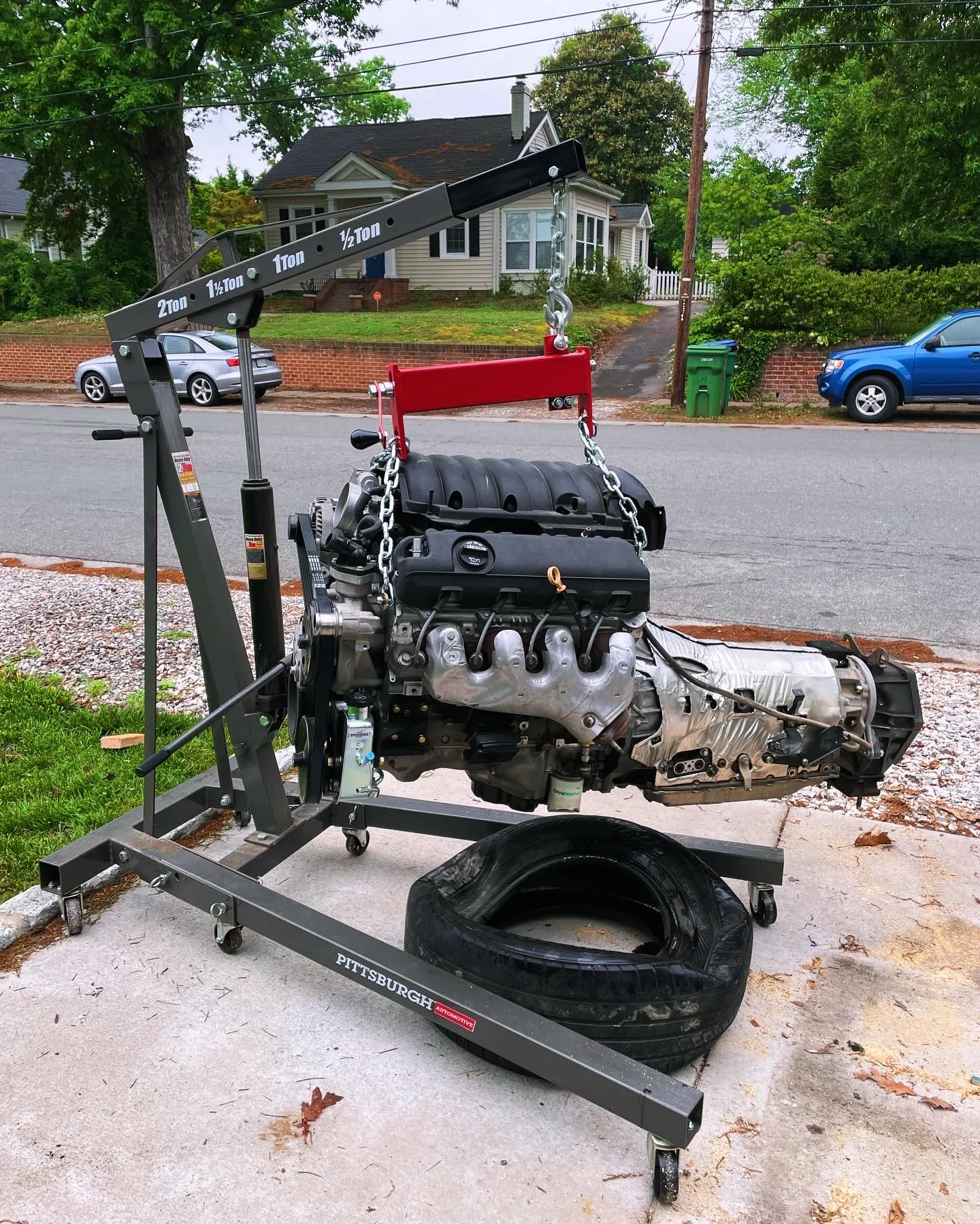

[Had the help of some big guns via a neighbor in pulling the 1FZ-FE out! Thanks @brm2993 for coming up to RVA to take it off my hands.]

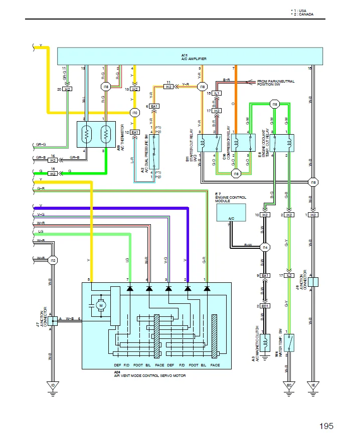

Air Conditioning: So there are (at least) two flavors of AC set-ups in the 80 series. It’s my understanding that most 80 series did not come with the “auto” climate control feature, but the 40th anniversary and LX450 trucks have this feature. I bought a hard copy EWD for a 1997 land cruiser, but it does not have the pages for the automatic air conditioning control. Thankfully the 1997 LC EWD and the LX450 EWD in the resources section here both show how this is wired.​
The lead on Mitch's harness is for an AC relay input for ON and the GM ECU will manage the operation of the AC compressor vis a vis AC line pressure, RPM, engine temp, starter cut-off etc. You're left, however, with a lot of Toyota controls and circuits that I am not 100% sure yet I understand how to integrate or bypass. Still doing some homework here, so bear with the real-time thoughts and questions. If you know what you're doing here, I would gladly take some advice!
My current thoughts (have not made any cuts yet) are as follows:​
  • [UPDATE] Delete the Toyota A/C pressure sensor, by cutting at the connector and joining those two wires (i.e., switch is effectively always on). Removing as it's just an unnecessary failure point.
  • [UPDATE] Connect Mitch's A/C lead to the G-W compressor relay wire as my signal to the GM ECU. I think this allows the Y / Y-R circuit to find ground appropriately, but welcome to other thoughts.
  • [UPDATE TO UPDATE] Maybe the above would be sending too much current into the MCM and I need to wire in a relay for the Y / Y-R circuit to find ground and link the MCM lead to the orange wire off the A/C Amp.
  • [UPDATE] tie swaptime lead into clutch circuit at EY1 / ED1 or wherever else might be easy for you.
  • Ignore the starter relay as it will be removed from the circuit and always on.
  • I think this leaves me with the A/C Amplifier receiving all the right on/off & thermostat signals from the controls, cabin sensors and thermistor and prunes cut-off relays that are being overseen by the GM ECU.
  • There are 3 additional wires running into the A/C amplifier though that are not shown on on this page of the EWD (or anywhere else that i can find): Y-L @ pin 5, V @ 14, and Y-B @ 17. Toyota notes that in reviewing connector schematics a dot indicates an occupied pin not used in the applicable circuit, but an X means unoccupied. The electronic copy of the 97 EWD in the resources section isn't quite as good as the LX450 version up there. When you go look up A30 (LC) and A11 (LX450) for the A/C Amplifier Connector, the LC version shows all pins as occupied (they are not) and the LX450 version shows Xs in each of 5, 14 and 17. I suspect these relate to some of the engine related functions noted below.
  • The EWD states:
THE A/C AUTOMATIC AMPLIFIER RECEIVES VARIOUS SIGNALS, I.E., THE ENGINE RPM FROM THE IGNITER,​
OUTLET TEMPERATURE SIGNAL FROM THE A/C AMBIENT TEMP. SENSOR, COOLANT TEMPERATURE FROM THE​
A/C THERMISTOR, ETC. WHEN THE ENGINE IS STARTED AND THE A/C SW IS ON, A SIGNAL IS INPUT TO THE A/C AUTOMATIC AMPLIFIER.​
AS A RESULT, THE SAME GROUND CIRCUIT IN THE A/C AUTOMATIC AMPLIFIER IS CLOSED. AT THE SAME TIME, THE ENGINE CONTROL MODULE DETECTS THE A/C MAGNETIC CLUTCH IS ON AND THE A/C AUTOMATIC AMPLIFIER OPERATES. OPEN DIRECTION TO AVOID LOWERING THE ENGINE RPM DURING A/C OPERATING. IF THE A/C AUTOMATIC AMPLIFIER DETECTS THE FOLLOWING CONDITIONS, IT STOPS THE AIR CONDITIONING.​
THE TEMPERATURE AT THE AIR VENTS IS LOW.​
THERE IS A MARKED DIFFERENCE BETWEEN THE COMPRESSOR SPEED AND THE ENGINE SPEED.​
THE REFRIGERANT PRESSURE IS ABNORMALLY HIGH OR ABNORMALLY LOW.​
THE ENGINE SPEED DECREASES.​
RAPID ACCELERATION OCCURS.​
  • There will definitely be some trial and error here in figuring out how to get this A/C system to operate properly and maybe some spoofing of an RPM signal to this system. I'm no whiz at reading circuit boards, but I've opened up the A/C Amplifier and the A/C Automatic Amplifier do not see a potentiometer like the Tach to make an adjustment. I read in some thread that you can disable the automatic climate feature via a switch on the back of the HVAC controls, and maybe my fallback position here will be to just rig up an on/off set-up and just have to be careful about not icing up the coils.
  • One other note (truly minutiae): I don't know if the differences in the wiring of the starter cut relay between the LX450 and the LC are in error or if it's truly wired that way. First picture is LC diagram and second is LX450. I think the LX450 is an error as the B-R wire off the P/N switch should only receive electricity in the ST1 position (i.e., crank) and the diagram doesn't make a lot of sense to me if that's the case.

I am not sure what is going on with the shifter linkage / positions on the transmission though. I need to take all that apart and sort it out. I don't think I've got the arm upside down, but I had to shift through all the AT gear positions to find Park at the opposite end I thought it should be.
[UPDATE] The shifter linkage was a bit mis-aligned and loose. P on the shifter in the cab wasn't pulling the actual transmission shifter all the way back to the P position on the transmission. Apparently the engine will fire though in the manual mode at the other end of the throw.

The mods to the Toyota shifter are needed because that linkage runs down the PS of the A343 transmission and the GM 8/10L80 transmission shifter is on the DS. I'm sure there are cable actuator work arounds to skipping this, but Tor provides the arms to just link it this way, so I figured give that a shot and see what I think about it. The arms come unbent, but in the pictures in the instructions that come with the Torfab kit you can see that Tor's shop bends the long arm to get the right geometry for the transmission tunnel. The instructions & his page are a little vague at times, but that's why there's mud and email!
