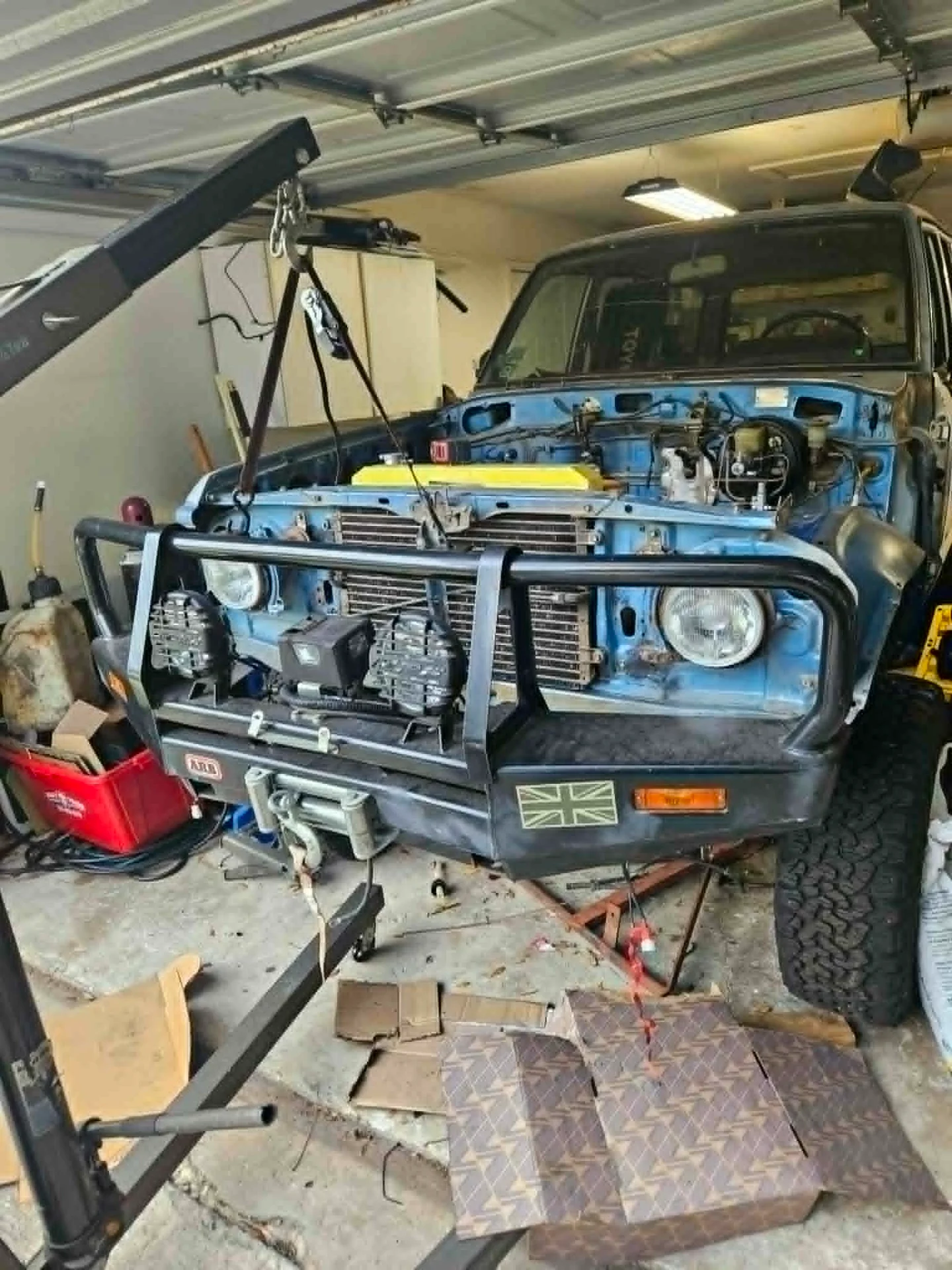

Was this the bumper on Marketplace the guy had on his 62??I scored a arb with a XD900 and lights for 800 bucks! A little tweaked but i can live with it. That will go on later.
It wasWas this the bumper on Marketplace the guy had on his 62??
Man I was trying to buy that! That dude hit me back a couple times, then the line went dead....It was
Its a 60-62 bumper. Its not too far off but the brackets will need to be modified.awesome progress!!! Was that a 62 ARB bumper that fits on 80 chassis? Or 80 ARB bumper? Need to figure option for my build

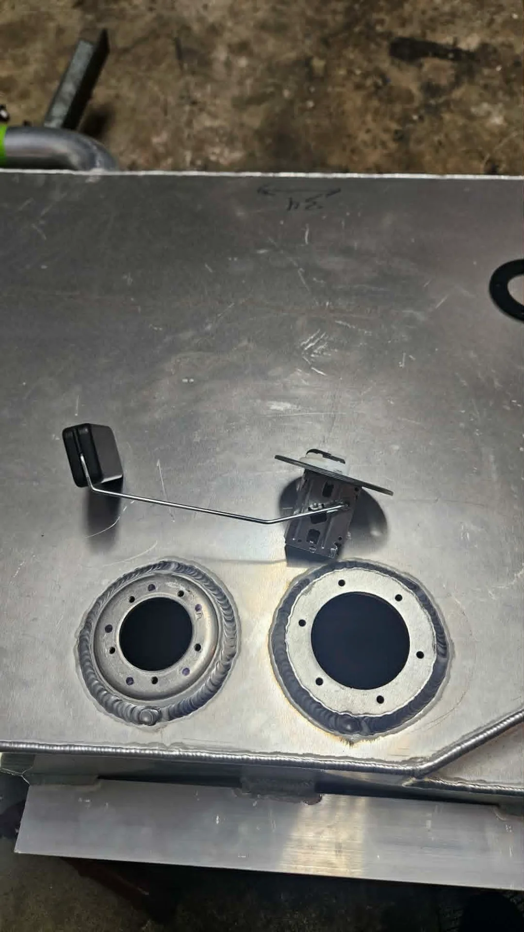

Is that one of those LRA tanks??I NEED TO GIVE A BIG SHOUT OUT TO @samc2447
With out him Id still be lost on the gas tank. This thing is so nice!!
no, it's a custom tank I build for 60 on 80 chassis swapsIs that one of those LRA tanks??
Its a custom tank that fits the 80 chassis and puts the fill in the right spot.Is that one of those LRA tanks??

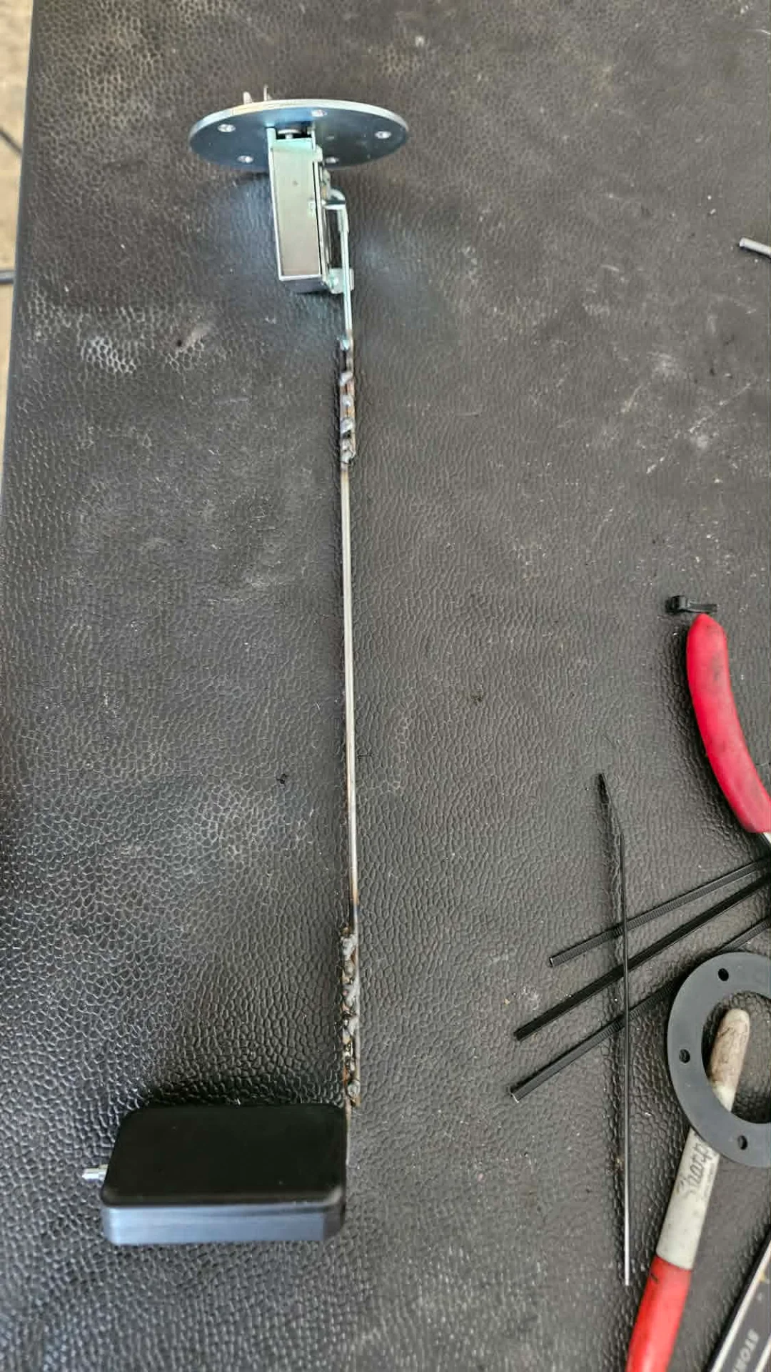

Where did you get denso connector pig tail?I modified a factory Toyota sender to work with my tank. Hopefully I didn't fry it when tack welding the arm. I had to add threaded holes for the Toyota sender to bolt it in. I got the fuel pump hanger all setup and ready to drop in. I just need the right hardware.
IT came with the pump and hanger. Im running a walbro fuel pump that came with the hanger.Where did you get denso connector pig tail?
A thought. Denso 80 pump is much quieter and more reliable. Why I am going this route.IT came with the pump and hanger. Im running a walbro fuel pump that came with the hanger.
