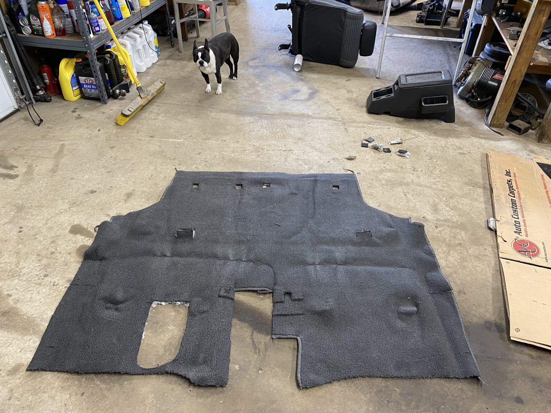

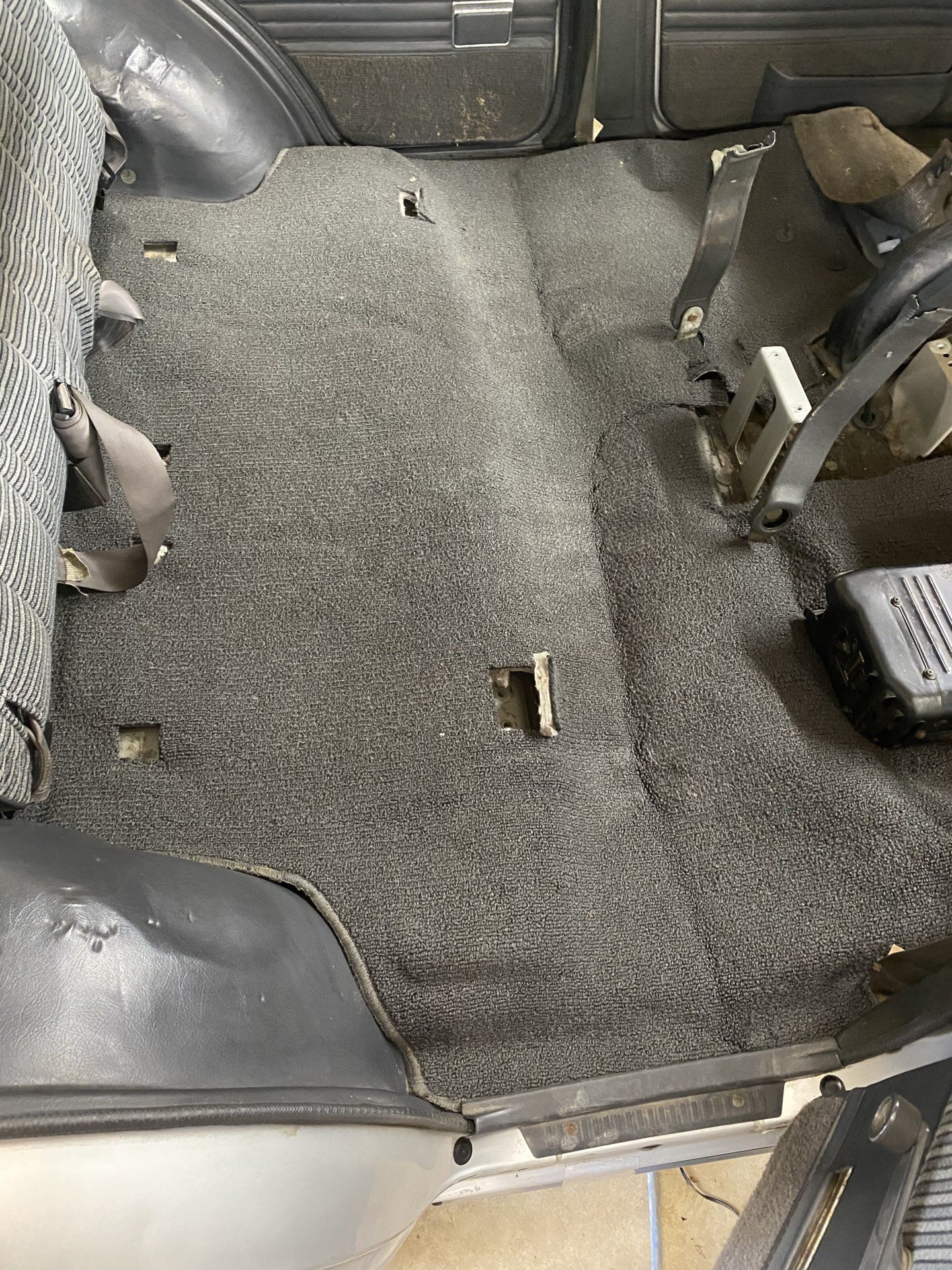

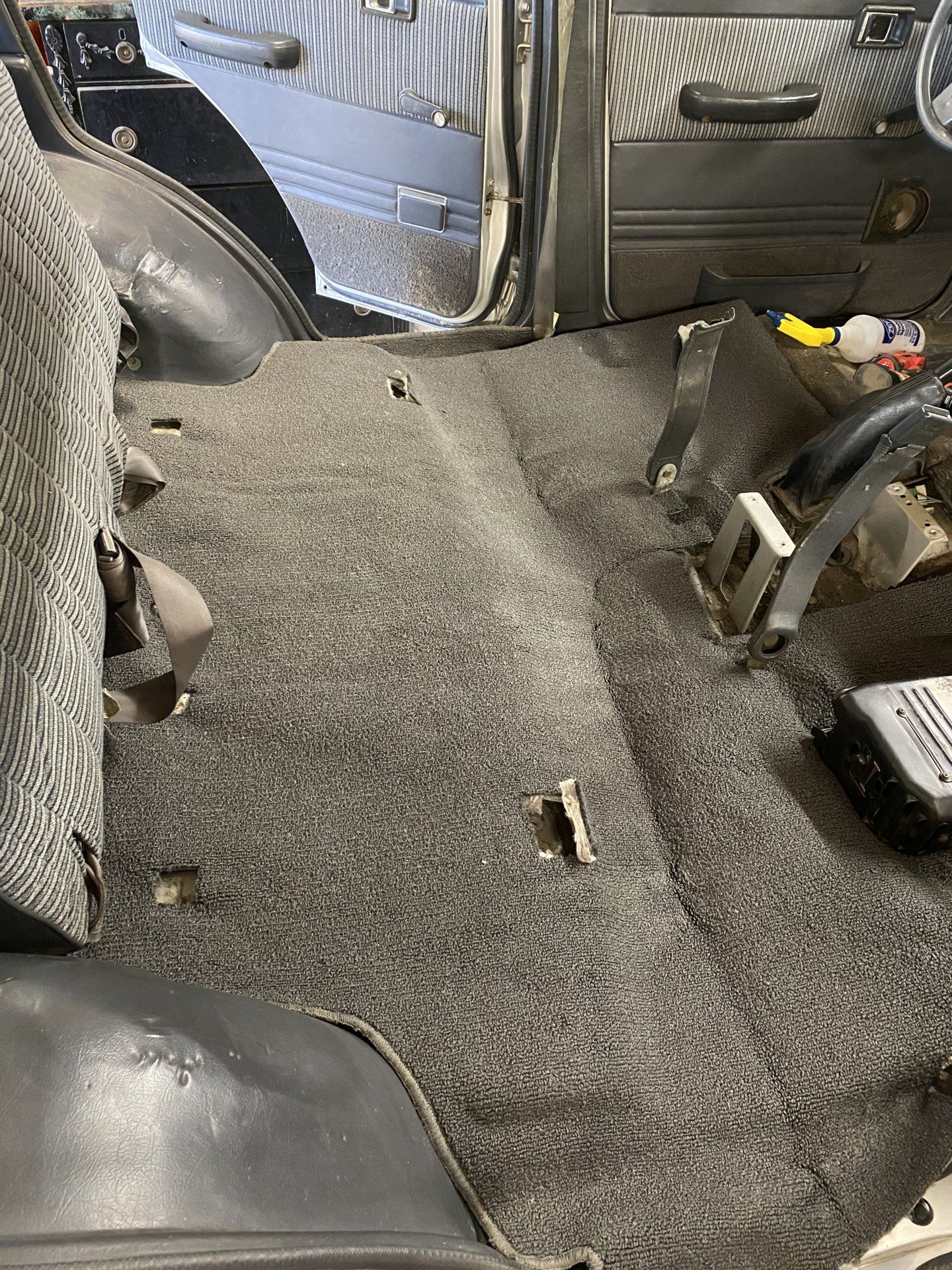

@dnp carpet is the single best upgrade to refresh a truck.

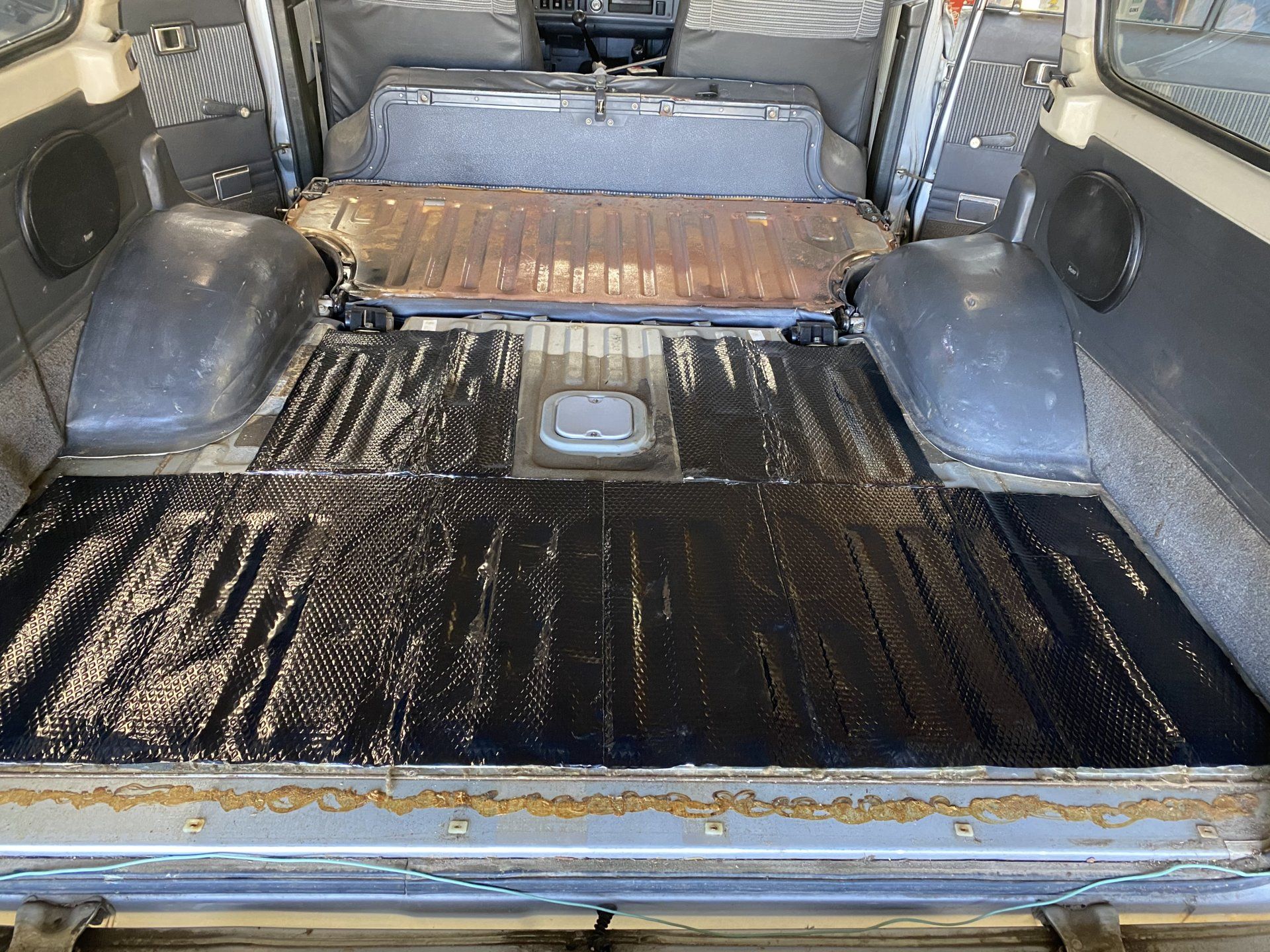

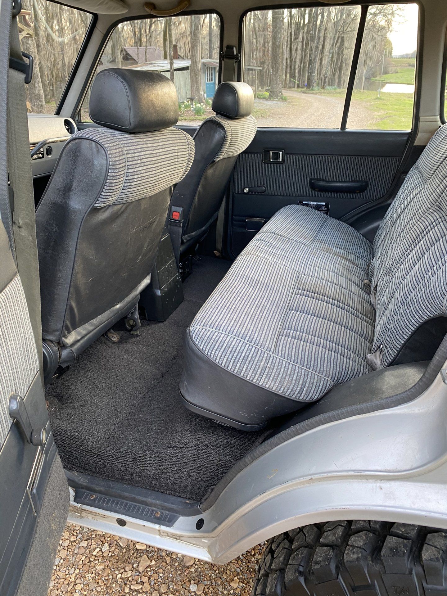

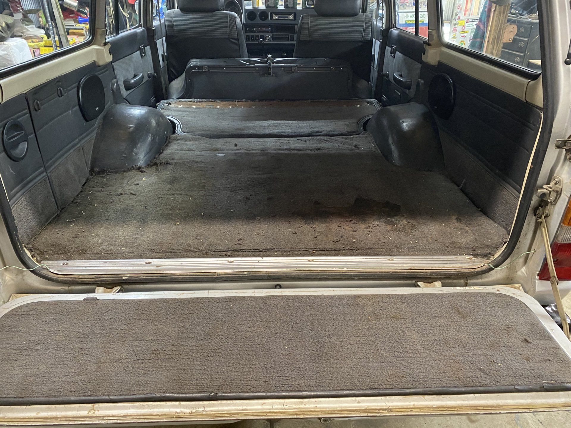

The rear is a pretty quick deal. It gets more complicated as you move forward with the other 2 sections but man.....it’s so nice
Side panels and fenders are in good shape.
I cleaned it up real good and added a layer of Noico. New fuel tank is such an amazing bonus. I peeked in the cover and it’s all new.
These wrinkles will fall out as the carpet relaxes. I just unpacked it this morning.

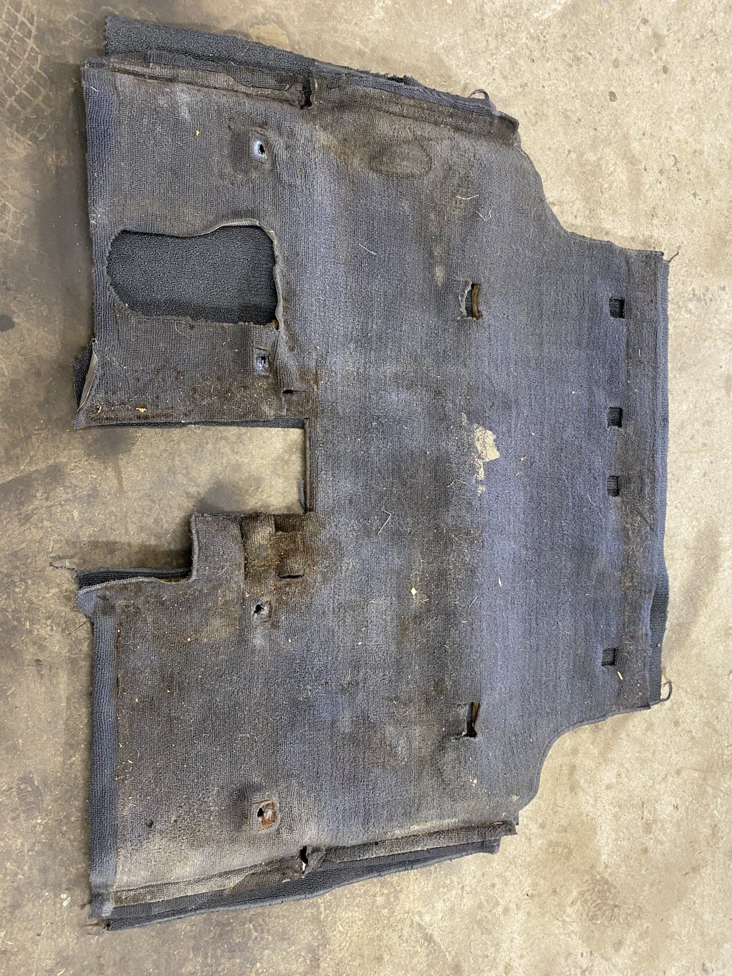

Middle section. Nasty. I think this is where the dog lived and ate the seats.
Once you get the center out it’s easiest to use it to pattern the cuts and cauterize your cuts
Cleaning and some noico will make this all good.
I found about $3 in change.

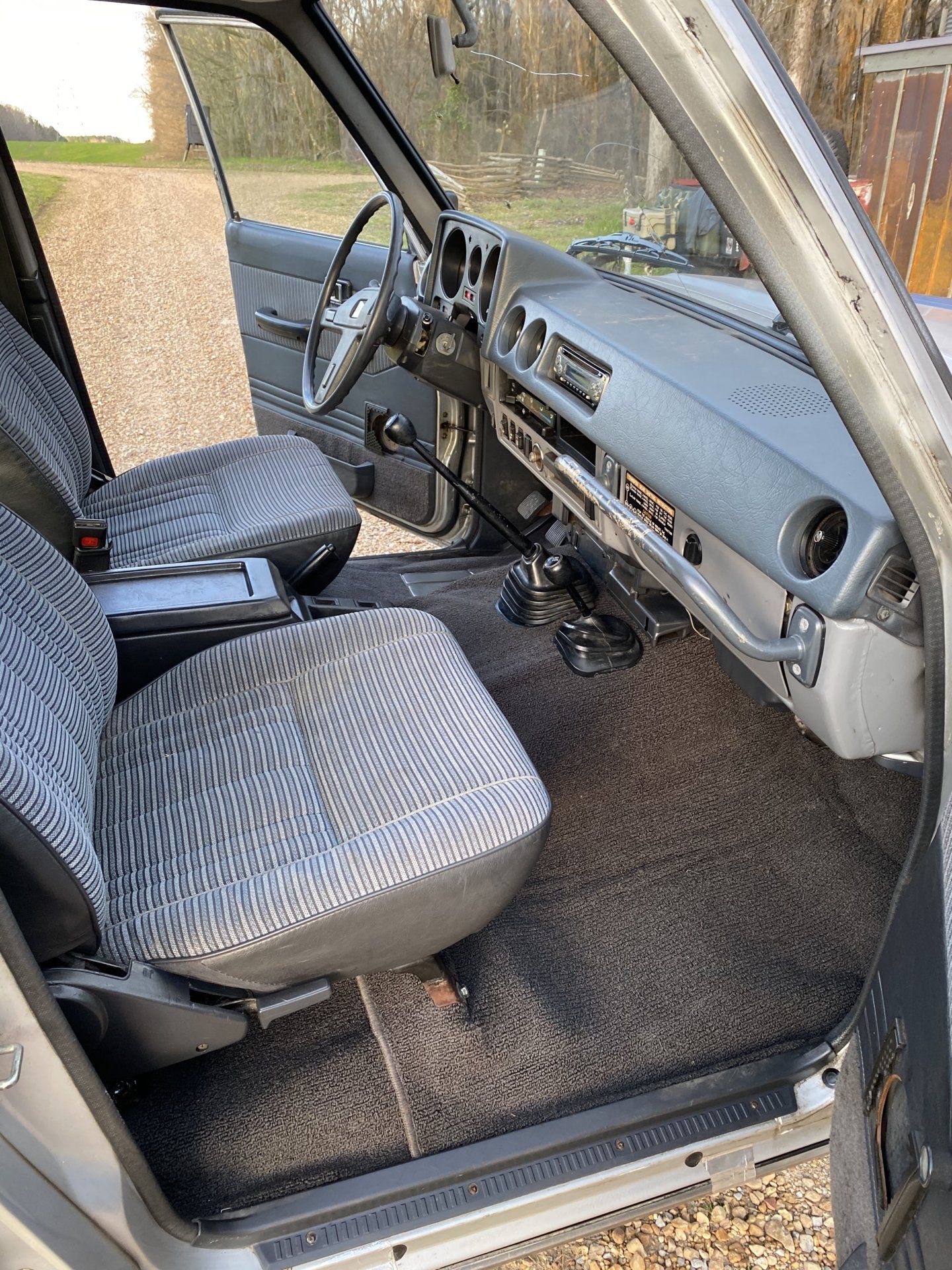

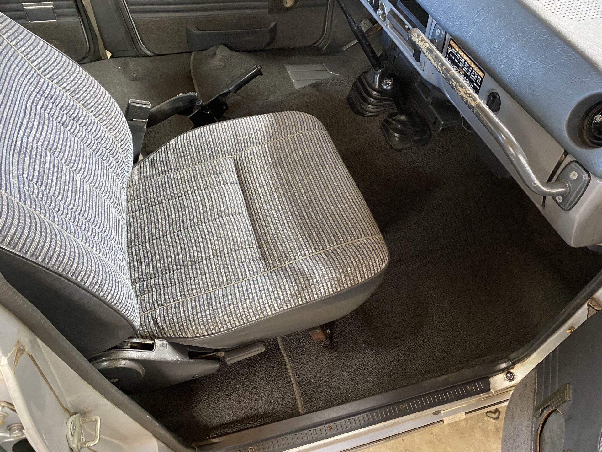

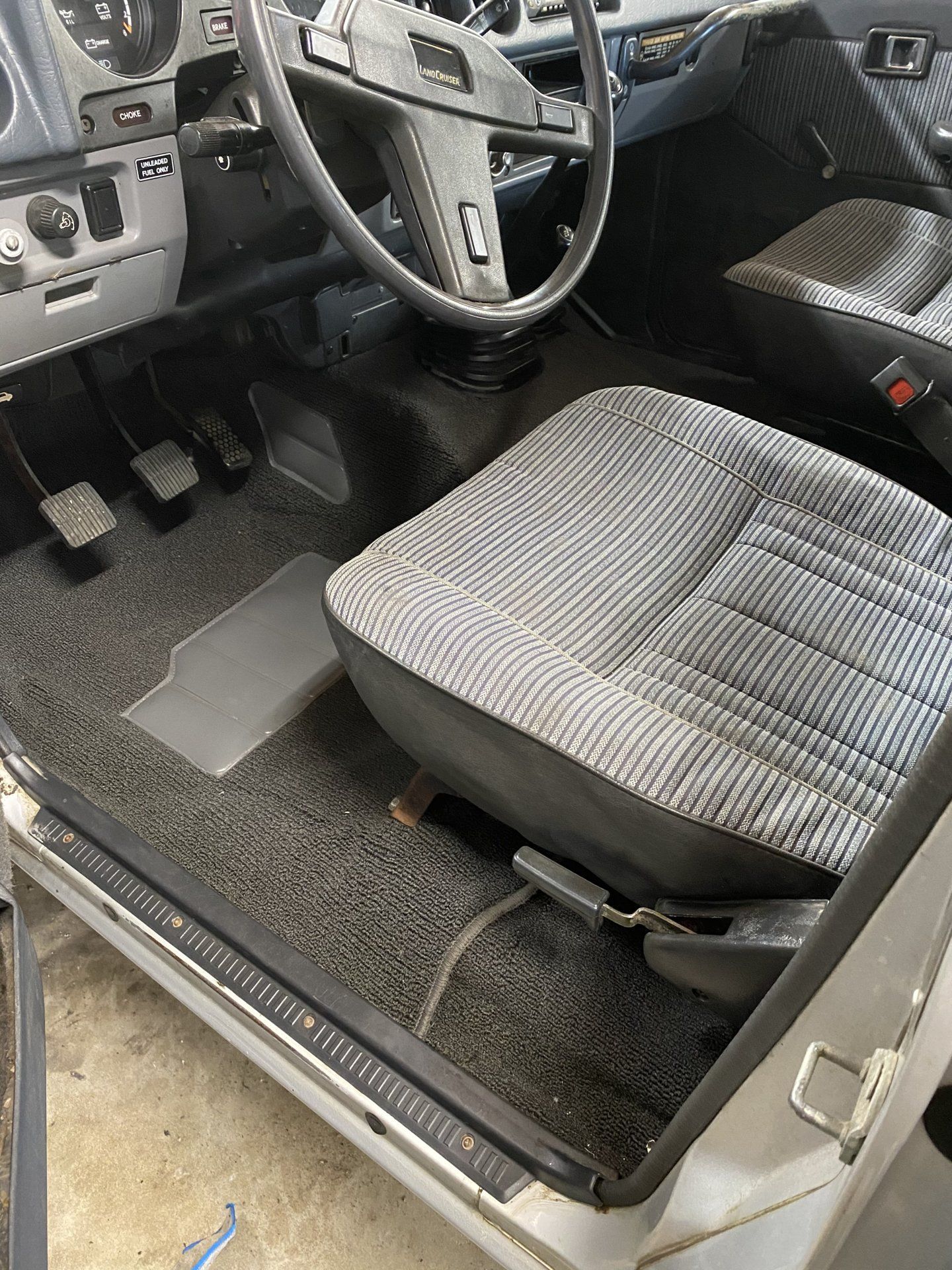

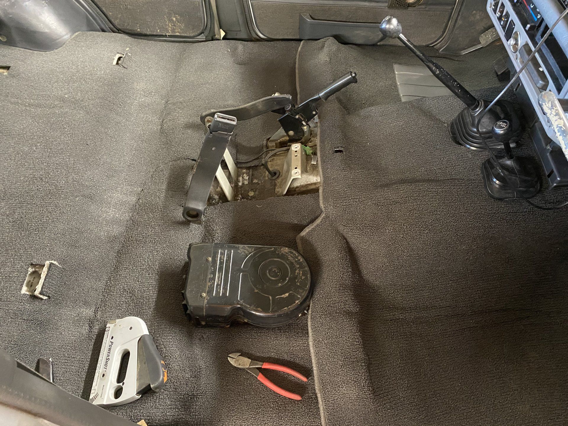

The front is a bit more tricky. I cut my shifter holes and slipped it over the shifters then trimmed the edges.

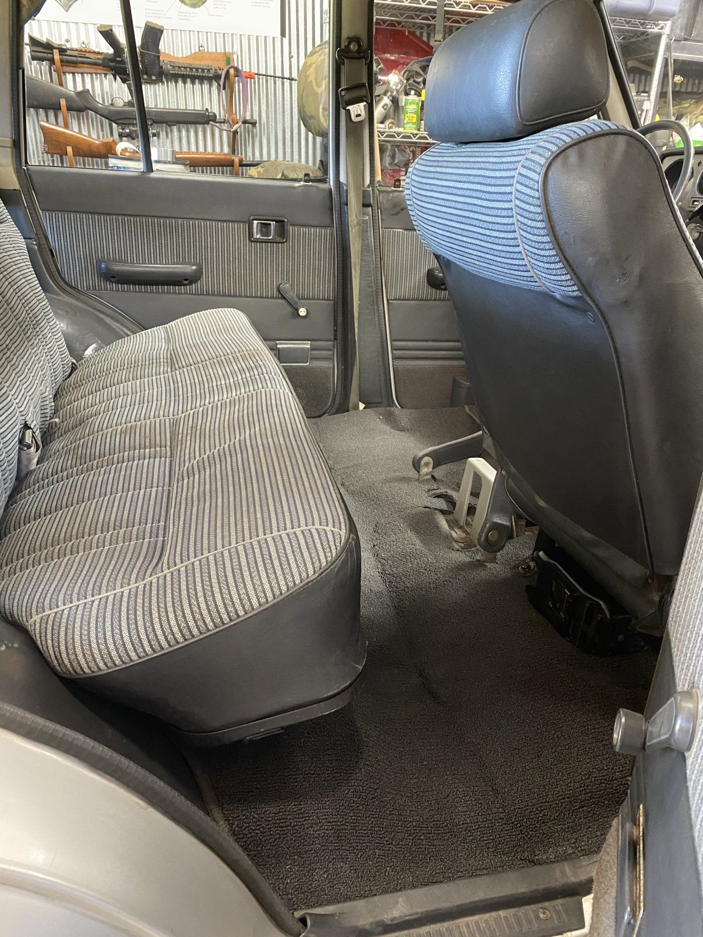

I put seats in last. Pull it all right then find the seat bolt holes with a pick then burn the holes in with the soldering iron.

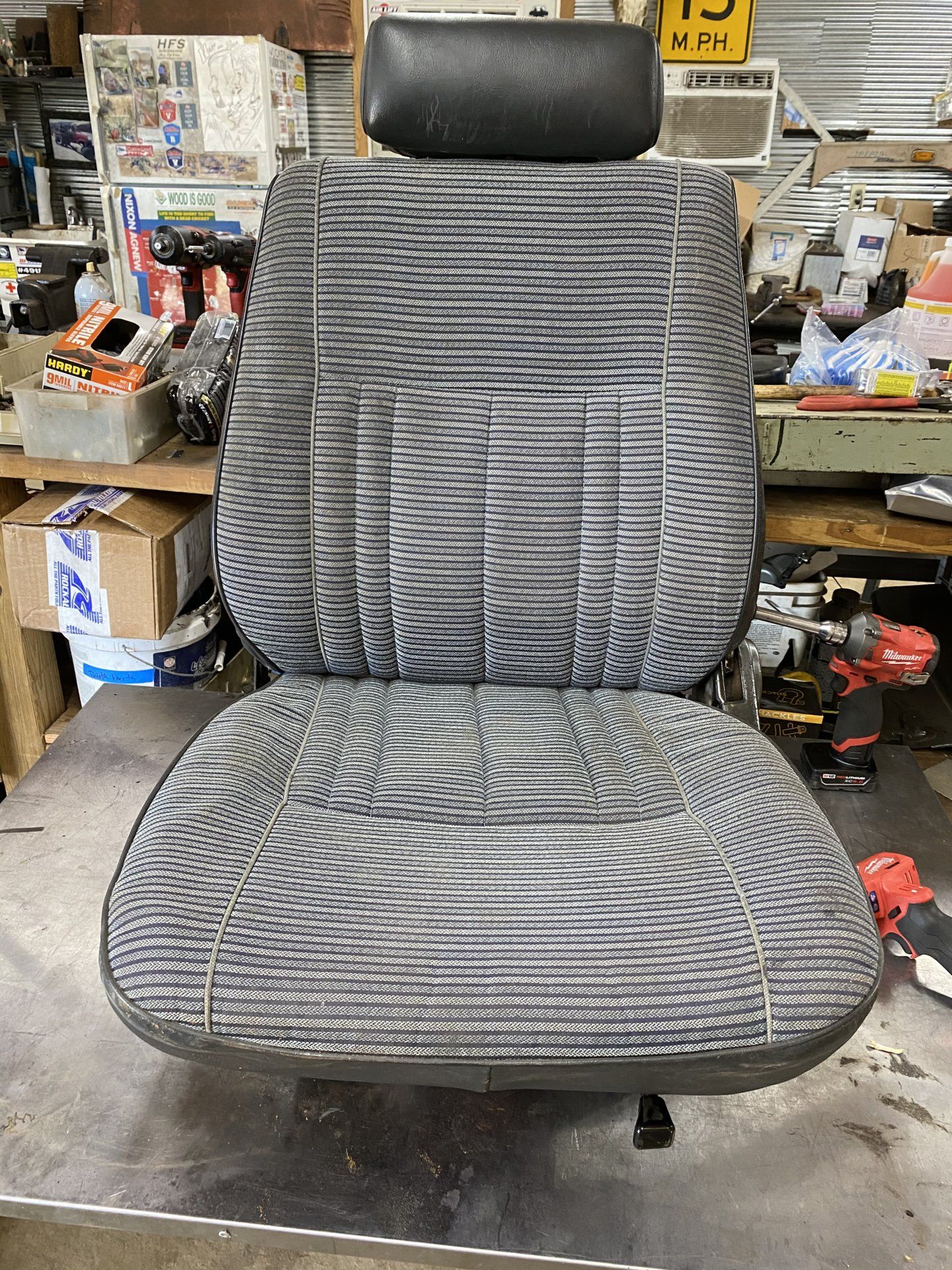

The rear seat bottom is new. The fabric was good on the other one but something ate a hole in the vinyl front. Easier to buy a new one in good shape. I still need to shampoo it all

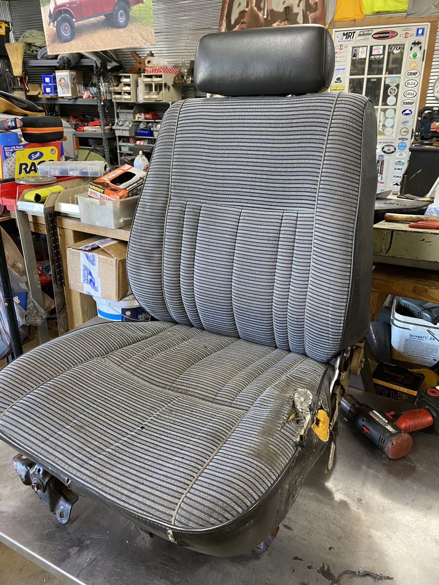

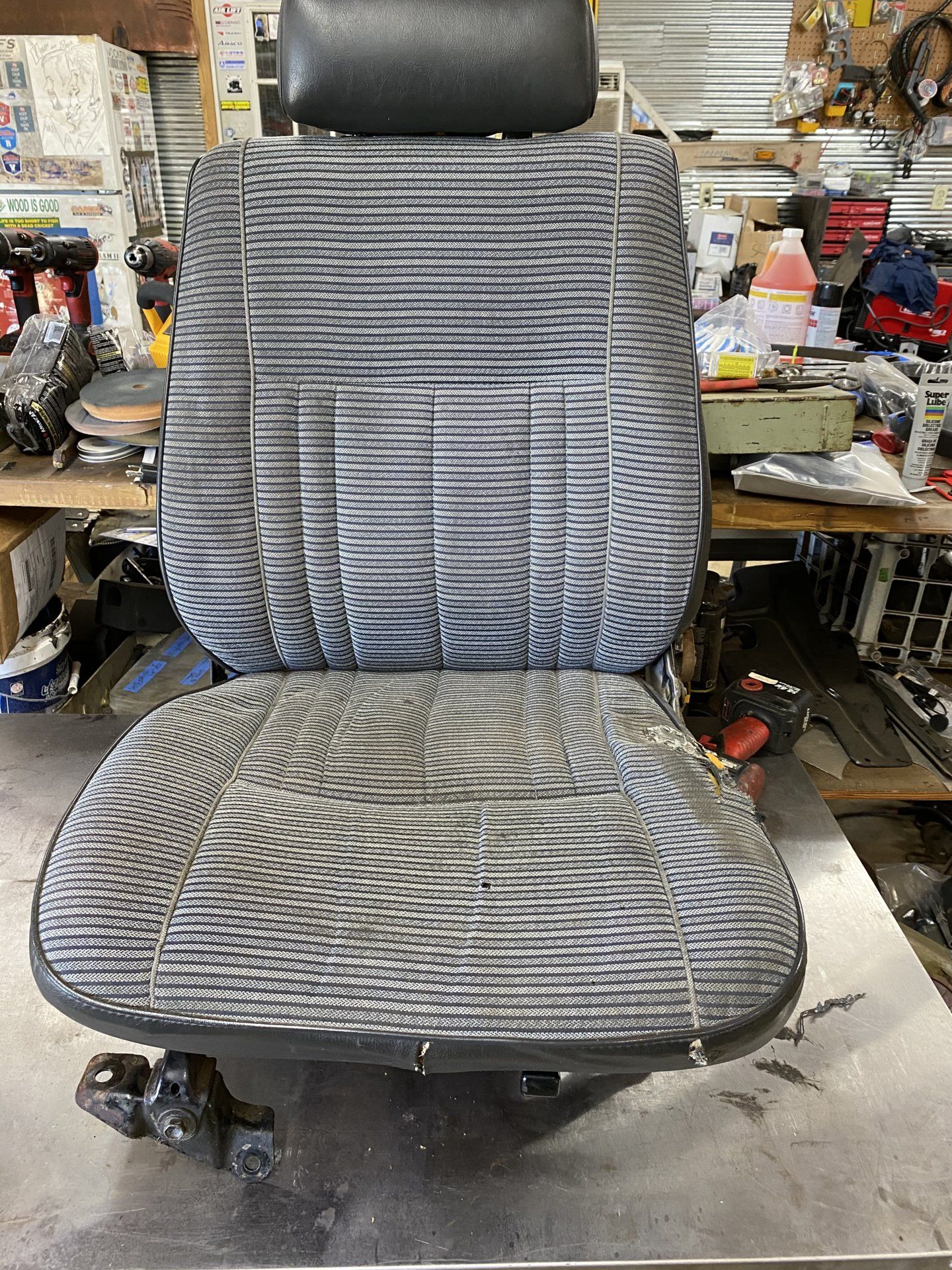

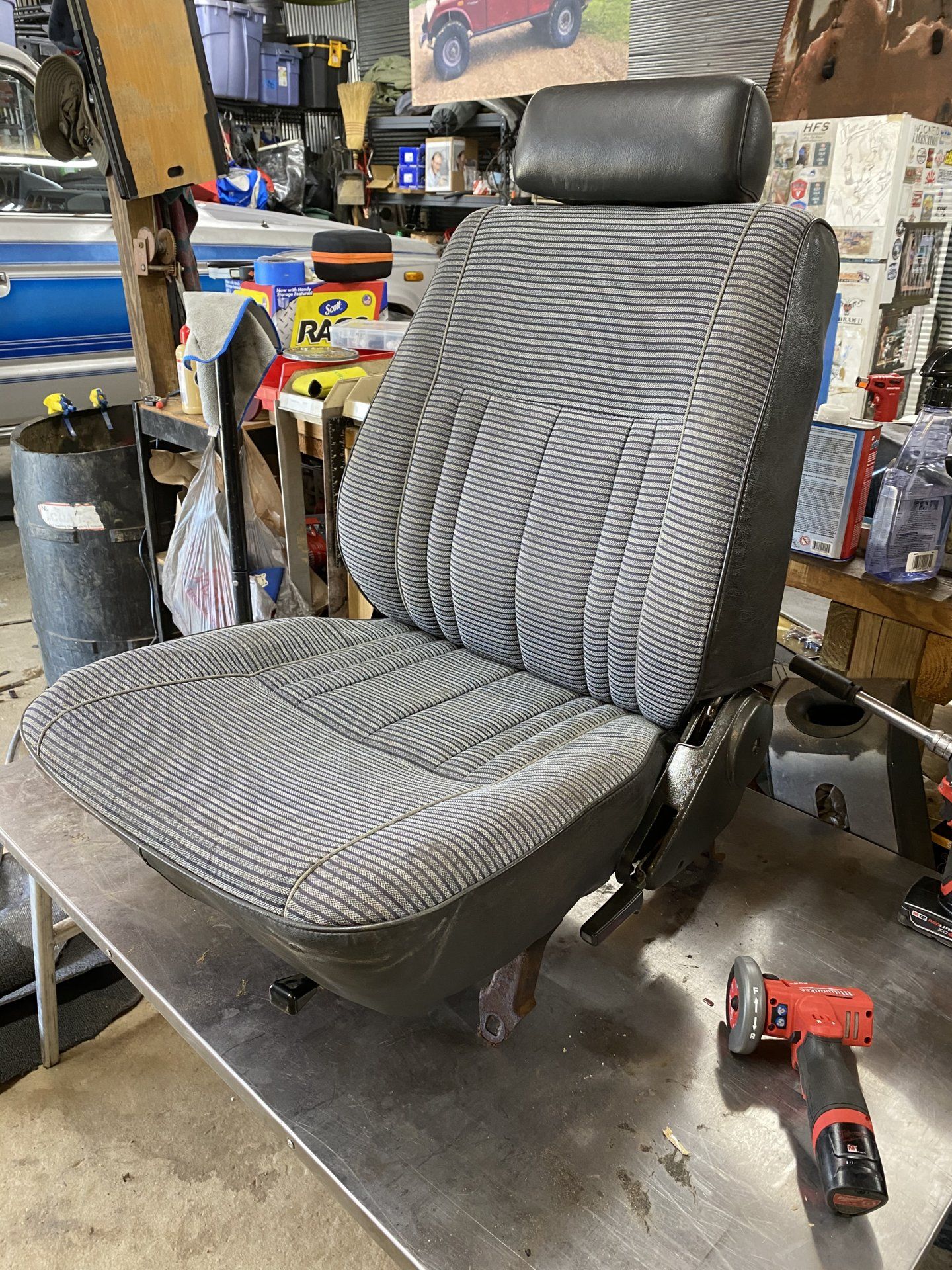

The drivers seat was hammered. Foam was flat. Side was ripped.
Solution was to find a good passenger side foam and cover and swap em over.
Also found a new tilt handle and bent the arm back and installed.
Final product. Dash is solid and tight. Looks great. Console top is a bit faded but it’s fully functional and even has a good cup holder.
I still need a couple of small items for the interior but this was a HUGE step forward on this truck.

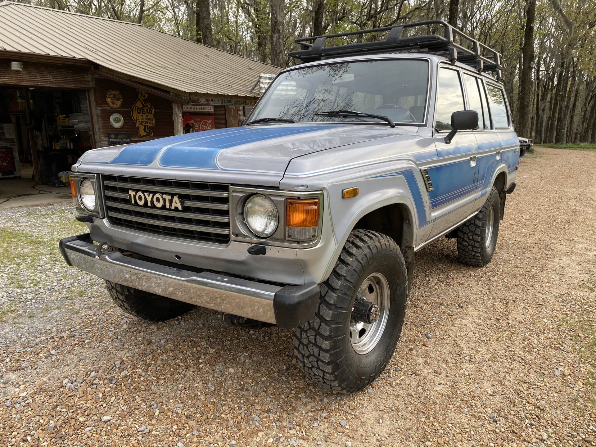

Love your cruiser. And all the work you are putting into restoring the original paint and decals.
side note I do use that P&S bead maker spray mentioned earlier on your thread from amazon. It’s a great top coat product. It can go over everything, waxed paint, glass, plastic, rubber. Everything! It’s relatively cheap and works very well ( as a top coat, last thing applied ). I love it but it’s not something that last more than several weeks to a month. I apply it’s after every wash when drying off, to a already waxed vehicle! Again awesome stuff i am pretty sure it has a uv protective as well, which would be good to help reduce further fading on those kick ass decals!
I'm following! Those sweet decals make this 60 pop! 👌
Thank you. I agree. I am playing musical Cruisers tonight making room in the shop and took it for a spin then tucked it away in the corn crib until I get some time to rub on it again
