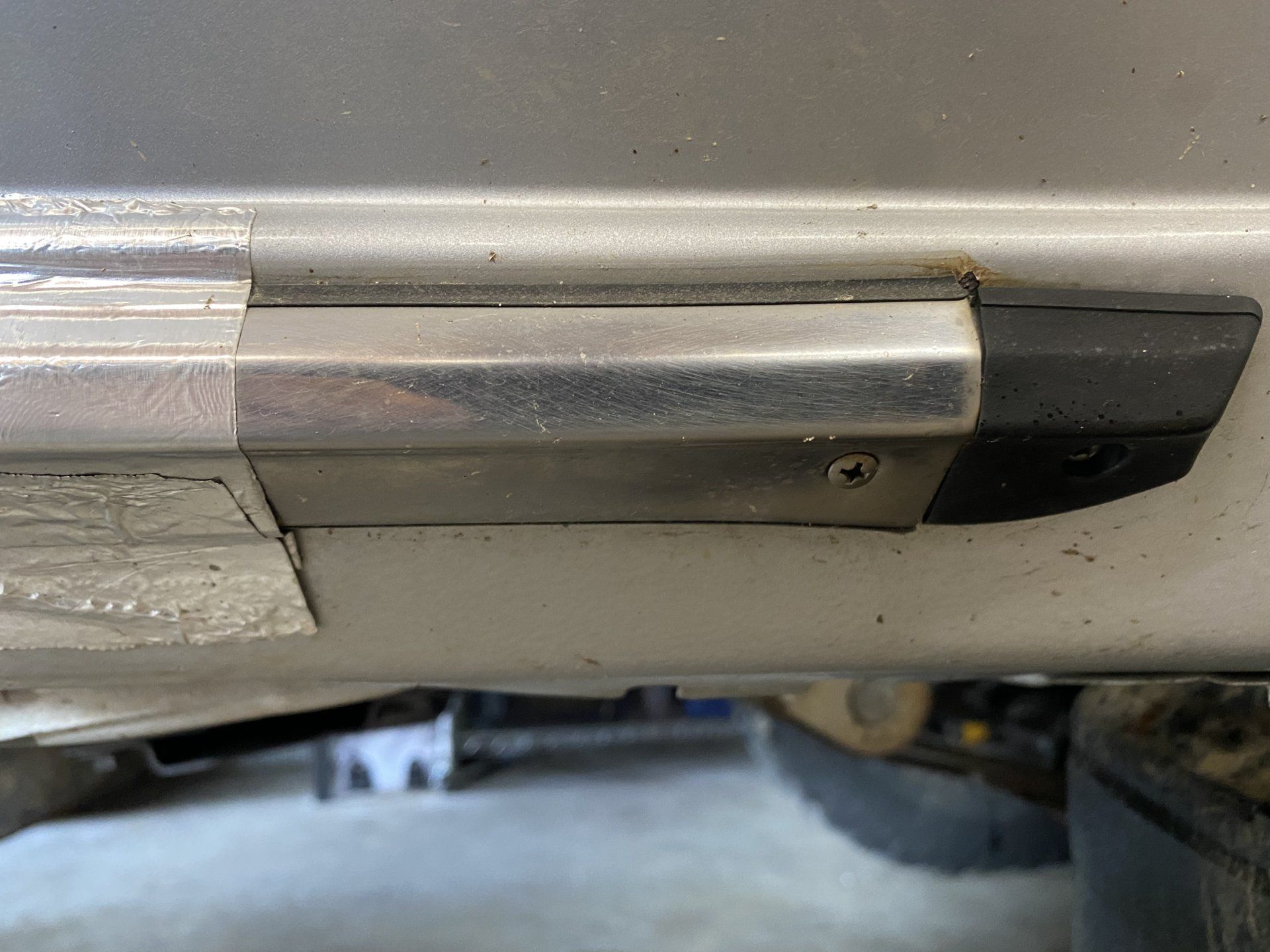

I have a single snake blinder that came in the back of my 60. How do I know what side it is? I’ve got no plan to find another and put them on - if it’s driver I’ll send it to you for the $ of shipping.

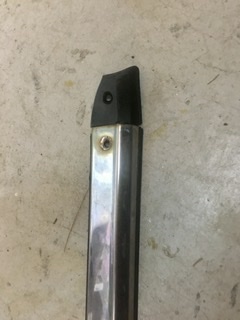

Looking at my 60, They are side specific. If the fat plastic piece is to the front and the small side is high that’s the side it goes on
this is the passenger front

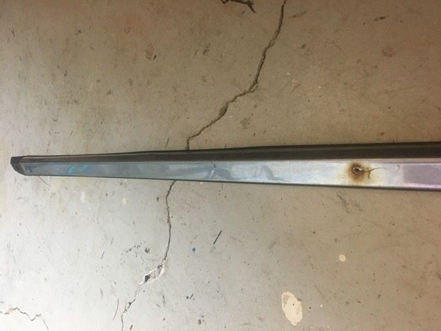

Was thinking the cheapest shipping option is probably if I bend it over a few times and stuff it in a flat rate box :rofl:
Just a suggestion, but I shipped a snake blinder a couple weeks ago... slid it into a piece of pic pipe and capped the ends with cardboard and copious amounts of tape to keep it from getting destroyed in transit.

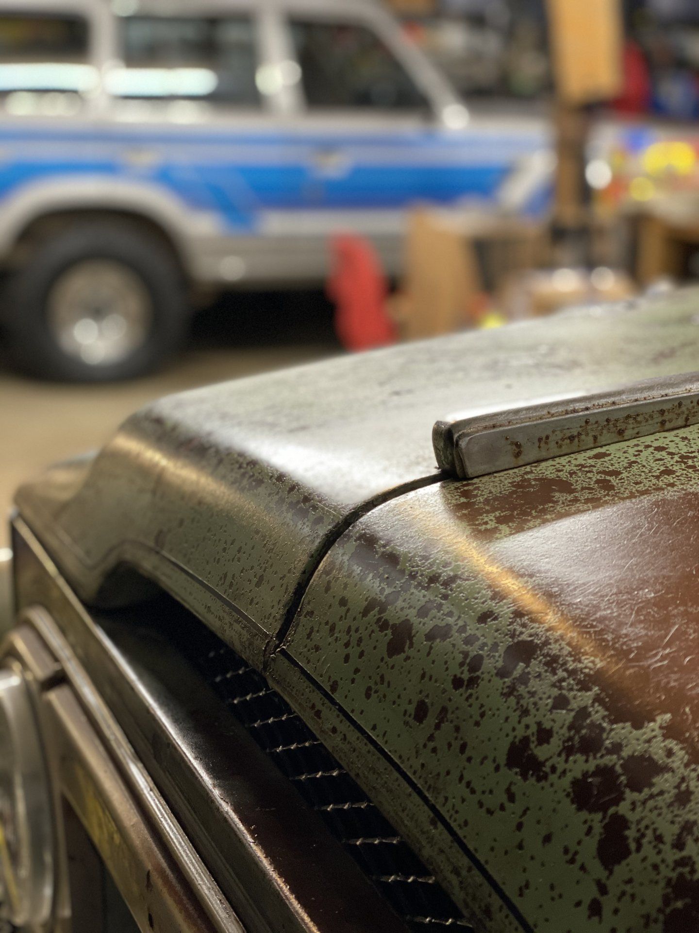

I took a break from the rubbing and polishing and switched over to messing with my new axle project on my FJ45. I’m looking forward to diving into the passenger side.
Who has the chrome trim for the gutters? 👀
