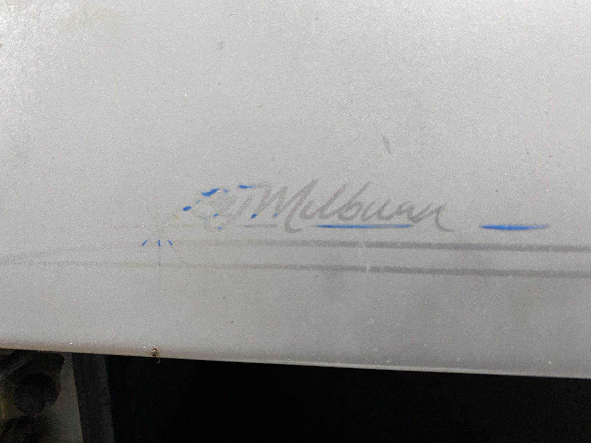

Something real cool is that the pinstripe artist signed it.....
A quick yahoo search brought up this place
I sent him a message. I sure hope he responds with some good info
Awesome
So the graphics are painted on, not a decal?
They are decals.

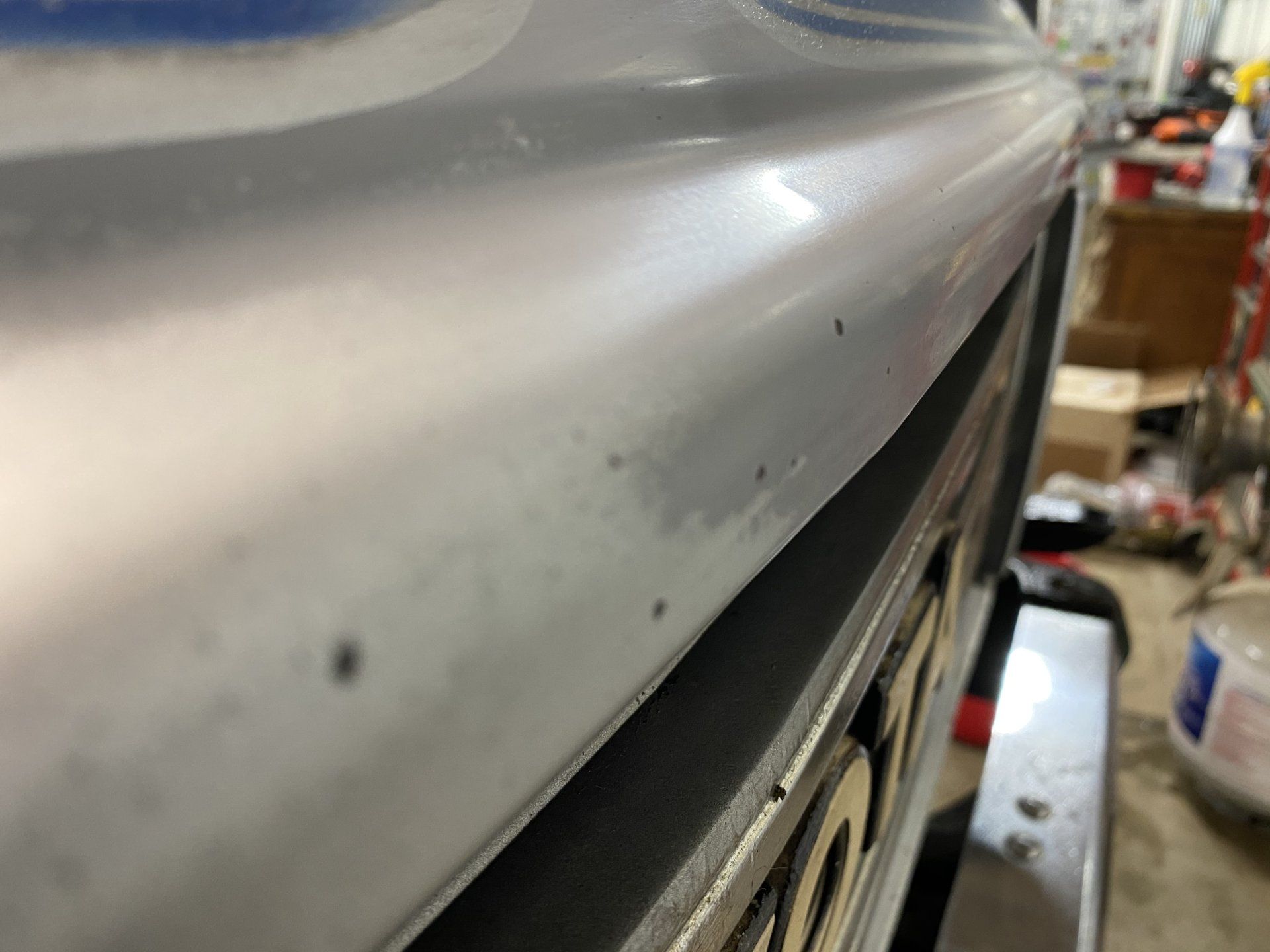

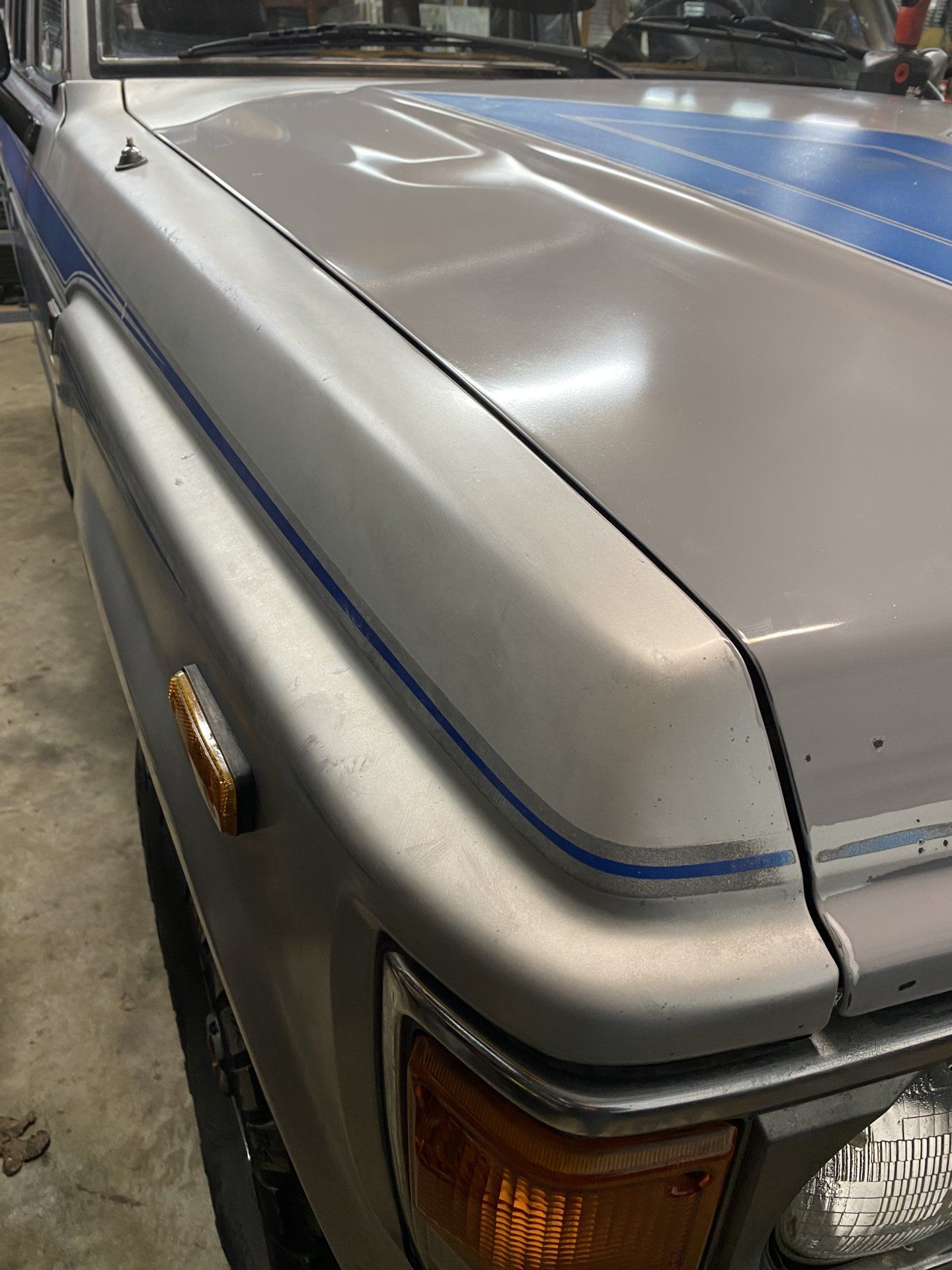

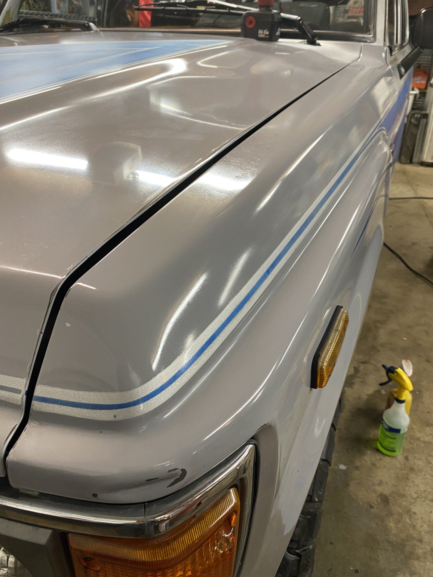

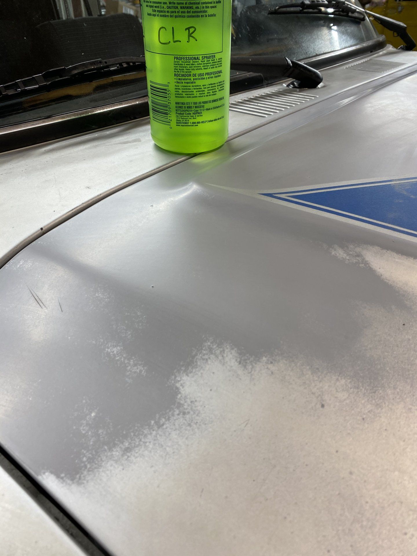

Here are some during shots. My happy place on this is CLR and 0000 steel wool.
Before
After
This is after 2 complete rounds of polish and then a final wax. Not bad for 34 year old paint
Hood. Done.

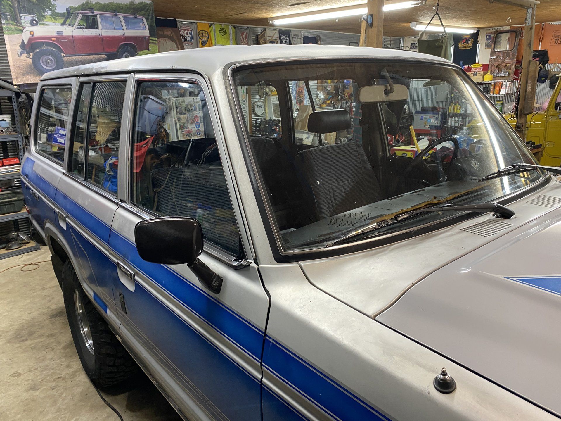

I was slapping myself on the back on how easy the tint was to remove.
That was until I touched the inside of the window and realized all the old glue has to be razor bladed off.
FJ-60s look best without tinted windows. I also would rather look at the cracked dash than the I’ll fitting, wrong colored junk that was on it
Not sure what method you used to de-tint, but a cheap steamer almost makes it too easy. Glue comes off with the tint as you peel. Lookin good.
Too late for that. I snatched it off and by the one window I cleaned I would say I guess all the glue stayed on the window :rolleyes:

Are you running steel wool on your orbital and just dumping a small amount of CLR on?
Beautiful your cleaning it up nicely. What a great find. Love the 60 and Star Wars theme, R2D2 is a great name, my kids would agree. I was considering a paint job on my 60 and now you’ve got me wanting to see if I can restore it’s factory paint. I love the patina look. :popcorn:
