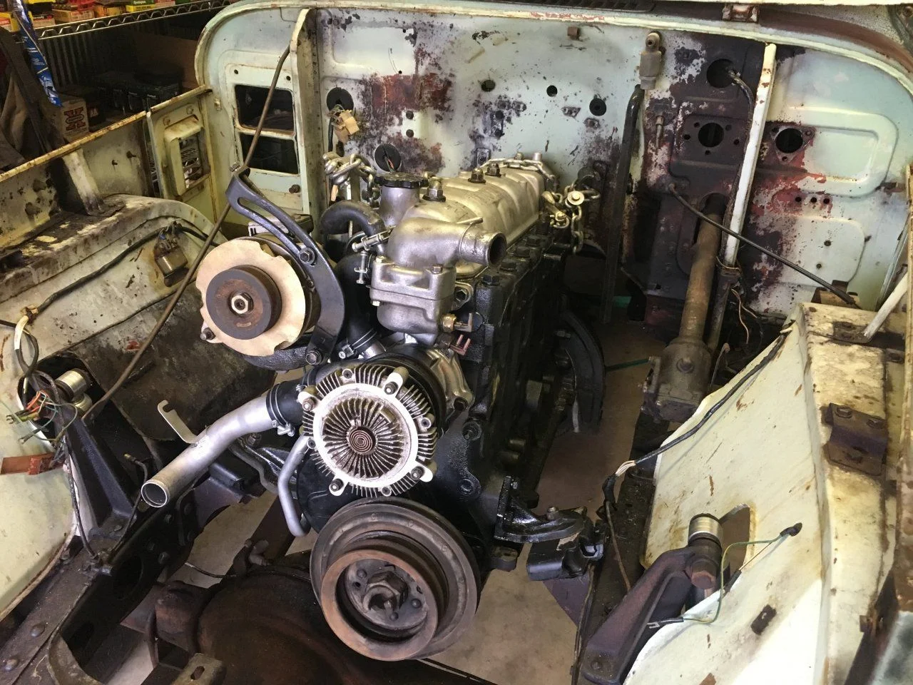

So wow. We got it in there.

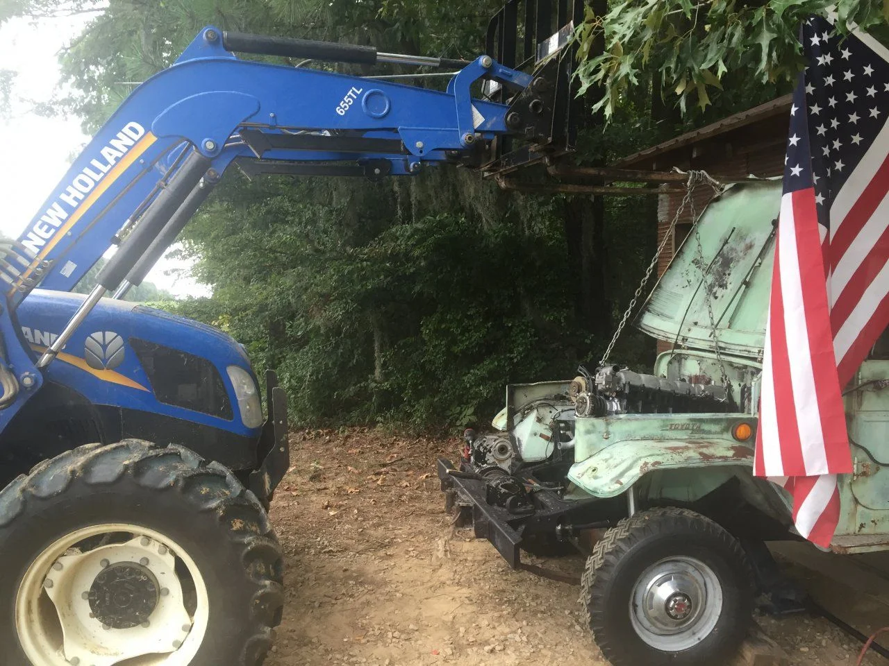

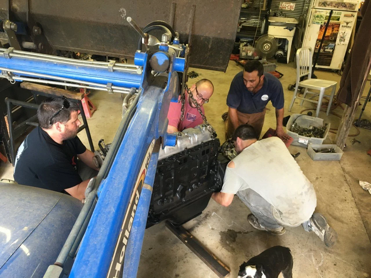

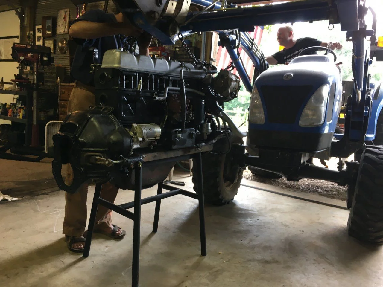

Biggest issue was the motor mounts and the "engine hoist"
The small tractor was 4" too short to get the motor in the truck. Bumper to bumper.
I got the big tractor and put the fork lift attachment on.
Perfect.

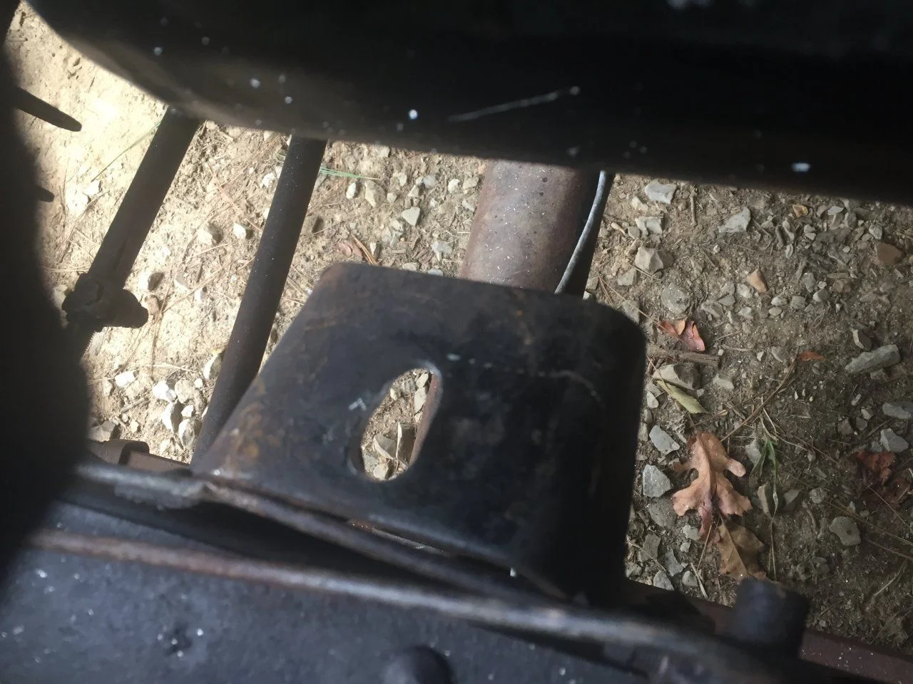

Except the motor mounts were wrong.
We screwed with it and finally Beno remembered the frame mounts on 60s and 80's have elongated holes.
I busted out my carbide bit and whammy.
It's in.
