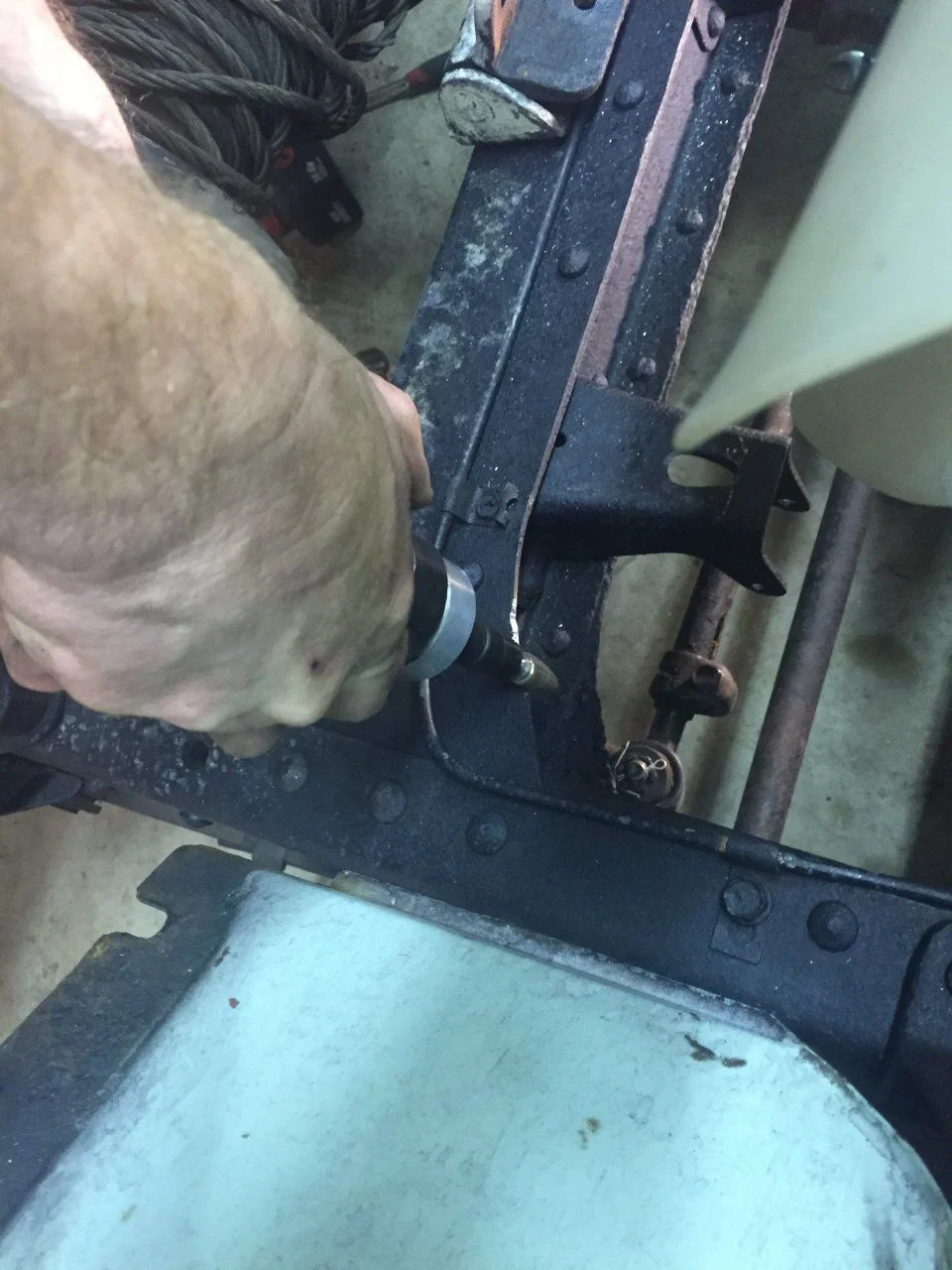

We used the F passenger bracket and he holes needed to be bored out on the bracket to 12mm (2 buckets did a fantastic job.
In the end though, the mount holes in the frame were about 2" too narrow.
We took a carbide bit and elongated the hole to fit.
Carbide bit for the win.
Huge PITA but would have been a snap if we had known before.

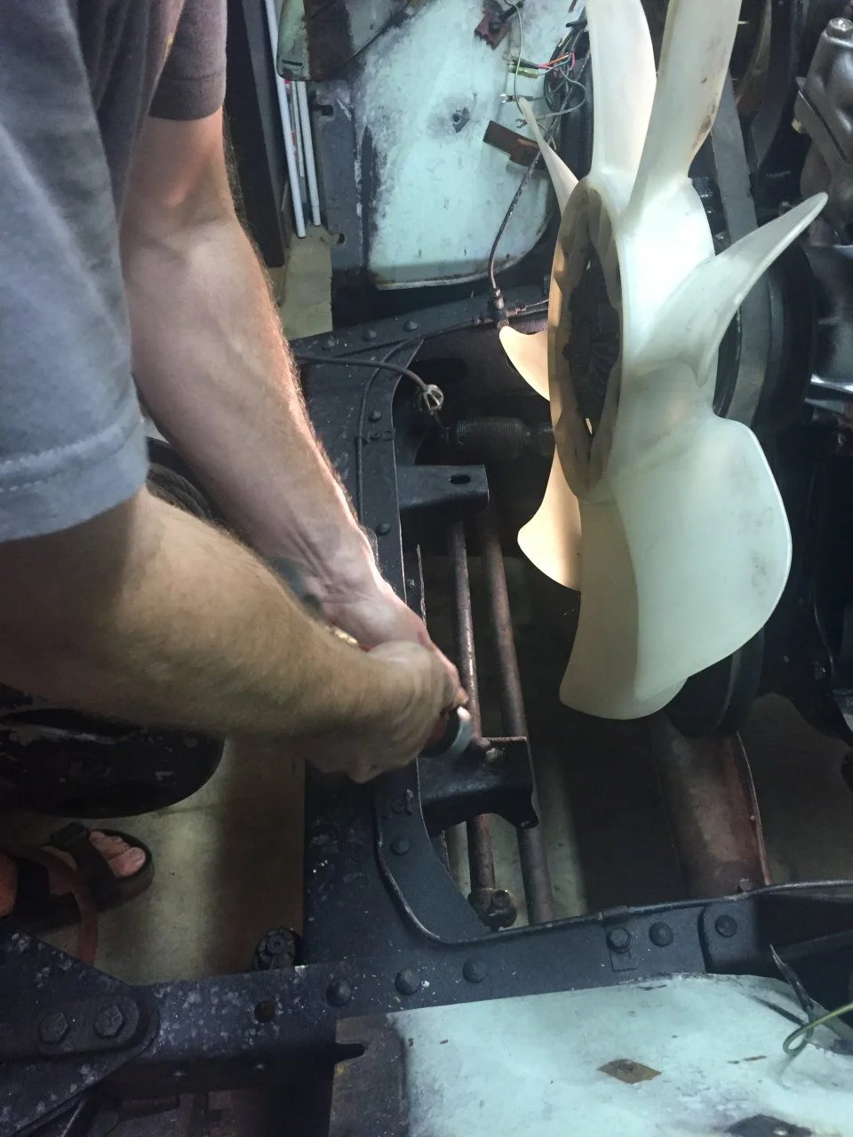

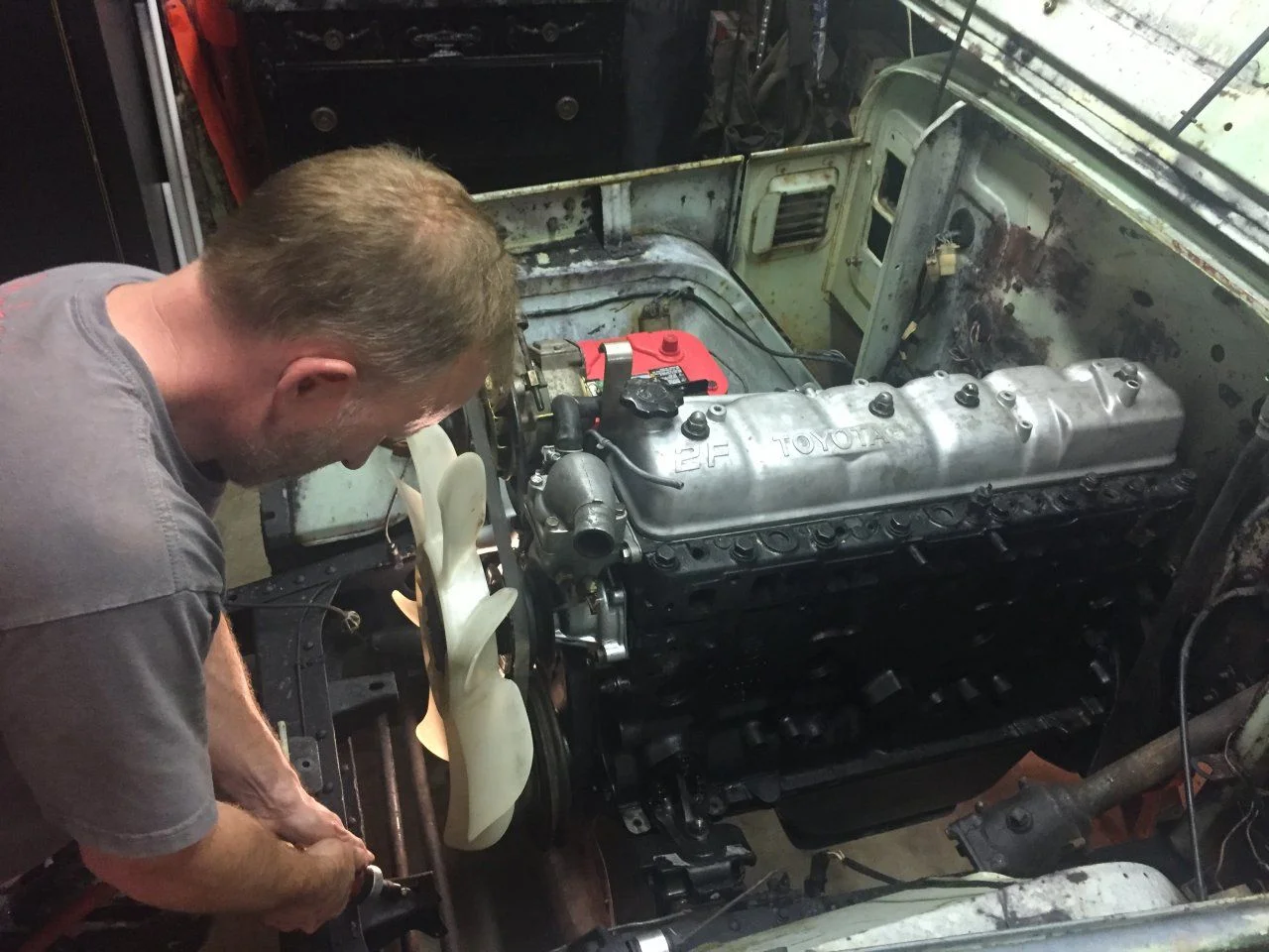

Fan. Radiator. Etc.
This motor has a fan clutch and a big ass plastic fan.
The fan I used was one out of an 80 I parted out. It's the same size as the 60 one that came with the motor minus the ribs on the blades and it is clean. The other was stained and ugly.
We fit the motor in. Installed the blade. But the radiator cradle in the truck. And slid the brand new OEM radiator in and proceeded to bend the fins all the down the new radiator until we realized it was too close.
So. We pulled it all back out and repeated what we did for the motor mounts. We elongated the holes in the radiator support mount to slide it all away from the motor.
Photos by Beno
I even had to notch out the drivers side frame support some to be able to slide the radiator support forward enough to clear the fan.

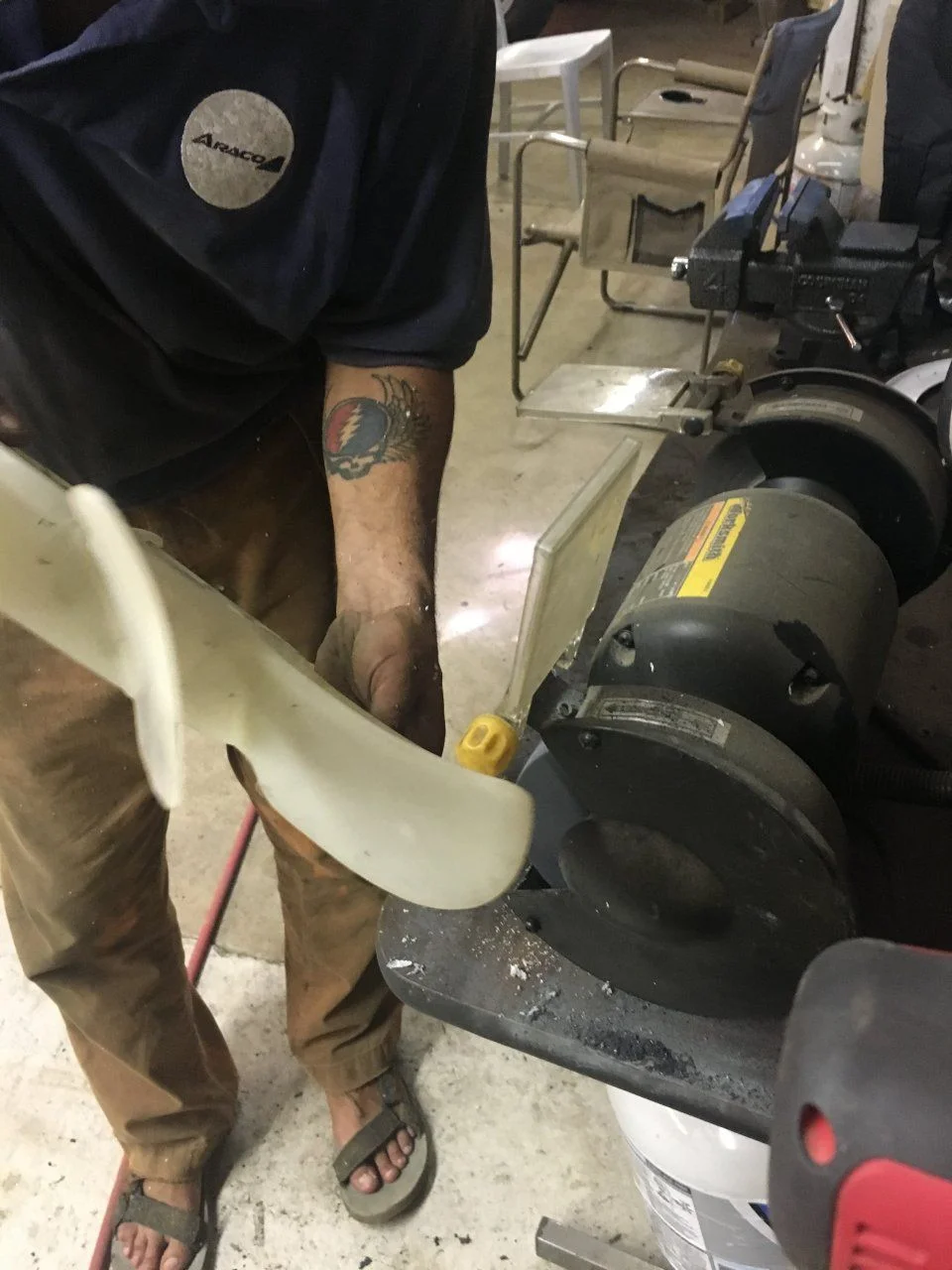

As we said before, Beno took a bit off my fan just to be safe.
Seriously. We were totally winging it.

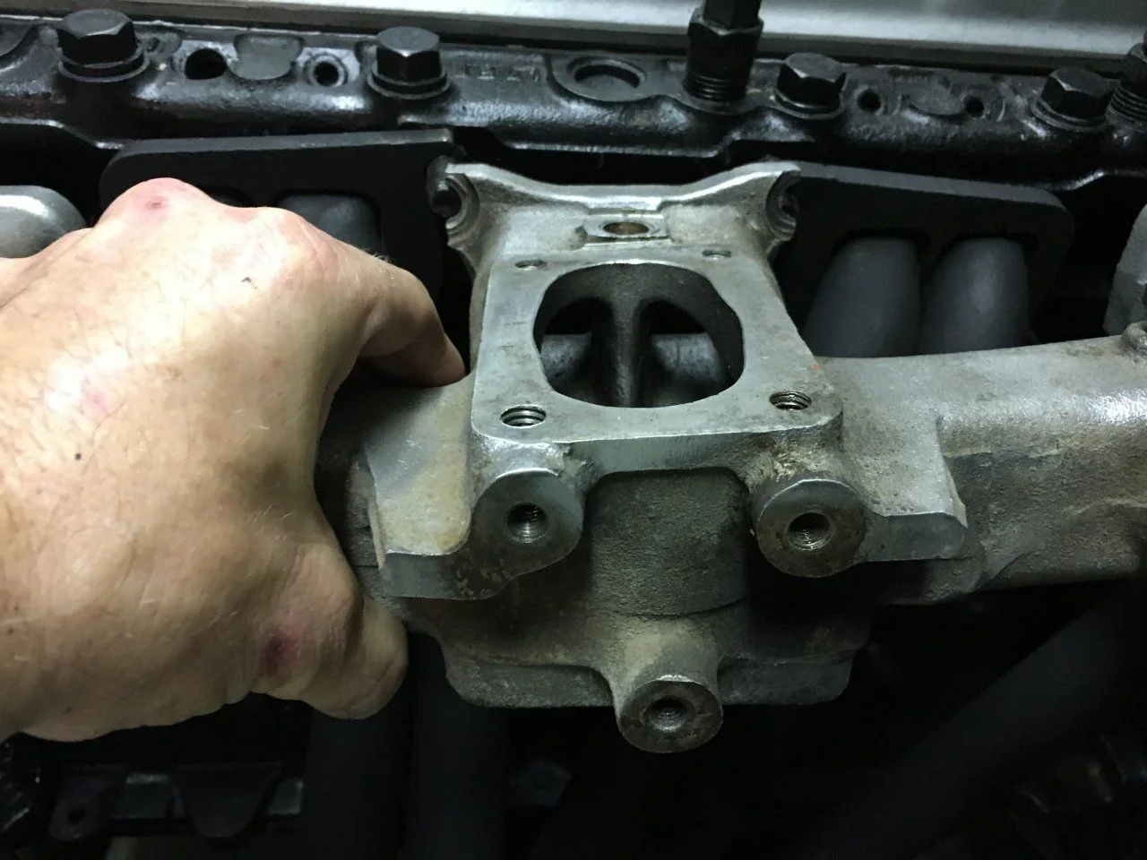

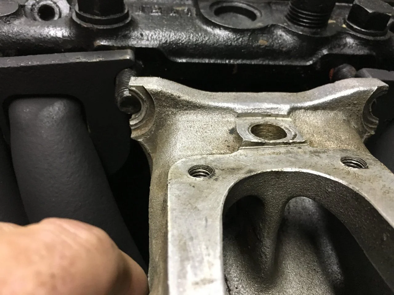

Intake manifold. Ugh.
My buddy @RustyNailJustin sent me an FJ60 intake manifold but it has a broken ear.
Rob told me he had a good one that did not need welding and had no EGR ports at DNPs shop.
I jumped on it. Got it super clean. Went to bolt it up and fuuuuuuuuck it an F manifold with 10mm bolt holes, not 12mm.

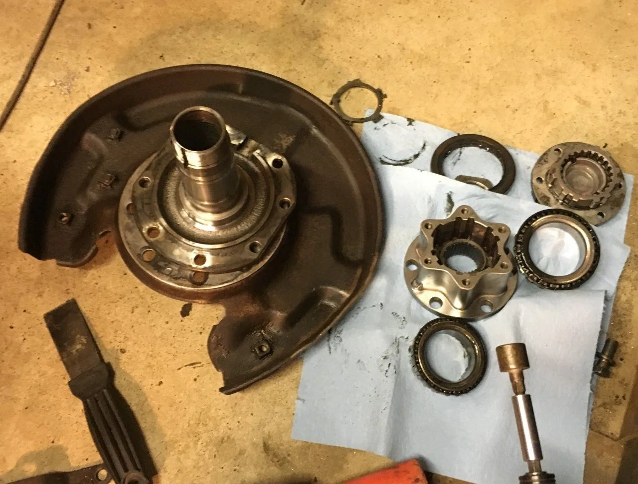

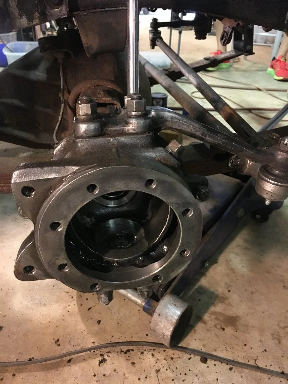

We started on the front axle and ran into too many problems to finish.
Calipers. Toast. Inner axle. Leaking. Killed seal and
The other was junky
But. The wire wheel shire made it look good in there.
Cleaned and painted everywhere you can't see :)
Lou is so cool he wears shades to grind
We have about 1 million axle seals...
Yeah we dove into that project unprepared. My fault. I had a gasket kit not a seal and gasket kit.
It's cool. It's coming.
