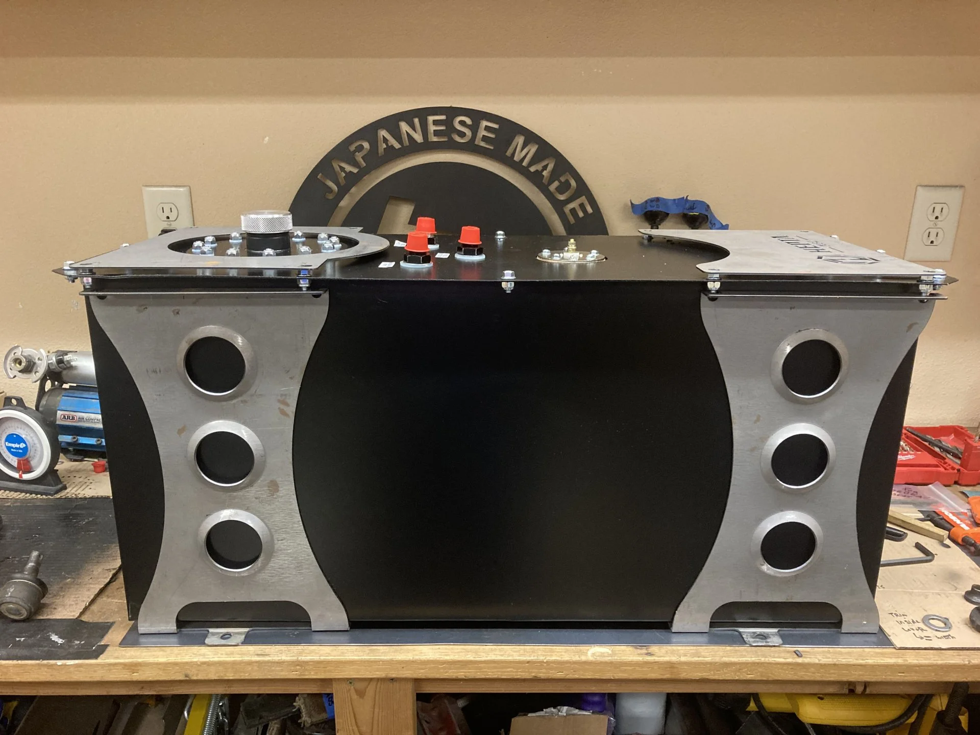

Here is a pic of the RCI rock crawler fuel cell Not bad quality, has a bladder as well. I will run it with in cell fuel pump. I will most likely use this cell as a template and build a stronger cell of thicker gauge. So overall a win. I did speak to about 5 guys running it and they are happy with it. Anyone out there looking at building their own hit me up for a template.

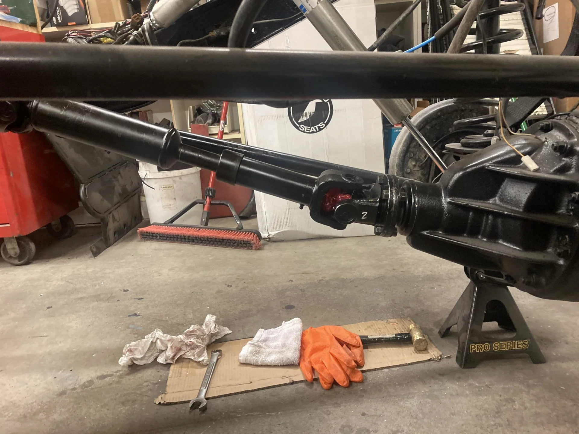

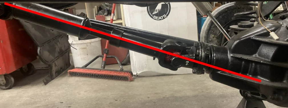

Hey Ryan sorry to jump on your build tread. Again, would you guys take a look at my new rear driveline and the pinion angle and tell me it that look ok. I can adjust my 4 link to tilt the pinion upward if needed. Thanks.
What does your front angle look like compared to the back? It might be the camera angle but it kind of looks like the angles are not equal, which isn’t a problem if you have a cardan joint at the transfercase?
Like Mike said, it might be the camera angle. To me it looks like the pinion needs to point up some.
Agreed. Here's a visual of the driveshaft line running into the pinion. This should hit the center of the pinion not the bottom of it like it is now.

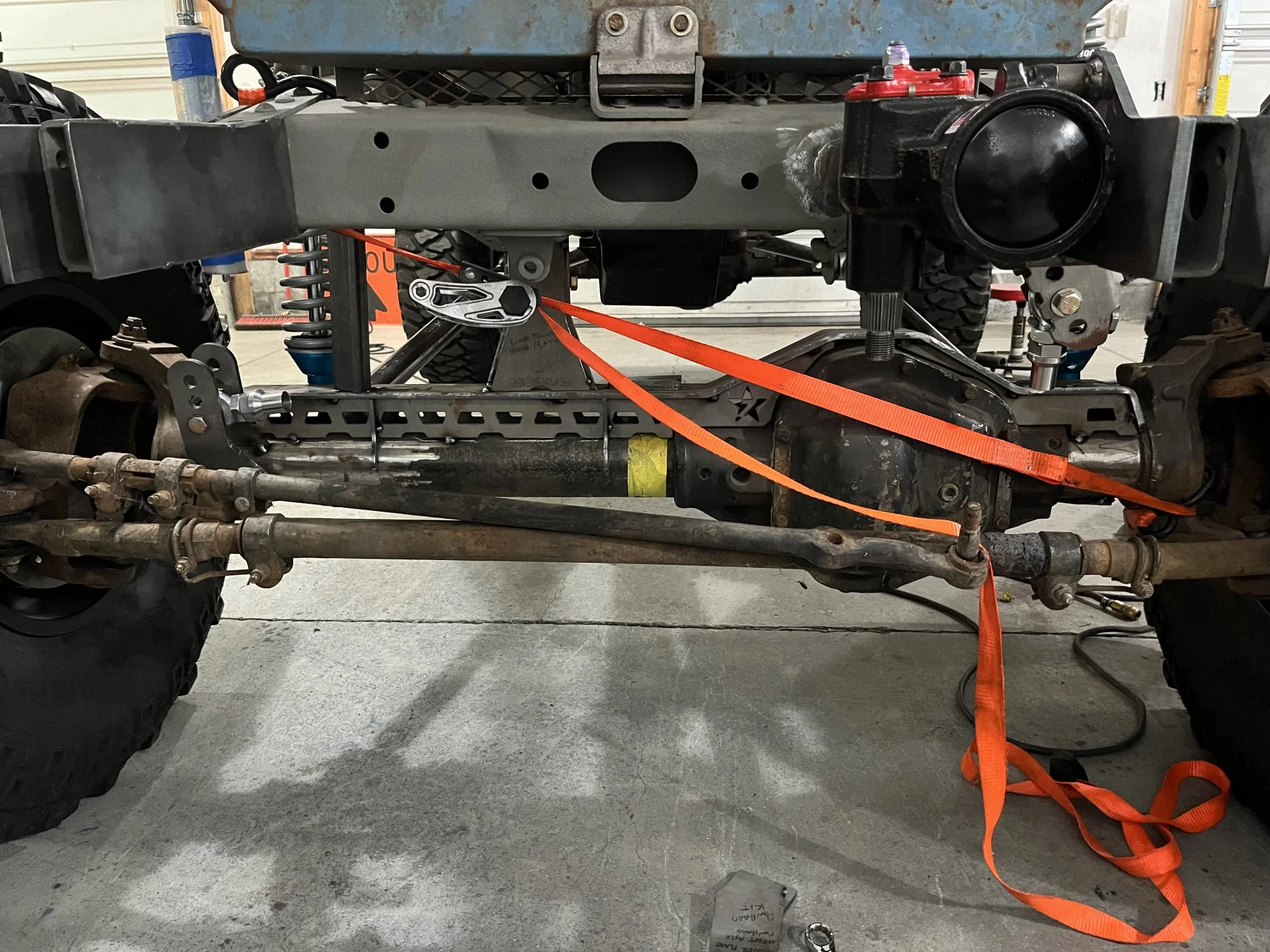

Started working on the track bar the other night. Need some different misalignment spacers. Also waiting on the Barnes high steer kit and steering arm kit

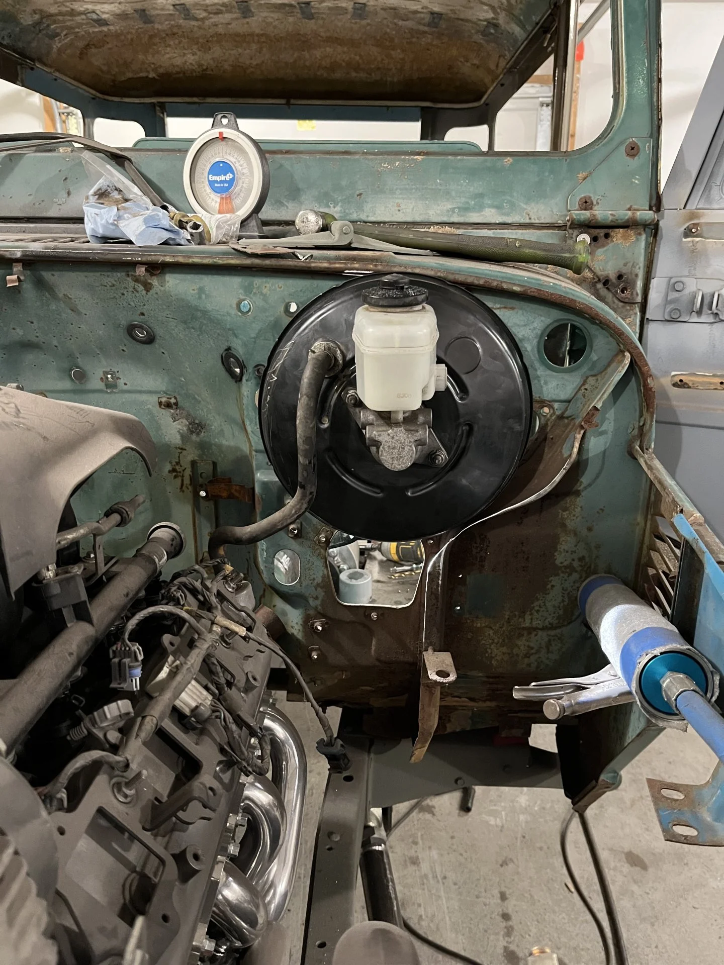

Waiting on parts for track bar, high steer, and steering arms. So I decided to work on the brake booster
Booster is out of a 2007 Tacoma

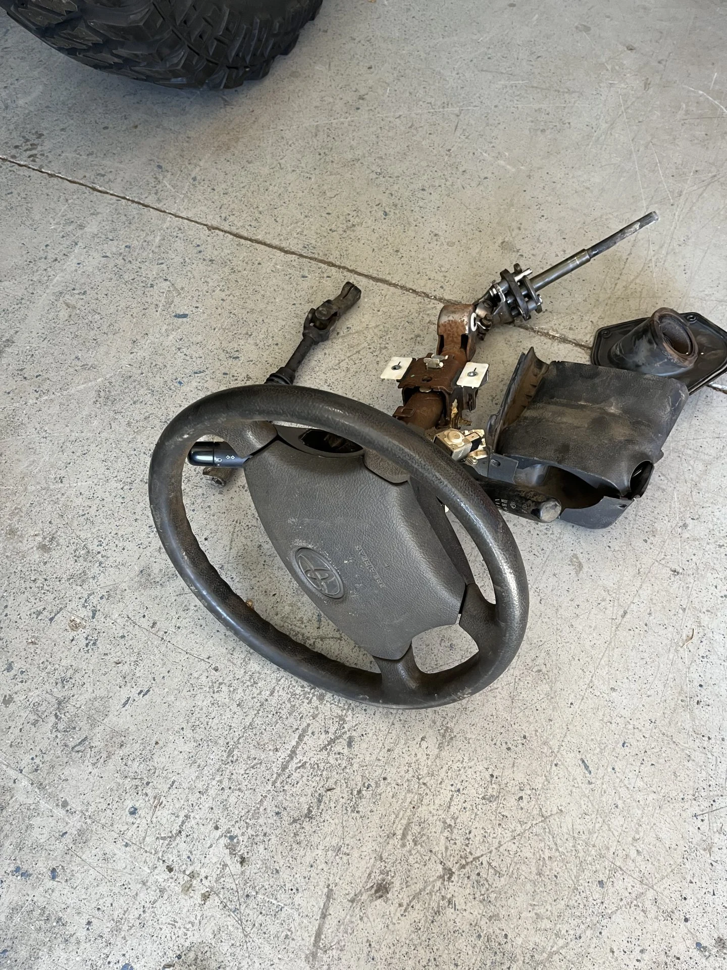

Got the steering column and all the linkage from the 2007 Tacoma

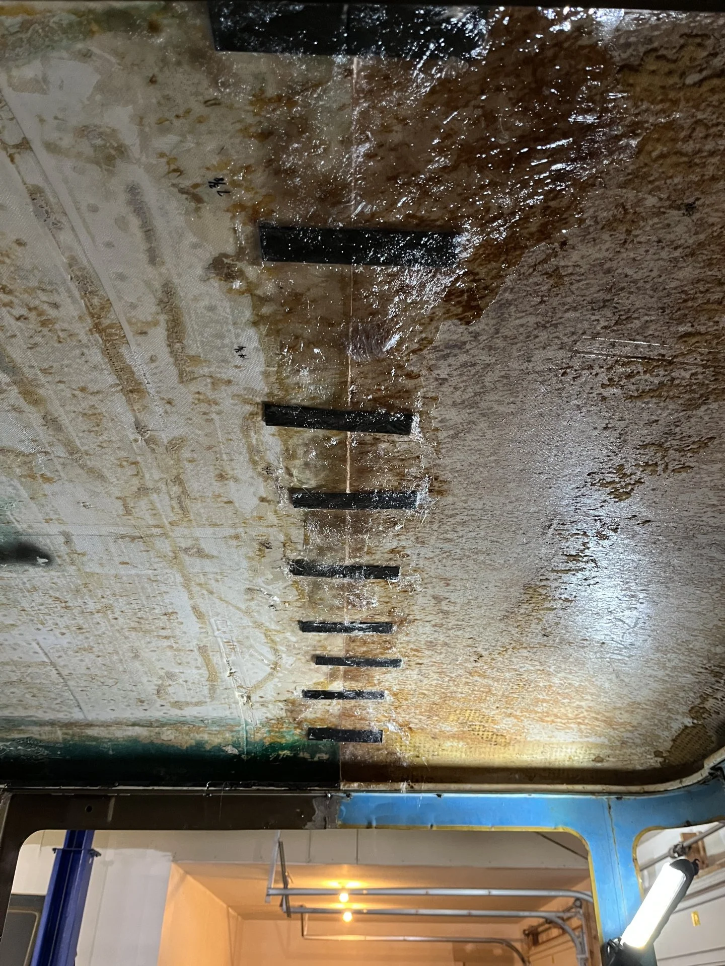

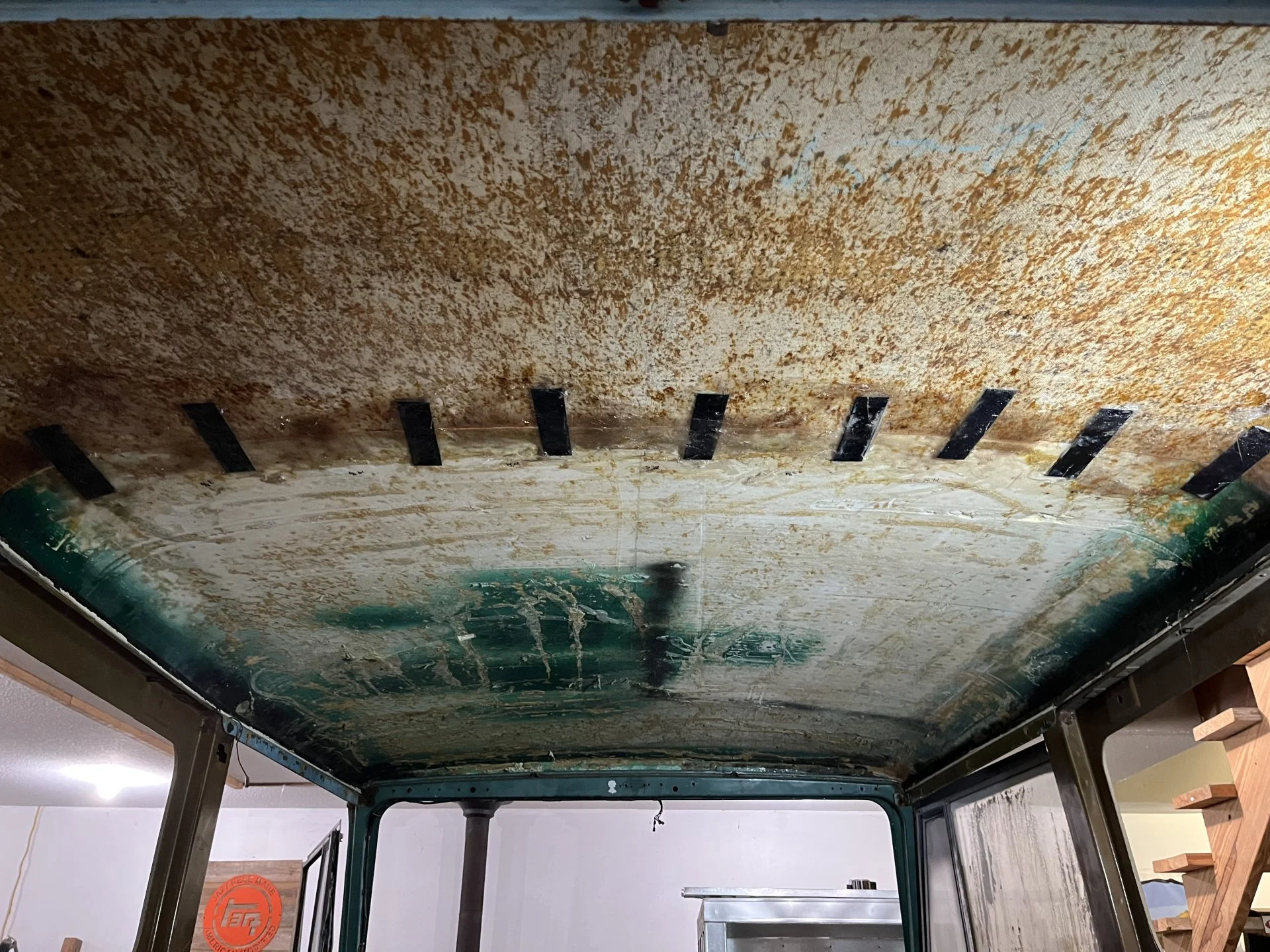

Worked on the top a bit also. Epoxied metal strips on the inside and then fiberglassed over the top of them. Still needs more work but getting there
Ryan, sweet booster. Much small than the original 40 booster. I was just looking at options for my build. Are you planning on running the Tacoma steering wheel. I’m been looking a PRP wheel.
