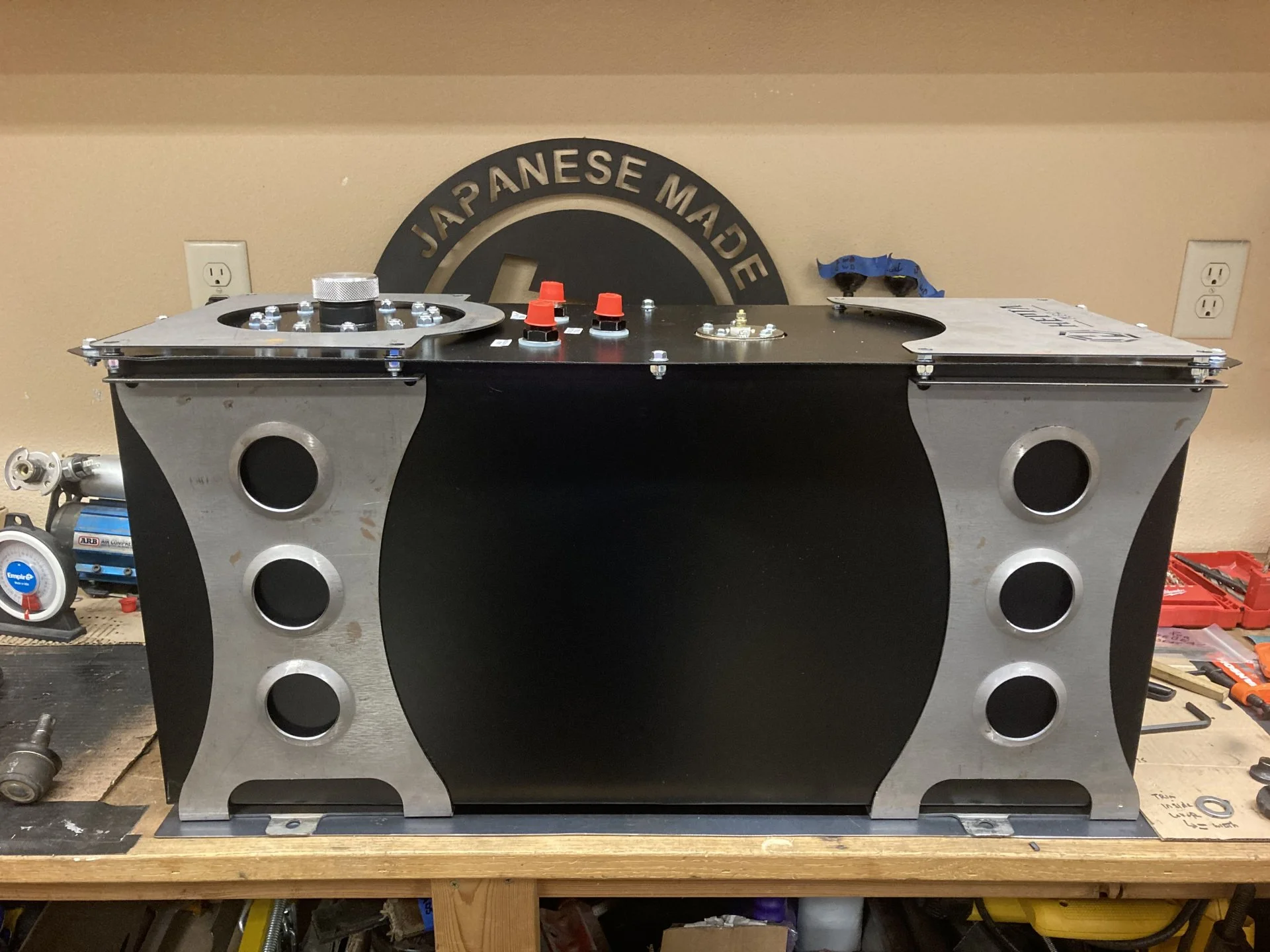

Here is a pic of the RCI rock crawler fuel cell Not bad quality, has a bladder as well. I will run it with in cell fuel pump. I will most likely use this cell as a template and build a stronger cell of thicker gauge. So overall a win. I did speak to about 5 guys running it and they are happy with it. Anyone out there looking at building their own hit me up for a template.

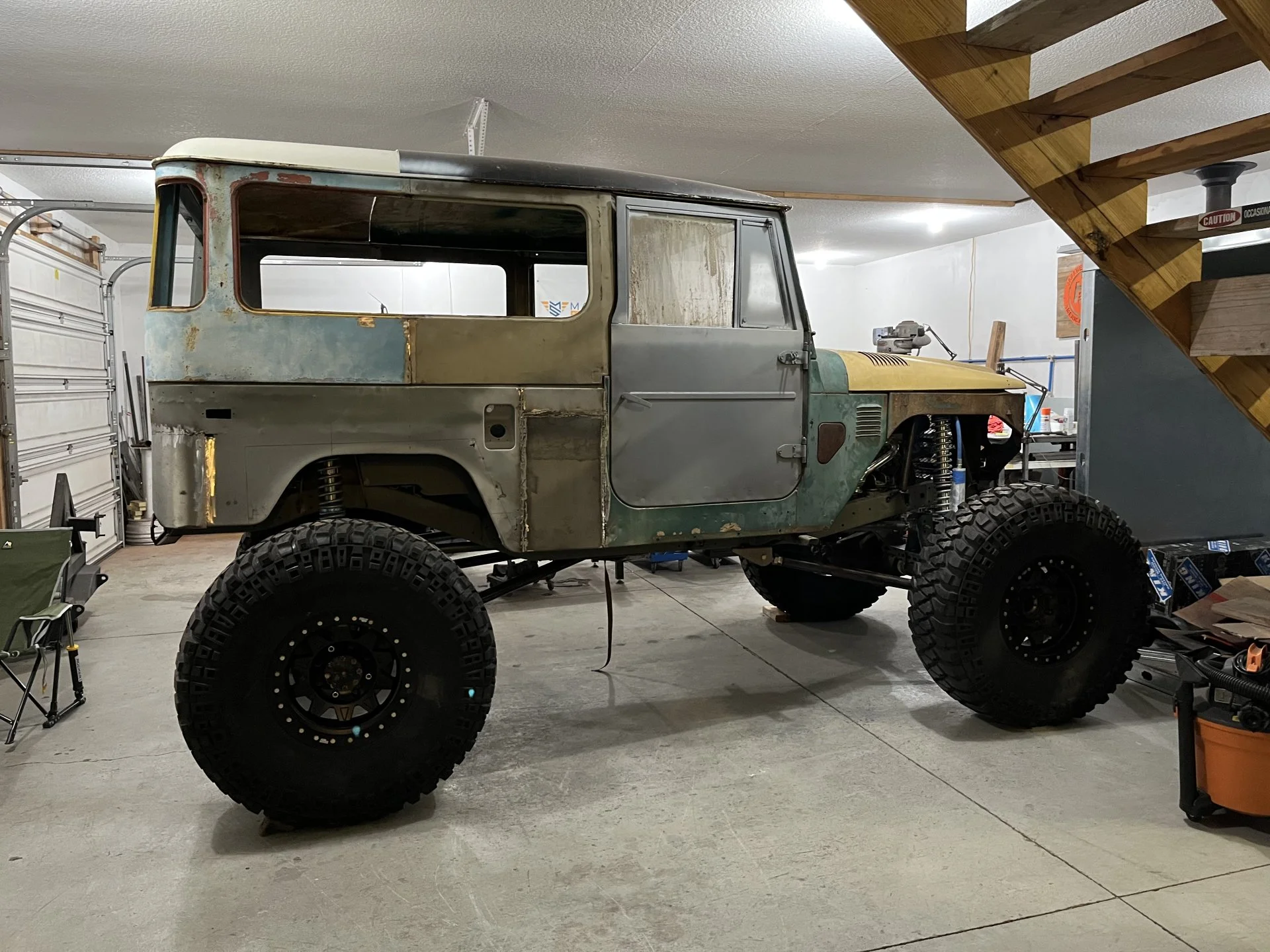

Well I got Lockjaw off of the lift and on all fours finally. Had a few issues but not to bad.
Need to open up the rear wheel wells and finish up some body work. Got a ton of stuff to finish up. More to come

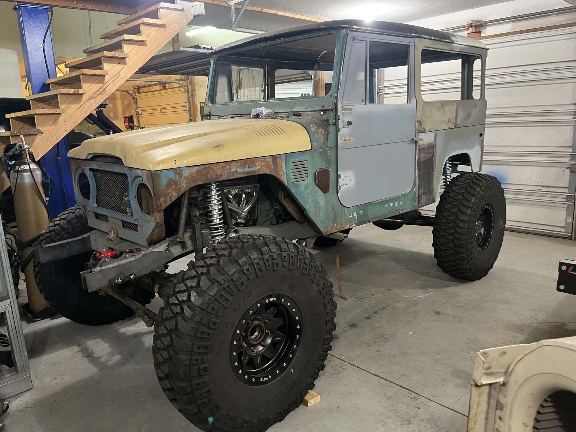

Keep it coming as life allows. Linking the front has me a bit spooked. No experience. Maybe I can recruit Danger noodle to come out Montana and give me a hand.
Linking my Cruiser was easier then I thought that it was going to be. Next time I’d spend less time worrying about lower link placement to the frame on the front end. I got pretty good geometry by changing the axle mount and upper link placement.
There is a four link and three link calculator on the web site Crawlpedia
You beat me to it Mike

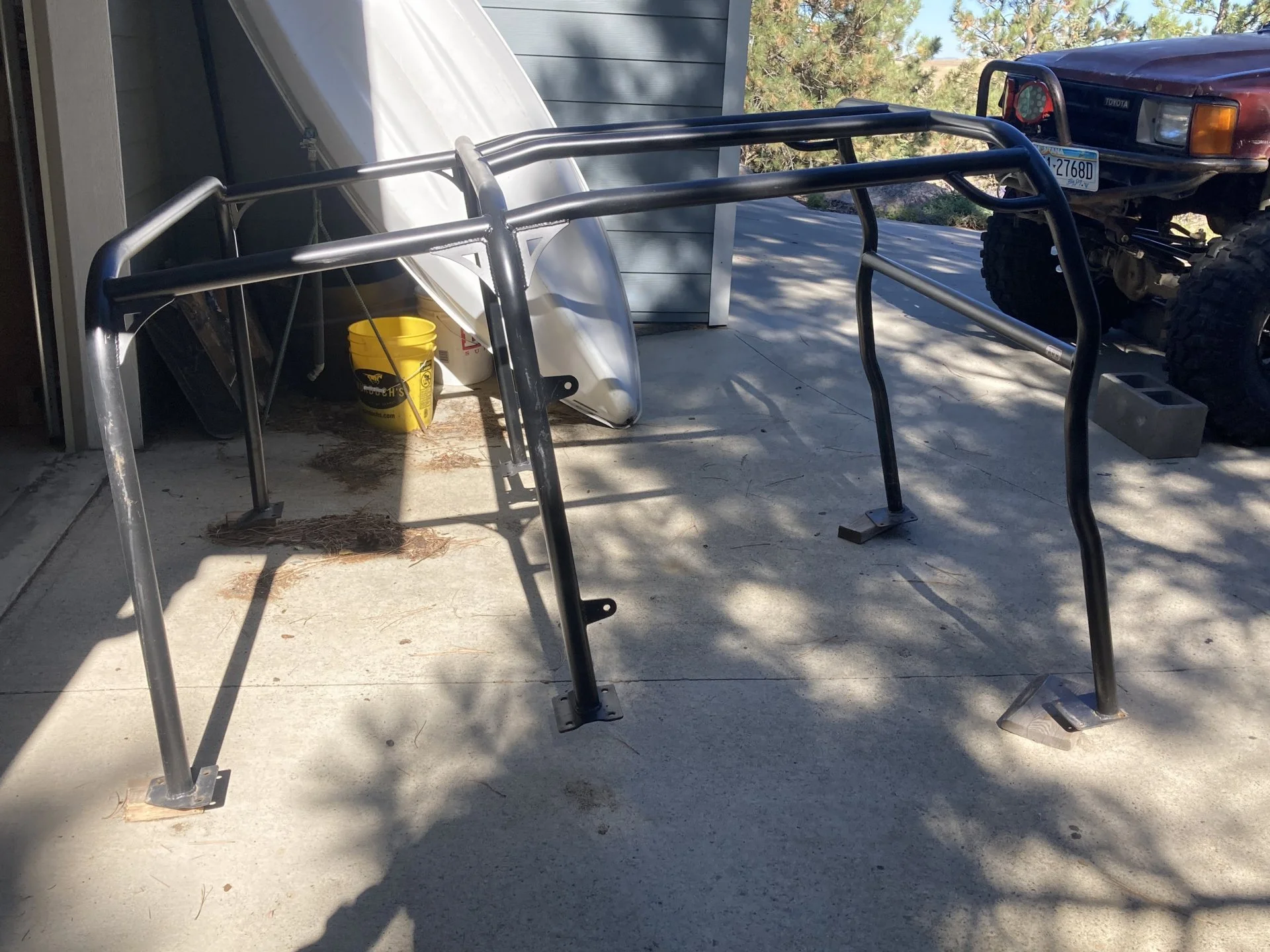

Here is my 40 cage. By PC back in the day. Family cage. Still really like it.
This cage looks clean! Let’s see it on your Cruiser.
What bender set up do you own? Happy with it.
I just bought a JD Squared model 32. I also purchased Bend-tech Pro with the roll cage template software. I’m excited to use it
