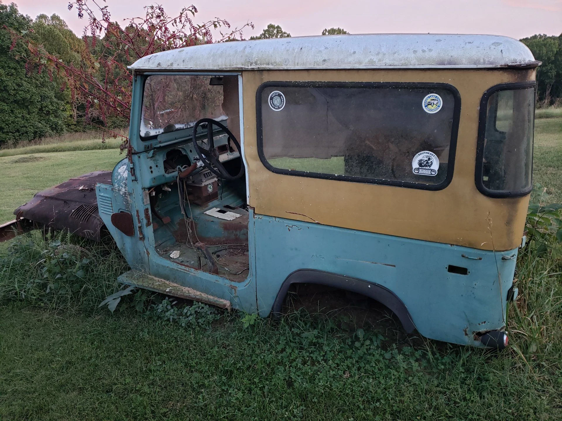

This is the start of a slow build. I've spent time in the Fj60's and a two year build there. Now I want a 40 to wheel in. It's a field find 40, 1973 model.

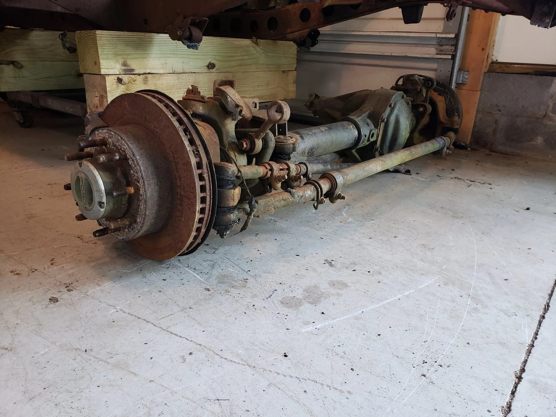

Dana 60 front
Sterling rear

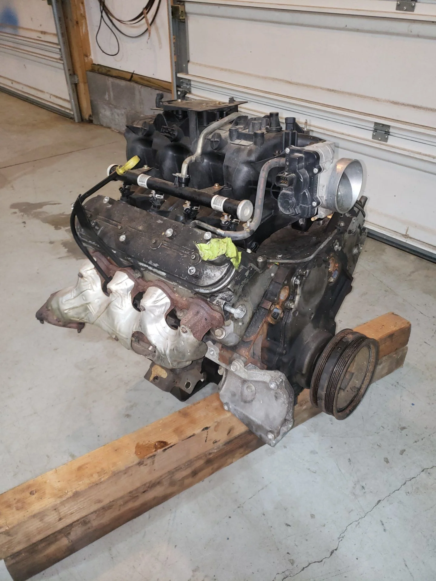

5.3 liter engine

Cool stuff Ryan, looking forwards to it. On the budget part I can help save you a ton of time of headache, skip the GM ECU and go straight to a Holley Terminator X. It will save you so much headache down the road trying to make that 4l80e work with HP tuners segment swap bull****, I’ve been down that road before, complete nightmare.
Don’t do a thing to that motor, it looks ready to run as it is. Don’t let anyone talk you into any high-volume oil pumps, head studs, etc.
Cool stuff Ryan, looking forwards to it. On the budget part I can help save you a ton of time of headache, skip the GM ECU and go straight to a Holley Terminator X. It will save you so much headache down the road trying to make that 4l80e work with HP tuners segment swap bulls***, I’ve been down that road before, complete nightmare.
Good info Matt. Thanks for the heads up

I see the GSMTR and STLCA stickers, did someone local have it in the club?
Yes it belonged to our club president of Appalachia Cruisers. It has sat in a field for a long time. Now it's ready for a new life

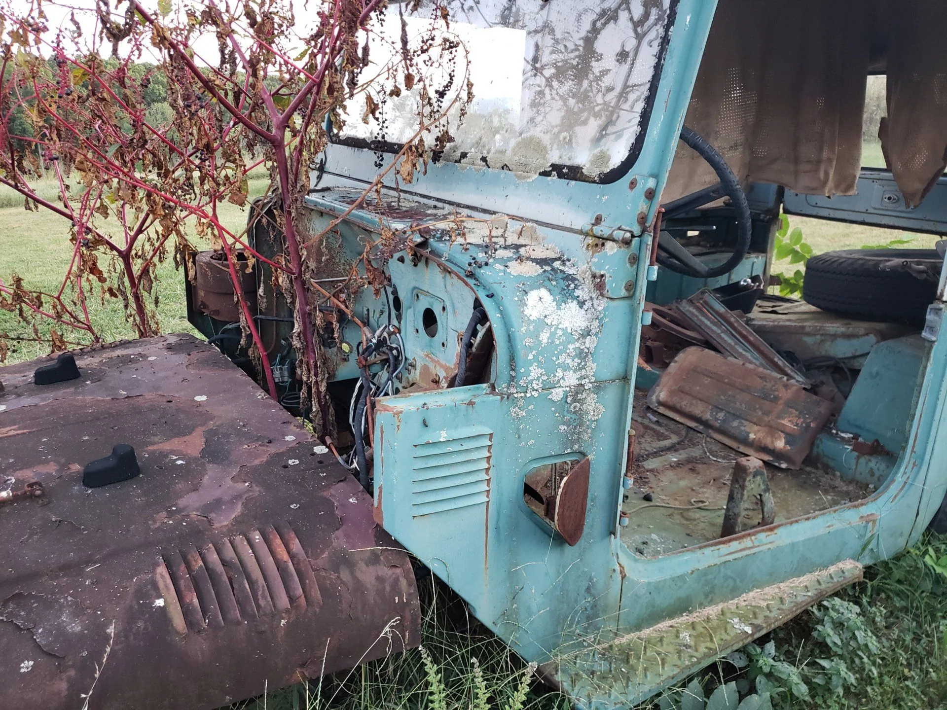

Trying to figure out what the original color is on this tub, it's so faded I can't really tell.
Polished a place on the lower dash. Anybody know?

That wouldn’t have been Rance’s 40 would it?

Gonna check on a transmission tomorrow, 4L80. Then tear down axles and cut off the unneeded stuff on them.
