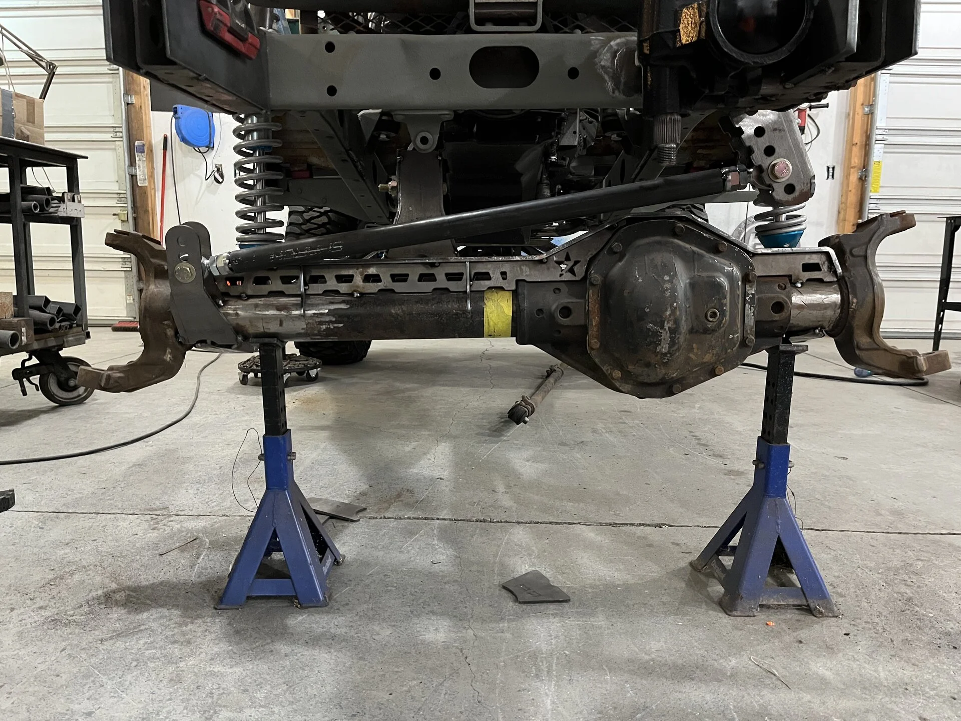

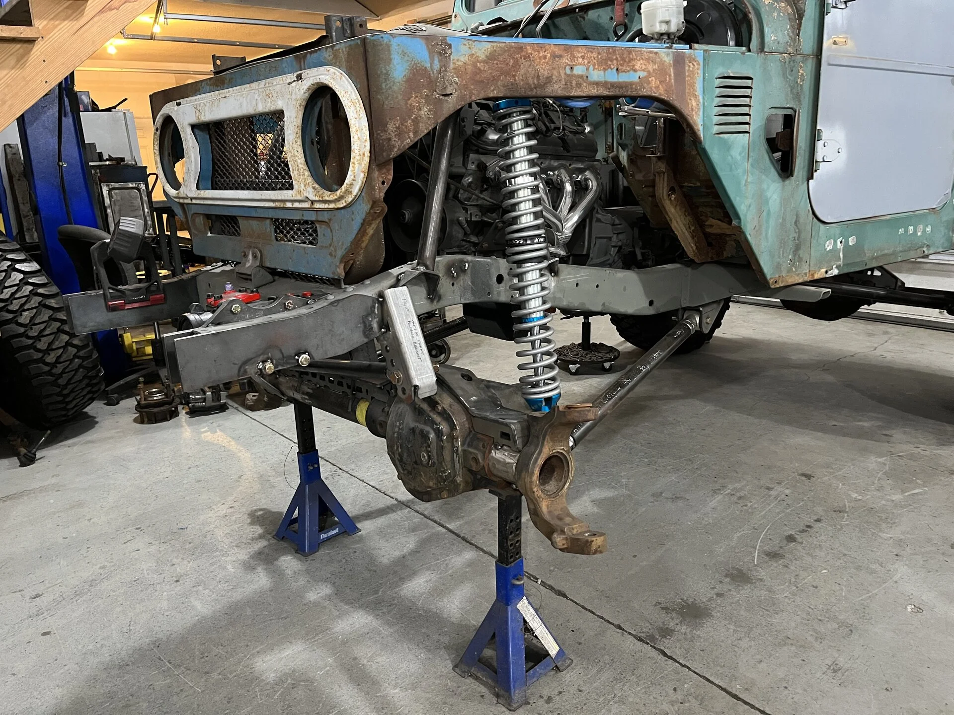

Got a little work done last night on LockJaw. Panhard bar is mocked up. More work to be done in the next week.
Is that the same length as your relay rod? I would put the knuckles on and get everything the same length and angle to ensure you don't have any bump-steer.
Got a little work done last night on LockJaw. Panhard bar is mocked up. More work to be done in the next week. View attachment 3183604
The knuckles were on when we did the Panhard bar. The relay should be about the same length and angle as Panhard. Everything is just tacked in place right now in case I need to move or adjust anything. Waiting on a set of drill bits to come in so I can drill out the steering arm for the Barnes4wd high steer kit.
