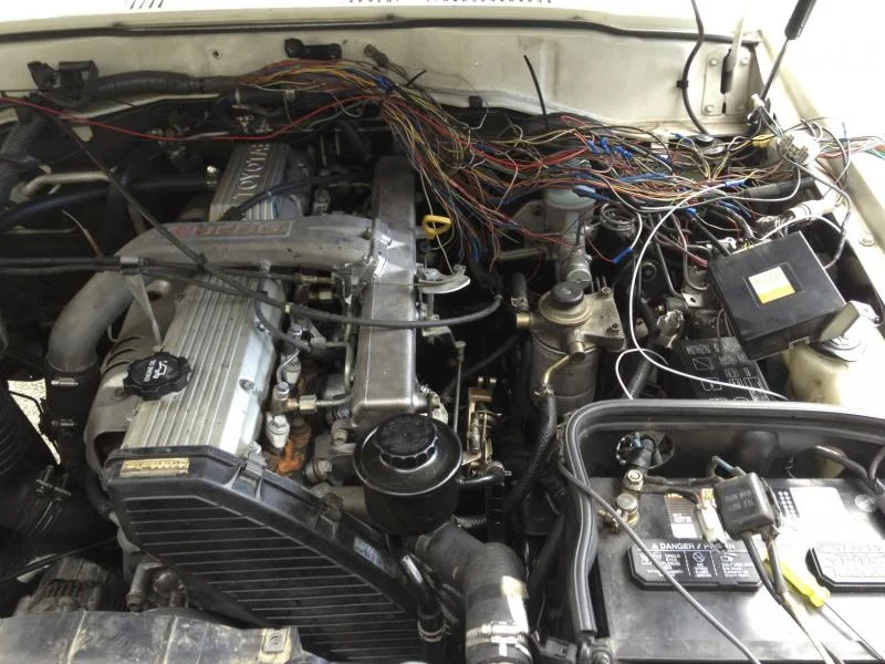

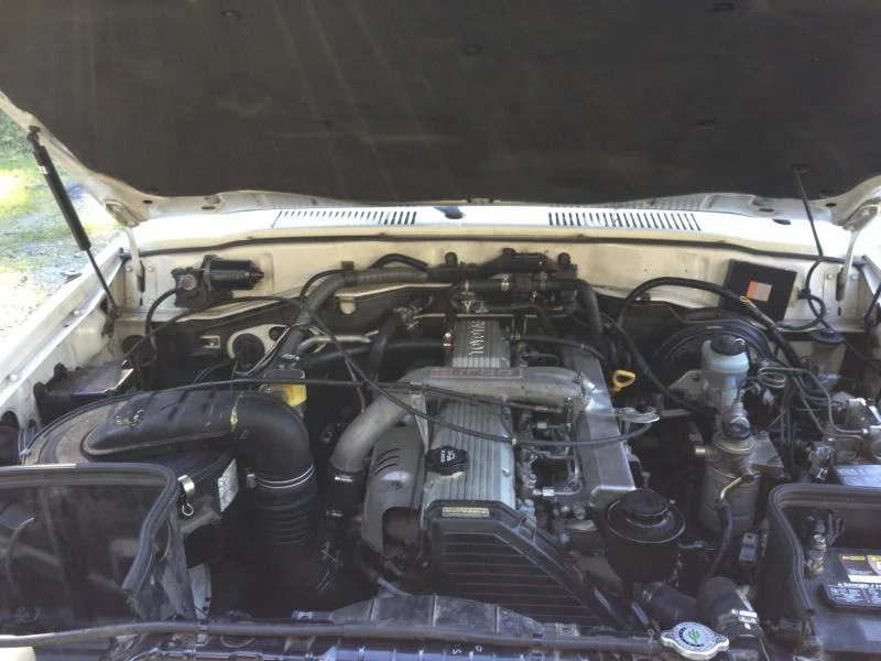

Awesome engine swap!
I want to ask you about the main wire engine harness, showed in both picture, did you used the gasser ones or the diesel?
Also, there is an specific reason to do not use the entire diesel cluster (with speed meter, RPM, and lights?)
I will do a similar swap, and i am not decided about those two issues.
thanks
I temporarily crimped the necessary wires together to get all the circuits working... drove like this for a couple days, but finally got around to tidying it all up! All circuits are working including cruise control and the glow plug timer!
Next up is A/C... gotta get some lines modified to relocate the receiver/dryer up by the battery, JDM style, and make the compressor work in its new location... I have also been working on making a way to fit a York compressor in addition to the stock A/C compressor...
thanks
If you can see the black plastic part on the harness that goes over the valve cover, that is where the splices are from gas to diesel. There were a couple wires that I had to add (turbo lights, and tach I think) and a TON of gasser wires that I just left disconnected.
The reason I didn't use the entire cluster is because of the model year differences (my diesel was a 1991, and white truck is a 1996). The newer trucks have different connections etc. Also an electronic speedometer, vs the cable driven one on the old truck.
