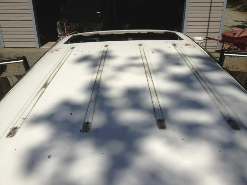

Well, gotta start somewhere -- why not start at the top and work down. The factory rack has gotta go! What a flimsy piece of junk -- it is "riv-nutted" into un-reinforced sheet metal. It turns out the riv-nuts are rusted, and the feet have worn oval shapes through the paint down to bare metal which is also starting to rust.

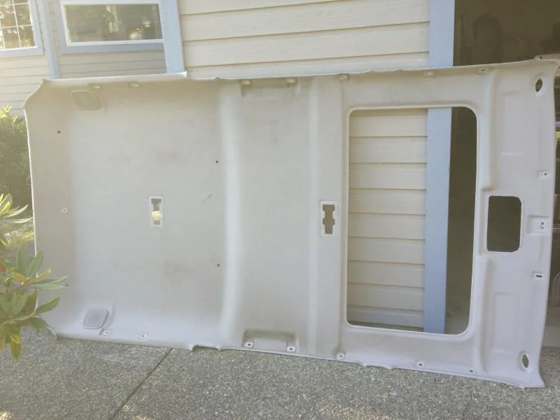

Step one is removing the headliner. One of the benefits of a 1996 truck is that it has a moulded cardboard headliner that is fairly easy to take in and out... after you remove about 100 grab handles and pieces of trim.

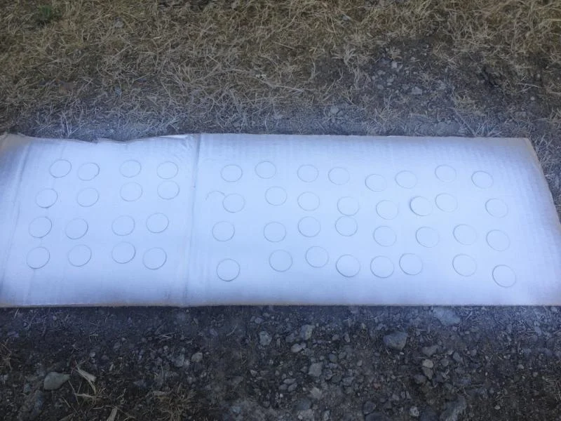

I've read many threads on filling both roof rack and flare holes... everything from plugs covered with bedliner to professionally welding and painting the entire panel. I wanted to do something less redneck than bedliner but also cheaper than a professional paint job. Also I definitely don't trust myself welding sheet metal.

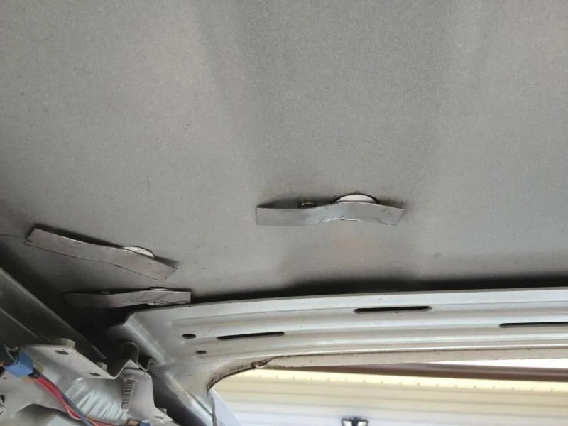

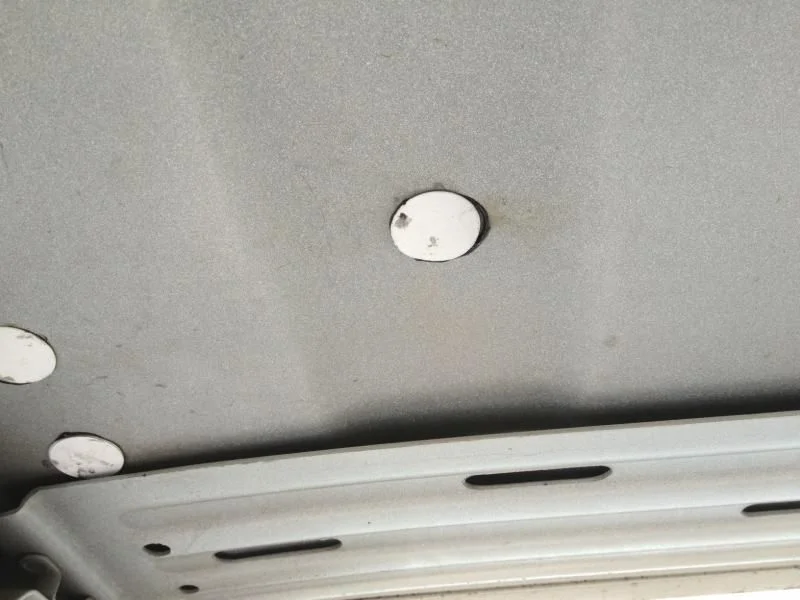

So I got some scrap sheet metal and cut out a bunch of little 1" circles on the drill press. I made 16 for the roof holes and another 32 for the fender flares (there will be some spares -- I think the flares only need 24 or 28). I primed and painted them and then glued them to the underside of the roof with body panel adhesive. I will then fill and sand around each hole on the roof and attempt to blend some new white paint over the area. If that all goes successfully I will try my flares :) The adhesive was a bit runny, so I rigged up some rare earth magnets and strips of metal to hold the circles in place while the adhesive set.

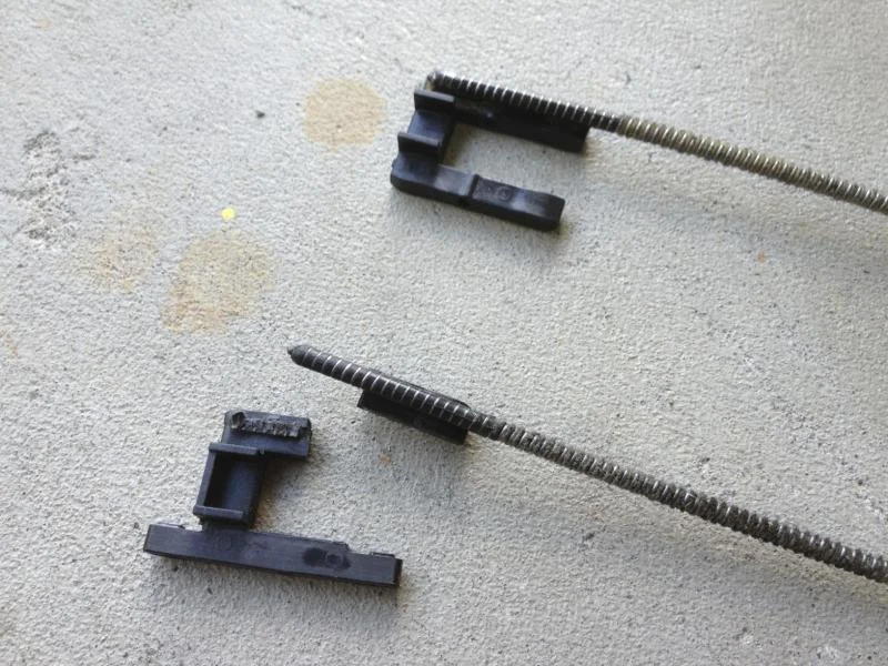

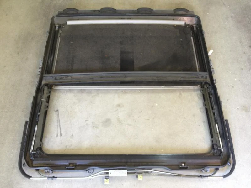

To access the underside of the front rack holes, I had to remove the sunroof assembly. As it happens, the sunroof on this truck was broken anyway and wouldn't open. So I took the opportunity to disassemble it and find the broken part. Good thing I have a "parts truck" with a working sunroof :) I swapped over the broken part. Even through the 1991 part is slightly different from the 1996 part, it still fits and works great.
After a thorough clean and new white grease on everything, it opens and closes smooth as budda :D I also took the opportunity to use a carpet cleaner on the sun-shade carpet. I will carpet-clean the rest of the headliner before I put it back, too.
Once my roof holes were all glued up, I reinstalled the repaired sunroof assembly with loc-tite everywhere and silicone caulk to seal the drain hoses.

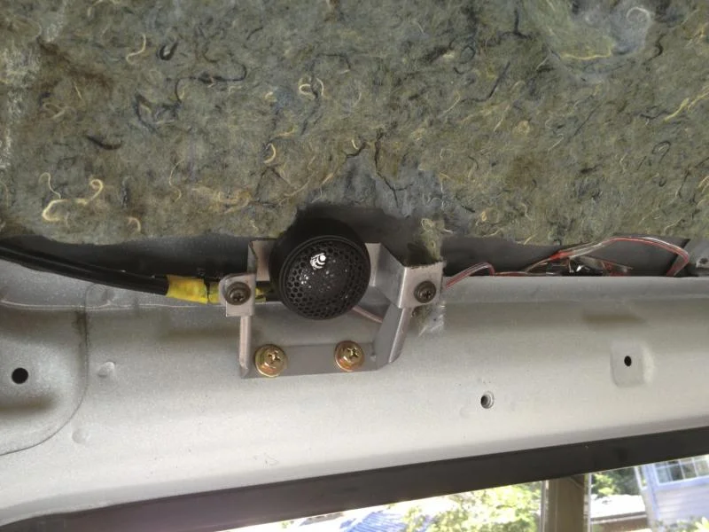

Before I re-installed the headliner, I upgraded the tweeters. Not sure how much they really add to the sound, but... may as well get everything done under that headliner so I don't have to remove it again for a looong time :)

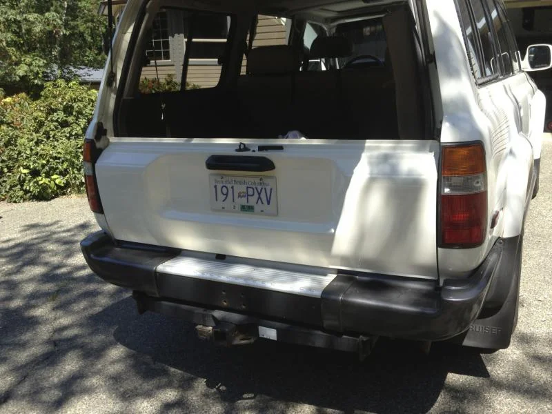

I spent some time filling, sanding, and painting the roof. After 3 trips to the paint store, the colour match is bang on :doh: My spray job isn't that great, but only tall guys would notice :hillbilly: The previous owner severely dented and actually cracked the tailgate in one spot, backing into his boat trailer apparently. So I got a used tailgate that was "dent free" (although quite scratched). Sanded it down and sprayed it too while I was on a roll.

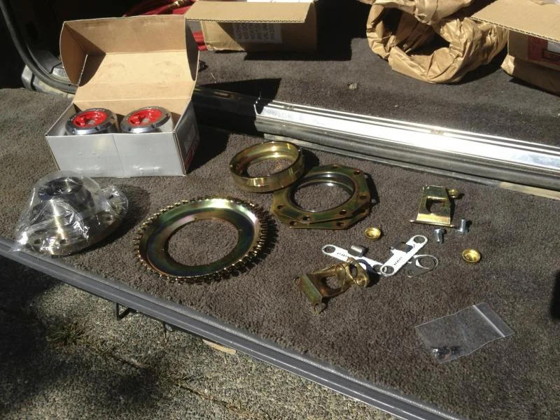

And today my first package arrived from Australia! Part-time with ABS relocator kit. I will install the axle part (hubs and ABS stuff) while I'm waiting for my transmission to arrive (1-3 months). Also will start working on pulling my 1HD-T next week, and think about which parts I can sell off my HDJ81.

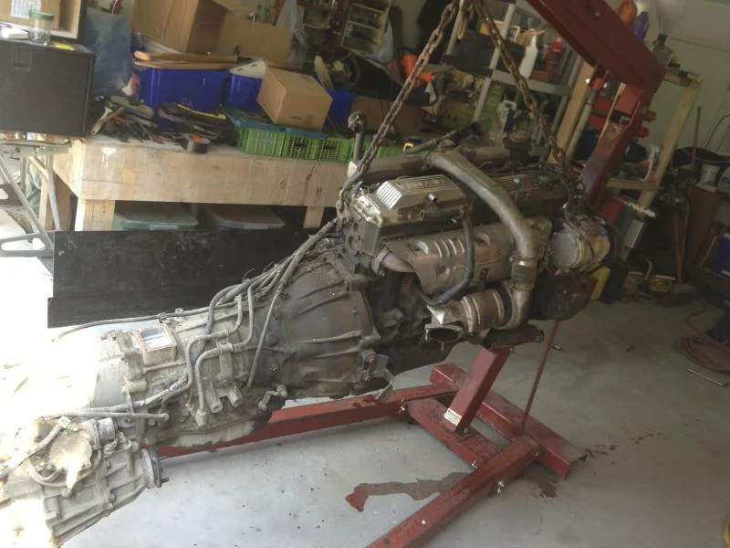

Ok finally getting my hands dirty. Now that the "Crusty Run" is past, I took the plates off the HDJ81 and pulled the engine.
