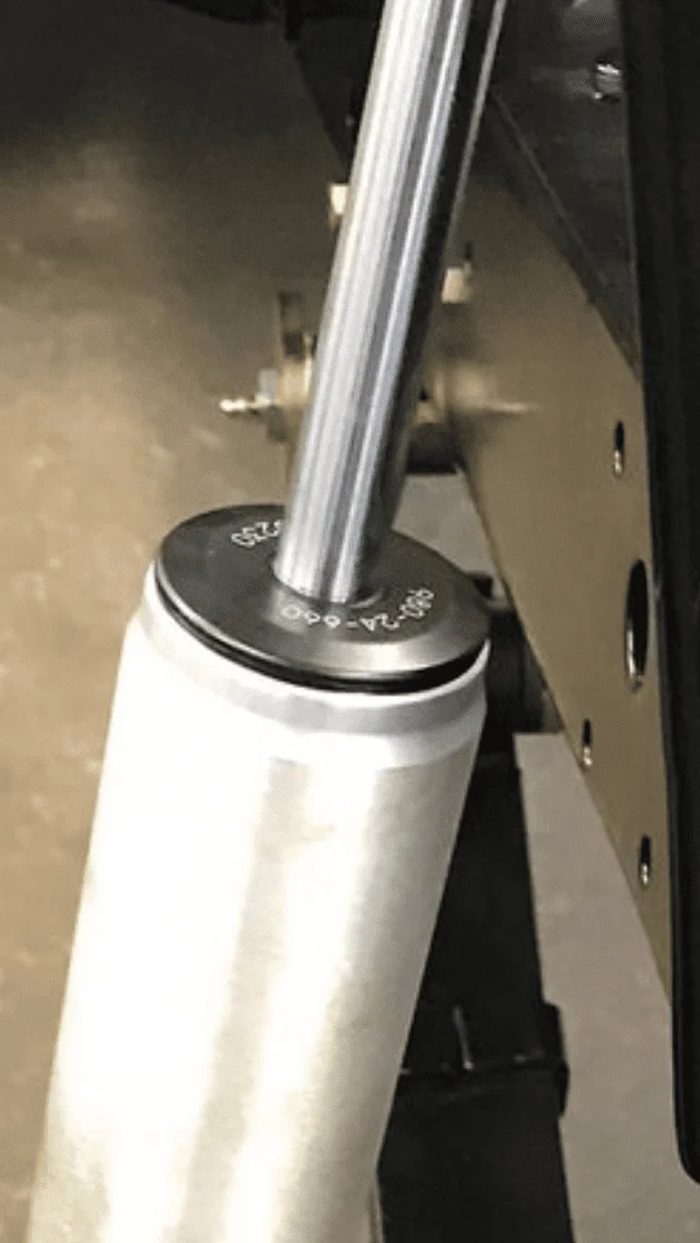

Got them:
BTB Part #’s
40-4007 FT Fox 4” shocks $149.95 ea.
40-4008 RR Fox 4” Shocks $149.95 ea.
40-4000 Bushings required for RR shocks. $4.15 ea.

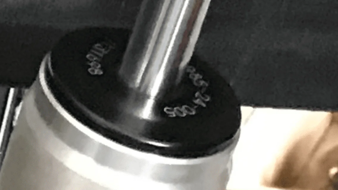

...but noticed afterwards there is the FOX number on the collar: 980-24-660
If possible, please check sometime when you are under the truck what is that number for the rear shocks.
Edit: found it from your other picture 985-24-005
Thanks for the hi-res flickr pics.:cheers:
