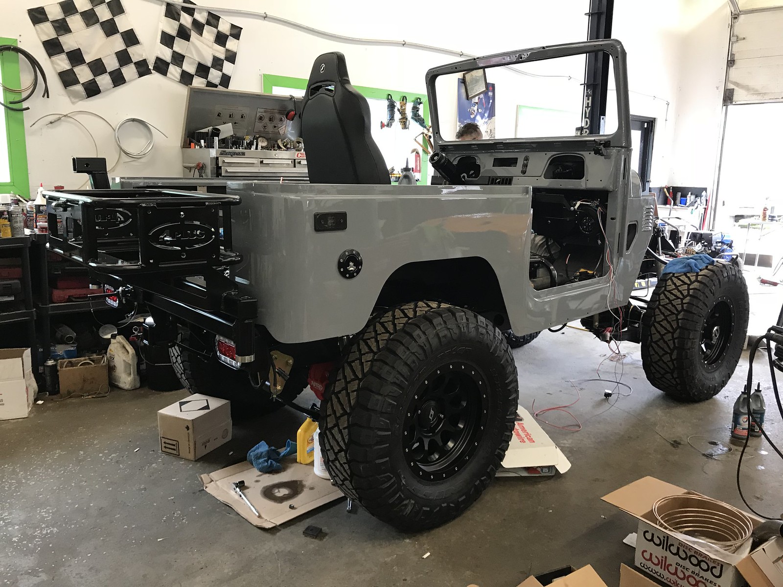

And the last of the painting done
IMG_9038 by Steve Heck, on Flickr
IMG_9036 by Steve Heck, on Flickr

We sent them a sample of Audi Nardo grey, and they colour scanned it, I can tell you that the paint is real nice and hard as nails
