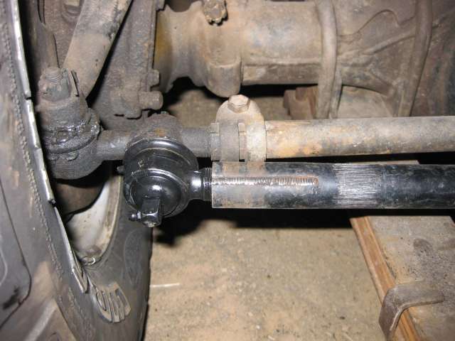

I don't particularly like the way it's currently pictured, but only because of this component:
I picked up a rebuildable FJ60 end to replace this end that I currently have. I'm also going to call Kurt at Cruiser Outfitters and order a passenger side FJ40 TRE and have him ream it out to accept the FJ60 end. Then I'll be happy.
