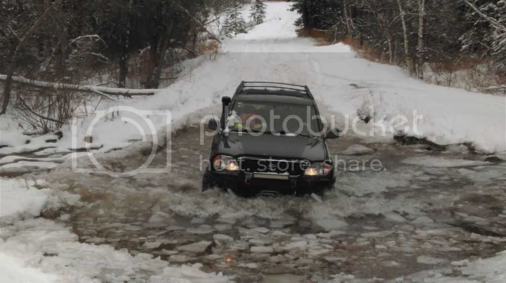

Not the best pictures of the hood but you can see it. I used a foam roller so there is very little texture on the hood.
yikes, I'd hate to be stuck in the middle of that puddle...

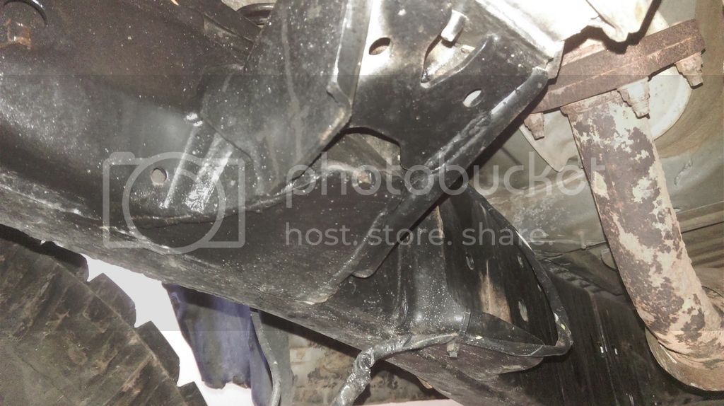

I have a question on plating to add strength, were any additional crossmember needed besides the plates showing in post 13?
Great job on your build!
I didn't add any cross members. The only additional plating was done to the inside of the frame since you have to cut into the engine mounts. I took a quick picture to show what I mean.

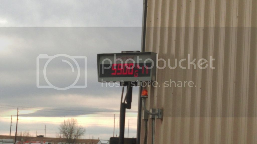

So after the discussion about my 100 being uh.......... big boned, I decided to put her on the scale today and see how much weight she has gained. That weight does include everything on the 100 with the 37" spare and me sitting in the 100. I tried to get a picture of just the front end on the scale but could not get one in focus (front half on the scale was 2,880 lbs).

How are you so light? I'm well north of 7k.

I wish I could have weighted it after the swap just for comparison. I would be surprised if it weighted any more doing the SAS.
Just adding things up in my head:
The bigger tires probably added 200 lbs
Front hybrid bumper is maybe 100 lbs
10k Winch 60 lbs
Rear bumper 150 lbs
Sliders 100 lbs
610 lbs? minus the weight I took off (bumpers, third row seats, running boards and some scrap metal ie: spare tire carrier)
I should note that I had minimal tools and recovery gear in the back.

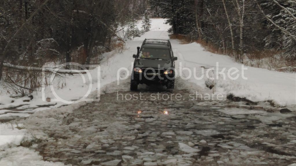

Took it out yesterday for a trail run and thoroughly tested the bumpers, sliders and GM one ton steering. I also decreased my gas tank capacity a little with the big rock in front of the 100.:doh:
Does anyone make a 100 gas tank skid?
I took it through Jake. It went really well until I slid off that rock.
