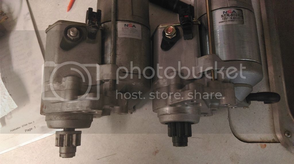

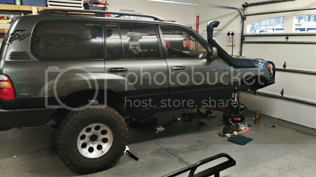

With all of the suspension finished I was ready to pull it out of the garage. That is when I got the dreaded click......click from the starter. Nothing like finishing up a major project only to have to jump right into another. I pulled the starter out and took it to a local shop to have it rebuilt.
After installing the rebuilt starter, I was getting a horrible grinding noise when running. AGAIN the intake manifold came off only to find when they rebuilt the starter they made the drive gear to long (left).

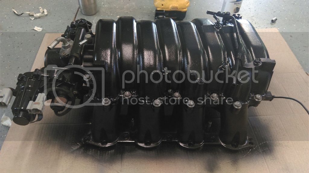

Since I had the manifold off I thought I would do some cleaning up.

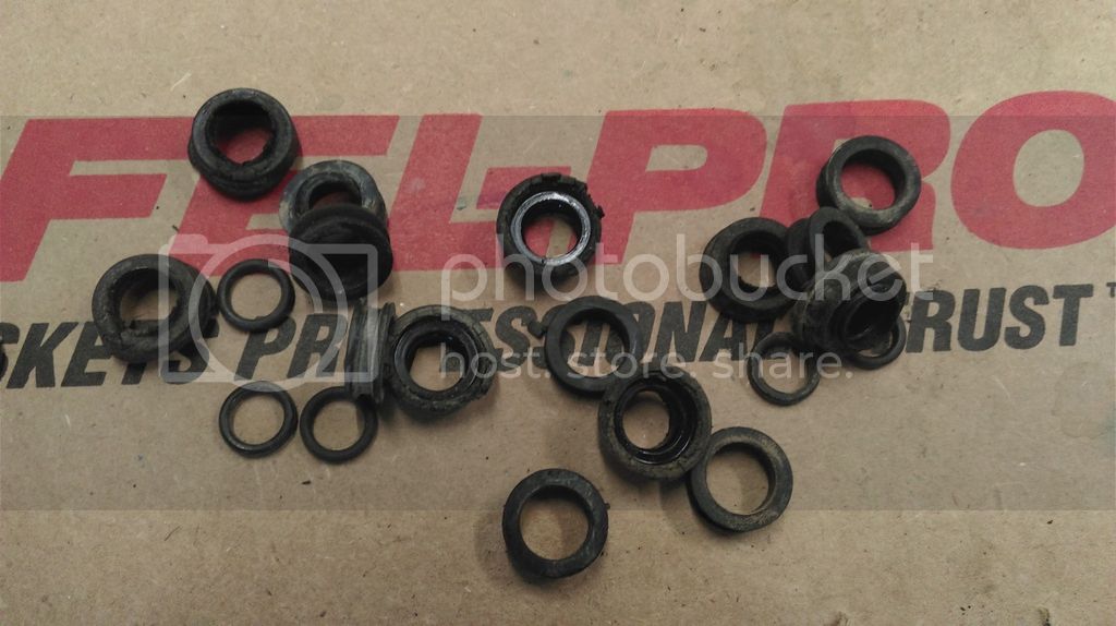

I was inspecting all of the parts and noticed that the o rings on the injectors were a little dry.
With the a new starter, clean intake and o rings it was back running and ready to get rinsed off.

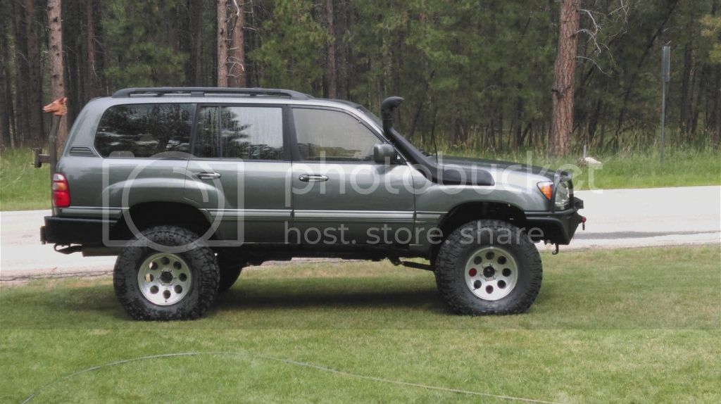

Finally a side shot of the truck, looks friggin mean. Interested to see some flex pics and hear about how it rolls down the HWY at 70+mph.
