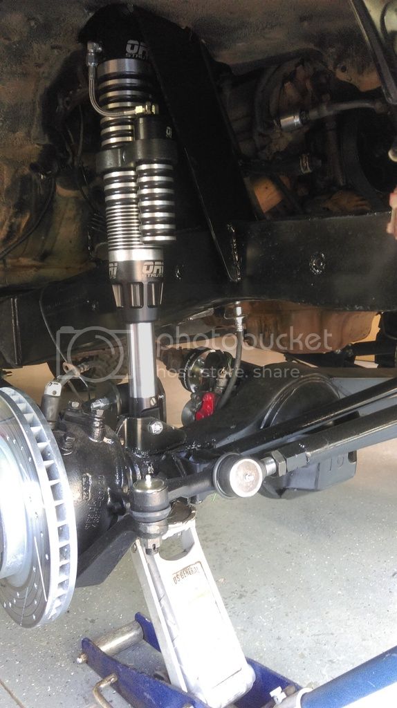

To mount the ORI struts I ordered some shock towers from another vendor here on MUD. link -----> Barnes 4WD
The shock towers are really nice quality.

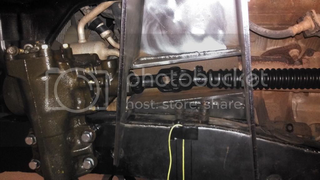

I did have to modify the drivers side shock tower to allow the steering to pass through it.
The stock steering shaft bolts directly up to the 80 PS box?
The splines on the shafts are the same but the stock 100 shaft is a little to long.
To make it all work, I cut a few inches out and welded the shaft back together. I then replaced the coupler with a U joint where the shaft comes out of the firewall and removed the flexible coupling (rag joint) inside the cab.

Would the 80 stock shaft worked?
I never had a stock 80 shaft so I am not sure. The shaft I made is roughly 18".
