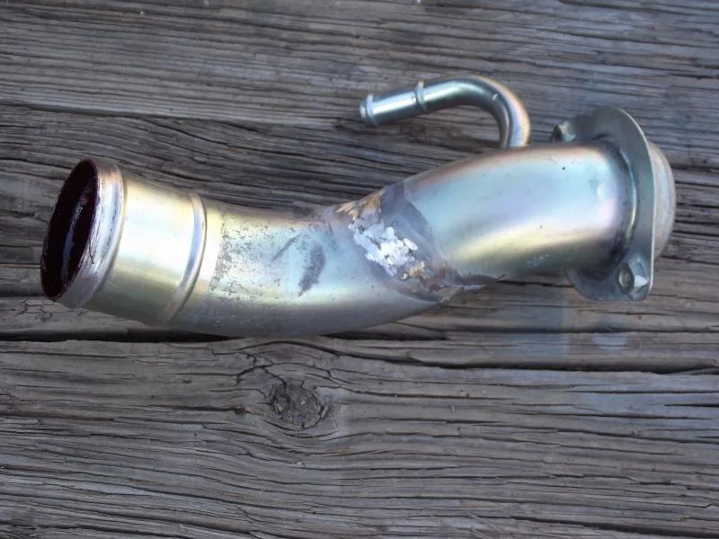

That filler neck is not made from radiator hose is it? I've heard rad hose will not hold up in that application...
Fun build, keep up the great work...
it is specifically fuel filler hose. and damn expensive stuff! I got 5 feet for the 2 separate fillers and it was $100.:eek:
...via IH8MUD app
Just to make sure that people know that it is a FACT that radiator hose will not hold up long term to gas. Many years ago I built saddle tanks for the pickup I had. I was young and inexperienced at that time and not knowing any better I used radiator hose for connecting the filler neck. Epic fail!! I don't remember just how long it took, but the gas turned the hose to jelly (almost).
Don
Junk yard. :idea:
:D I had looked there and couldn't find what I needed in long enough length. 1 of them is going to be 3', and both have to bend slightly. the junk yard ones were too dry and wouldn't bend or were too short.
what I got was the 'Gates' filler hose. it is really good stuff. stiff, but I was able to bend it enough to fit the shorter one. the longer one will have a 45* bend, but test fitting has shown it works. we welded up the modified filler neck for it last night. when we seal it, I'll get pics. maybe tomorrow.
yes Don, that is good info. I had seen that in a few places when looking for filler neck hose. it is good to clarify it. thanks.

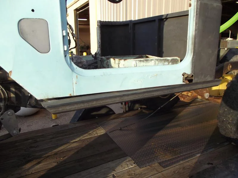

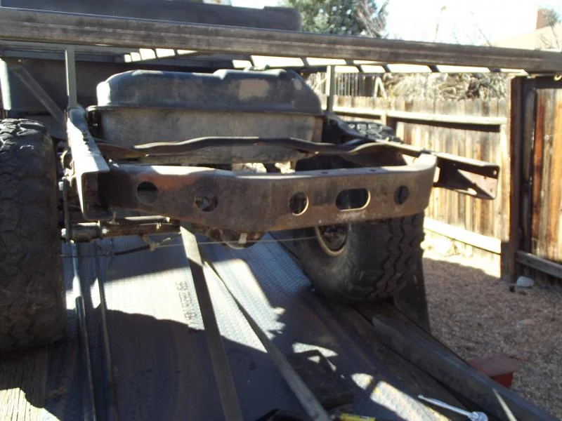

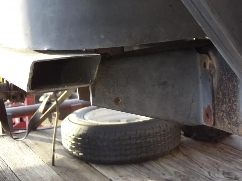

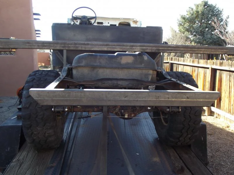

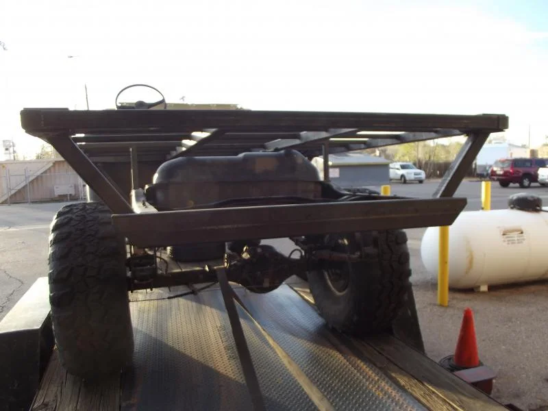

big long day of fab work today! we were both home all day, so we cut the front and rear bumpers out, as well as rocker sliders. then we cut the rear x-member out and trimmed the rear frame, then tacked in the new bumper.
attachment.php
attachment.php
pics coming tomorrow, the cab body mount bracket was trimmed to mount the sliders and the front mounts were cut. a little grinding and the sliders are ready to weld in.
ok, we ground the welds on the second filler neck and sealed it with fuel cell sealer(red kote). it had some rust inside so the sealer gets the rust and welds all sealed. you can see it at the fuel tank end a little.

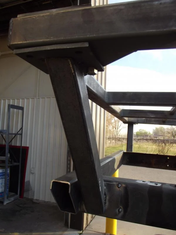

I was able to get the sliders tacked on today. the rear mount will be the same bracket as the body mount. it will get the bottom trimmed and boxed.
attachment.php
attachment.php
attachment.php
next up was the rear bed mounts. I also got the front frame horns prepped for the front bumper brackets. no pics of that yet. also, I'm feeling tons better about my welds. I may start doing up some of the final welds myself.:grinpimp:

we've been working on the project, but hadn't gotten pics yet. things slowed down a little when my chop saw broke for the final time and we found the roll bar tubing we got was the wrong size. I paid for 1.75" and they loaded me with 2". I have to go back and get the correct size that my buddy has a die for. so here are some pics!
first is the middle support for the sliders.
dscf0955-jpg.880509
then the front bumper,
dscf0950-jpg.880510
then the frame for the fuel filler necks and the mounting plate template
dscf0954-jpg.880511
dscf0953-jpg.880513

today I cut the hole in the rear bumper for the receiver hitch, removed the xmember for the spare tire rack and installed a new one. it will double as the floor support for the gear box and a tie in for the receiver hitch.
