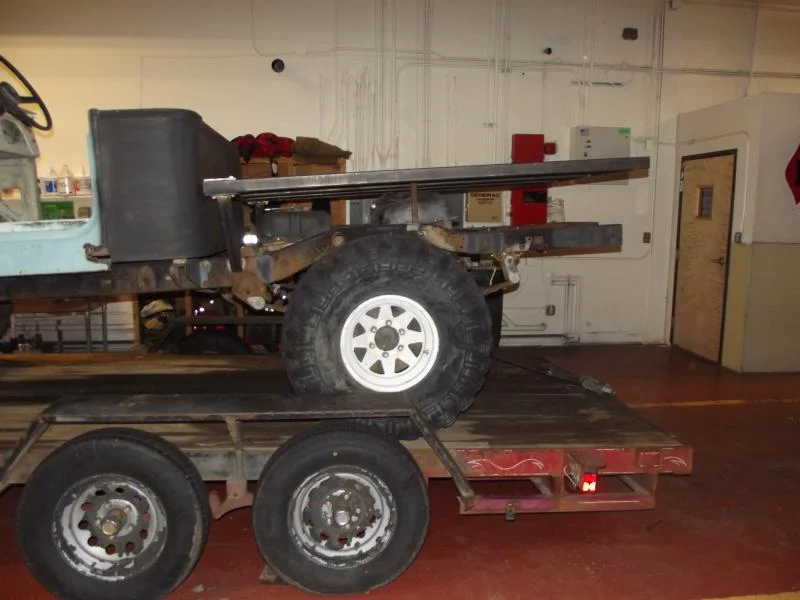

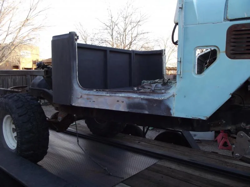

got more done finally. the bed is mounted/tacked in at the front and middle now.
attachment.php

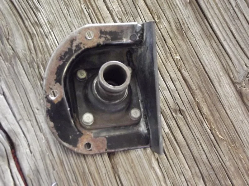

we have been looking at wiring diagrams for this week, so not much report worthy. however, today I finished up mounting the steering wheel and brake booster/MC. we had to modify the firewall steering wheel mount to clear the gas pedal. it's a '73 FJ55 column. we also made a spacer to help move the steering wheel back. lots of grinding also, in prep for the SOA.
attachment.php
attachment.php

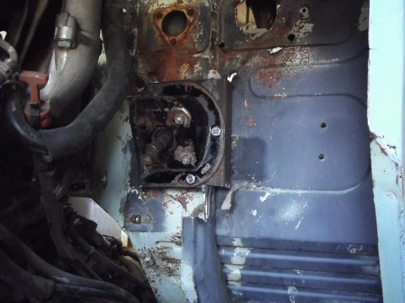

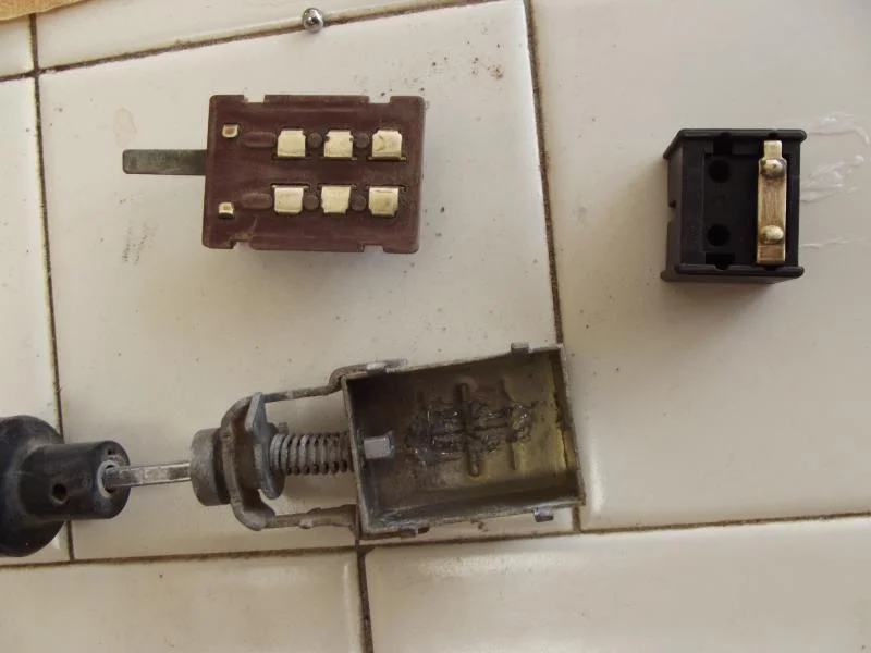

progress has slowed because of the cold weather (teens to 20's, yes I'm still an Az guy). Brock, my son, has wanted to be present for the front spring over and cut n turn, so focus has turned to electrical. we refreshed the wiper switch we have. opened it up and it looked like this-
attachment.php
cleaned contacts and regreased it, straightened the shaft, and it looked like this-
attachment.php

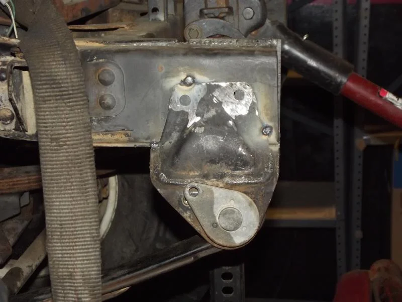

What did you do to get the motor mounts completed after the boogered up tack welds?
You've gotta get that wire wheel out and clean up the areas you're welding up! You say you're welds aren't good so I'm just throwing out one reason as to why. None of the areas in the pics you've posted of your welds on have been cleaned up prior to hitting 'em with the welder.
Especially on the body and motor mounts - adequate penetration and bead lapping is going to be compromised by having inconsistencies in the cleanliness of the weld area. Spend 5 mins and grind that rusty s*** off there before welding and they'll improve ten-fold. The outer look does actually matter and indicate the inner quality of the joining of the two pieces. Crappy welds have held up in the shop for a short time...the second you start to add stress to it - they'll fail and you don't want to be repairing a failed weld out in the field when it could have been prevented.
Keep up the progress - damn the weather....get that thing on the road!
you are absolutely correct on cleaning up for better welds. it's something I forget about. thanks for the reminder. my welds are actually getting a ton better. the motor mounts, trans mounts, spring perches are still just tacked and I plan to take it to someone when it is more together for quality welds (so I can get most all of it done in one shot). I did that with my 40 when I built it. I am doing more of it than before, like the flat bed, etc. anything structural for suspension, body, roll cage, seat belts, will be someone who can do it right.

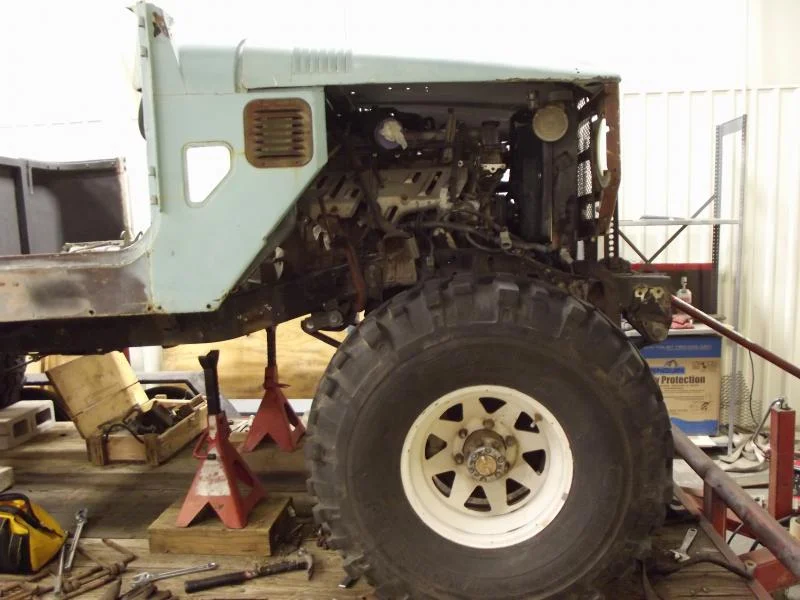

front is now 4.5" or so forward. this pic is a mock up pic, so ignore the shackle, it's not full weight on the spring, but it should come out to this height in the end. how does it look for wheel centering in the well now?
attachment.php
we reused all the factory spring mounts. it does save about 2" clearance on the front entry angle. in the end, it looks like this will work perfect. with the pinion at 2* down from the DS angle, it leaves 4* of caster. I will have to recheck that with a new angle finder. this morning I found that my old one got dropped once too many times. so it may not need a cut and turn!
attachment.php
well, when I got everything in place, the angles were more off than I thought. I adjusted it and am still doing adjustments, but it will need a cut and turn.

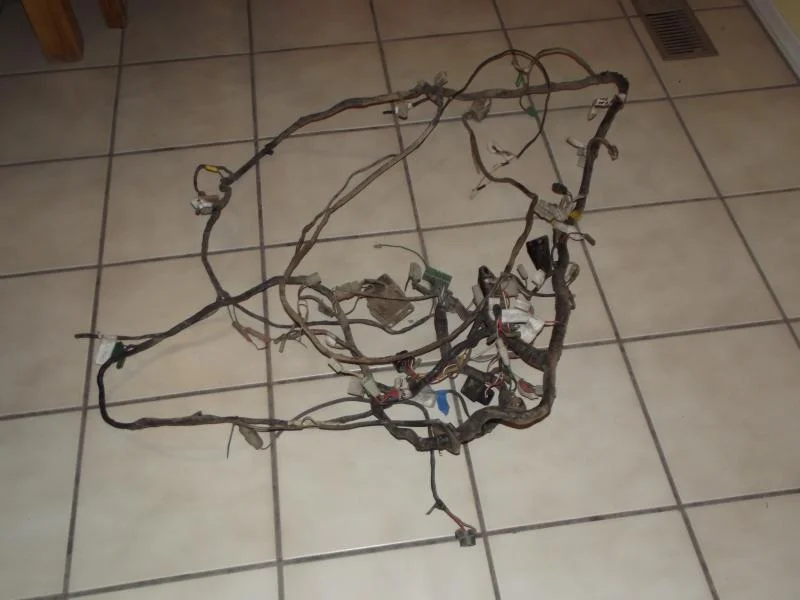

so we now have the cowl harness from a '95 FZJ80. most of this stuff will get cut out, but some very key parts are here. this sucker took me nearly 4 hours to extract. we spent an hour labeling plugs and got just over half way.

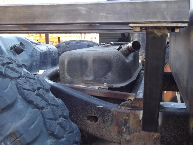

with the weather warming and it's been so lovely outside, we went back to some metal and fab work.
we cut the rockers a little in prep for the sliders. got 1 fuel tank filler neck done, the other is cut and ready weld up.

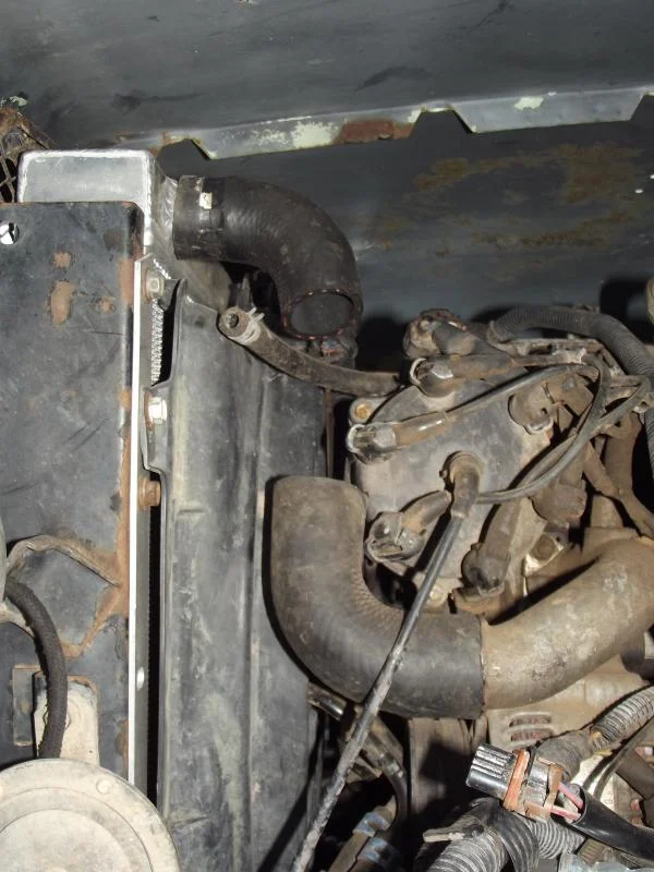

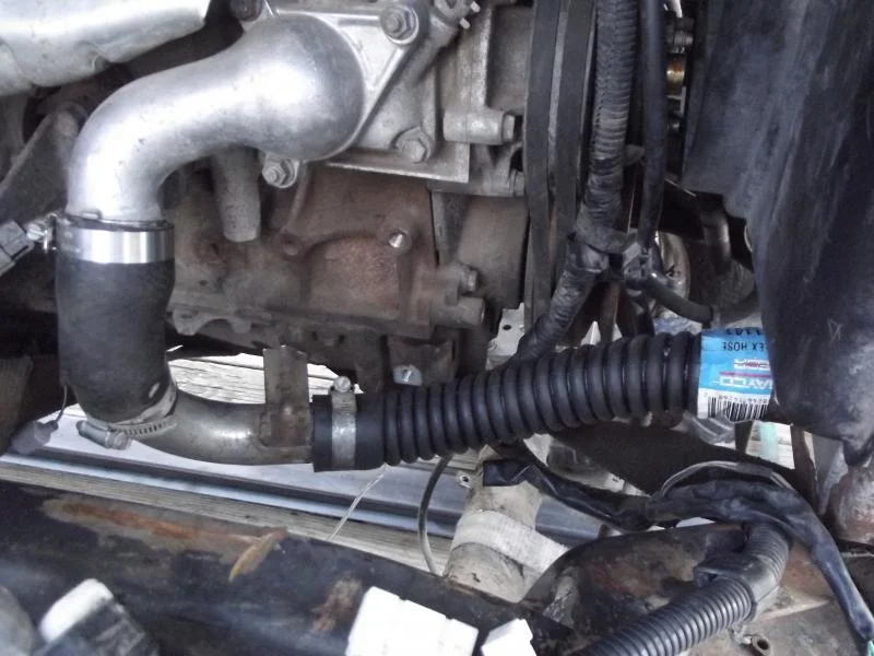

next was getting the radiator hoses figured out. some trimming on stock hoses and a flex hose got one side mocked up and the other side only needs a 6" metal pipe piece.
attachment.php
attachment.php

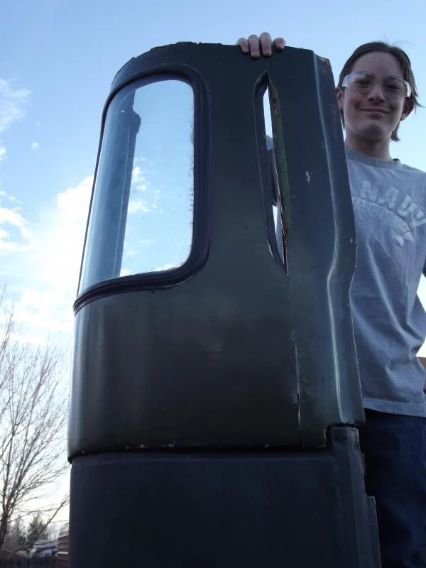

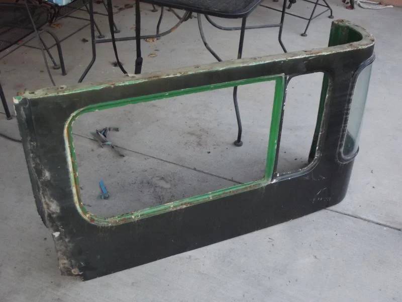

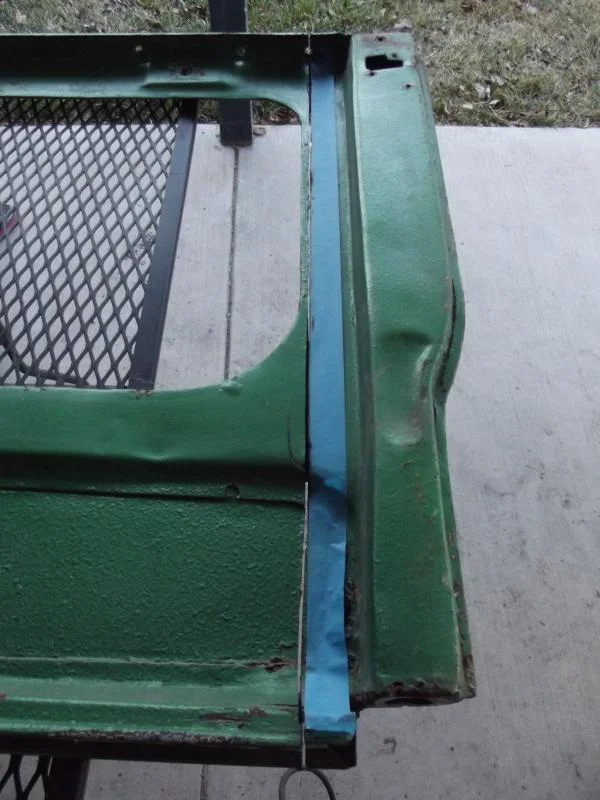

then we started on the hard top. we have 2 sides and a fiberglass top. we still need the rain gutters. I have never done this kind of body work, so I'm on new ground. the hard top needs to be close to in place to start the roll cage.
attachment.php
attachment.php
attachment.php
with the weather warming and it's been so lovely / got 1 fuel tank filler neck done, the other is cut and ready weld up.
attachment.php
That filler neck is not made from radiator hose is it? I've heard rad hose will not hold up in that application...
