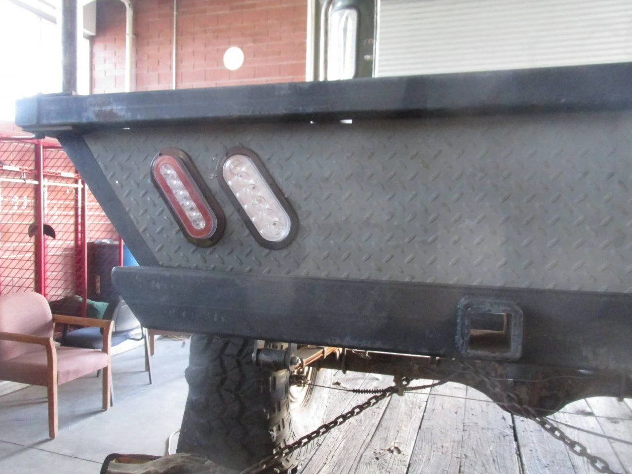

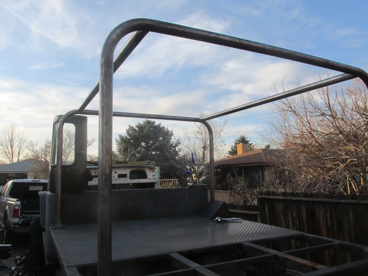

got the rear plate for tail lights trimmed and mocked in. then got roll cage hoops bent with some help from Frank.

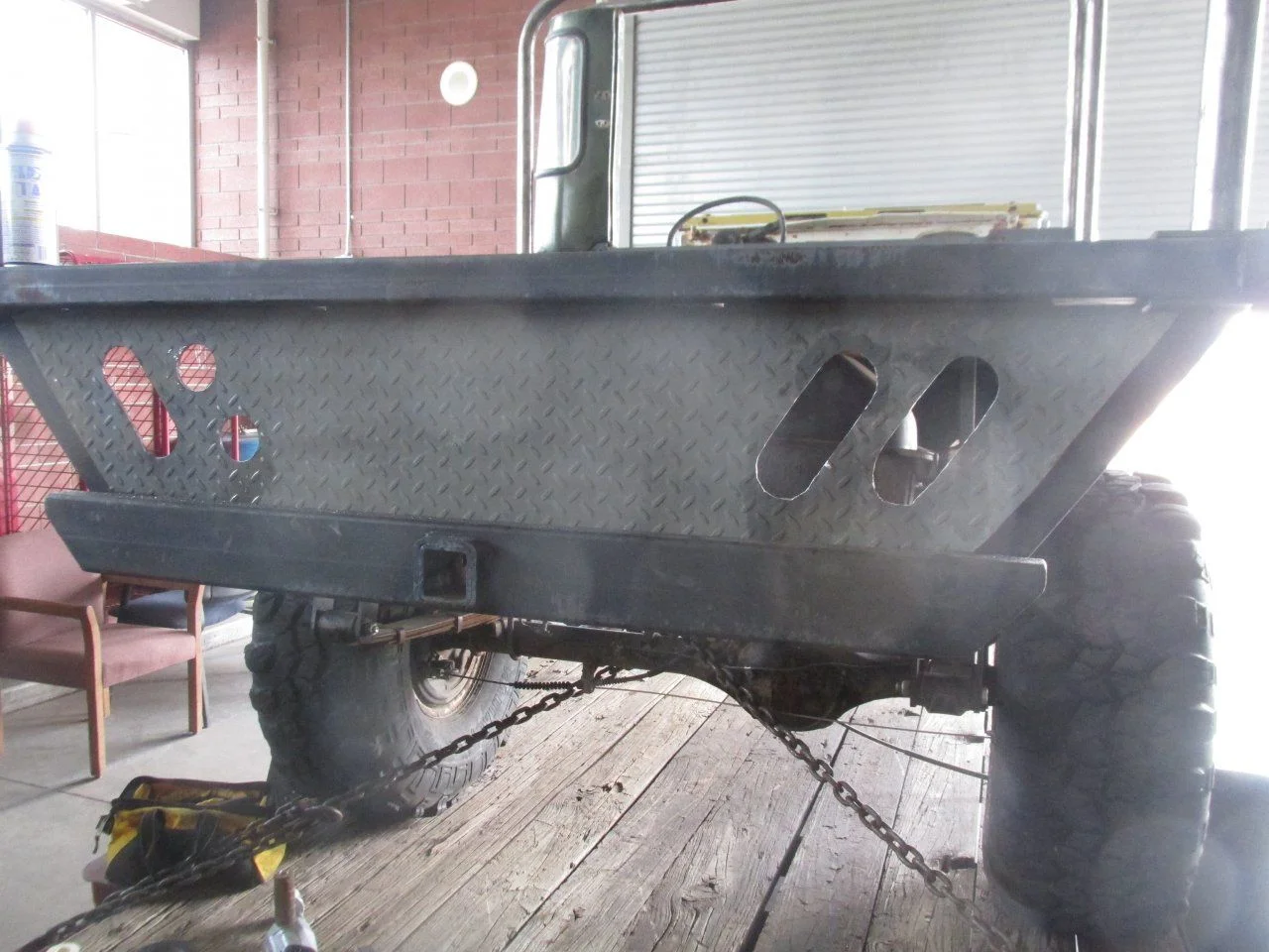

Brock and I tacked in the rear cage. it will get some diagonals in the corners. then on to cutting out the tail light ovals.
very nice!!!! Did you use a tubing notcher ?

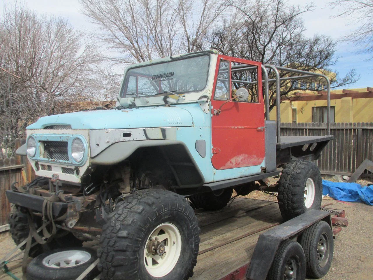

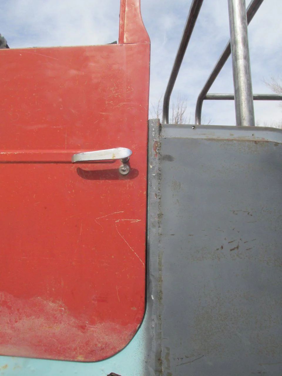

I put doors on it in order to get dimensions for the front cage(pic 1). it's starting to look like a cruiser! BUT, that brought to light a problem. the driver door opening is tweaked. it didn't surprise me, because I knew the truck had likely been hit just behind the driver door in the past. the frame from the body (that was made into a trailer) showed evidence of it. I tried to adjust the door from 2 directions, but it still was too narrow at the top of the opening and the door hung low.

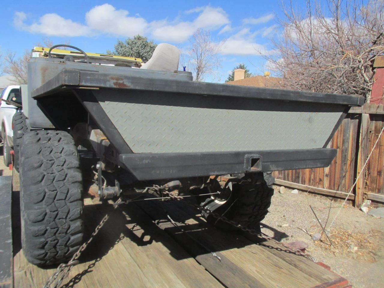

pic 2- driver door forced shut. note the angle of the door top to bottom and along the bottom

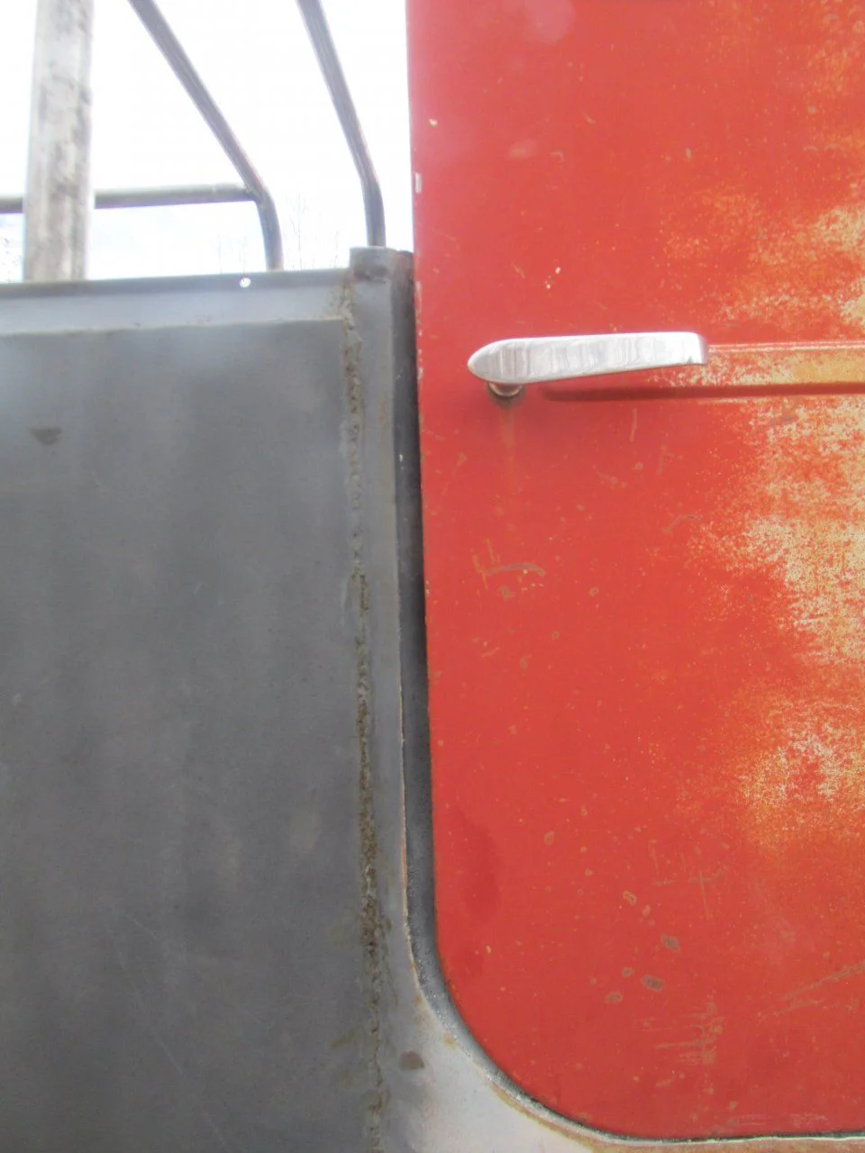

pic 3- passenger door with plenty of room.
I tried several ways to adjust the door with the hinges, removed them from the body side and bent them to pull the top of the door forward, no change other than the door now hits the hinge:bang:.
soooooo, some creative use of monster power tools opened the top of the opening by force. and it worked! both back and bottom lines are close enough now. I'll see later what I did to screw something else up, I'm sure.:lol:
