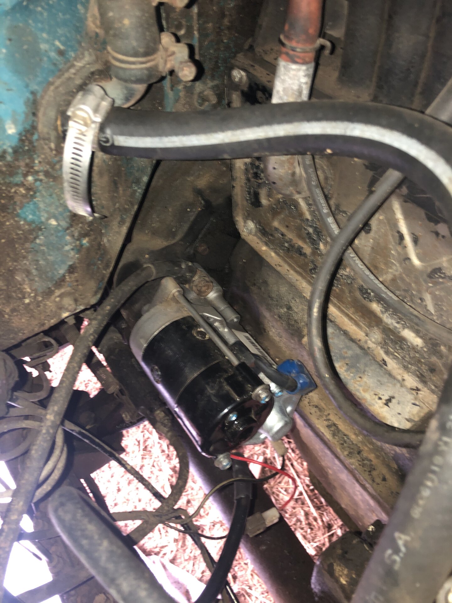

Swapped out the old starter in the 40 after the solenoid decided to go on vacation. Went gear reduction.
Amazingly better but if you are going to it from the old starter just go ahead and get a 6” longer battery cable because it has to go under the starter now.
Also mad props to Kiichiro Toyoda for putting a stud at the top so you can just hang the starter and then put the nut and the bottom bolt on..... it's the little things in life that make it enjoyable.

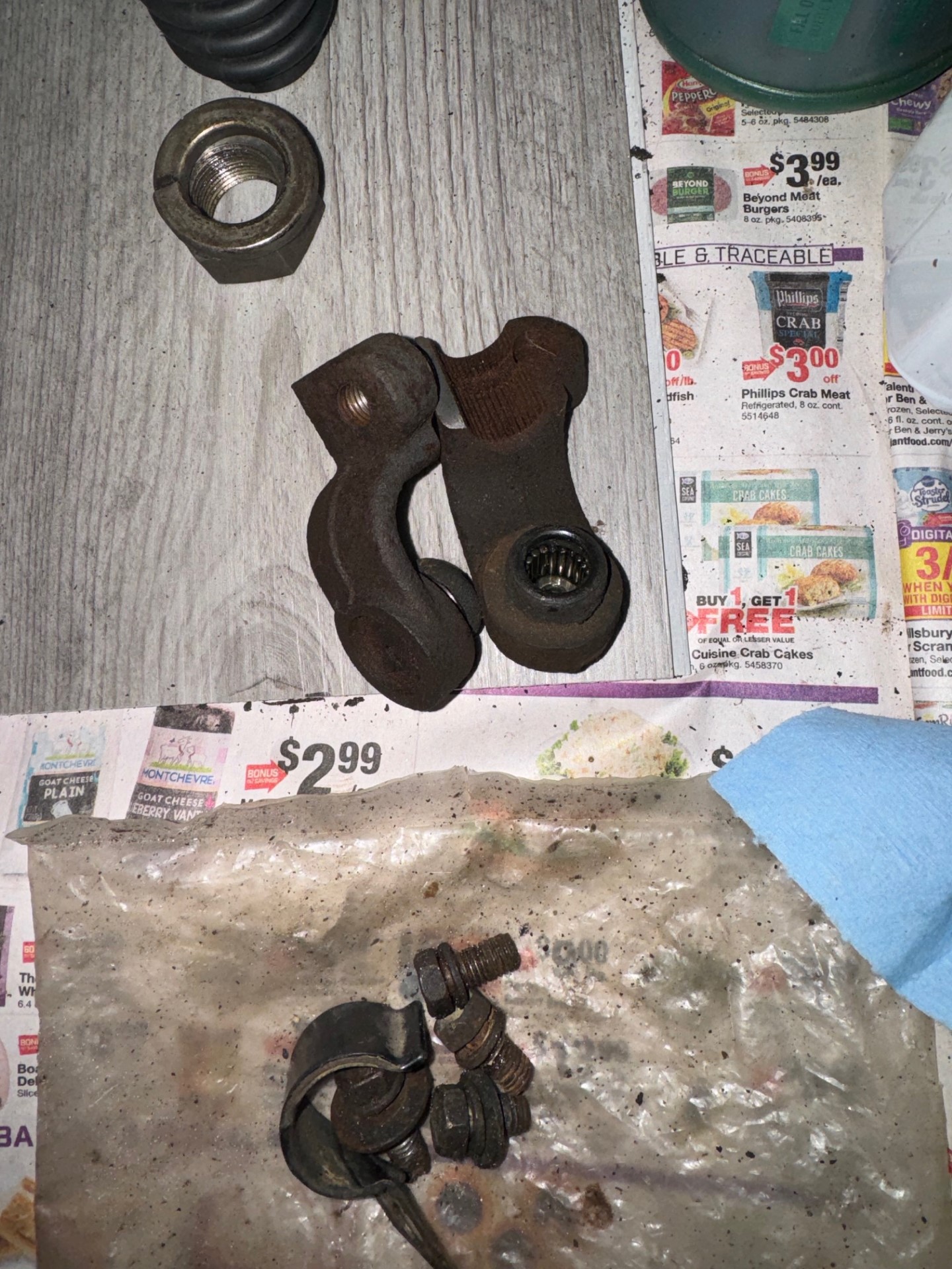

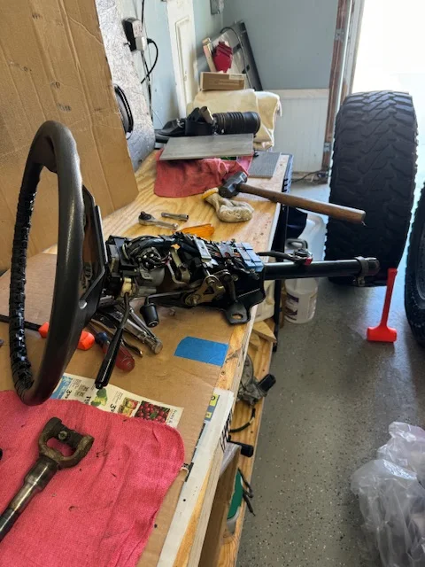

during the process of removing/cleaning/painting elements of the steering linkage while I have the gearbox out, I snapped the yoke of the inner spider joint, because why wouldn't I break something, right?!? Trying to find a replacement yoke (4524460020) or shaft assembly (4522060080) for a 61/62 series. Now it's not so bad that the gearbox shipment is late from Redhead Steering.
during the process of removing/cleaning/painting elements of the steering linkage while I have the gearbox out, I snapped the yoke of the inner spider joint, because why wouldn't I break something, right?!? Trying to find a replacement yoke (4524460020) or shaft assembly (4522060080) for a 61/62 series. Now it's not so bad that the gearbox shipment is late from Redhead Steering. View attachment 3541800
@jkdur728
@RICVirginiaHJ61 might know. He just ordered a bunch of 60 stuff
@kevin in okinawa I probably have one on my parts 60 at the farm. I don’t have the box but should still have the ujoints. I’ll try and go out tomorrow and look.

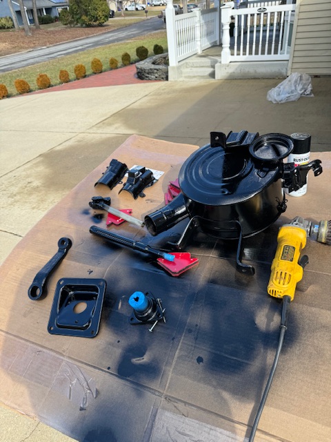

Made a lot of progress yesterday! Took advantage of the warm weather and painted some parts outside. Scrubbed my garage floor too to keep the wife happy (it was getting nasty).

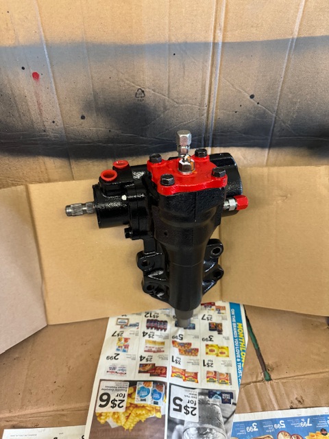

The gear box came back looking nice! The one I sent them looked rough, they sure made it look pretty. And ported for a future hydro-assist project. 🤓
