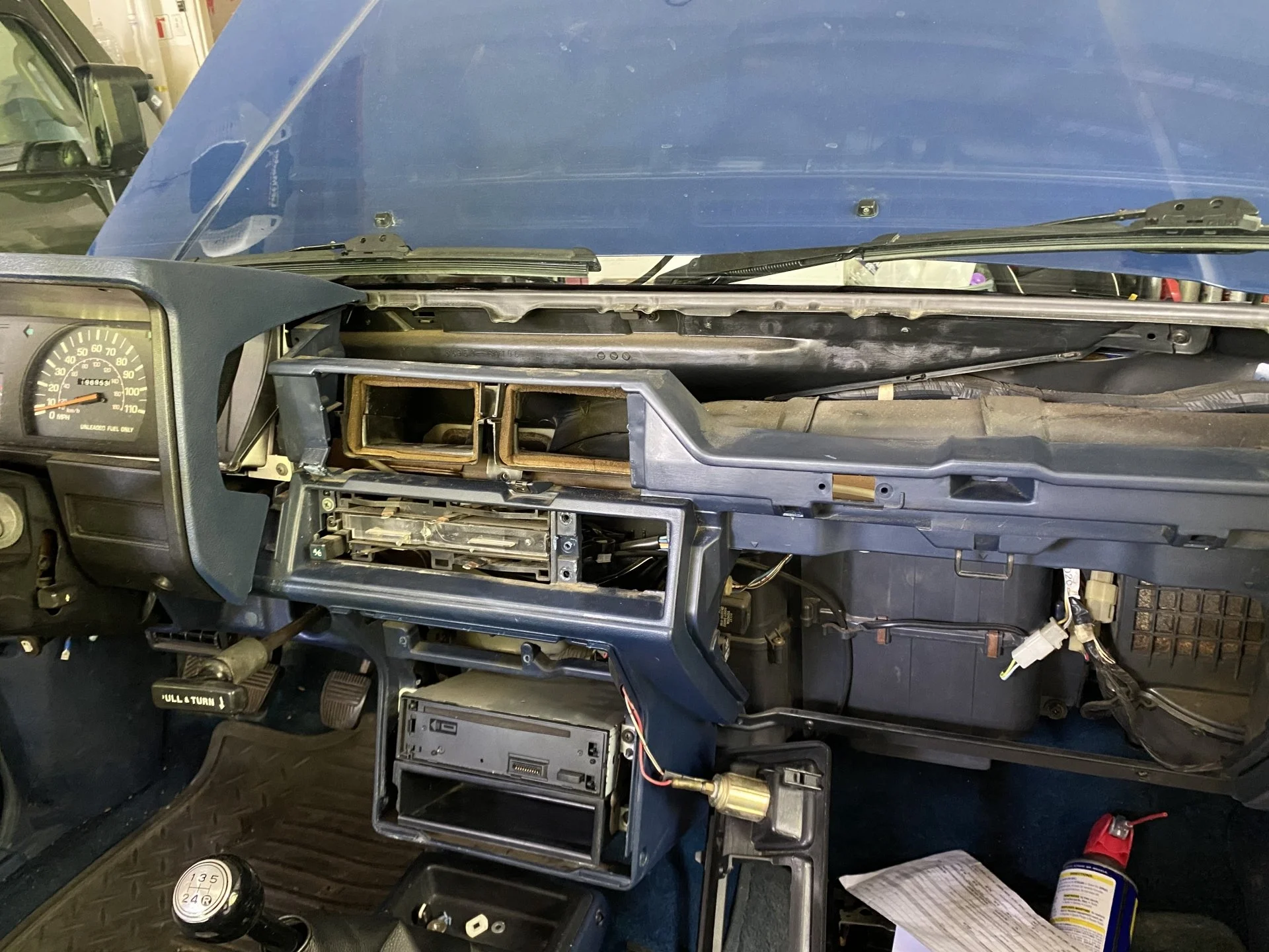

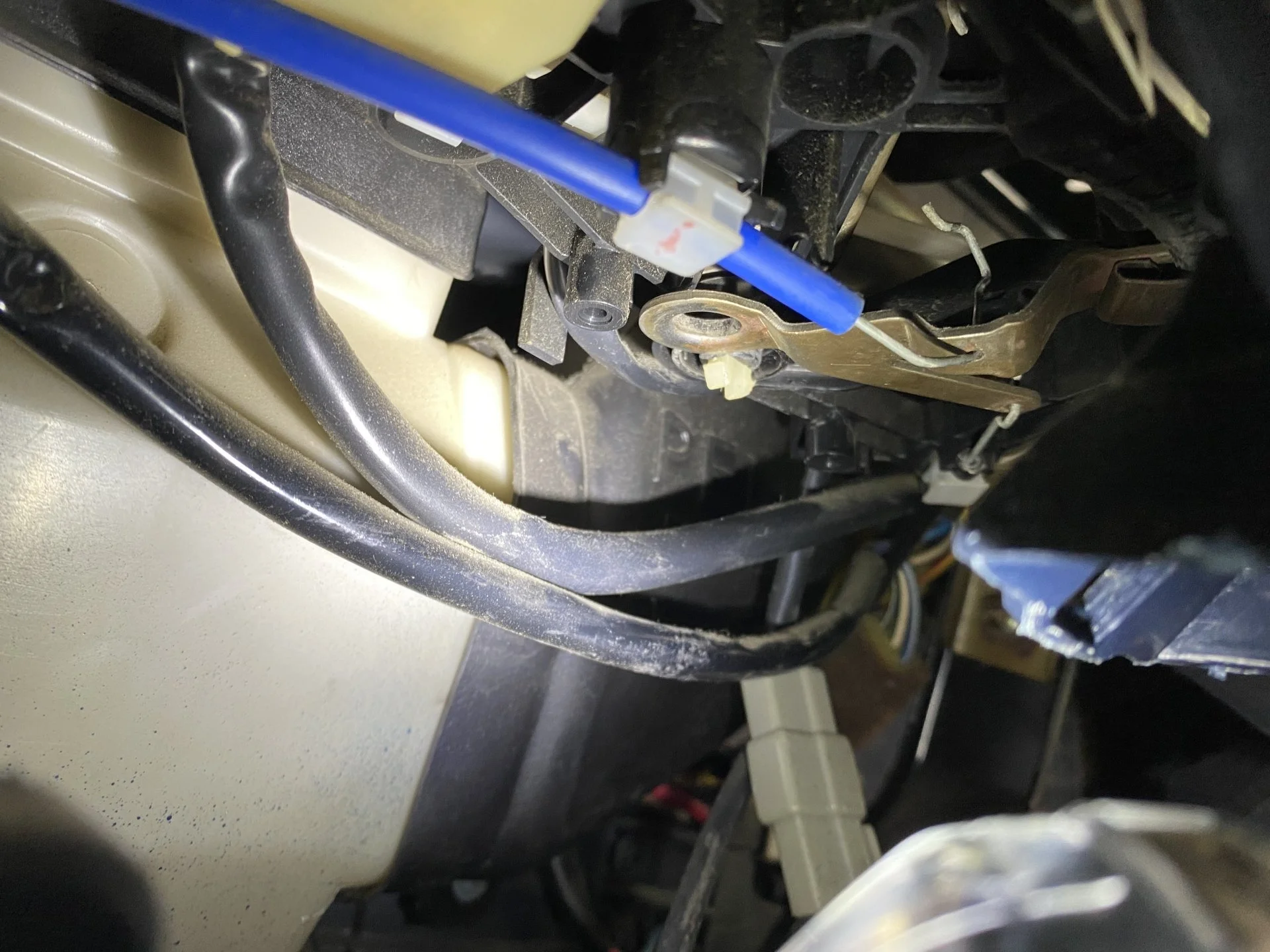

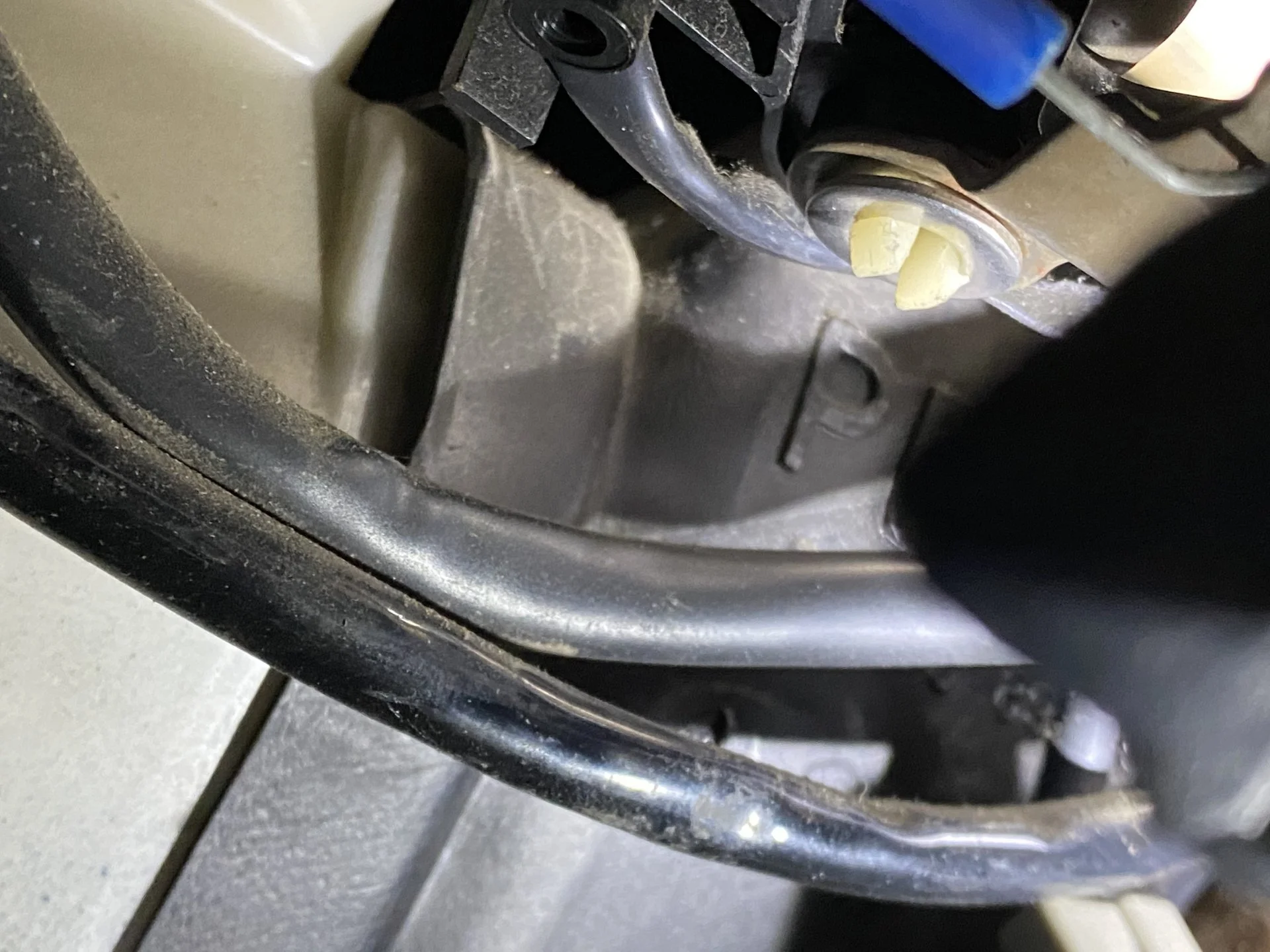

Well.... the hot/cold lever busted off today... I had to take everything apart to figure it out. I busted a plastic retainer on a plastic pin and chipped the ridges on the pin itself. I was able to snap a washer in pretty well in place of the retainer but this is not super solid. At least it’s a temporary fix until I figure out what to do.

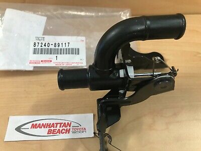

I though about ordering the part below but the parts guy said it would not work unless I changed out all kinds of other stuff.... not sure why.

Does it just pivot on that piece? If so, why not just replace it with a bolt and washers and a nylon nut?

I think that’s all it does. There are 2 cables controlled by that leaver... one is for heater core and one is for heat/cool mixture. The blue cable is seized up. I’ll look through the FSM and see what can be done. I think I forced it and it popped the locking clip. I’ll tear everything apart again once I get a game plan. Hopefully I can manually operate that cable to cold somehow!

Boom... someone did exactly that... now to loosen that blue cable and re-clip it properly...
Heater control valve is seized... I need this. the cable wast moving freely so when I moved it to cool it kind of acted like a ramp and made everything go catywhompus ... which is what created extra stress on the plastic clip. Should be a pretty easy fix.
