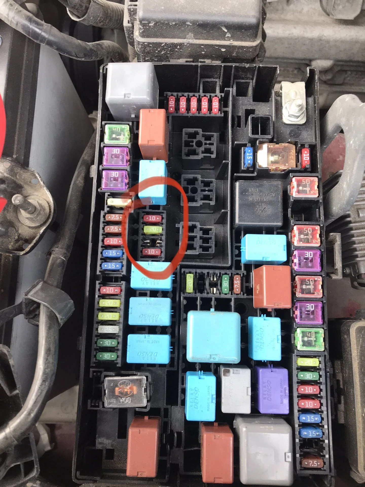

Also, I just tracked down a 1amp parasitic draw this morning that had me jump start my truck twice this month. It’s from the electric mirrors. They also shorted out a couple months ago and were blowing fuses. I turned off the auto tilt function and ordered new mirror actuators. This is a known issue on the GX470. I think mine happened because I was manually folding the mirrors each day when parked and it must have worn through the soy based wires:

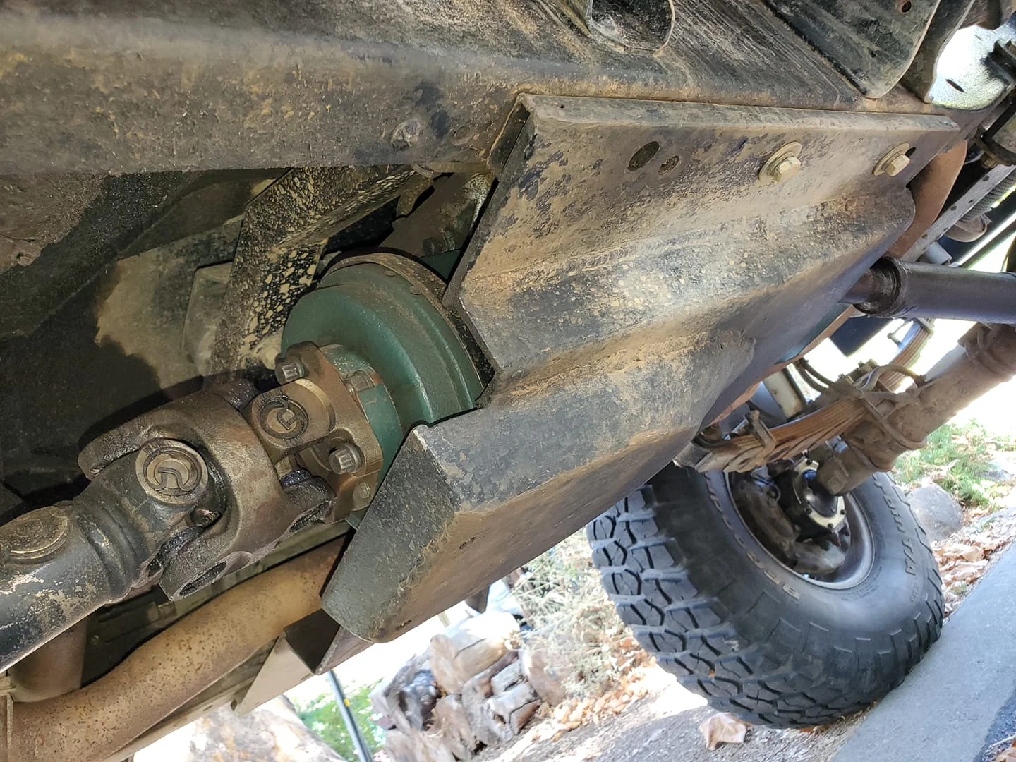

I lost the thread where we were talking about skid plates. Saw this one from Doug Freutel. Impressive skid plate and double joint on the drive shaft.
You'll need a floor jack to get that baby up into place!!! Actually I use a floor jack whenever I need to remove/re-install my Ironpig skid plate.
Yeah that or a transmission jack but it looks like it would stop a IED too donuts got that going for it.
I’m getting pretty tired of dropping mine onto my chest every time I need to dump the gear oil out to put new oil in! I’d drill some drain holes but then everybody would know my junk leaks.
Saw that on face book the other day. That is a stout skid plate.
