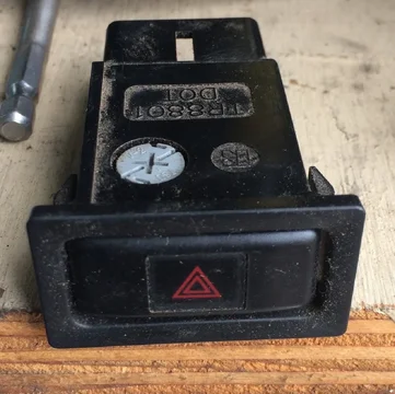

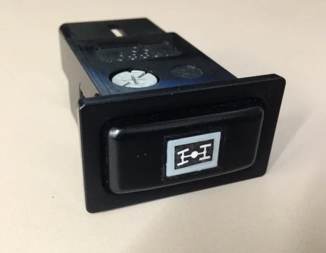

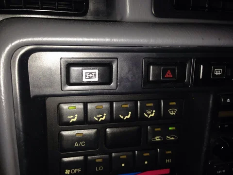

Thanks to countless documentation here on 'Mud, I installed the CDL switch + 7 pin mod.
I started by reusing an old hazard switch.
cleaned,rebadged, and modified to fit.
It's not perfect but good enough for me.
Then after that, pulled the wire of pin #7 in the transmission relay box.
Can't wait to try it out on the trails !
