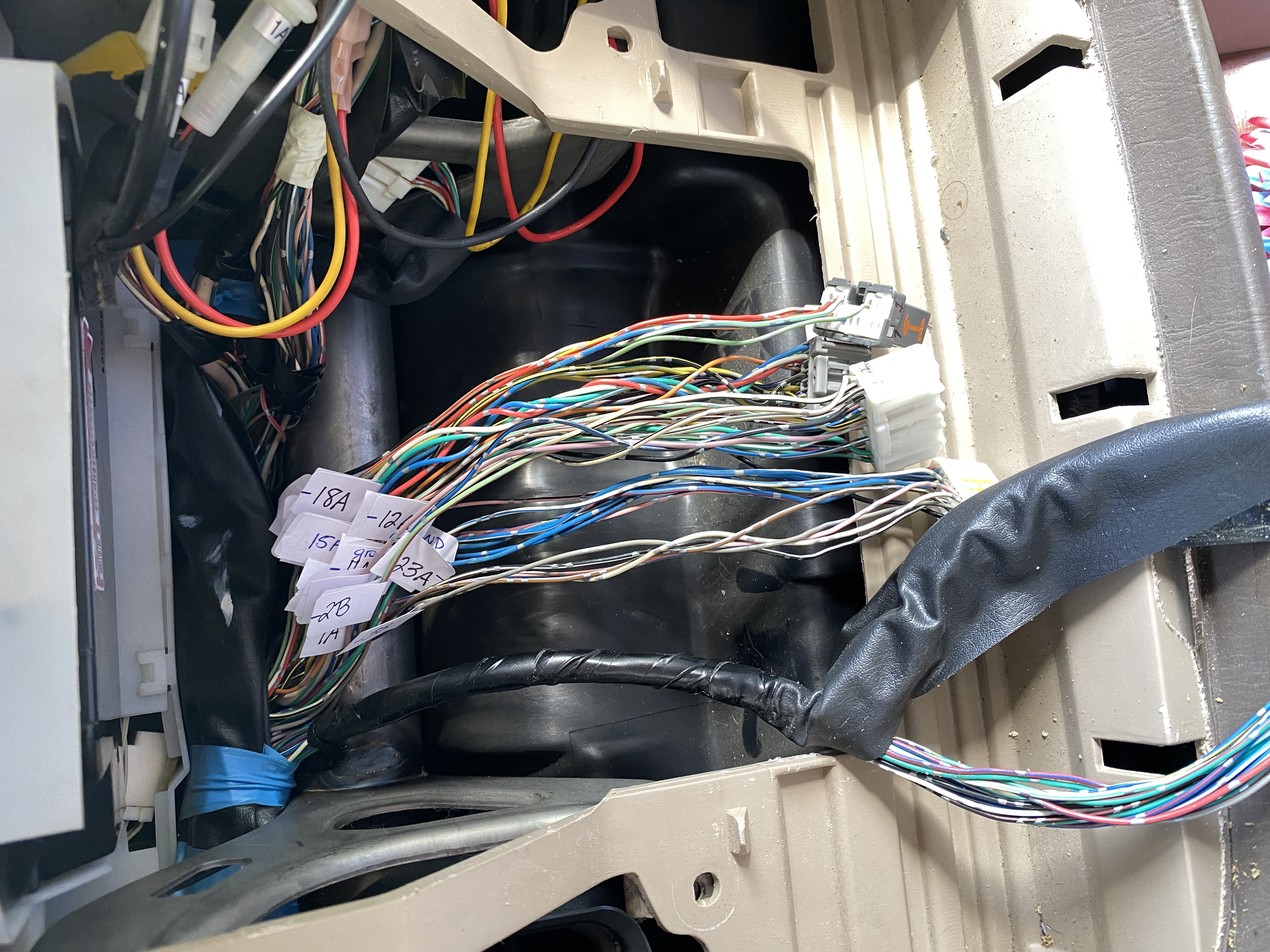

After much back and forth thinking they have to be too good to be true and will never be as good as a soldered crimp and heat shrunk connection, I ended up using solder seal wire connectors. Get a good heat gun and I recommend a heavy duty welding glove to place between the heat gun and all the stuff...Which is most of the stuff...That you don't want to melt. Burn up a few as practice to get a feel for them. I think that the most important part, other than being patient enough to see the solder melt, is maintaining a horizontal orientation and not moving the wires when applying the heat. These things tend to pull apart and/or harden in less than optimal orientations. They burn the crap outa your fingers too.
I bought all new connectors, re-pinned, and used the links in this thread for the new pins and tools/picks...I think. I like the engineer crimping pliers for open barrel connectors. They make a solid connection but you have to crimp the wire and the insulation separately which is a pita. I have a ratchet crimper and dies that were the appropriate size, so used them most of the time. I was unable to use any of the original connectors that had to go into a different sized location in it's new home, they just didn't fit well and swapping connectors is super easy anyway.
For any situation where one source wire needed to go to multiple pin locations, I cut the source wire and added up to 3 new wires as needed with a solder seal connector. 2 wires in(1 Source) 2 wires out. I extended some of the shorter original wires too that made the final instasllation a bit tight. I was able to salvage enough wire lengths from the original looms to supply all the extensions and additional wires I needed.
I am an analy retentaive, partially dyslective, mechanical engineer with ADHD, so none of the pinout diagarms and descriptions in this post made any sense to me. Take your time to figure out the pinout numbering scheme first. Left to right, upper row to bottom row, connection side vs wire side...It's a special kinda thinking to get it straight. The hardest thing for me was actually figuring out which existing connectors were to be used vs not needed and only part of the Multi-Function Display. I have the service and electircal manuals, so figured it out that way. I absolutely was unable to wrap my head around it otherwise. Basically the small connectors along the top row of the MFD are not used at all....I tihnk. I'm better at figuring stuff out than following instructions.

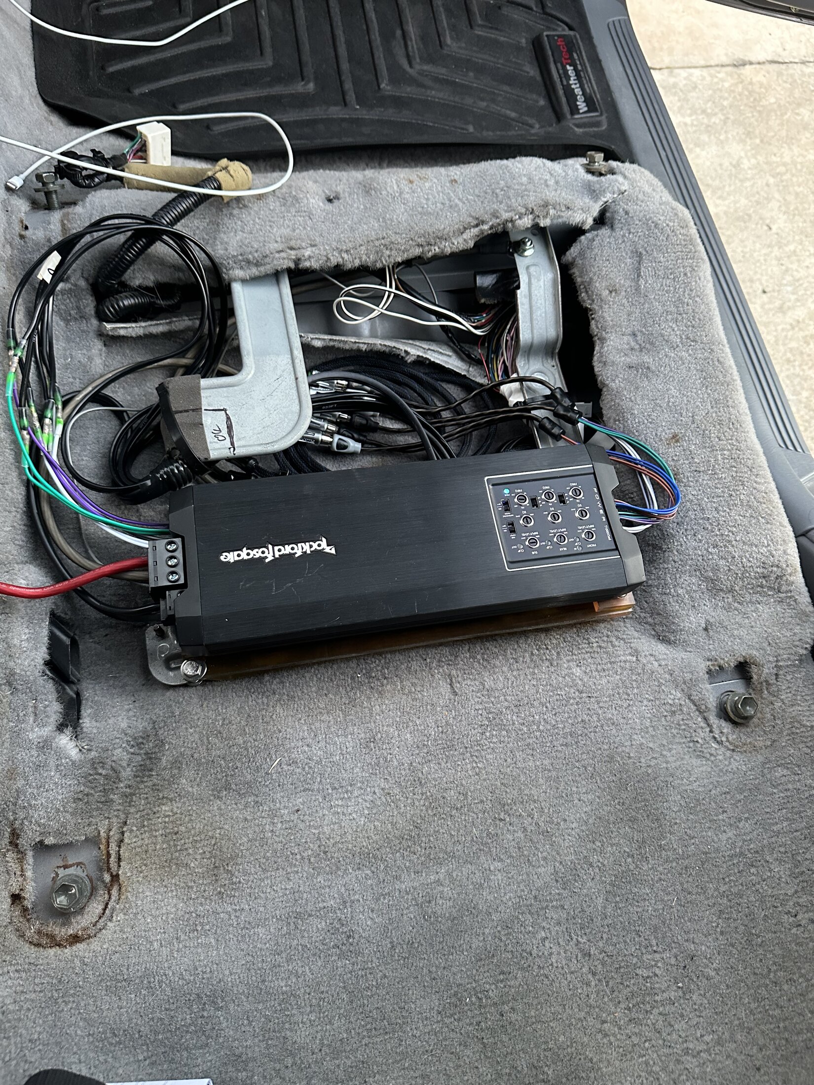

I had to grab the antanea signal from the original radio plug, and I think the speed sensor and reverse signal for turning the backup camera on were both under the passenger seat. I tied them to a pin I know wasn't going to be used anymore on the old loom and just put those pins in the proper place. I used the existing amp on +12V under the passenger seat as the new Amp remote on signal.
If you are going to put hardware under the passenger seat, keep in mind that there are mechanisims that move under there that can(& will) break stuff if you mount it too high. I ended up removing most of the original Nav & Amp mounting brackets.

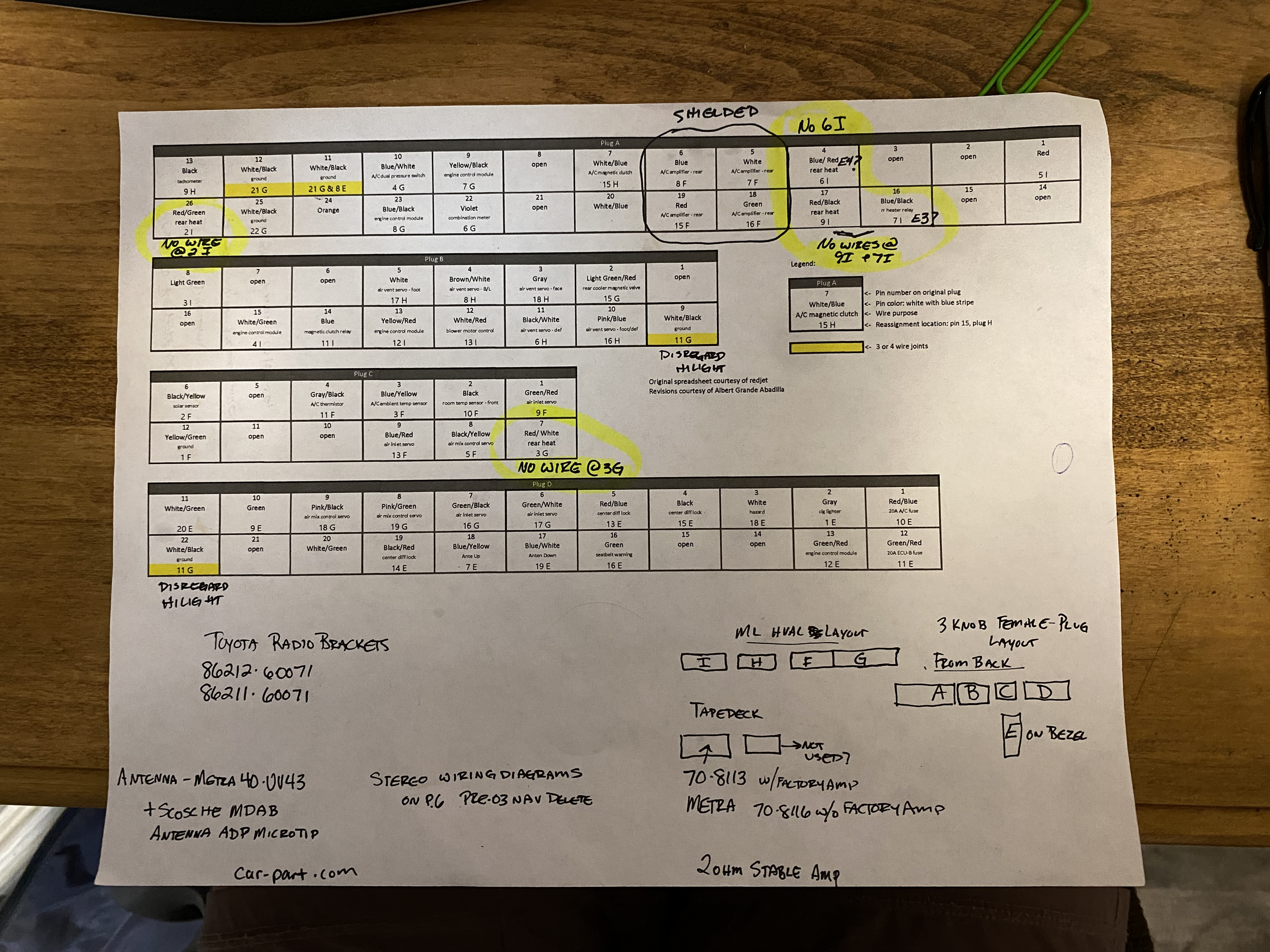

So I got all the parts and pieces to get from a Levinson POS to the three knob controller. My LX is a 2002 w/ nav and rear A/C and heat. Got after it yesterday and thanks so much to TXSunDevil and all those that have gone before! So everything works and is connected correctly but I have 2 issues.
1. A/C in ON all the time. tried the 20-30 second hold Patassa mentioned earlier but no dice. Sill on always.
2. Bigger issue is the rear heat/ A/C. From the truck side, I have no wires that correspond to the pinouts for the rear portion of the conversion. I looked around for color matching wires, but was hoping someone has resolved this. See pic of the pinout guide, I highlighted the pins here that have no where to attach.
SO I'm looking for the LX to LC diagrams for the rear heat/A/C. I've got a few printed but for some reason my special rig just does not have the wires in the existing dash to accommodate the new 4 plug dash unit.
Thanks for any help and my apologies if this has already been posted. I made it like page 30 of this thread and am crosseyed.

Yep. I read thru those. I got the exact same type of controller, with just the button that says "REAR". The dash just powers up the controller, I think. The problem is that none of the wiring for the rear heat has anywhere to plug into from the old/factory wiring and into the "new" unit. Maybe ill pull the rear ceiling control unit down and see if I can find some wires there that match up to the stuff in the dash. From the pinout diagram I'm missing all of the wires (6i to 4a, 9i to 17a, 7i to 16a, 2i to 26a, 3G to 7C) that are "supposed" to be there. They go to so I don't have the wires to splice into the "new" unit. :confused:

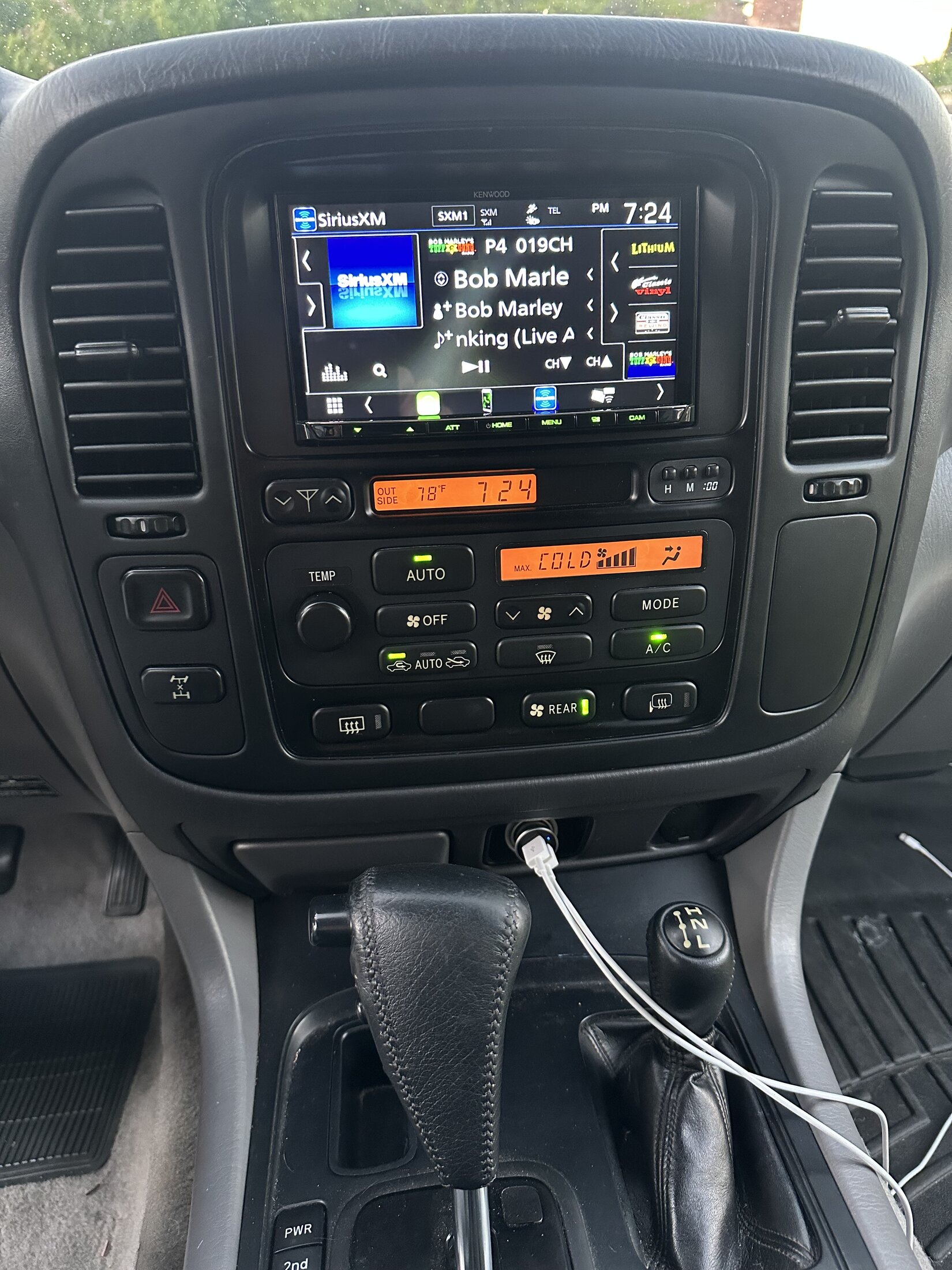

Done. New Sony unit installed and everything is working as it should. AND sounds amazing! Local stereo shop that I got the unit from had time that day to install and sort out some new components and crossovers etc. Work a couple bucks in my mind.

Sorry I was confused by some missing wires on the pinout, They all work and are controlled by the A/C amplifier shielded wires on Plug A. So if you have rear A/C and heat, just trust the process. If it doesn't work, likely the buttons on the "new" unit are lousy.
