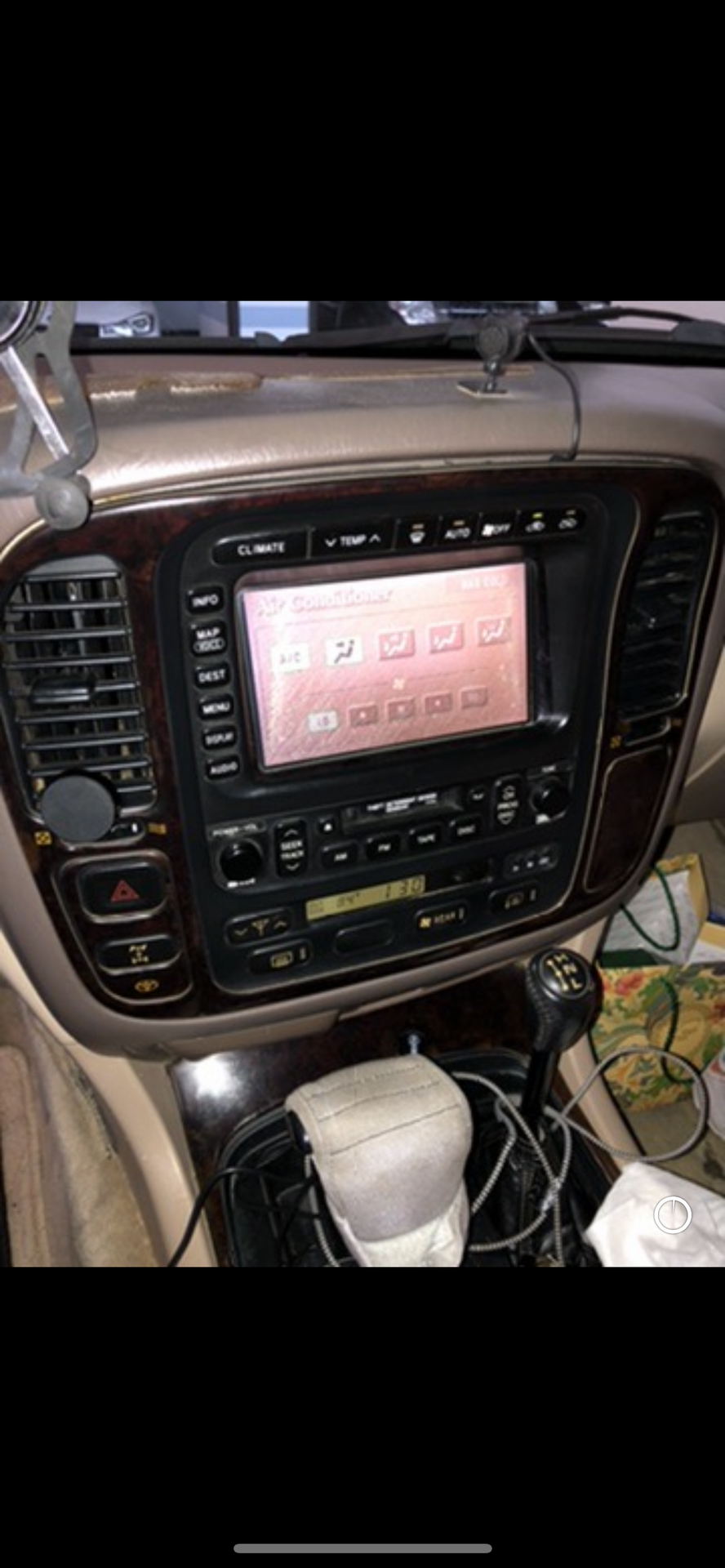

On the 2002's the climate controls are not on the touch screen like the later 100's. However, they do have climate controls on the top of the screen & dash pod. It looks they have included the climate controls within this unit and moved them to the bottom. Would love to know if this unit actually works.
Mine's 2002, VIN JTEHT05J122023124 you can check. Below photo of my AC Touch Screen:

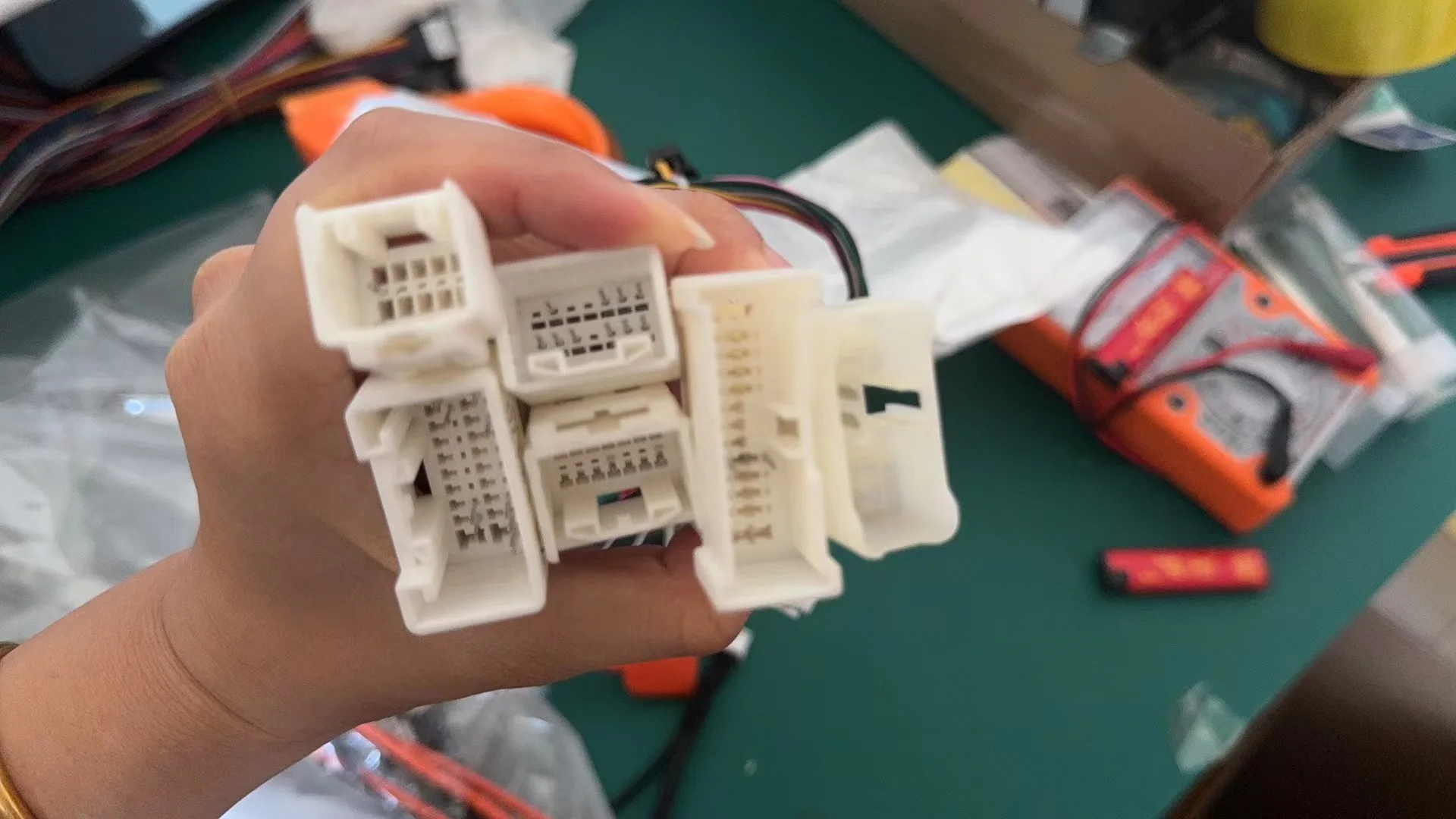

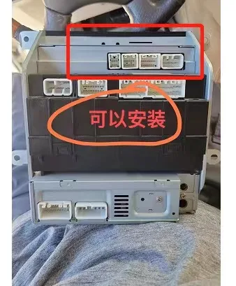

I sent a message also, they respond to "it's compatible with your plugs but you have to change your bezel to nav then install it" and sent to me the product plugs.
What's written in Chinese is "Can be installed"
but still I'm not convinced, I'm afraid it doesn't fit my plugs. I asked if doesn't fit can I return it? they says Yes

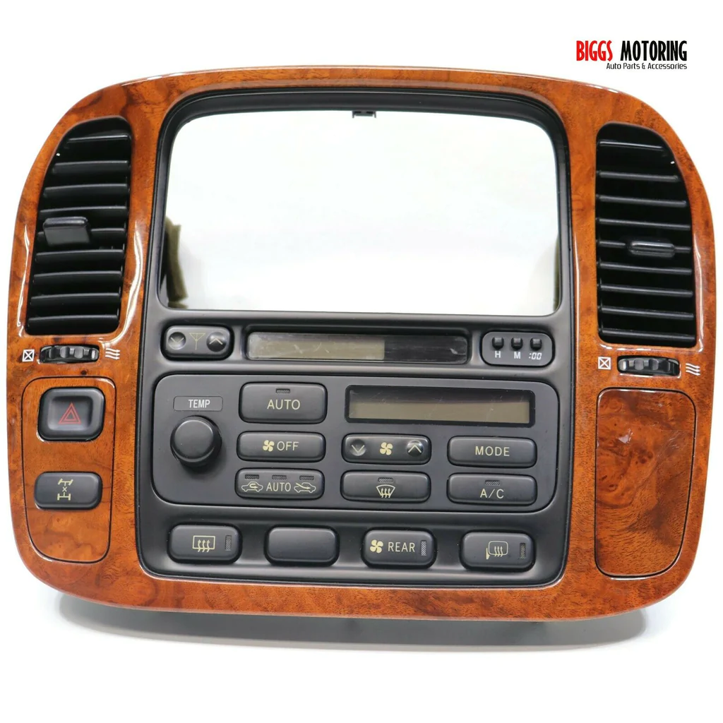

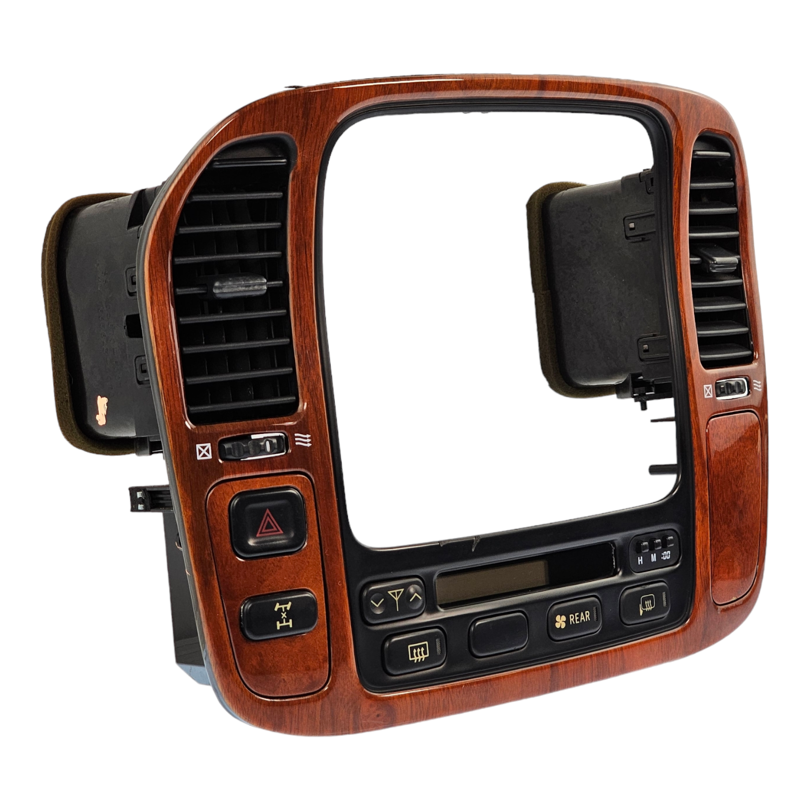

What I have is "non-nav bezel", so they said first change it "nav bezel" then the product will be compatible with you.
from this bezel (What I have now):
to this one:
But they're wrong because it's not that easy just buy "nav bezel" then the there product and install them. I have to manipulating with my "non-nav" bezel's wire harness to make it work.

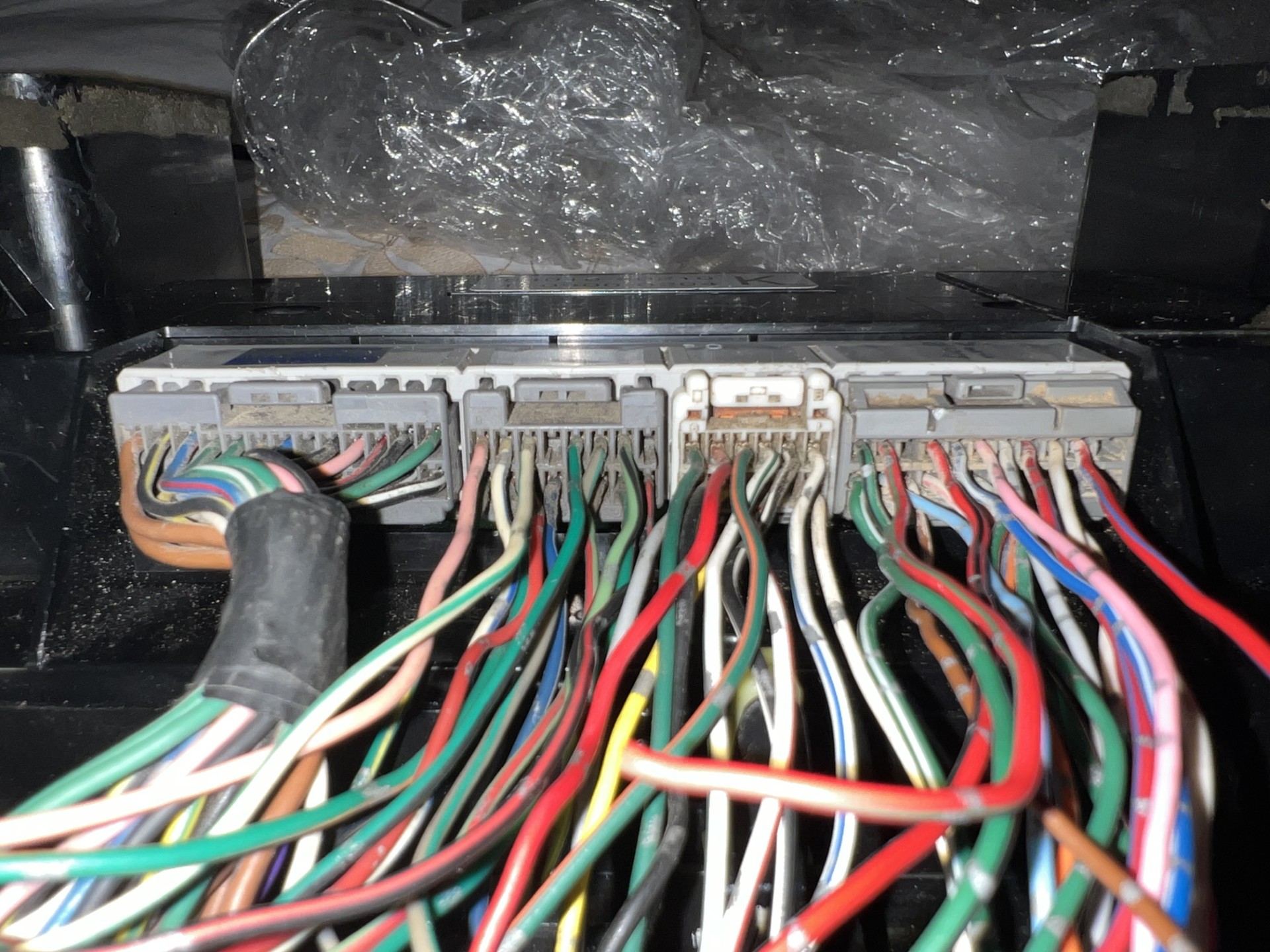

So my project is complete - successful - but a little more involved. There are a lot of great write ups here so I will try to just add to and not repeat anything. First of all I want to underscore what was written in 360: the Mark Levinson factory amp was unable to respond to my new head unit, and required a significant departure of plan for me, but the outcome was better than I had planned!

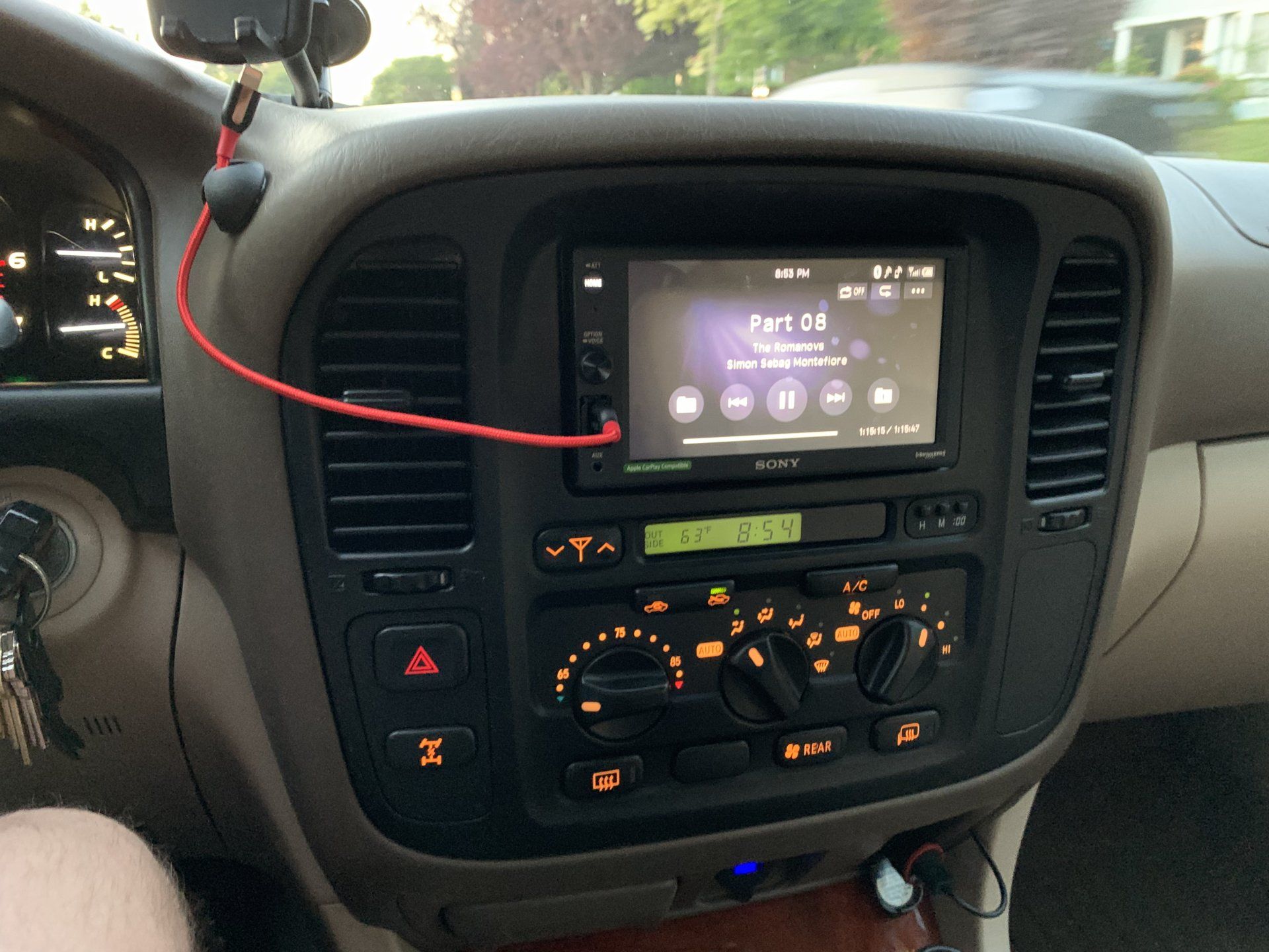

Here’s the money shot:
My parts list included:

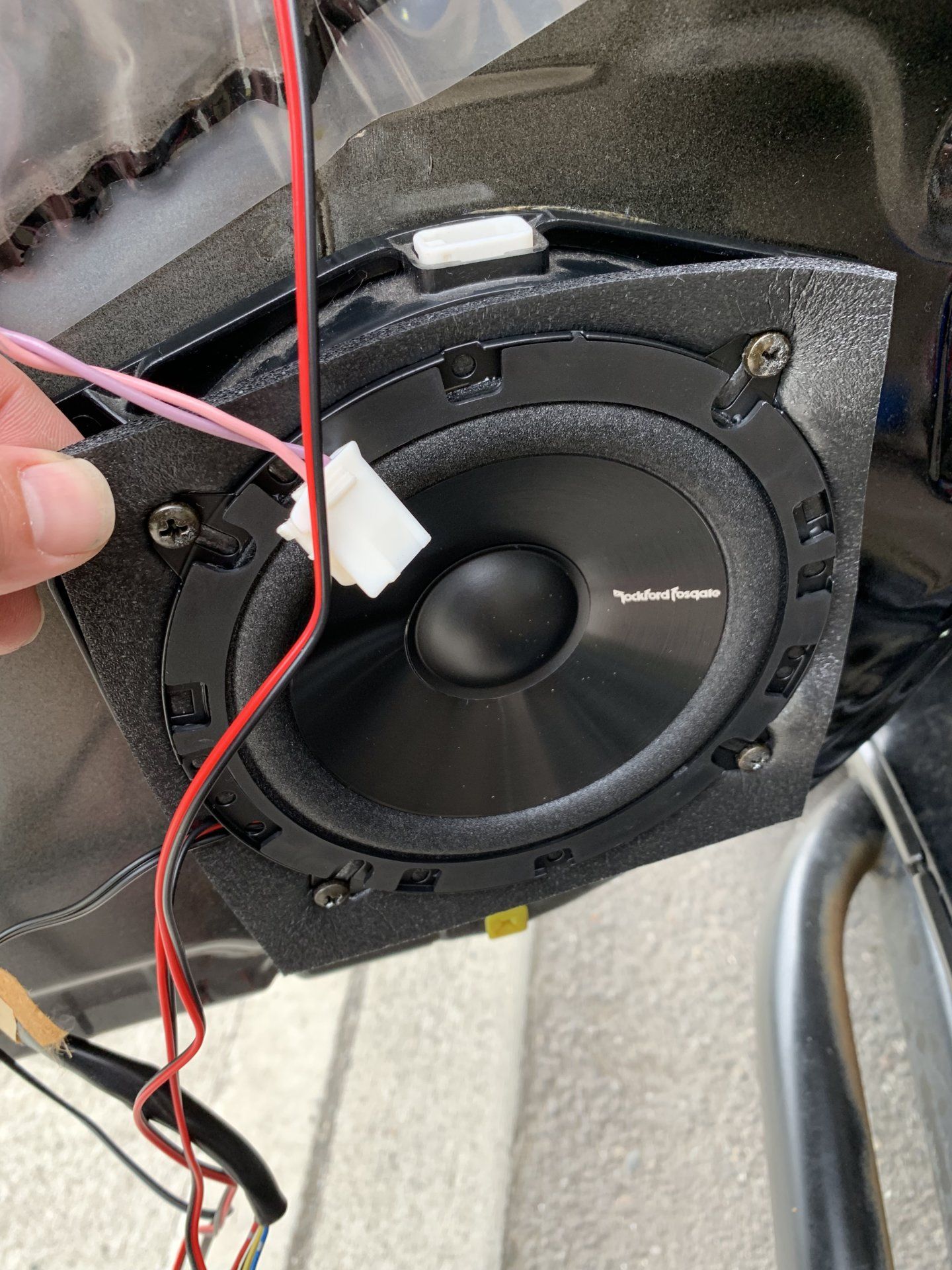

Here’s some random pics that I thought might be helpful:
The foam speaker baffle installed behind the speaker. Creates an air tight space? Is that important?

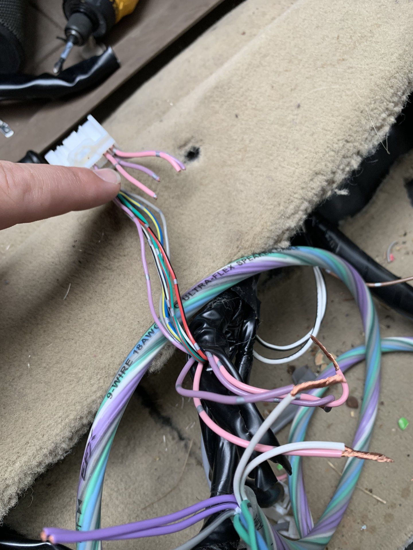

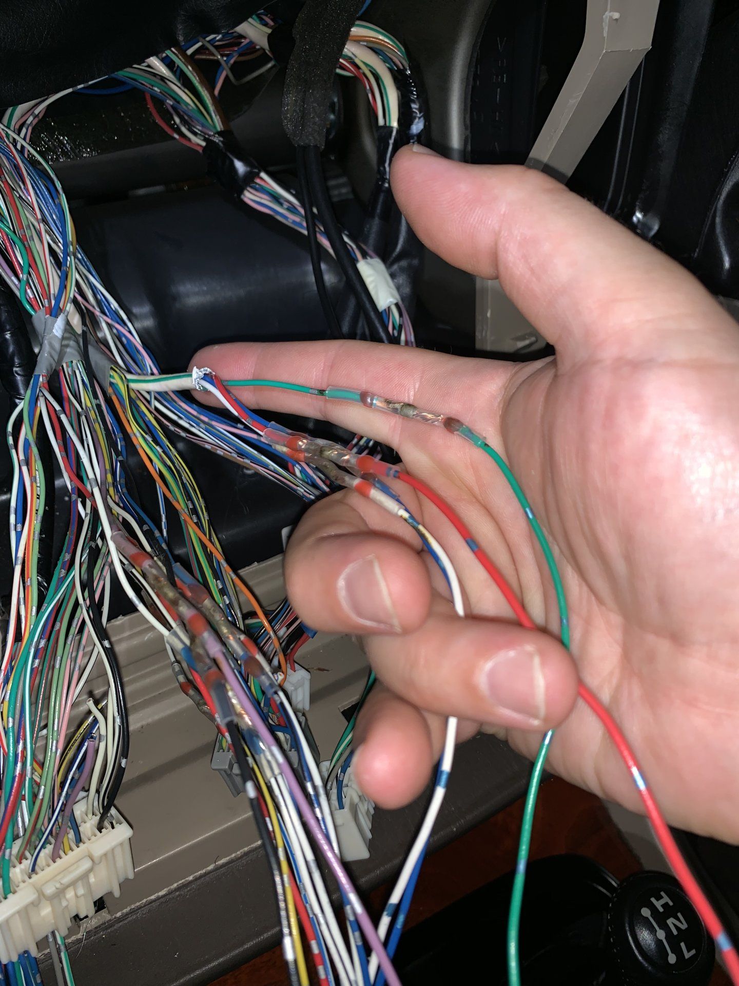

I didn’t notice until later that these four wires, which needed to be switched around following the wiring pin out map, were wrapped together... anyways I went to the hassle of stripping that white and green wrap around the four wires, and basically could’ve left it, so that was 2-3m of time wasted.
There’s some vague language in here about “grabbing the left door speaker” from the Nav DVD drive plug - that’s true! Basically the factory Mark Levinson w/Nav setup sends sound: head unit -> amp -> speakers EXCEPT the front door sound goes from amp -> Nav DVD -> Speaker; so you are looking for two pairs of pink & purple wires by my finger in one of the Nav DVD drive plugs, and you’ve gotta pull those through the bundle to find the 2’ Section that goes amp -> Nav, and the wires that go from Nav -> speakers. This whole thing is assuming you want to use the existing speaker wires in your new setup. As you can see here, I connected the 9wire bundle from my head unit to the existing speaker wires. That worked super well. No reason to run new wires. I used solder seal connectors here after confirming everything was working properly.

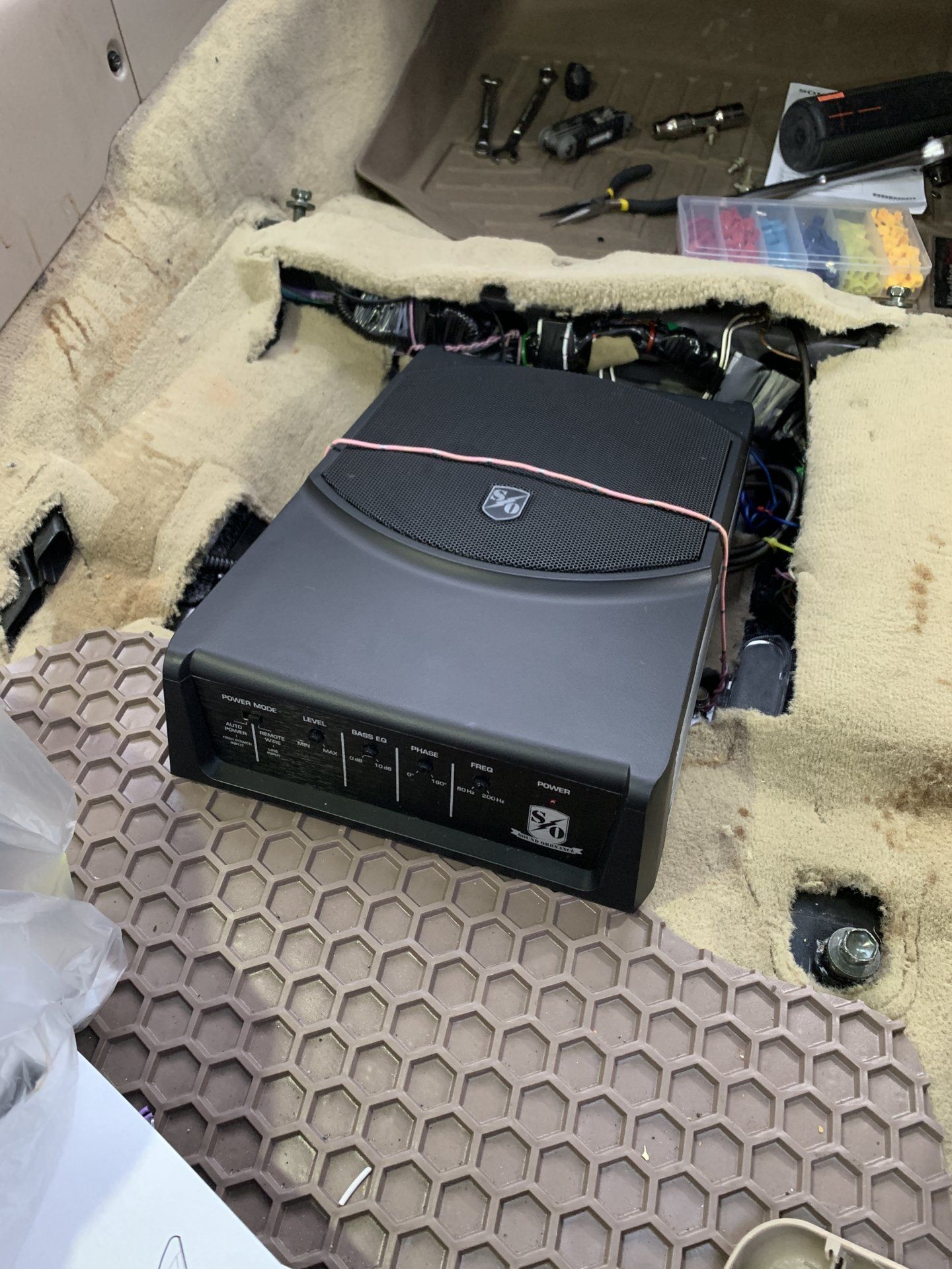

This thing is great! I hate how it sits in there, but there isn’t a lot of options unless I move it to the back or I start trimming carpet around. I ran the power through the driver’s firewall, behind the pedals under the carpet, and up under the gear shift trim, then under the carpet there where the awful stain is on the carpet. It’s a little janky of a setup but the wire shouldn’t shift or rub, and isn’t being pinched.
So, that’s the tale of my Nav Delete! Removed the factory amp, new speakers, etc... the sound is amazing, and I love the conversion to manual climate knobs. So much easier. I do not really know what I am doing with this, and I made it work, so anybody can do this.

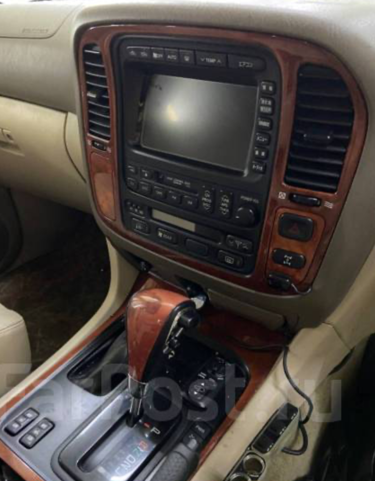

I have attached photos of my current set up and the setup that I would like to move to includimg the backside. I have been looking at the instructions on this forum and my pigtail wire colours are different for pins A,B,C,D. I can also see for example that I have wires in pins shown as open in the instruction diagram.
Has anyone attempted a nav delete on RHD with the setup I want to use? Can someone offer me help on how to get this set up on my RHD car? Most of the instructions I have seen on this forum are for LHD. The one I have seen for RHD is for a conversion to the LC100 climate control dials and not the one I have attached in the images that I want to switch to.
Can you please advice on how I can get this to work?
