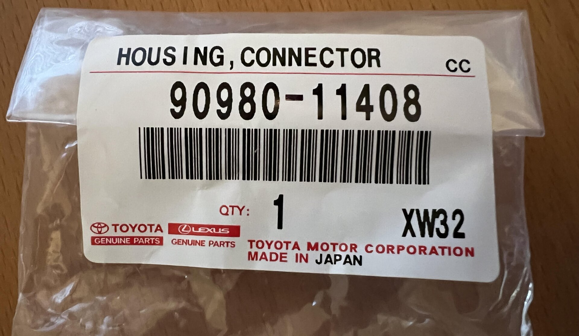

When I went to the dealership site to order the Connector E with the PN 90980-11408, it comes up as Connector F. Am I right in ordering that one?
Very nice. I will be following as I haven't had luck finding the pigtails.
That should actually be connector C, not E. Looks like I mistyped in my original post. I'll verify the PN's when I get home.
Once my post count is high enough to allow editing I'll correct my original post.

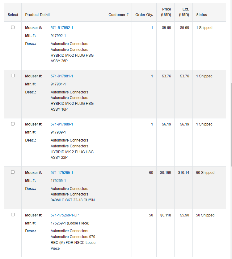

Ok I was able to order connectors A B and D through the Mouser links you posted along with the terminals. I tried the link for Connector E shown above and it required a minimum 2400
I think all the electronics sites had either no inventory or a large minimum buy for that connector, so I ordered directly from dealer. The only reason for using mouser for the other connectors was price was cheaper than Toyota and I also wanted extra terminals.
As soon as I get home from work I'll verify everything for you before you place the order.
@silverg
I corrected my original post to show the connector as "C" instead of "E" but the Toyota part number is correct, here is a pic of what I ordered and it plugged into the connector C slot fine:

Here is a screenshot of my Mouser order for reference also
